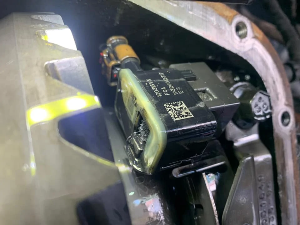

I had my diff gears changed to 4.88 recently. While taking off the main bearing (on both diffs), the guy bust them up pretty good. No biggie, got replacements and done.
Unfortunately, he left some busted up pieces in the rear diff. The gears seem to be fine, but the actuator looks broken (I'll be able to test when I get my Jeep back from service). Apparently, you can't get them separate and have to buy a new diff, gears and all.
So now I'm thinking just replace the lockers (thinking Ox or Eaton). Is that doable? Is there anything else I could do here?

Jeep Wrangler JL 2020 JLUR Locker Replacement diff1
Jeep Wrangler JL 2020 JLUR Locker Replacement diff2
Jeep Wrangler JL 2020 JLUR Locker Replacement diff3

This all sounds so half-assed and home garage based. Your situation is infinitely more complicated due to the fact there are no repair parts for the locker mechanism in the Rubicon axles. You are looking at $$$$ to even bring this back to stock.

You won't be able to run aftermarket lockers from the factory locker switches, but you can run them from the aux switches.
Edit, apparently Z Automotive has a fix for that, see below.
Thank you!

To my knowledge, ARB is the only aftermarket locker available for the JL rubicon. The catch is that it requires 35 spline axle shafts. The next catch is that RCV is the only company that makes 35 spline front axle shafts that I’m aware of. RCV = $$$$. The third catch is that nobody makes 35 spline rear shafts for the JLUR and ARB locker.
