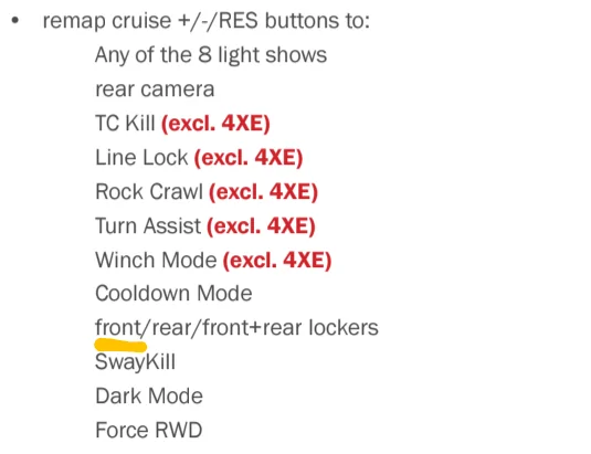

Here are some screenshots of the Tazer JL Mini instructions I have saved on my phone:
Jeep Wrangler JL Front Locker Coil/Solenoid Actuator Dead - Sources? 1000005236
Jeep Wrangler JL Front Locker Coil/Solenoid Actuator Dead - Sources? 1000005235

I jacked up the axles and confirmed the Tazer feature works, front locker only.
The only question remaining is why "front/" is no longer included with "rear/front+rear" in the current Tazer button mapping instructions. Was the feature removed from the latest firmware or is it just a typo?
