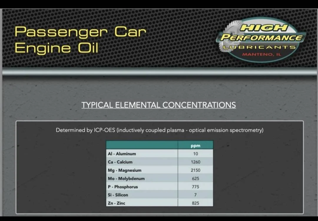

They show Aluminum in the datasheet. Why?
most likely in how the oil was stored or mixed or transported ie might use aluminum vats or pipes it could have come from the other additives ie maybe they came in contact with minute parts of aluminum..multitude of reasons..try asking the oil manufacturer..

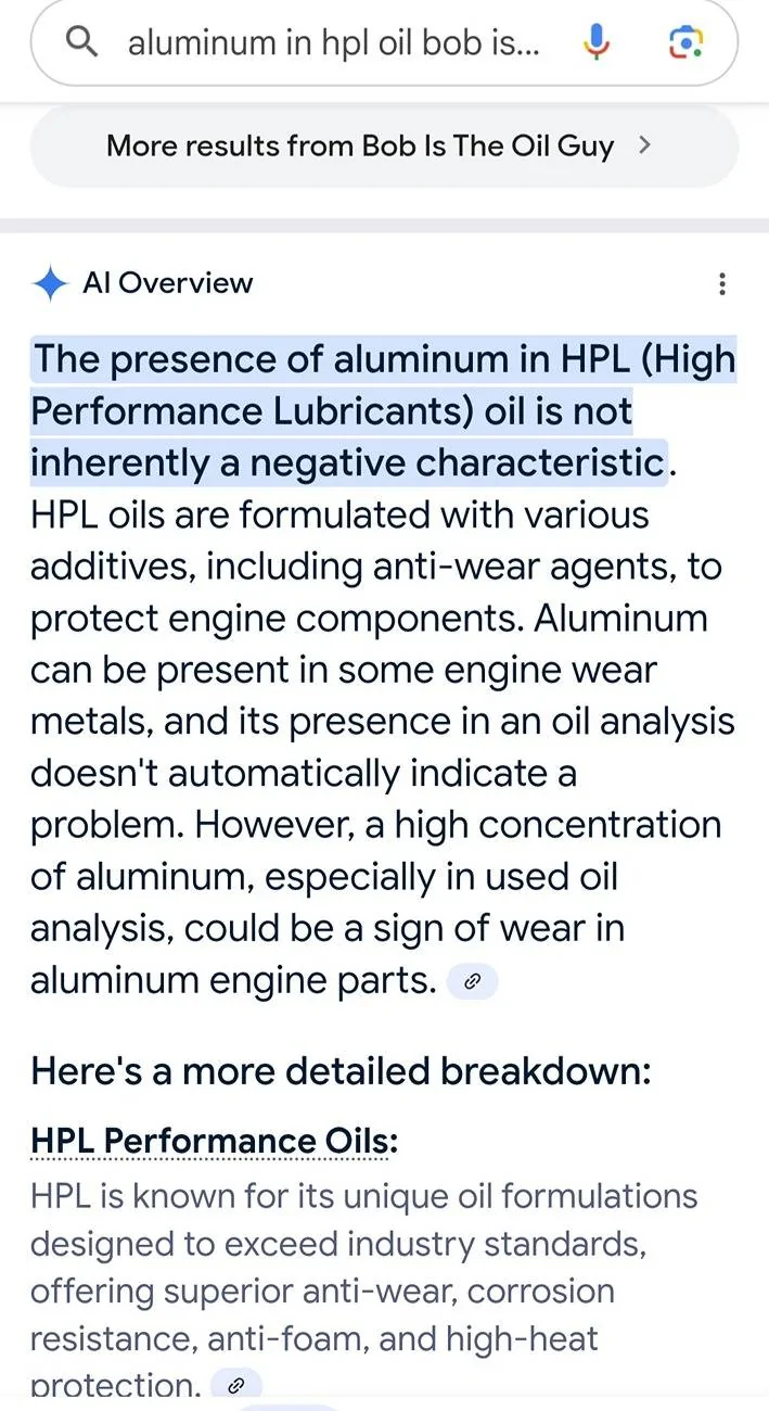

I will shoot them an email, in the meanwhile I found this. Looks like it comes from the anti-wear additive packages that they use in the oil
