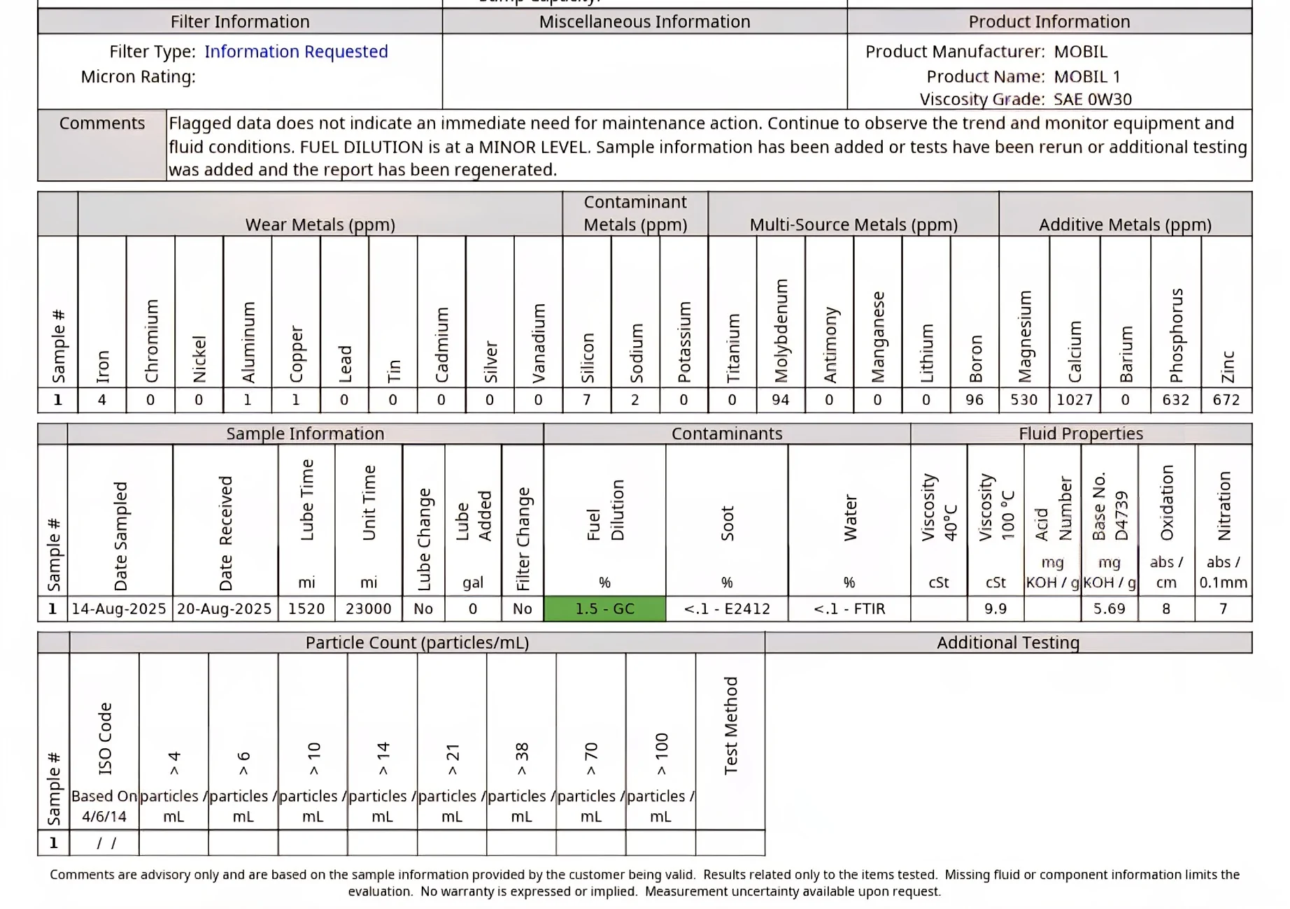

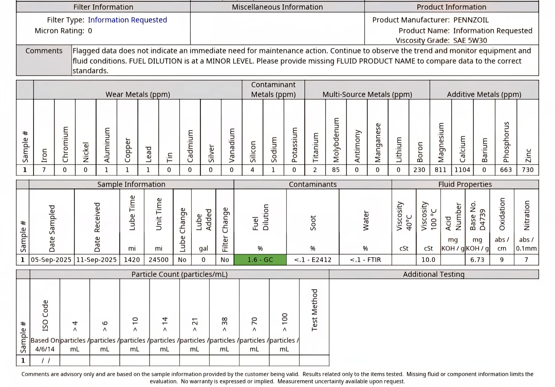

PUP 5W-30 lost only 0.3 centistokes while M1 AFE 0W-30 lost 0.9. I have virgin numbers for both, 10.3 and 10.8. I think 5W is more beefy.
Jeep Wrangler JL 5W does better against fuel vs. 0W? Screenshot_20250927_193351_Adobe Acrobat
Jeep Wrangler JL 5W does better against fuel vs. 0W? Screenshot_20250927_193410_Adobe Acrobat

Maybe a centistokes comparison between the 0w or 5w for three or four thousand miles, with only difference being one run has five quarts and the other is six quarts. Can almost predict the outcome.

To establish any kind of trend you’d need about a dozen UOA’s of each to start.
The other problem is fuel dilution is an ever changing data point.
