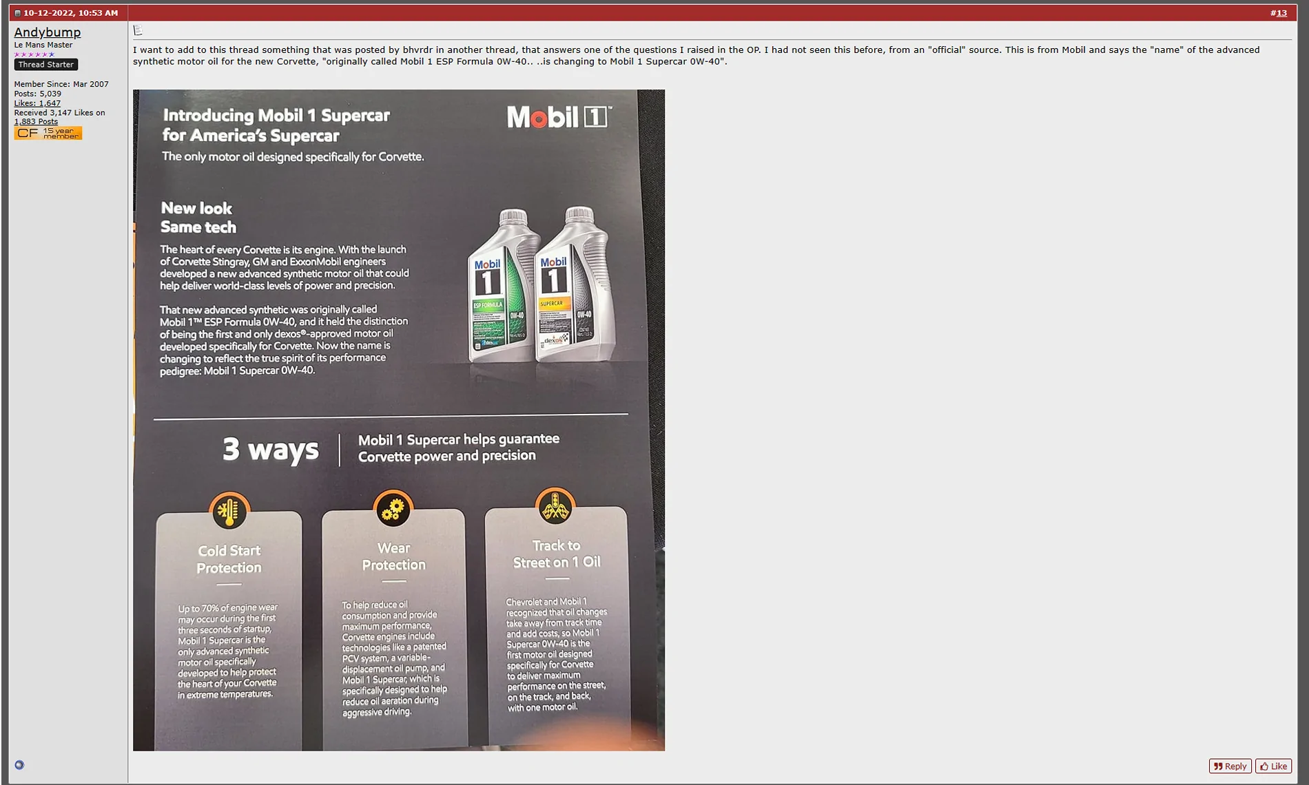

Both fantastic oils! Supercar was the original ESP Formula 0W-40 as you probably already know. It’s nice walking into Wally and grabbing ESP 0W-30 for $28!
I found this on BITOG.
Jeep Wrangler JL 5W 30 versus 0W 20 ESP vs Supercar
