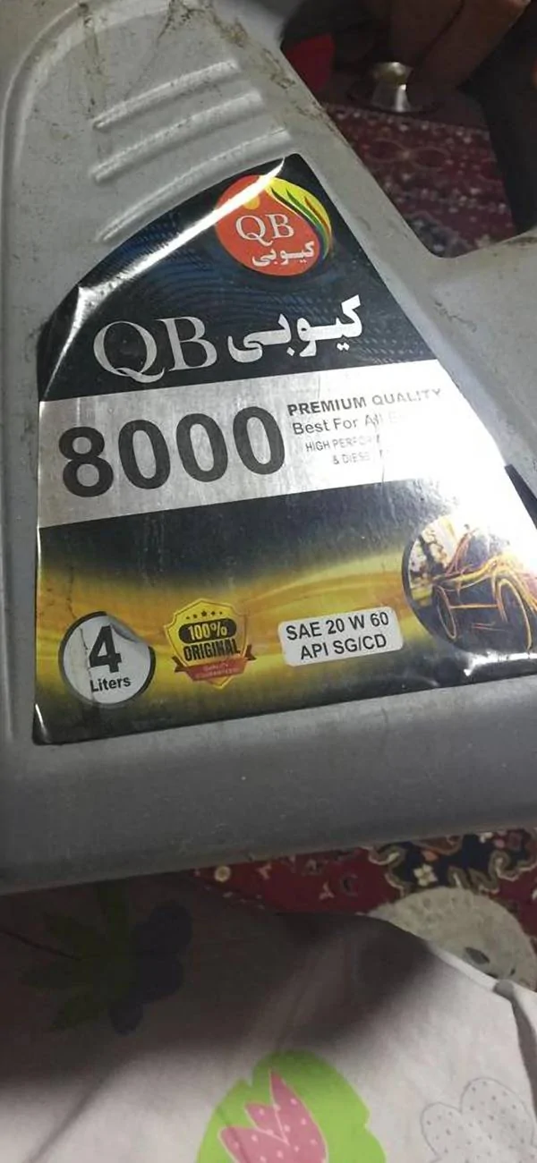

My dad runs 20W60 diesel oil in his 1998 Toyota 4Runner in Kabul Afghanistan 🫣. Kabul gets as cold as Denver. This winter it got down to 5° fahrenheit, and he says that the truck started fine
Jeep Wrangler JL 5W 30 versus 0W 20 Screenshot_20250711_134832_Gallery

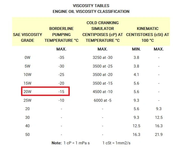

Surprised that you can still buy API SG and that API is used there versus ACEA, but that is another conversation.
It is easy to see why it would start at 5°F, but that would be about the limit (-15C = +5F):
Jeep Wrangler JL 5W 30 versus 0W 20 Motor Oil Viscosity Classification System
https://www.machinerylubrication.com/Read/23788/motor-oil-viscosity

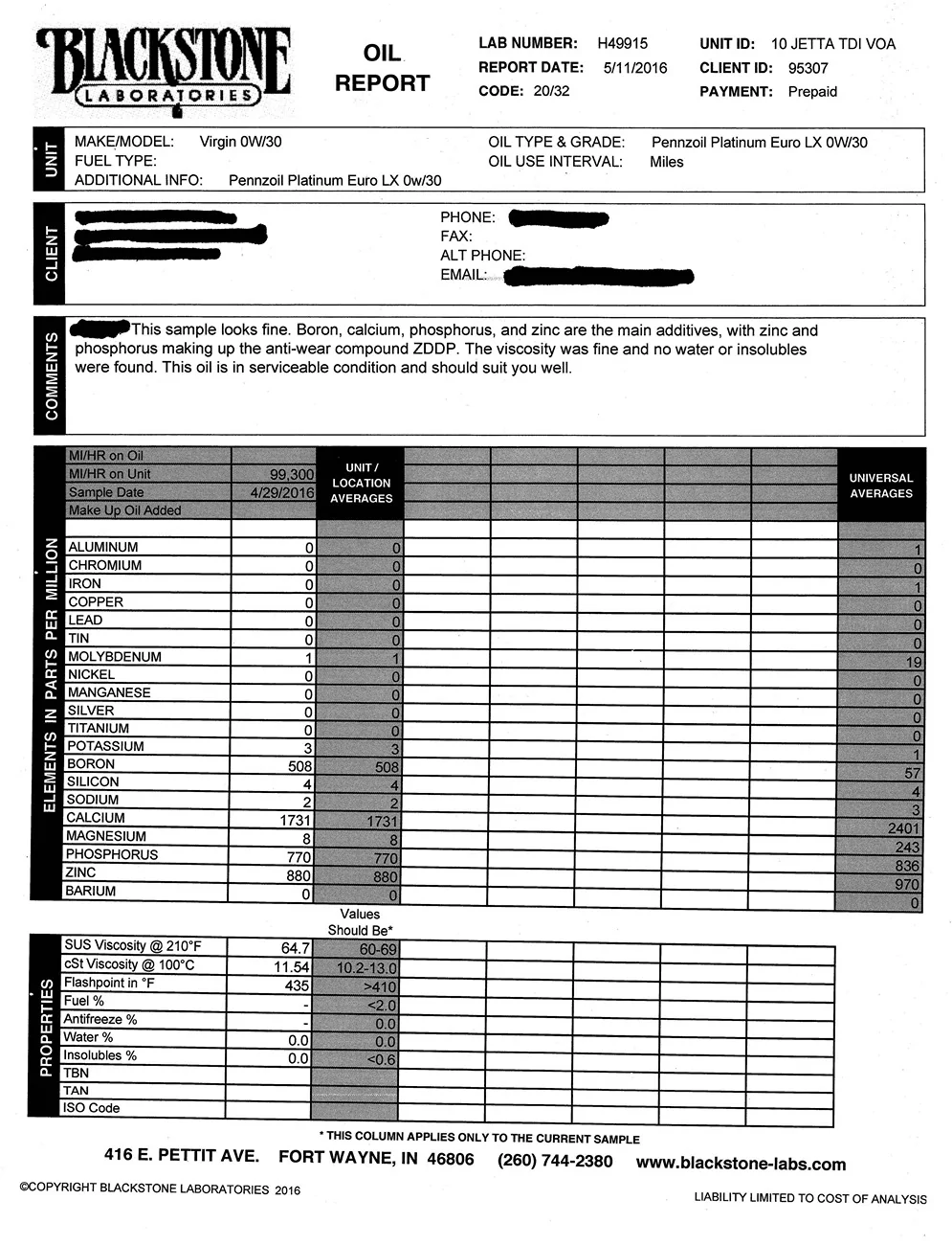

I just learned that Pennzoil Euro LX 0W-30 is known as Shell Helix Ultra in the rest of the world, it boasts about PurePlus natural gas stuff in the datasheet so that's PUP 0W-30 🤩👍
Likely the additive package is different.
