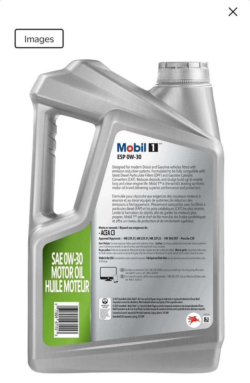

Why it doesn't have API Starburst?
I believe it's on the back. I will have to check one of the bottles I have on the shelf in the garage, but all the certs are listed on the back of the bottle.

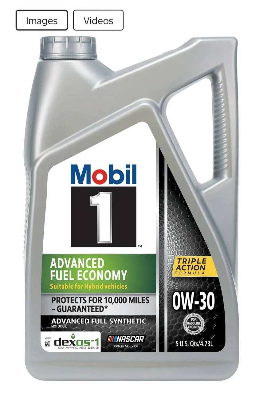

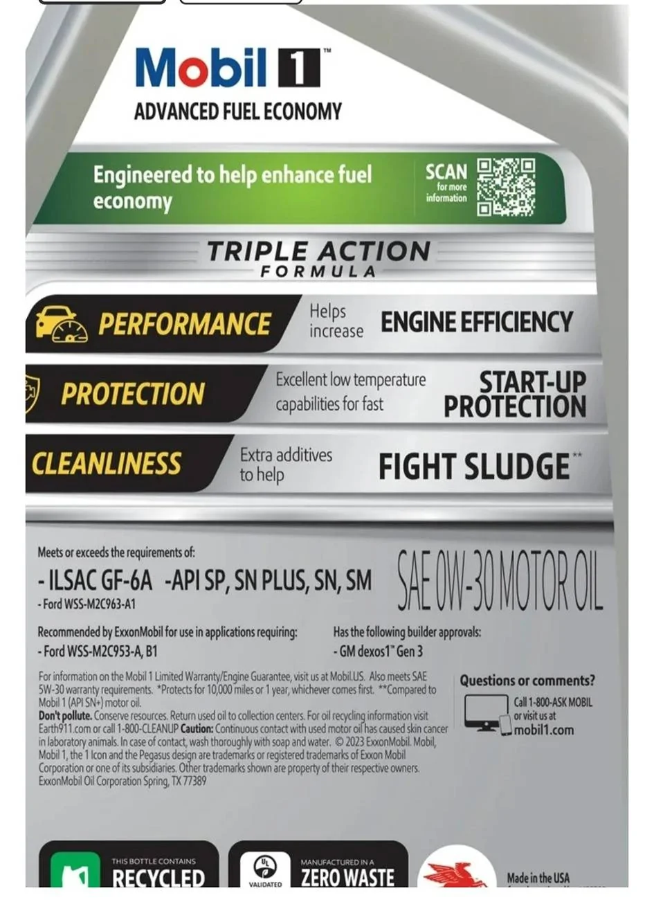

This one has the Startburst and ILSAC GF-6A too. Not crazy thick, only 10.5 🤩👍

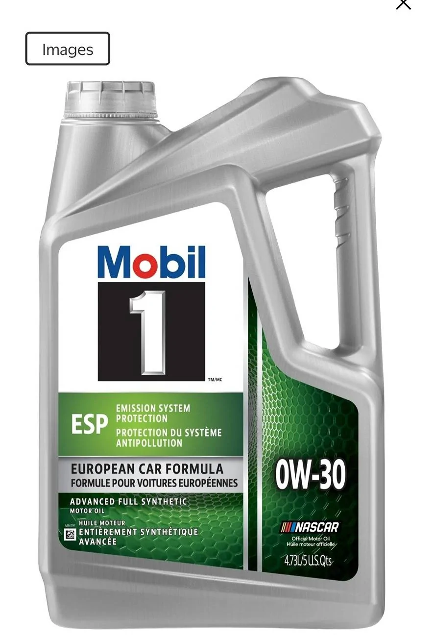

Because it is a European oil and uses ACEA instead. Like other European oils, with regards to API, it states:
This product meets or exceeds the requirements of:
API SL
API SN Engine Test Requirements
API SN PLUS ENGINE TEST REQUIREMENTS
API SP ENGINE TEST REQUIREMENTS
API SQ Engine Test Requirements
Given the actual approvals that it has:
MB-Approval 229.31
MB-Approval 229.51
Porsche C30
VW 504 00
VW 507 00
There is no question that it does.
