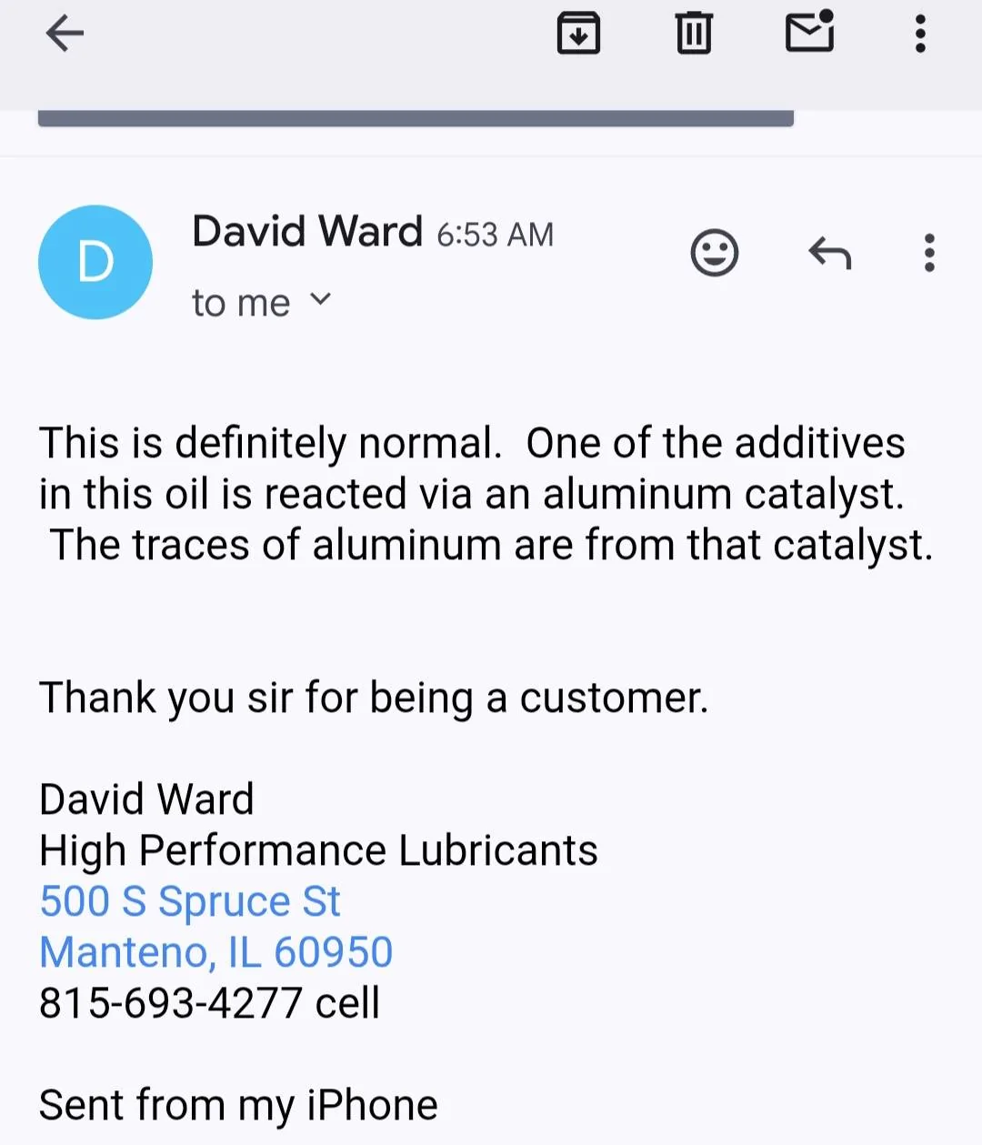

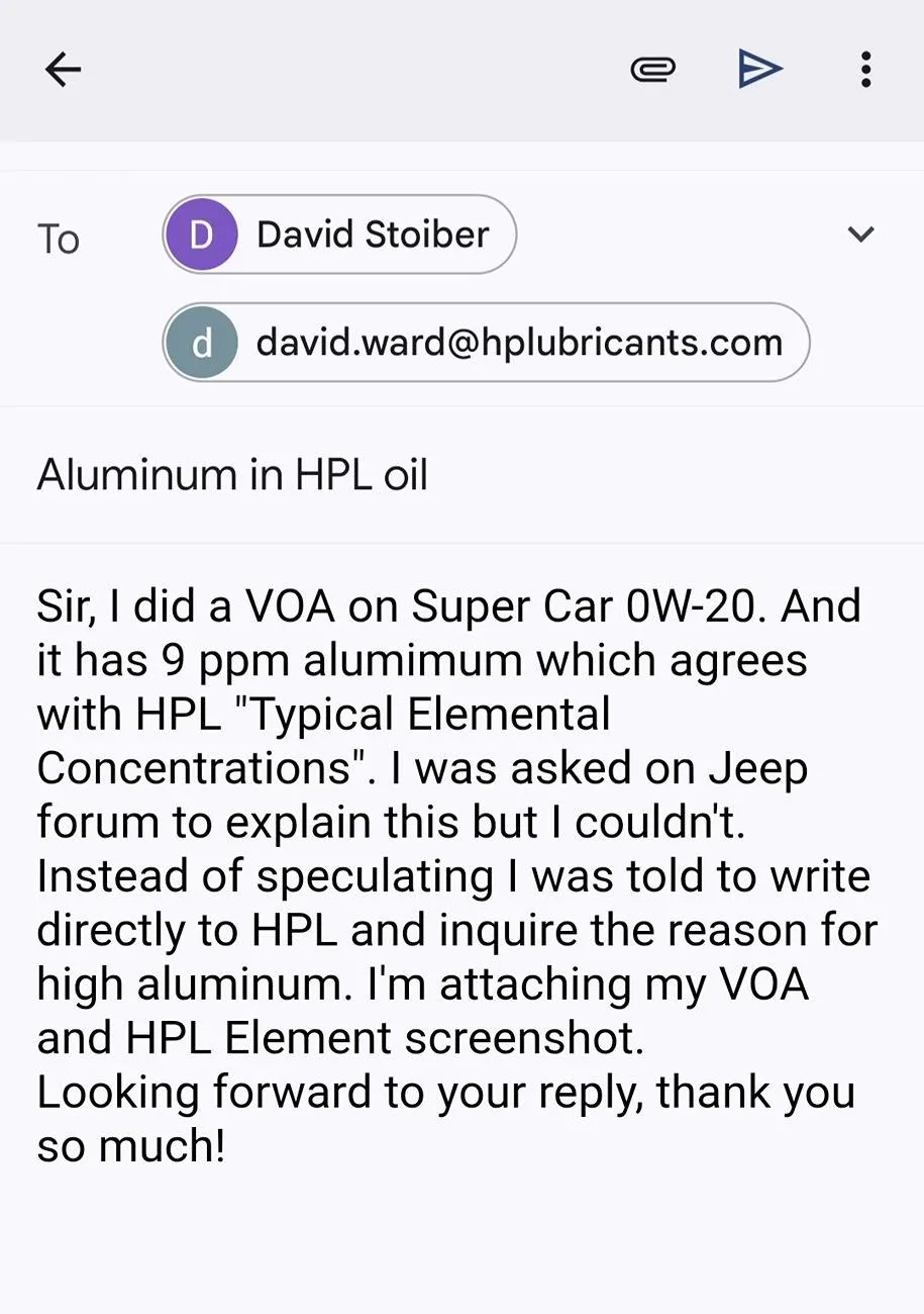

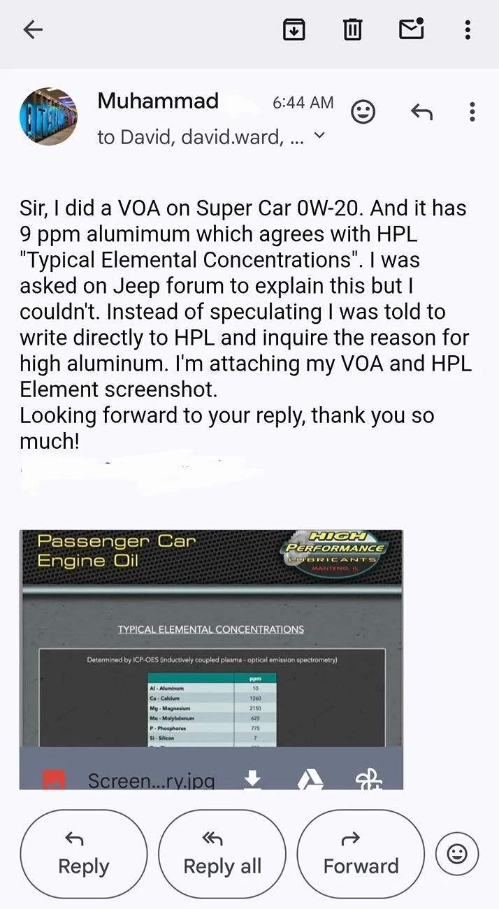

most likely in how the oil was stored or mixed or transported ie might use aluminum vats or pipes it could have come from the other additives ie maybe they came in contact with minute parts of aluminum..multitude of reasons..try asking the oil manufacturer..
Done!
Jeep Wrangler JL 5W 30 versus 0W 20 Screenshot_20250705_181152_Gmail

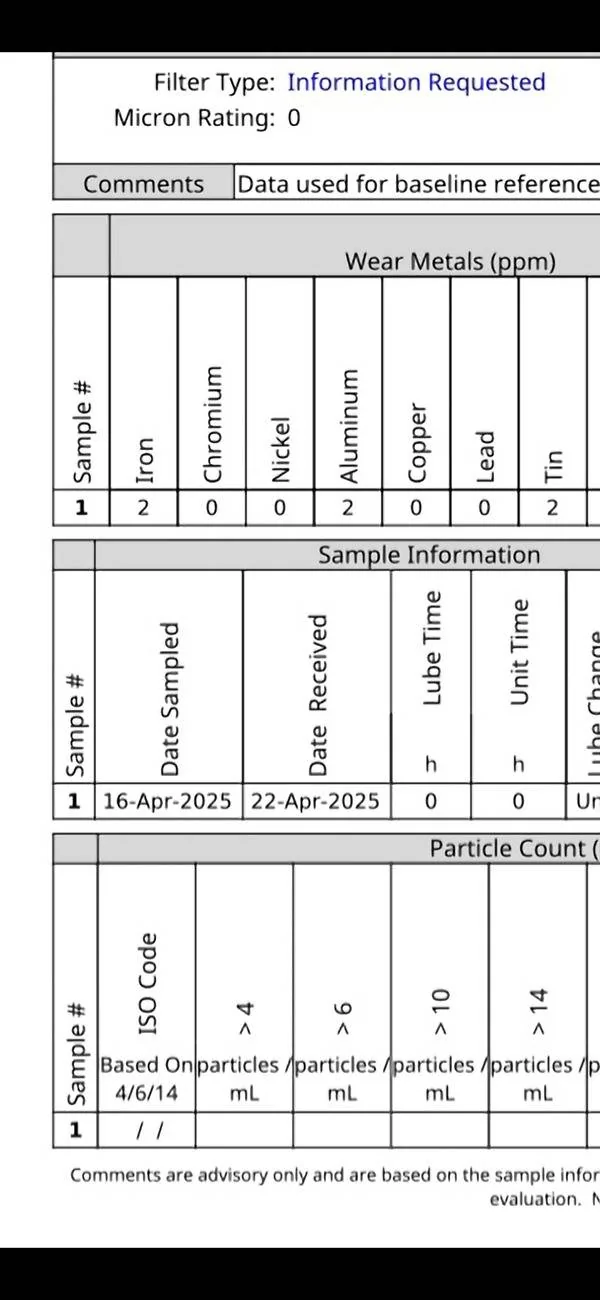

This Mobil 1 VOA also has 2 Iron and 2 Aluminum
2 != 9.
There can always be traces of wear metals, but HPL had multiple plus sodium and potassium.
Put that aside--look at the price of an oil that has no approvals.
Where is the cost justification?

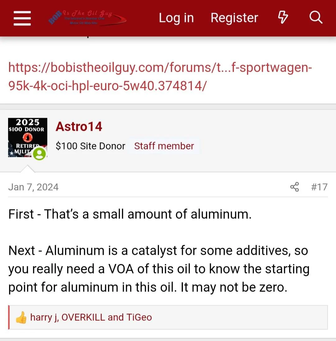

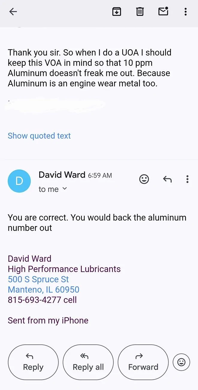

Wait, so $123 total or $20.50 per QT? Seriously??
There is NO way I'm paying that for an oil that has ZERO approvals or specifications.
Given your propensity to fall into paralysis by analysis, I am floored that you are...
Good luck!
Also this
Jeep Wrangler JL 5W 30 versus 0W 20 Screenshot_20250709_070716_Chrom

While it theoretically explains the aluminum, that does not explain the other components that were found, it does not compensate for zero approvals/certifications, and definitely does nothing to mitigate the cost.
This does not change my mind that this is a massively overpriced oil that has zero approvals or certifications.
Color me exceedingly skeptical that this "magic elixir" will facilitate engine longevity in any shape or fashion over any commercial off the shelf oil that has the appropriate approvals.
