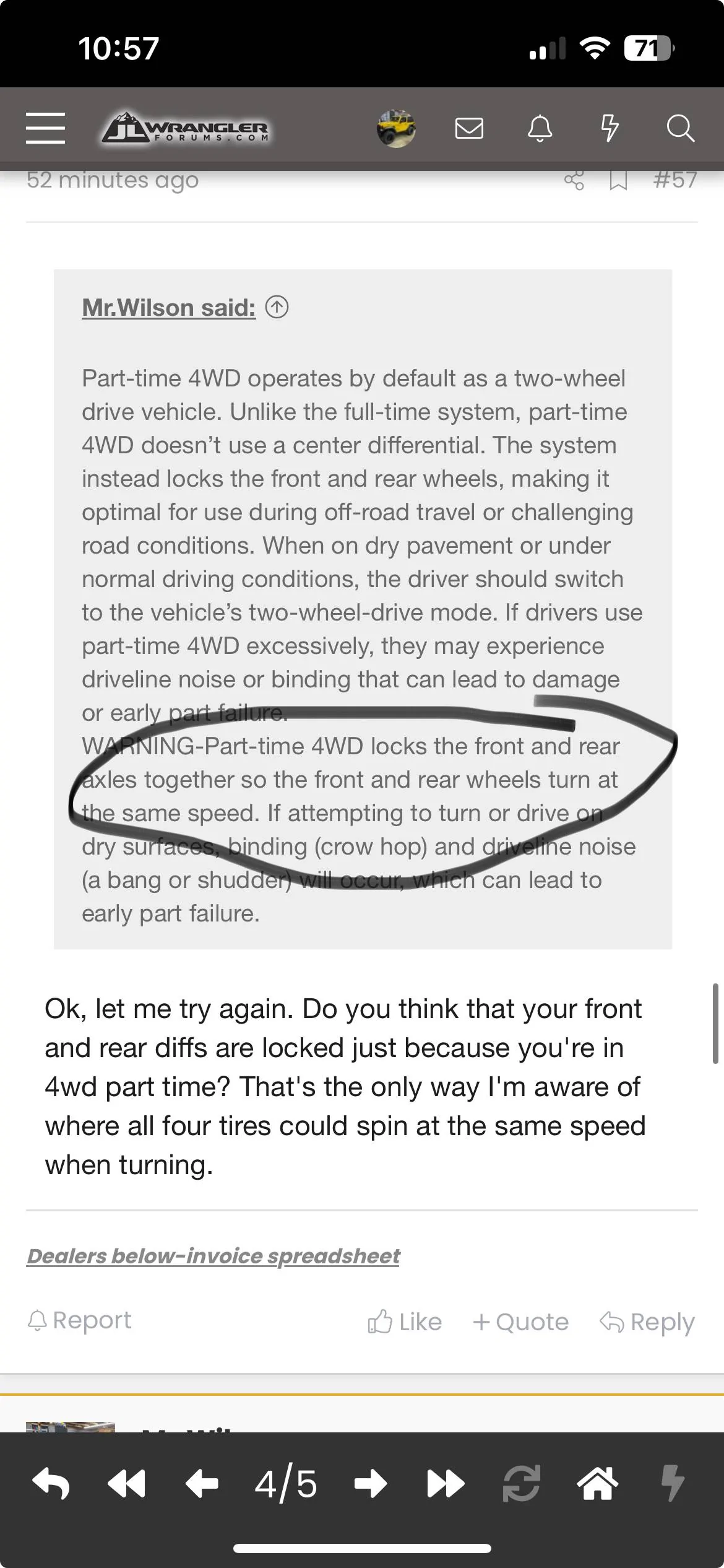

That's not what that explanation was saying. 4WD HI locks the front and rear DRIVESHAFTS together, so they spin at the same speed and transmit the same amount of torque. That does not mean that the wheels on the left side are getting the same torque as the wheels on the right, unless you have lockers like the Rubicon does. The diffs still transmit torque the way they do under all circumstances.
Jeep Wrangler JL 4WD Auto questions 1705678129040
4H Part Time locks the front and rear axels causing them to spin at the exact same speed.

We can agree to disagree all day but this is directly from JEEP. So maybe they don’t know what they’re talking about. Who knows.
You are reading more in that description than is actually there. That's a description written by a marketing team.
There is a clutch in your transfer case that manages the connection between your transmission and driveshafts. In 2HI the clutch is fully disengaged and 100% of the power produced by the motor through the transmission is sent to the rear driveshaft. That power is transmitted through the diff in a method consistent with the type of diff it is. But the ONLY time that that power is split evenly between both rear wheels is when a locker is engaged. From the factory, only the Rubicon is equipped with lockers, and they are engaged by the driver as needed. The front axle works the exact same way, so when you engage 4HI, that clutch in the transfer case engages fully and sends 50% of available power to the front driveshaft.
So again, the ONLY example where all four wheels are receiving the exact same amount of power is in a Rubicon with lockers engaged in 4HI or 4LO. If you are in a Sport or Sahara, the front/rear split is 50/50 but the diffs are distributing torque based on traction in a manner consistent with their design (so it depends on whether you have the LSD or the BLD diffs) The transfer case can only control the split between the front and rear driveshafts, it cannot do anything about the split between left and right axles.
No, you're acting like you understand all of this from reading the owner's manual. Sorry, but you're clearly mistaken if you think that engaging 4hi locks all four wheels to the same speed. You understand what lockers are, right?
Yes I do and if I’m wrong then im wrong. I’m just going by what I read. If it’s wrong then ok. Now I know.
Lockers do what you described from a left / right perspective. If that was in place with normal 4wd then turning would be stupidly difficult (and potentially damaging), especially with the fronts locked.

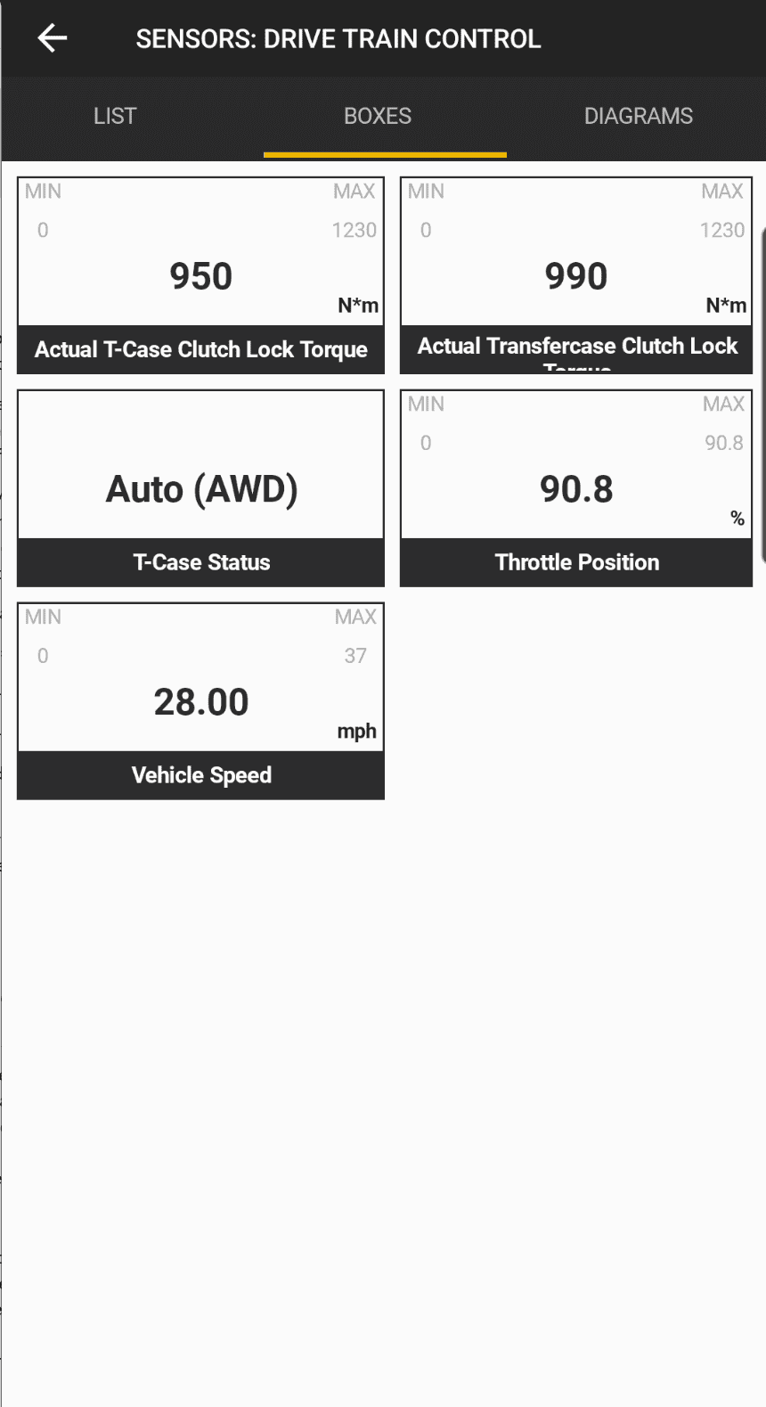

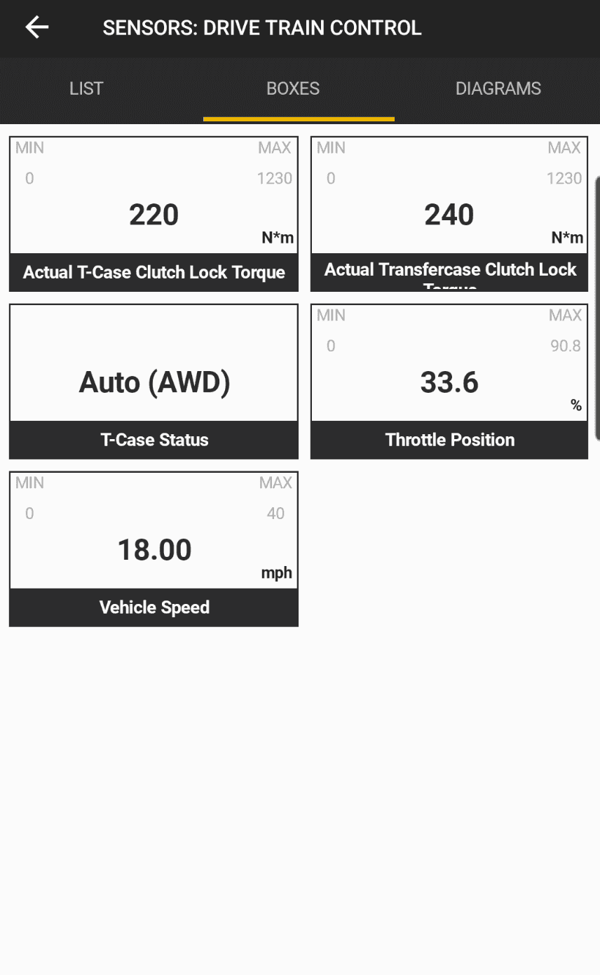

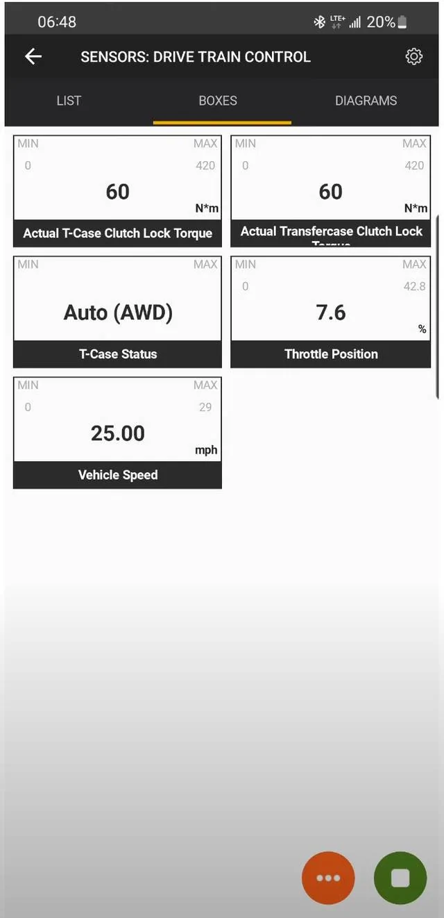

Jeep Wrangler JL 4WD Auto questions transfer-case_dtcm-4h-auto
Jeep Wrangler JL 4WD Auto questions DTCM-4-high-Auto-30-throttle
Jeep Wrangler JL 4WD Auto questions DTCM-4-high-Auto-50-throttle

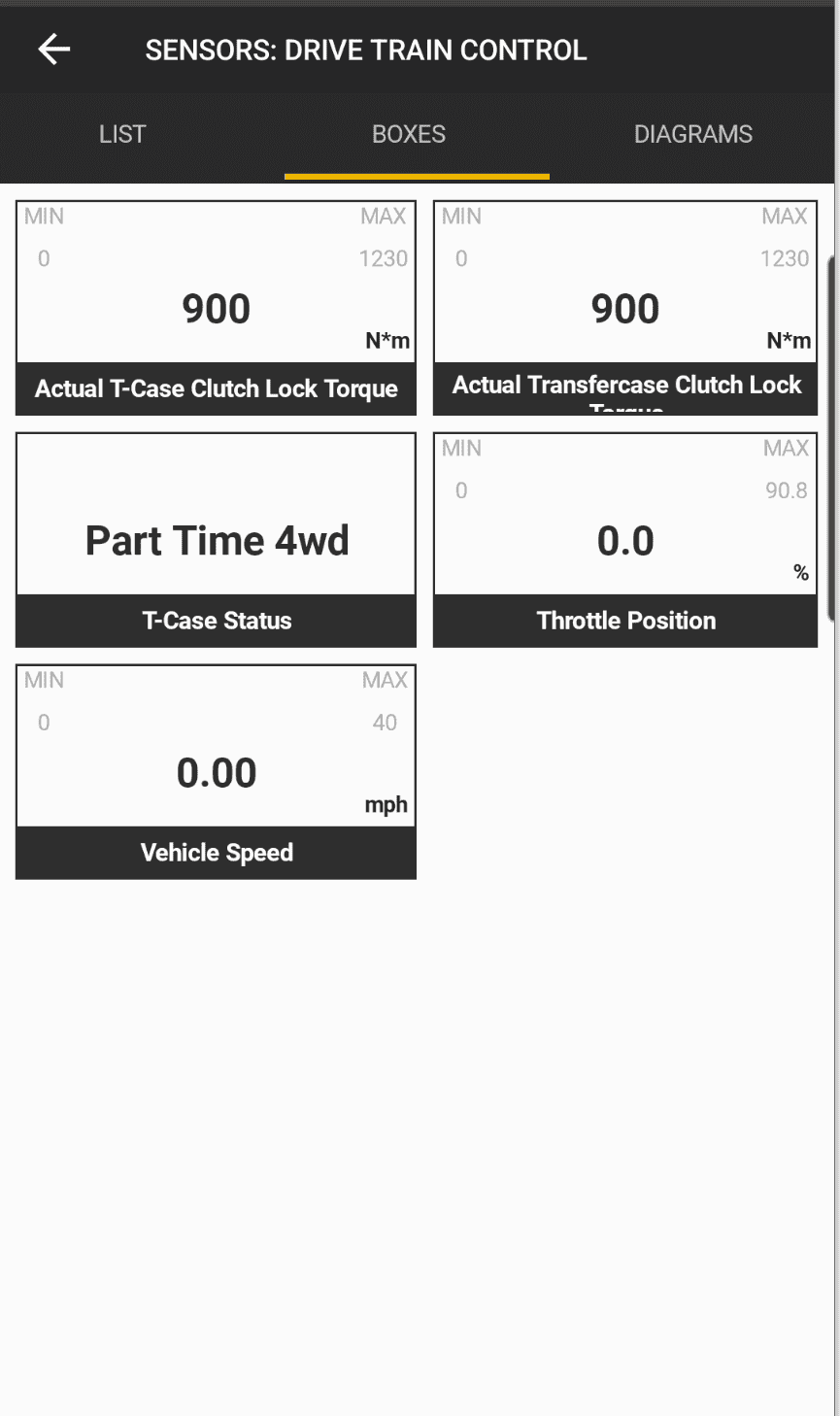

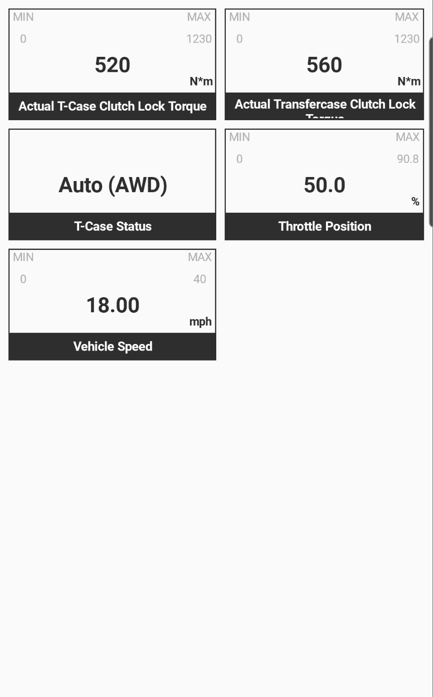

Under heavy throttle, the clutch get more pressure - regardless of road speed or wheel slip, etc.

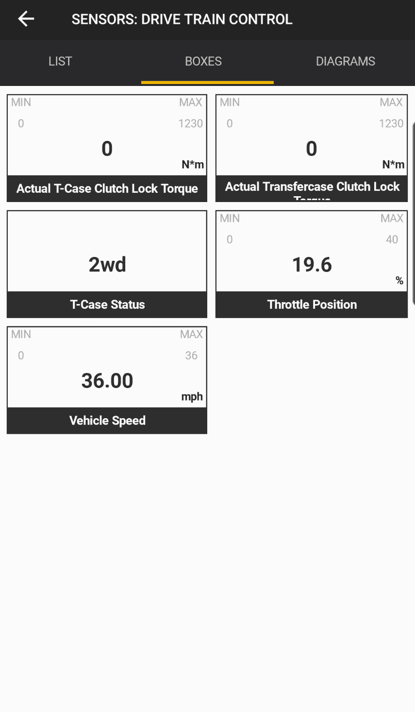

If you use 4HA in a 4xe and nail it you can feel a big difference between that and nailing it with it in 2H because the torque is limited unless you are in 4HA.
Jeep Wrangler JL 4WD Auto questions DTCM-4-high-Auto-WOT-throttle
Jeep Wrangler JL 4WD Auto questions DTCM-2WD
Jeep Wrangler JL 4WD Auto questions DTCM-4-high-prt-time
Jeep Wrangler JL 4WD Auto questions DTCM-4-low
somewhere I have another showing that when it's sitting, 0 mph, no throttle - the clutches are applied.
