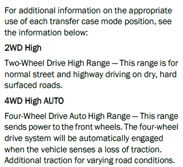

What's your owner's manual say?
Surprisingly silent:
Jeep Wrangler JL 4WD Auto questions 1705592003031
Most of the difference will be FAD engagement (if your 24 even has it), it's engaged in 4Auto, so more moving mass and a tad less fuel mileage is possible.
Looks like you'll definitely want it in 4 Auto tonight.
Yeah, it implies that he/she should be using 2HI on dry hard roads, but doesn't explicitly say it.
