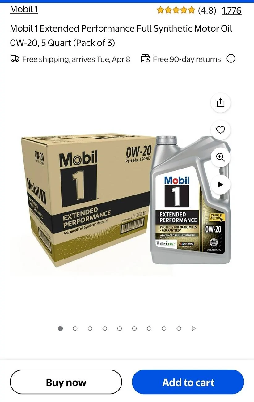

Walmart sells it in a nice Mobil 1 box 😋 They don't sell PUP like that.
Jeep Wrangler JL 3.6 l Engine Oil Type Screenshot_20250406_074431_Walmart
