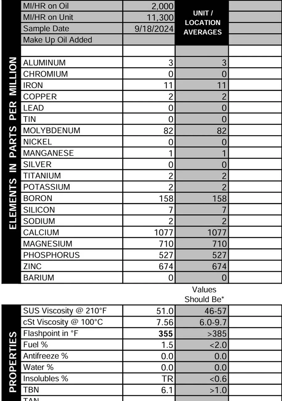

Their pup 5W30 VOA says 9.13, and then when I sent them a red line and asked them to confirm whether it was 9.0 or not, their report said 9.01. I feel like they didn't even bother to test its viscosity, they just confirmed it to me that is yes it's 9. I think one should give them the least amount of information, just send them the sample and say it is synthetic 0w20. Crooks 😡

Stupid BS Lab shook my confidence in PUP 0w20. Afrer 2000 miles its viscosity was 7.5, and that is a lie. Bdcause virgin it is 8.8
