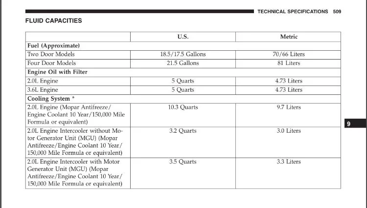

I’ve been looking through the manual -pdf version that I have - and done see where it says five quarts. I only see that it says to the fill line. That’s why I’m asking where. I don’t see it.
But I would think they would know. That’s why I’m surprised.
Look in the Index under Fluid Capacities.
Jeep Wrangler JL Engine oil type and amount 330F3572-8E9E-453E-869E-B1EABF966E32

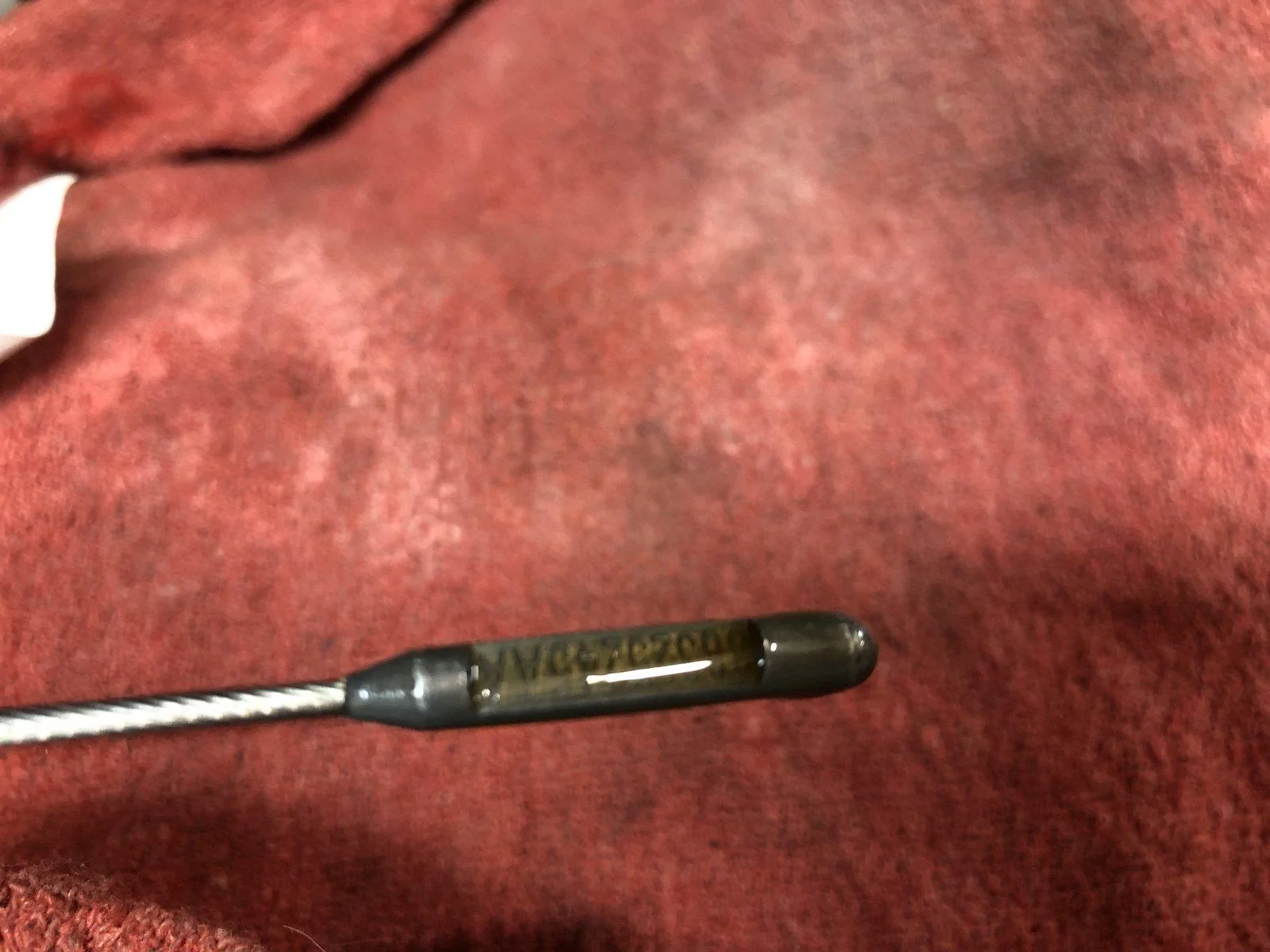

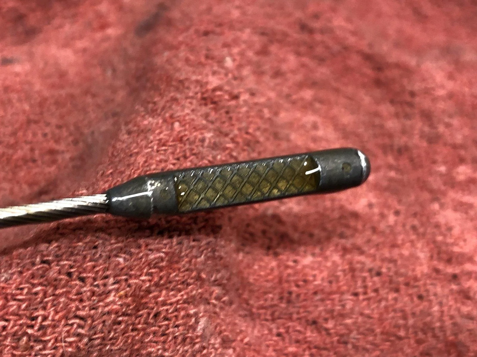

Please check it ASAP or have someone you trust do so. Overfilled systems can cause air bubbles/foaming in the oil and you don't want that circulating as well as slapping around the crankshaft. Just make it right if you really want to maintain your ride properly.
This is what 5 quarts should look like on the dipstick. No more.. no less.
This makes no sense. If you search the threads there are two factors - some people have reported putting 5 in and confirming the dipstick shows the oil is exactly to the fill line ie: 6 would make it overfull as the photo shows. Second - people are own JKs say the oil pan on the JL is distinctively smaller ie: direct evidence the JL only takes 5.

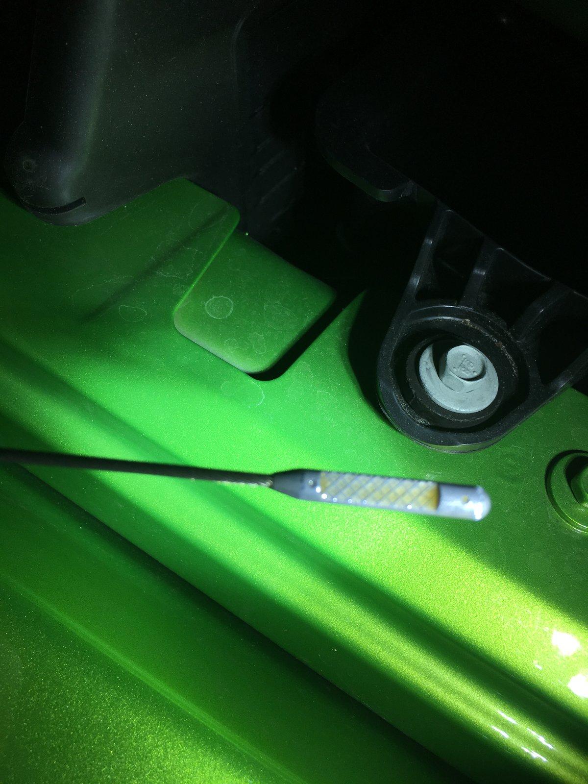

I dont understand how to read the dipstick as there are no markings.
If there are no markings. Kinda hard to see. May have to do in the light tomorrow
That is 5 quarts (I filled it myself) and the picture is a bit difficult to see but when you see it in person it is right at the end of the full mark i.e. crosshatch area maybe just a tad above. Others that have had 6 put in will be beyond the tip upper point and up the wire at some point.
Hope that makes sense. They are hard to see either way and takes a few pulls/wipes to get confidence. Best thing is to make sure it only gets 5. That eliminates any doubt. If it gets 6 it is way overfull.
First off, these dipsticks are terrible! Second - it is true what the manual says in that you need to check when engine is hot and after it's been sitting for at least 10 mins. I checked when cold (appeared overfilled) and checked after five minutes of sitting (underfilled). Second - always read the side with the lower reading. It should be around where the top dot is. If you can feel a decent amount of oil above the dot and going up the cable, it is overfilled.
Check it in the light after it sits for for a 1/2 hr just to be sure on level ground. Pull & wipe a few times rechecking till you are sure of what you see. It is not the best dipstick to see with clean oil.
Ok. This is very helpful. Thank you. I’ll try again in the morning and see what it is.
