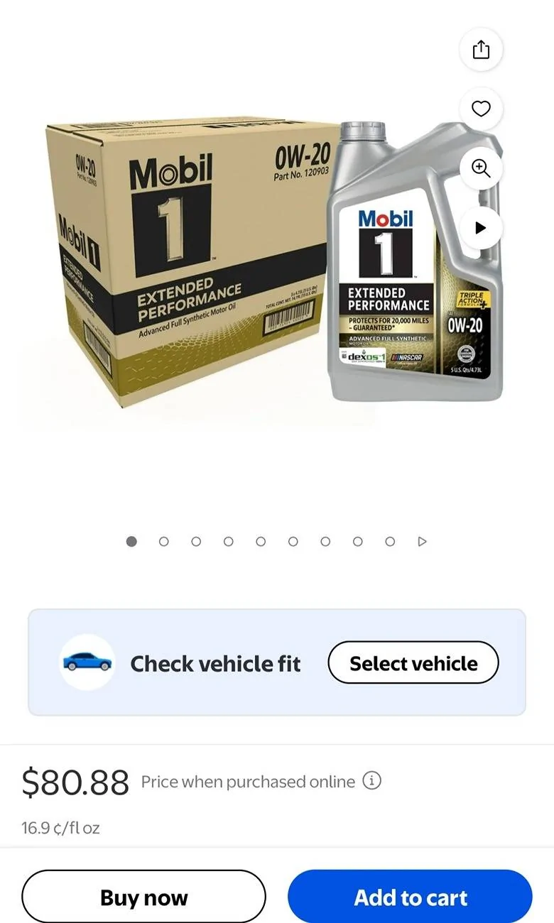

Hey, if its their best, how come they are giving it away like that?
Jeep Wrangler JL 3.6 l Engine Oil Type Screenshot_20250408_184050_Walmart
