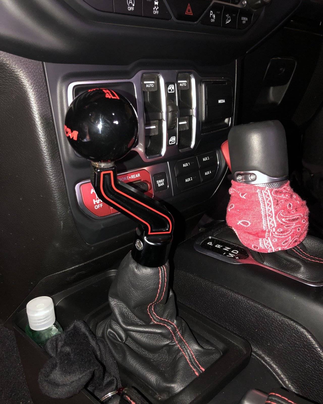

we use it several times every weekend, mine is where I can shift into 4 lo stopped and in neutral ( no grinding at all) easier than the conventional method of slightly rolling. Also I switched out the lever with the B&M shifter, a lot more leverage, it also makes it easier……
