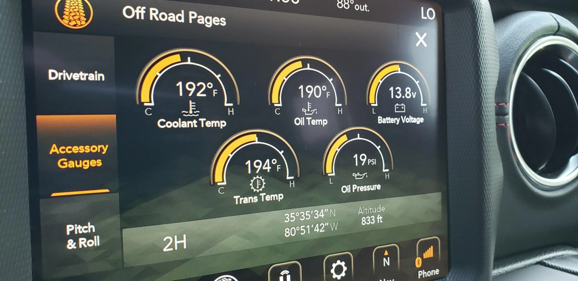

Jeep Wrangler JL 2.0T, how hot do you run? 20200718_115851
Just a light drive for fast food...

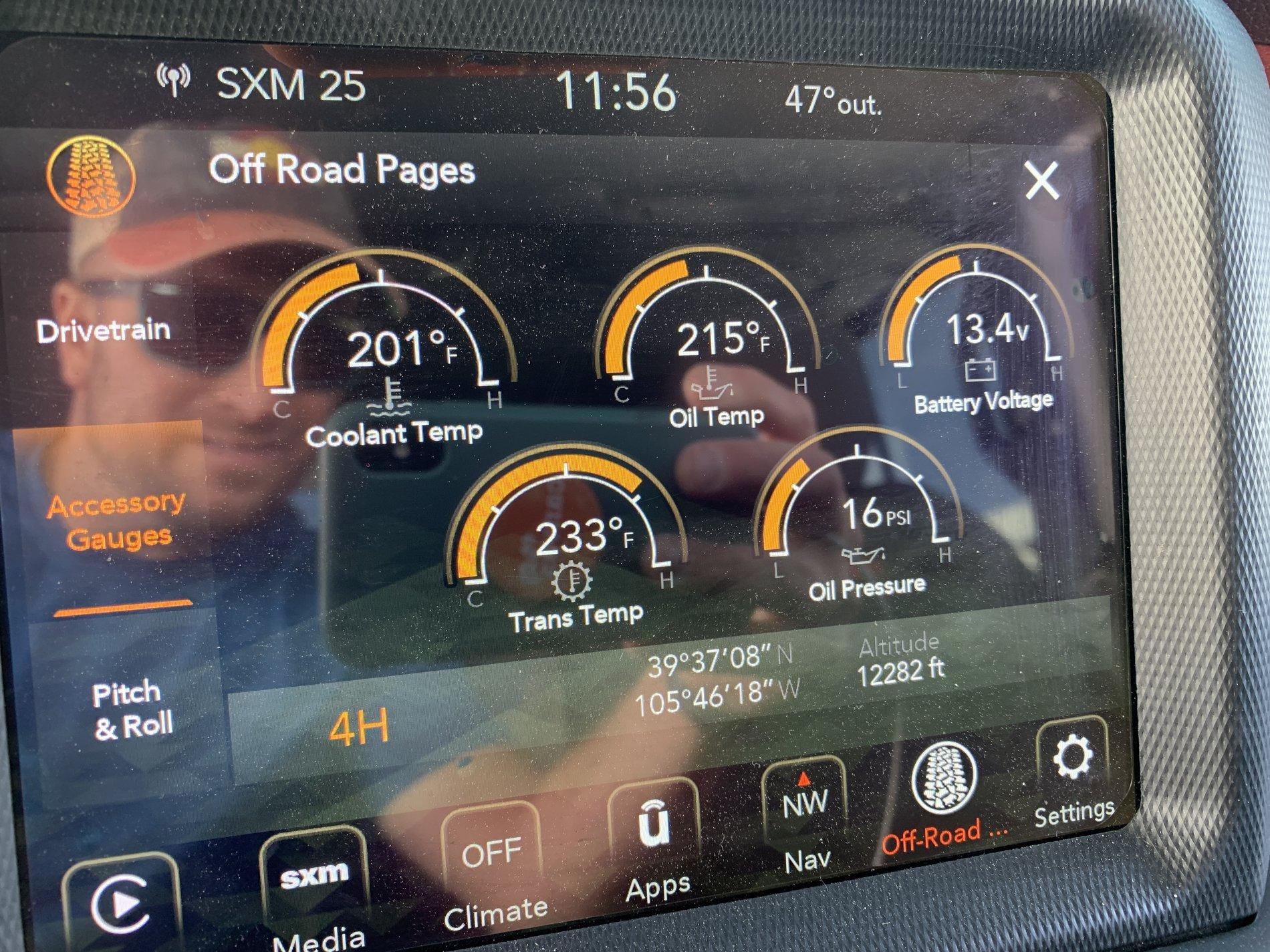

Went wheeling in the Colorado mountains today between 8,500 and 10750 ft. Going up hill in low range, occasional crawling, ran between 205 and 210. Downhill...about 199. - 195. I really like this motor.
