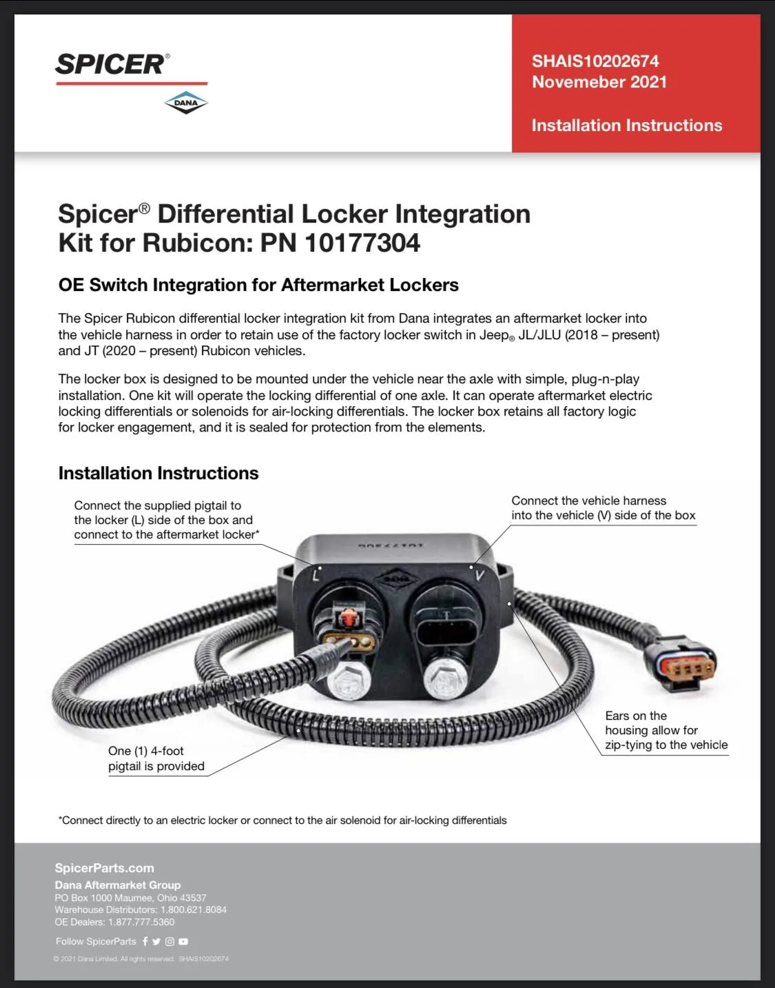

Spoke to tech support at Dana Spicer and they use the following part on each of their axles and it works with the UD60 axles. I believe those also use the Eaton lockers so maybe they’d work with other axle manufacturers as well. It’s a pricey part though. $400 and you need 2 of them. I’ll probably just get an A Pillar auxiliary switch and wire them up to that. Also, Dana said you need to have the Tazer to change the axle locker settings.
This part is now listed for anywhere from $750 to over $1000, depending on where you buy. You would need 2 of these for front and rear lockers. Rediculous.
