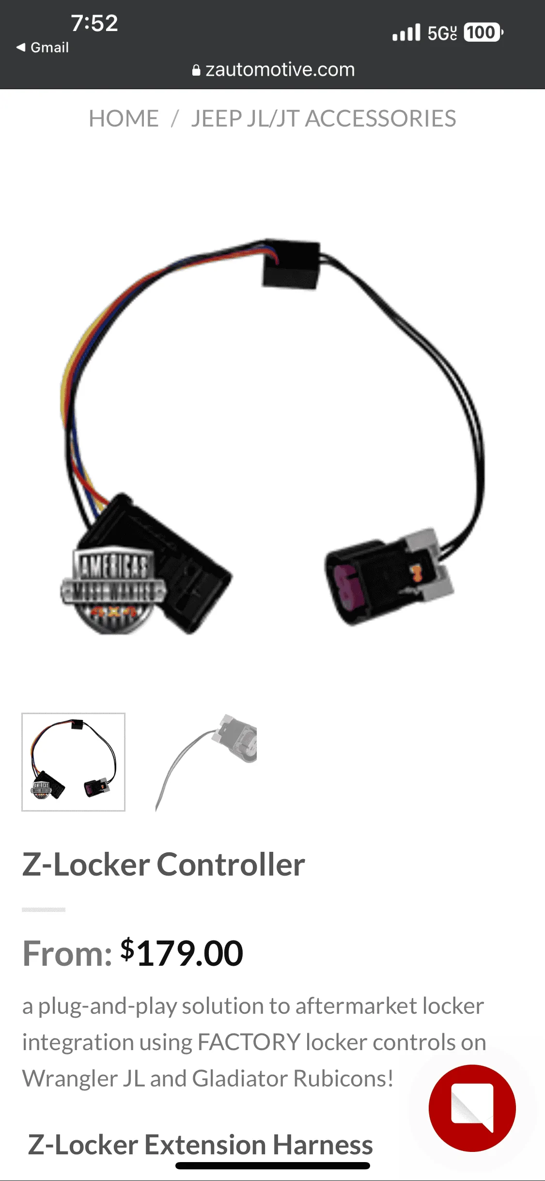

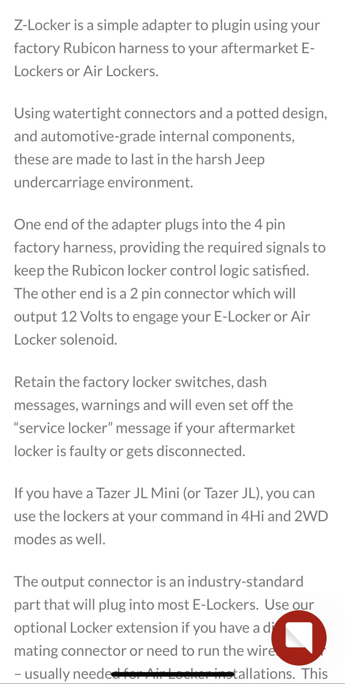

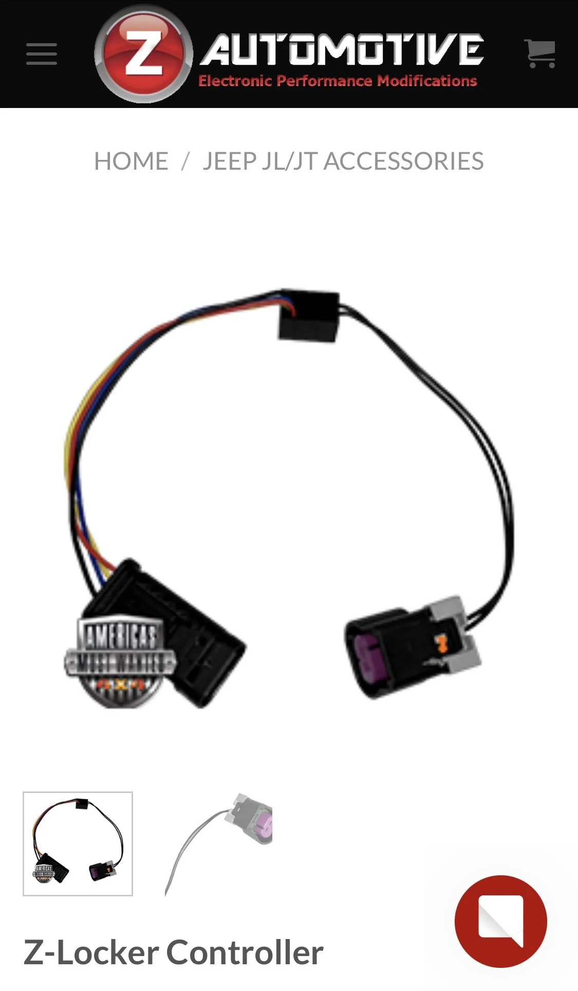

Looking into getting aftermarket axles and would like to use the factory locker switch.
Z Automotive has a product called Z-Locker Controller which claims to put out 12v for aftermarket lockers like the Eaton.
However, I’m hearing the factory system puts out a pulsed signal and not a constant 12v.

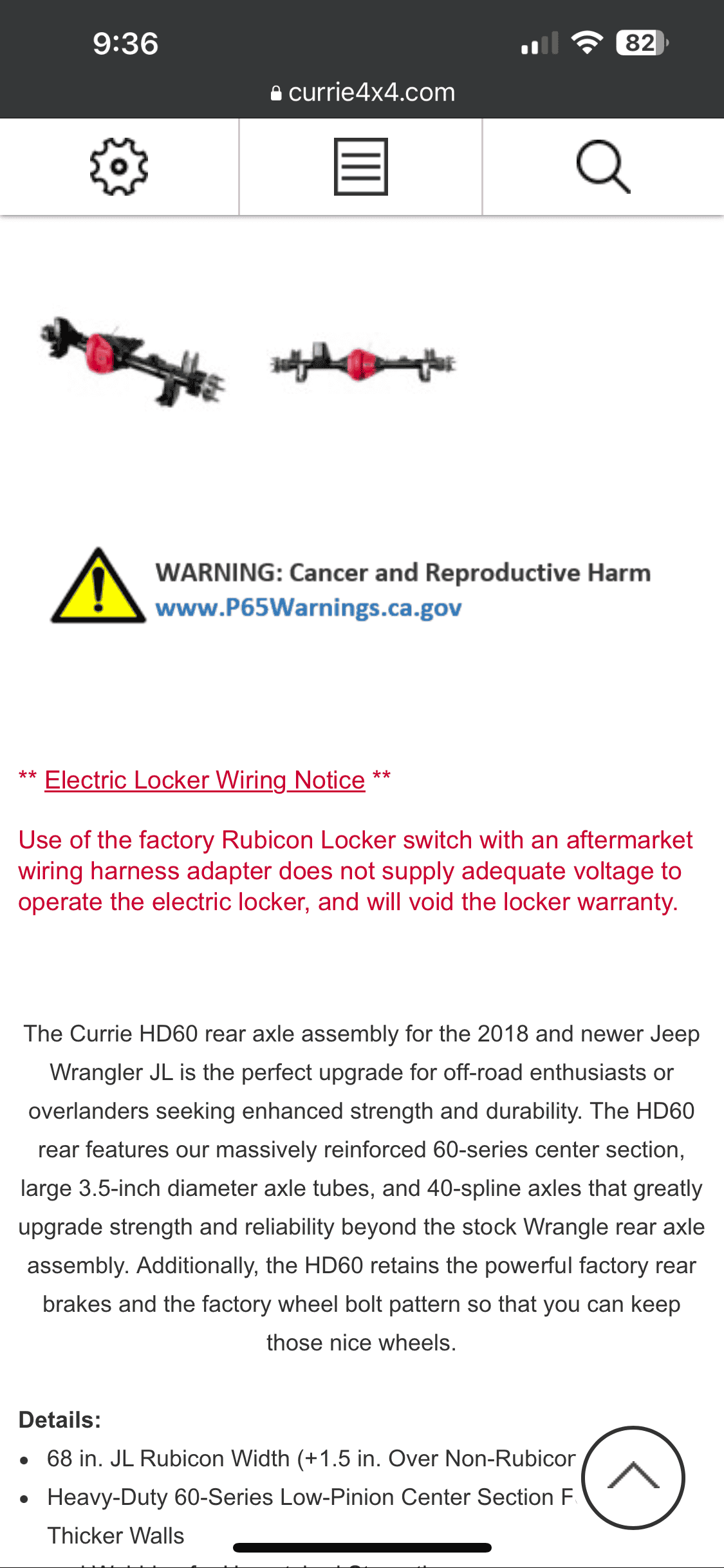

Currie even states that using an aftermarket locker harness will void the Eaton warranty.
Not sure if there’s anyone here with Z Automotive that can clear this up. Here’s some screen shots from Z Automotive and Curries website.

I was wondering the same thing. Dana, Dynatrac, Fusion all offer Eaton lockers but don’t mention anything about voiding their warranty like Currie does. I was also curious if the Auburn lockers work with the factory switch and Z Automotive adapters. Might be the better option.

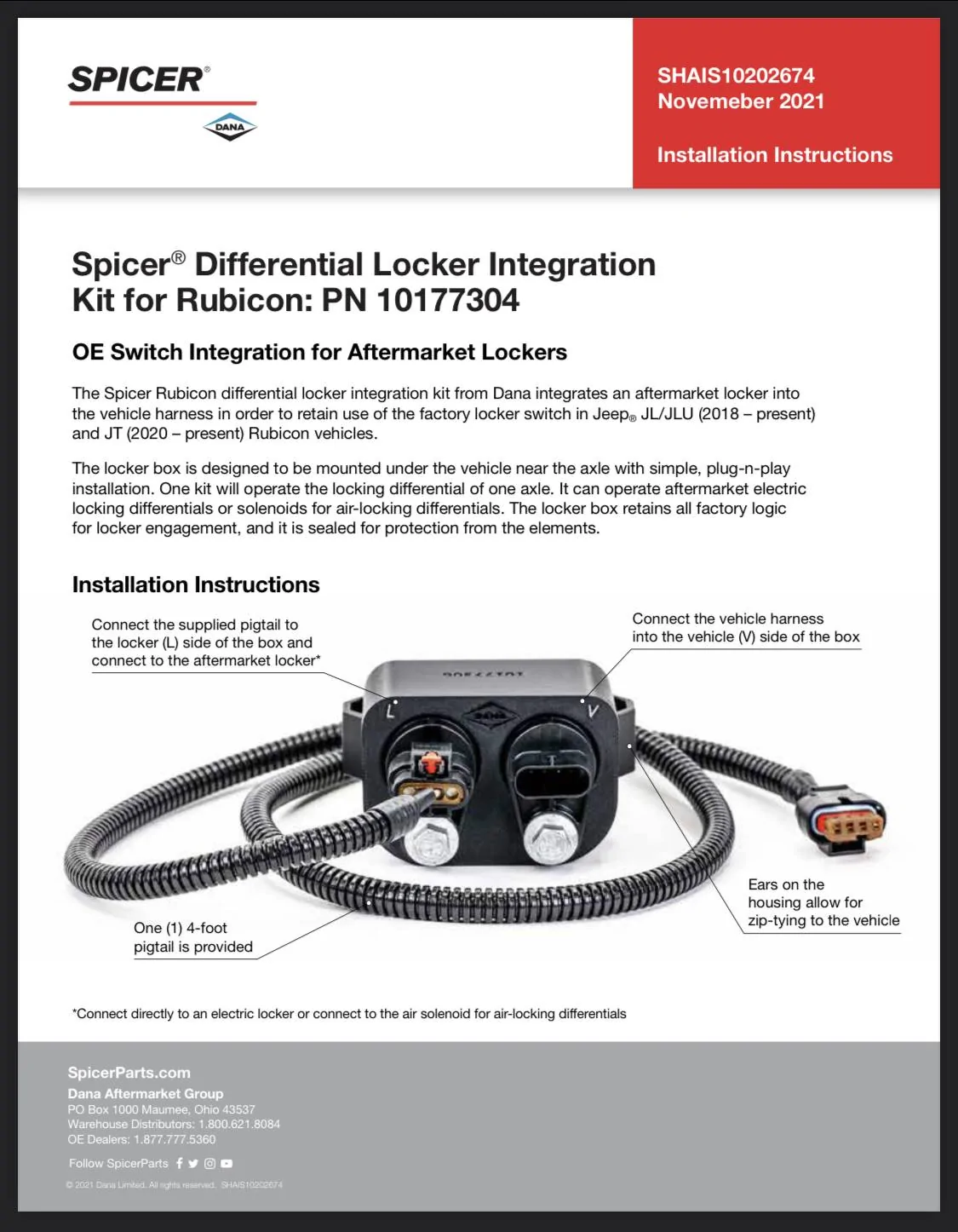

Z Automotive emailed me back and confirmed that they don’t have a product that can make aftermarket axles work with the OEM locker switch.
On another note I spoke to Dana Spicer aftermarket and they have a product that can make the OEM switch work with aftermarket axles however I can’t find any in stock for sale.
Does anyone have any experience with this product?

I think one of my buddies used these with his Ultimate 60's.
