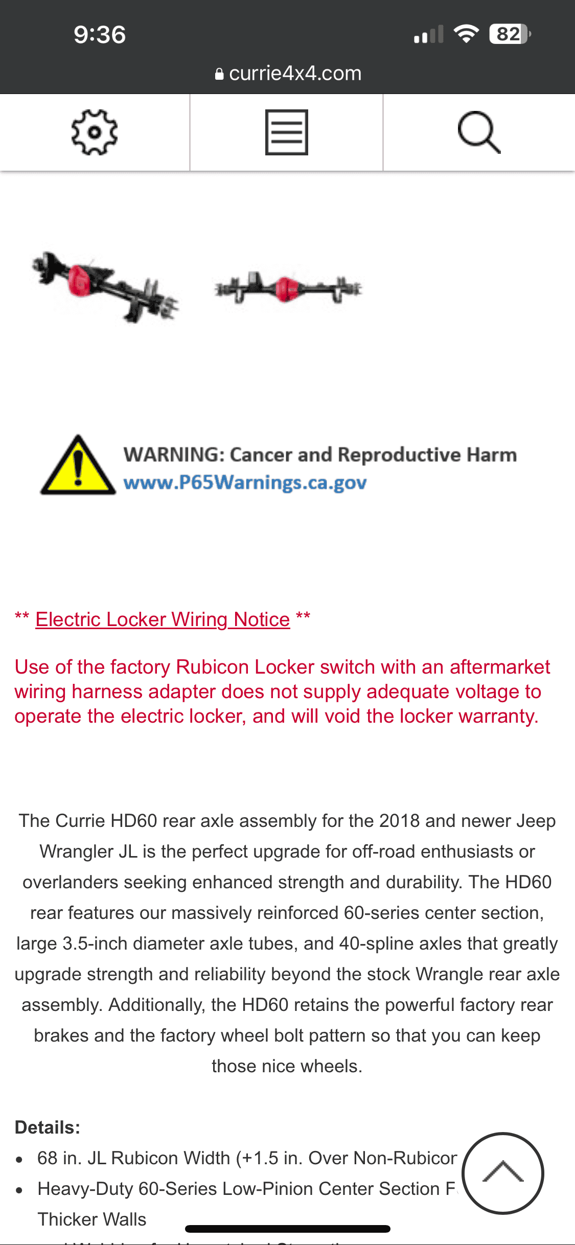

Right, I’m saying you should be able to use this with aftermarket lockers like an ARB no matter what axle they are in. You said z automotive said these wouldn’t work with aftermarket axles.
I’m not an electrical engineer. Not sure exactly why the ARB or an E Locker doesn’t like the pulsed signal vs a constant signal.
Currie says it won’t work and will void the warranty if used.

For what it’s worth, I recently swapped to Currie axles and investigated this as well. I spoke to Currie directly and they adamantly said not to use the z auto/similar device due to it being a pulsating current or what not. I ended up wiring to Aux1 and AUX2 for the lockers. I run a compressor and some lights so I’m running an spod for those. Yes, it would have been nice to retain stock switch, but it’s just as good on the aux switches

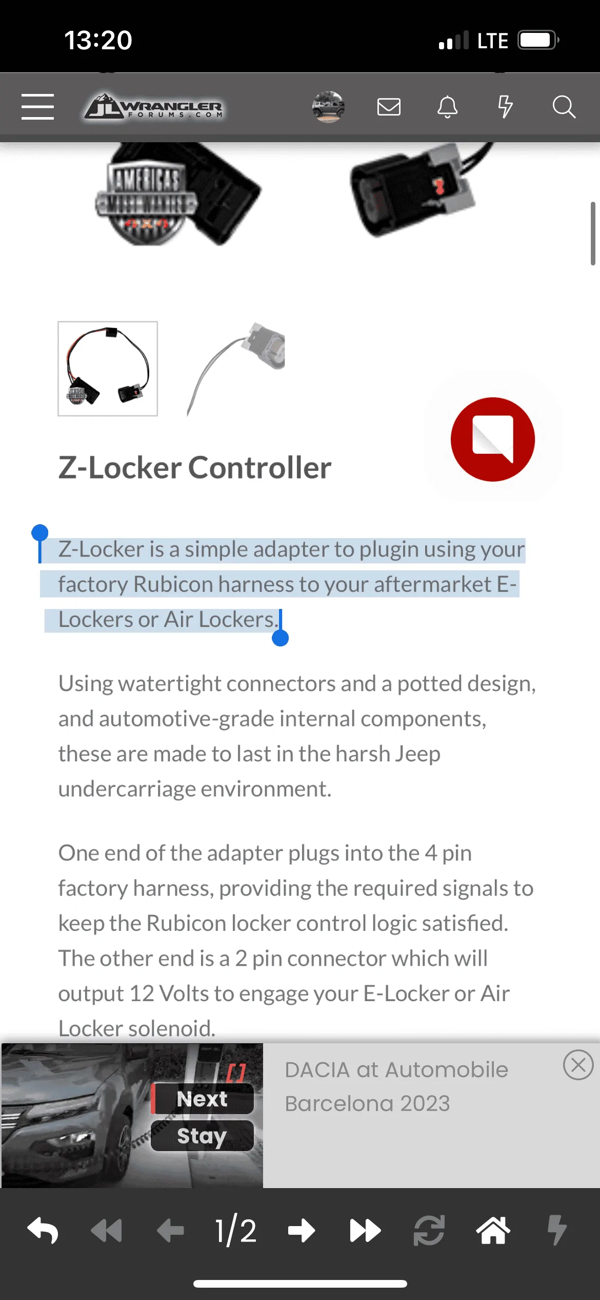

I think what we are questioning here is why Z automotive would manufacture and market a harness to do exactly this (oem switch with aftermarket lockers, whether in a d44 or d60), and then later identify in an email to you that they do not have a product to do this.
Something isn't adding up. And presumably AMW is using this to connect UD60 E lockers up to oem switches without problems.
I’ll give them a call to verify if that’s true. Thank you. That would really help.

I have dynatrac 60s with the elocker and I have been using the Z-Locker Controller for years. I don't recall having issues with them engaging/releasing.
What switch do you have them wired to?

This is the part that is confusing. Z Automotive sells two versions. One is to overcome a factory differential sensor failure and the other is directly designed to allow an aftermarket locker to communicate with the factory switch. It clearly states that in the description. I have heard others mention like the above post that they have had success using the adapter. I also don’t understand why the other manufacturers aren’t saying the same thing. Especially Eaton, who doesn’t mention it anywhere on their site.
Exactly and why is only Currie saying it won’t work. What about Dynatrac and Dana? (Doubt Dana would say anything)
