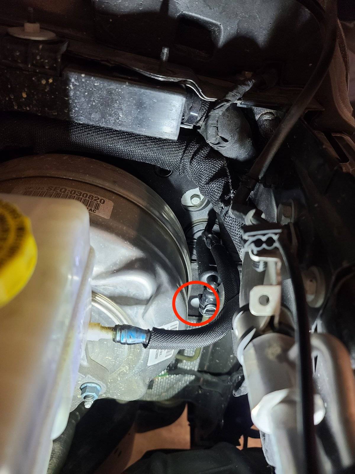

Hey, all
I was recently trying to run power from the battery to the rear cargo area and came across another firewall access hole for the Manual Transmission folks. It's on the driver's side beside the brake booster but NOT the hole used by the clutch. Circled in red in the first pic with the grommet still installed (but a little warped because I re-installed it to take the pic).

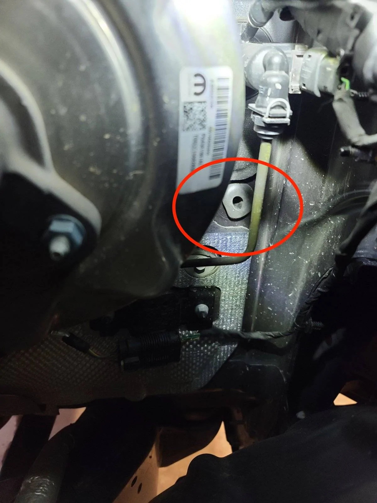

Here it is with the grommet removed and you can (barely) see the white foam behind it:
Jeep Wrangler JL wiring through the firewall 20210415_150812

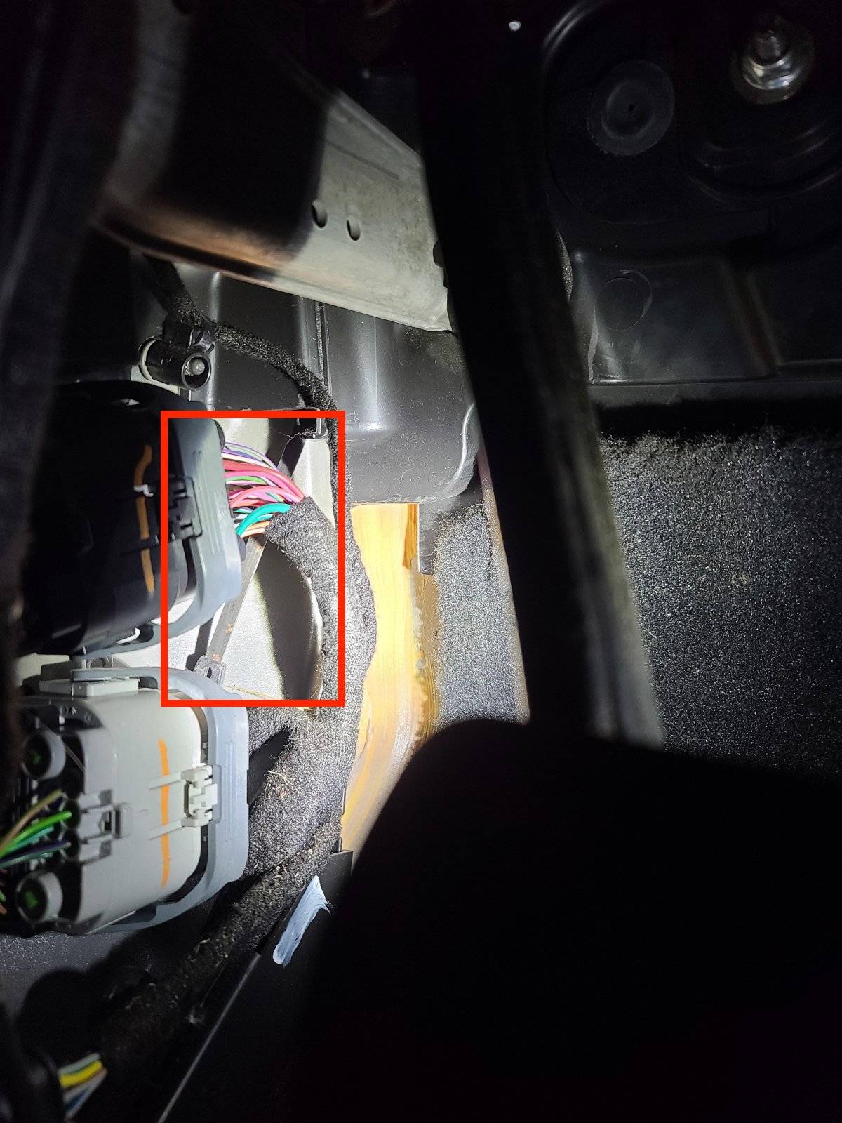

and, finally, a pic of under the dash where my fish-tape is coming out from behind the plastic in the far corner of the footwell. This is with the trim/kick panel removed:
Jeep Wrangler JL wiring through the firewall 20210415_160256
Hope this helps!

Oh, and for reference: I ran (2) 8-gauge wires through this hole with plenty of room to spare. Was able to use the factory-installed grommet as well (although soapy water made that easier)

Do you have a soft top? I have a '21 MT with hard top from the factory, and it looks like that grommet is used for the washer fluid tube to the rear window. Was hoping to be able to use your idea :)
Unfortunately, I do have a soft top... I wonder if you can still use that spot, though and just piggyback off the washer tube?

Ultimately for my project I settled on using the tube on the passenger side, but without removing the battery or fuse panel...spent an hour yesterday trying to fish a power wire through and no success yet, but I did cut the nipple off the tube so it's open...so close.

Any tips trying to get it to pop out in the footwell? I think I’m getting stuck i side the firewall or behind a plastic panel.
Edit: Got it after a beer break. Thanks for this post, I have a manual and needed to pass some 4 AWG through on the driver side.
