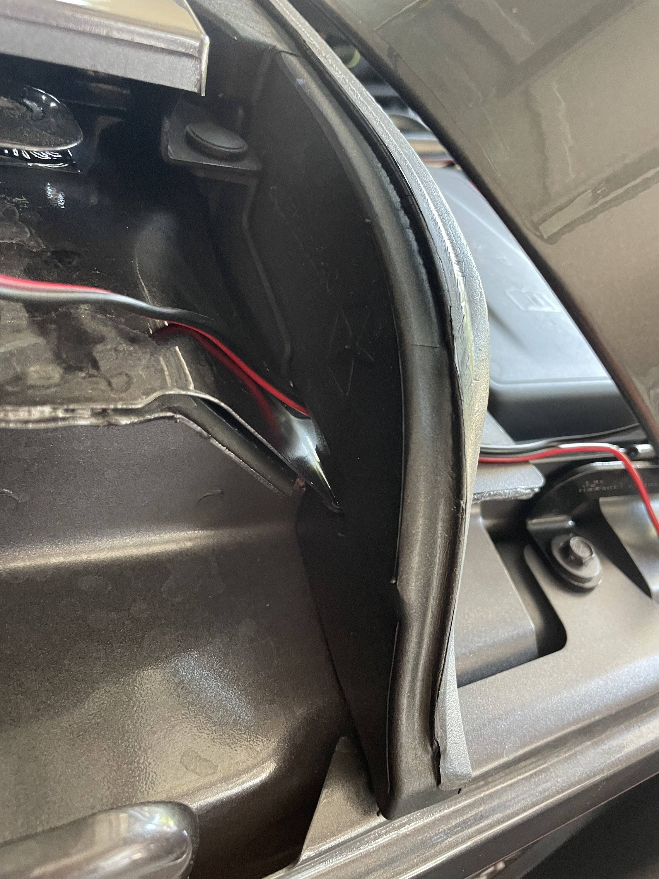

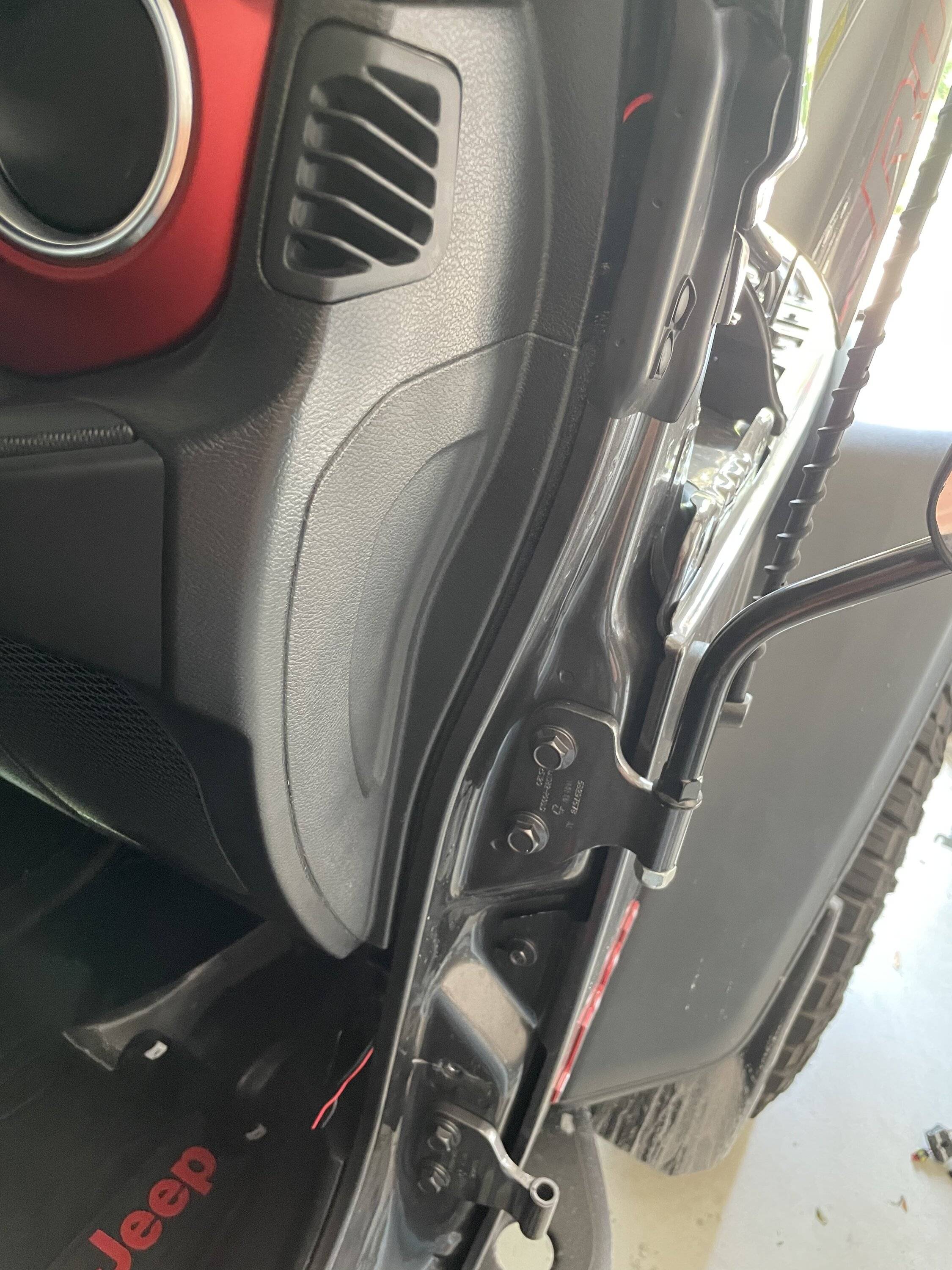

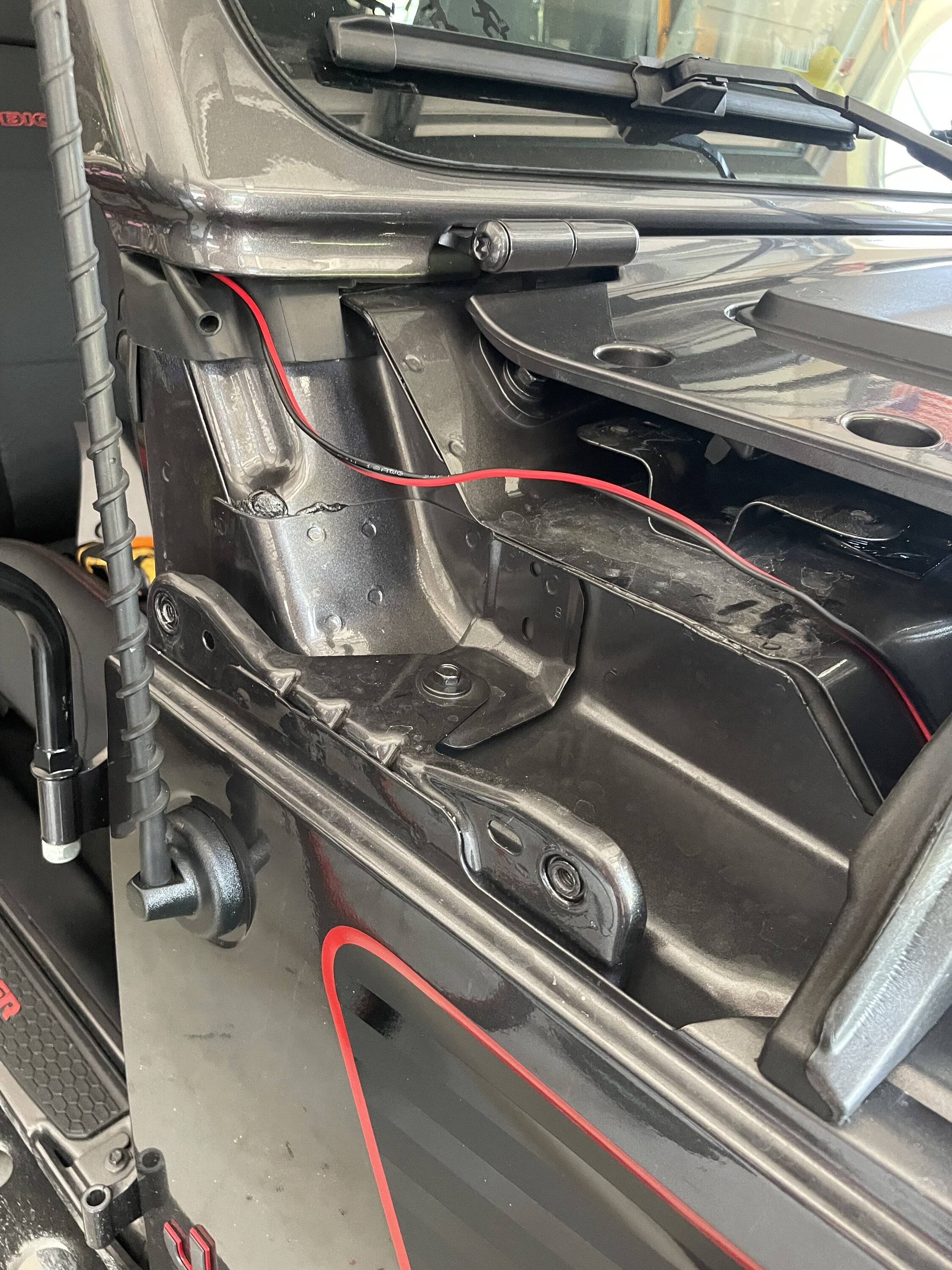

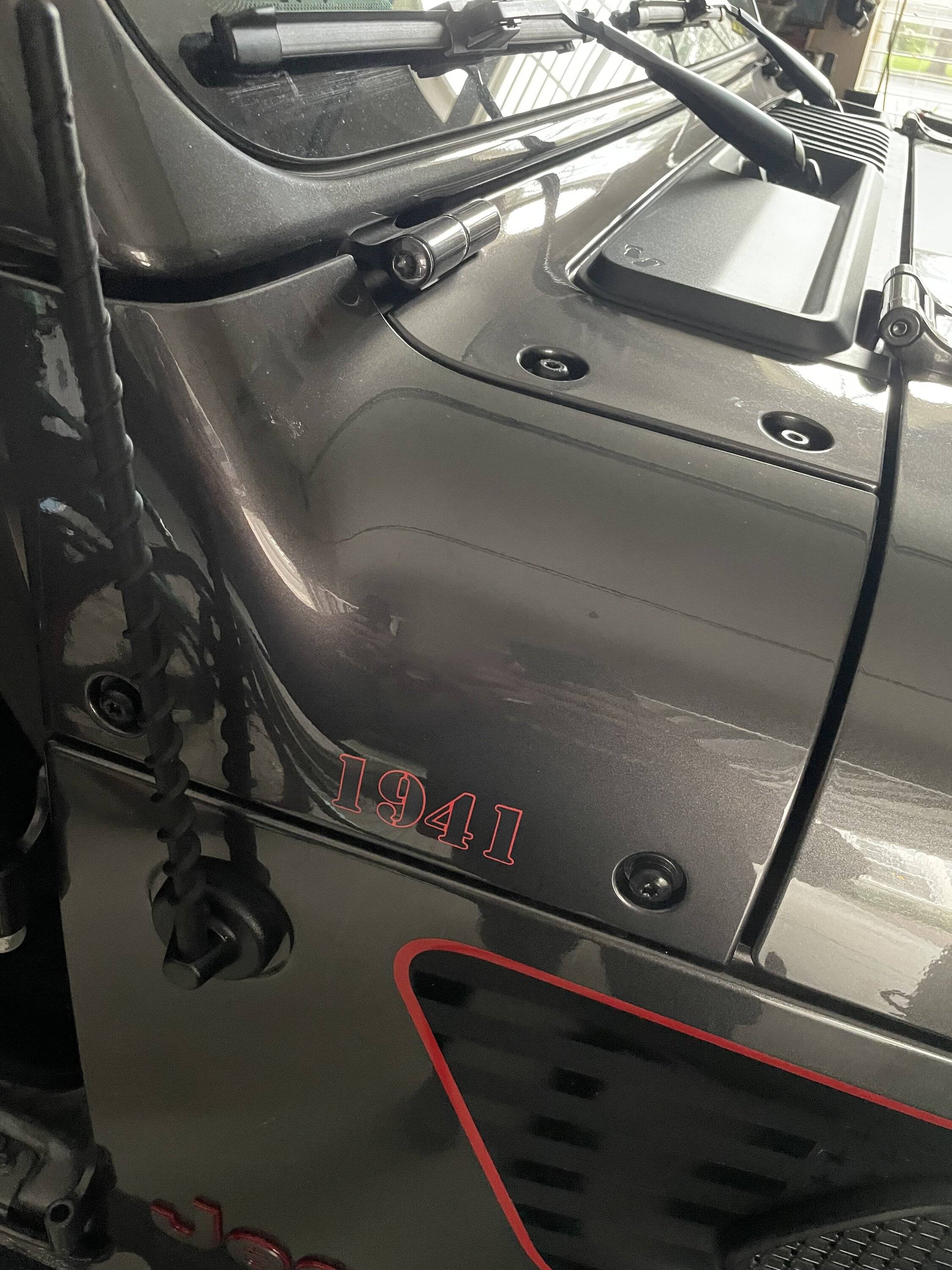

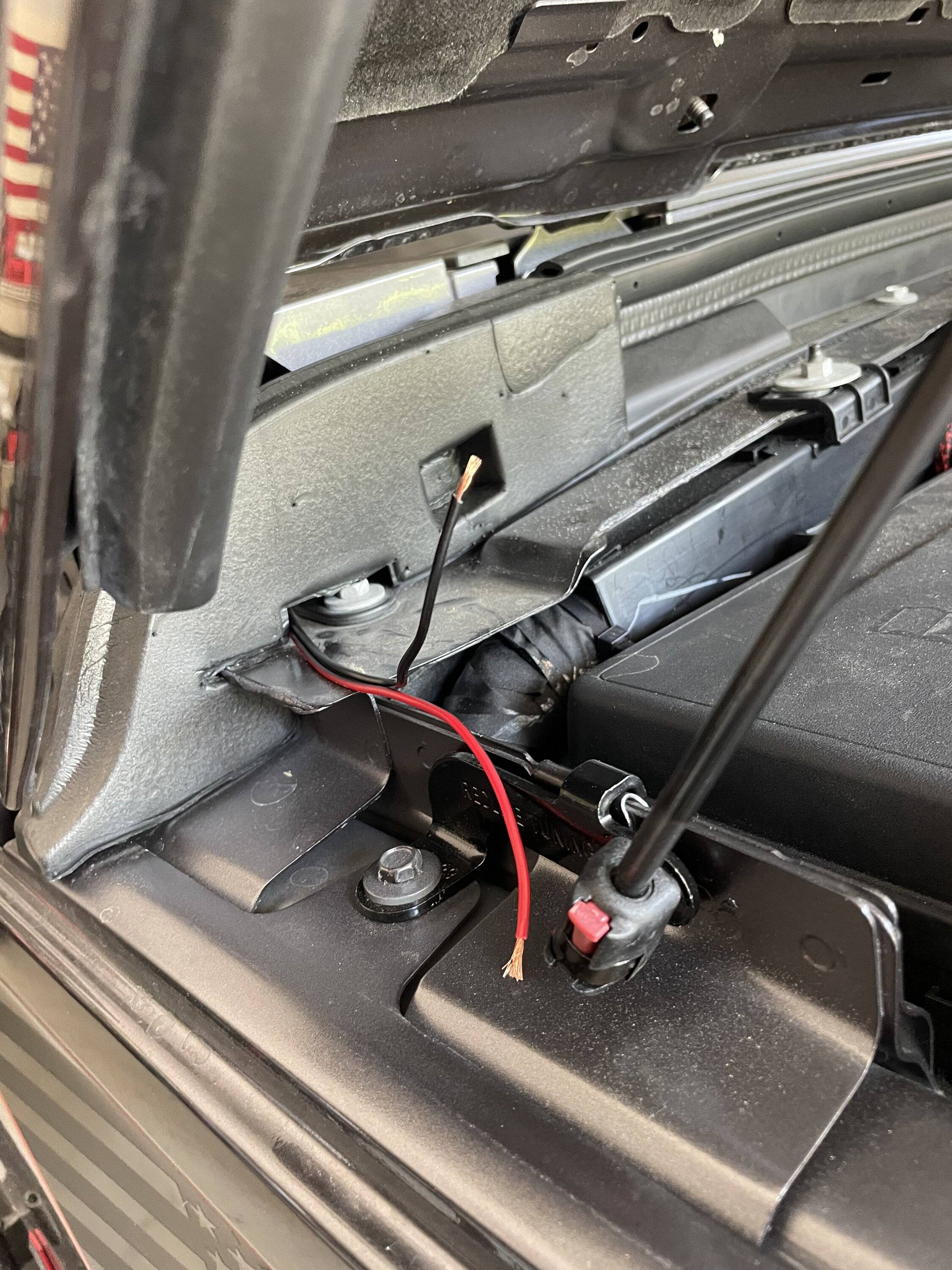

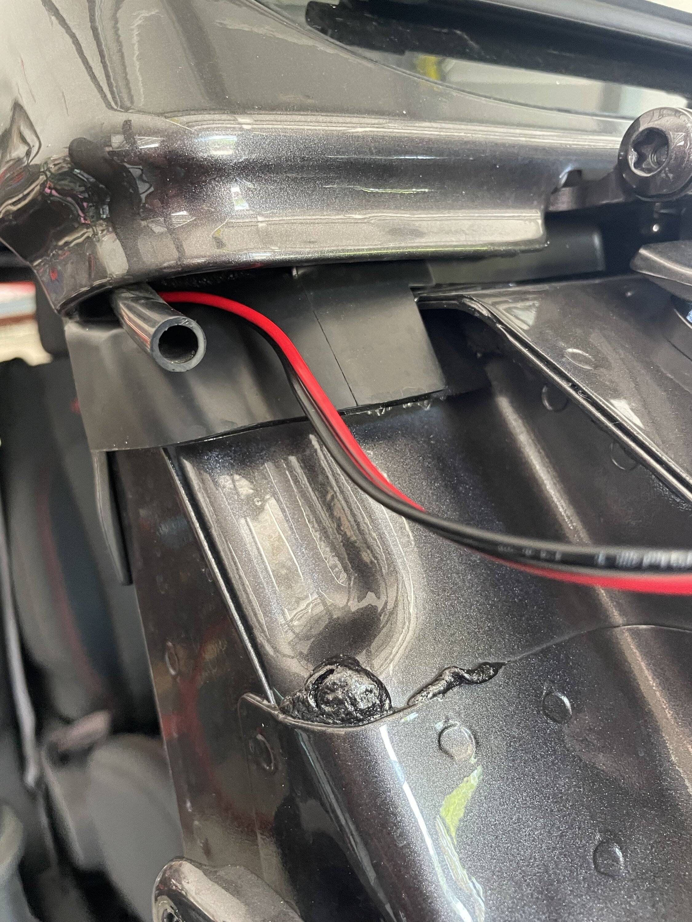

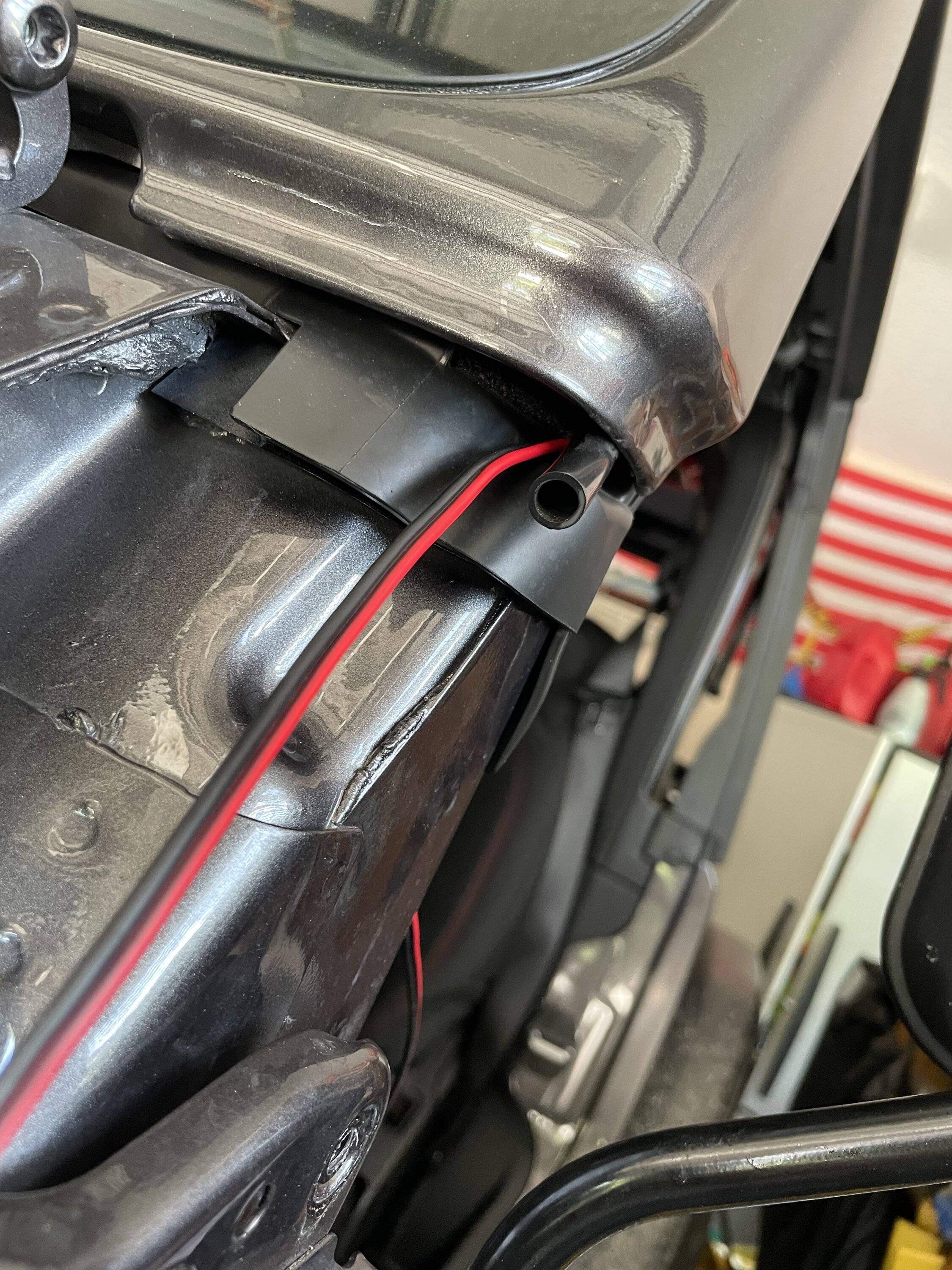

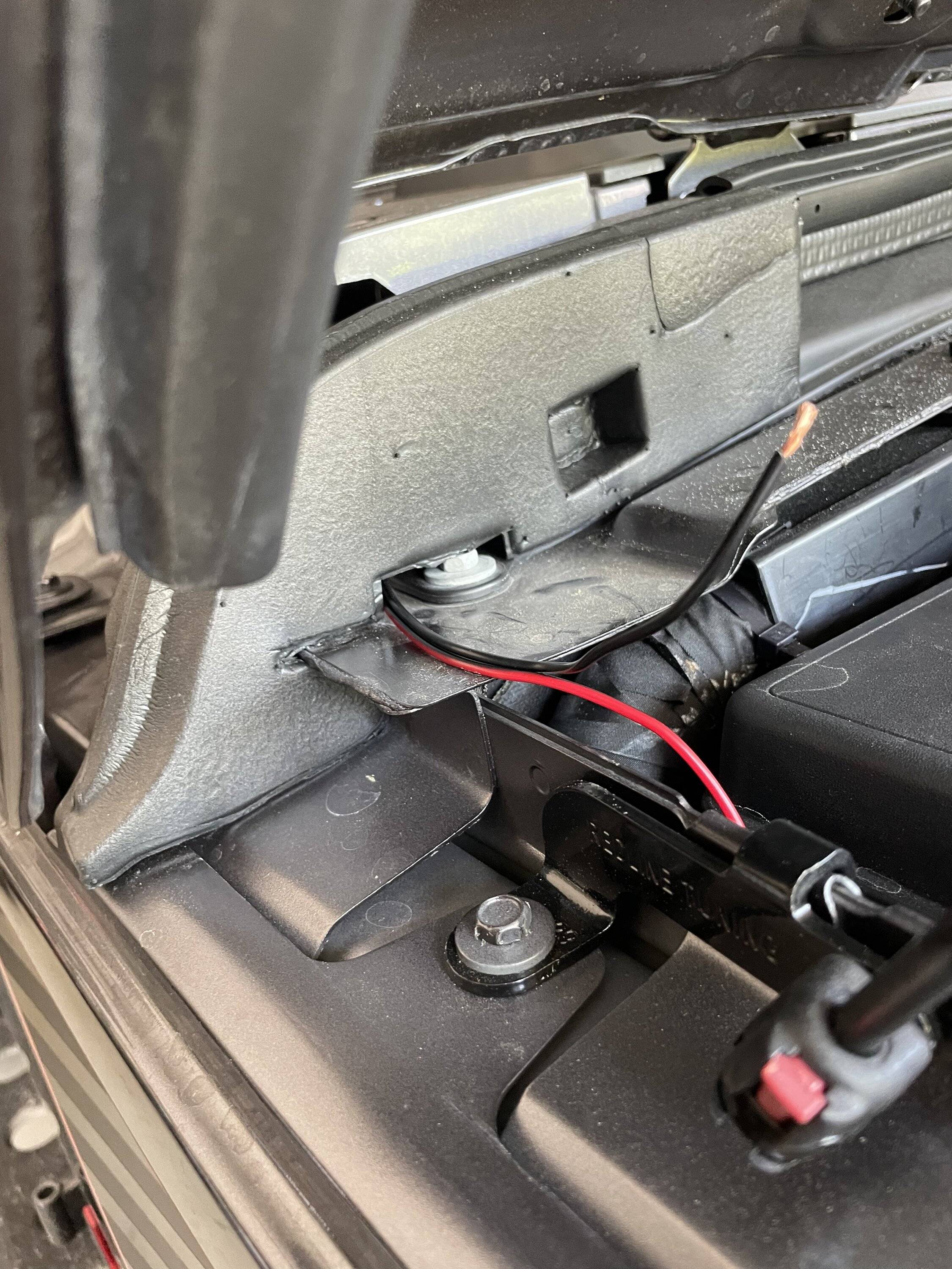

Well, actually, OVER the firewall. So easy, had to run wires to add turn signals to side mirrors. Removed this hood trim panel and poked around, was easily able to run wires from turn signal bundle in fender well, up over firewall and under windshield. There’s gaps on both sides of car. Then ranwires behind knee trim panel to connect where door harness disconnect is.
