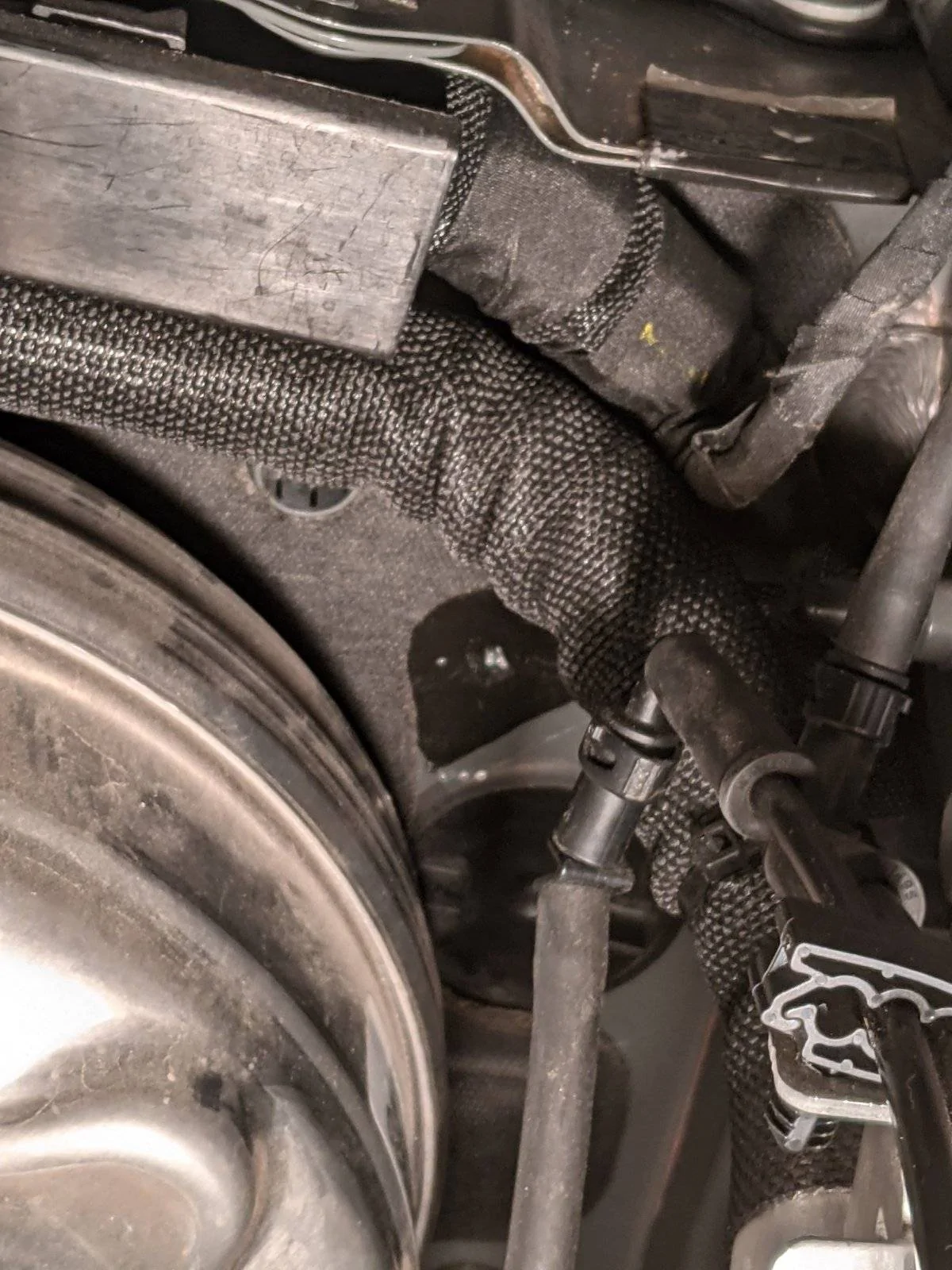

You should have plastic cap on an opening on the driver side. I do in my 2020 jl?
Jeep Wrangler JL Getting Through Firewall on Driver’s Side (MT)? PXL_20210109_230140289
This is the view with hood up and looking at the area in front of driver side dash and footwell.
Thanks. I’ll look for that. If so I guess I can just drill through it and then seal it?

That's where your clutch master cylinder sits. I just drilled through in that general area (a litle below the master cylinder) to pass my wires. It is double wall, so a bit of a pain. I inserted a grommet and used rtv to seal it up

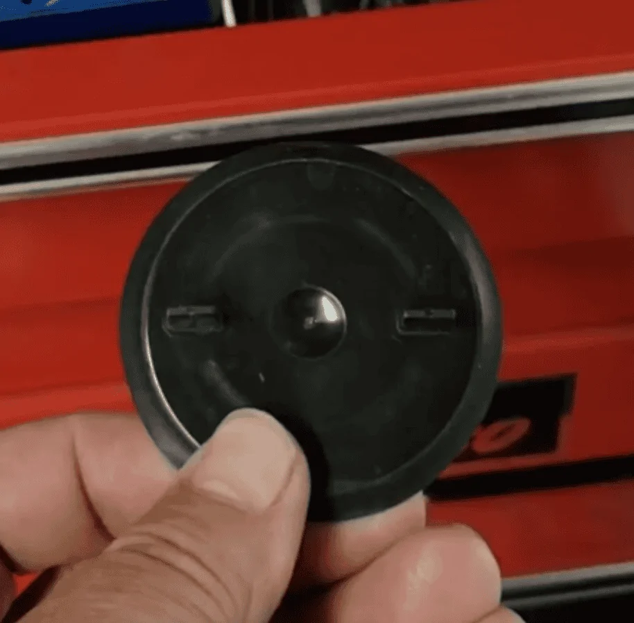

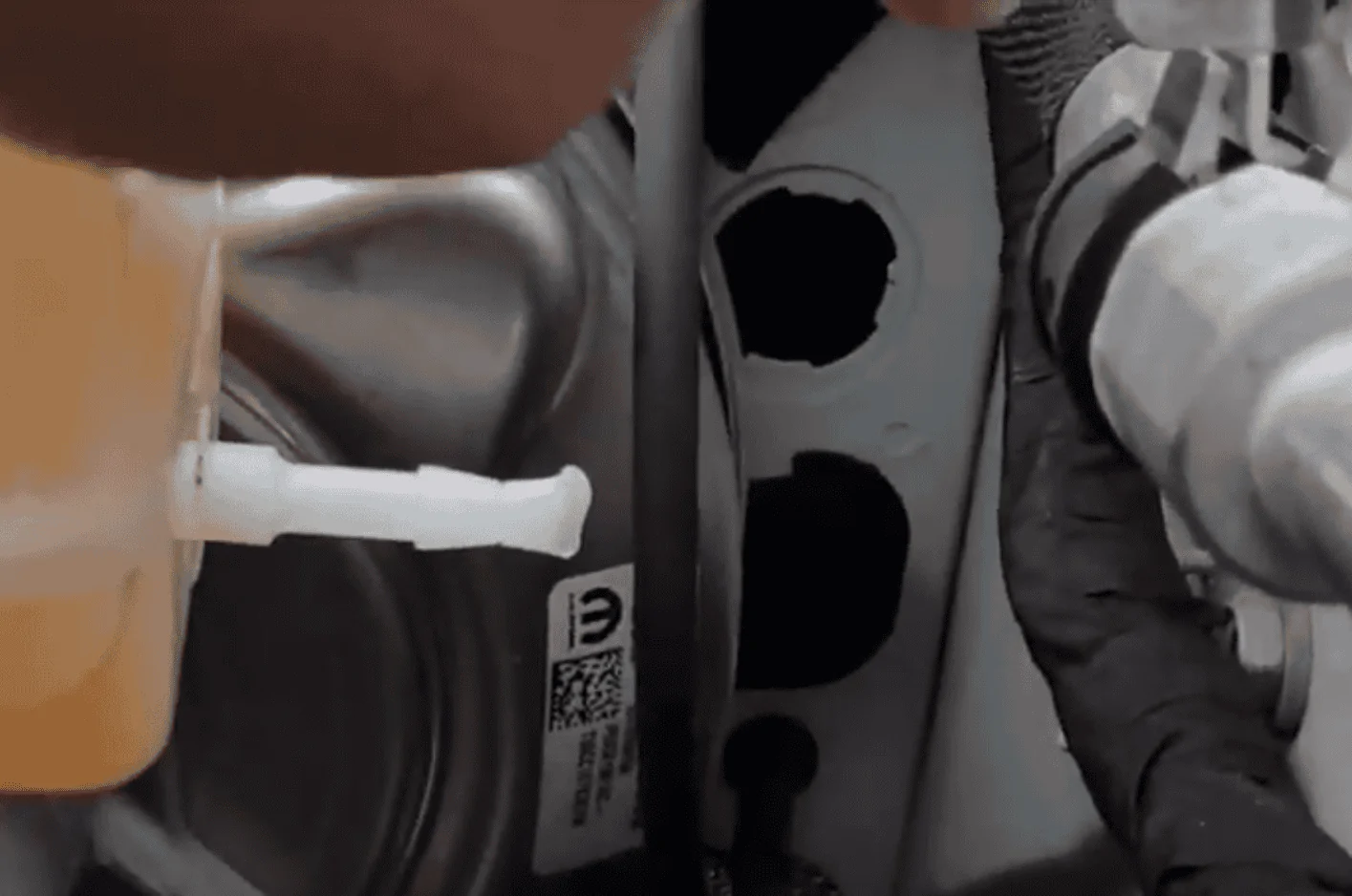

@safety_glasses
IF you have an automatic tranny JL, you will find a removable plug on the driver's side firewall.
On the inside of the JL it is right where the clutch pedal hardware would come through.
The part number for this plug is 68336758AC PLUG-DASH.
You can easily remove the plug and drill holes it in to pass wire(s) through. Pops back on easily. Be sure to seal up around wires well with silicone.

How do you easily remove that plug? I’m trying from the inside but can’t get it to budge.
