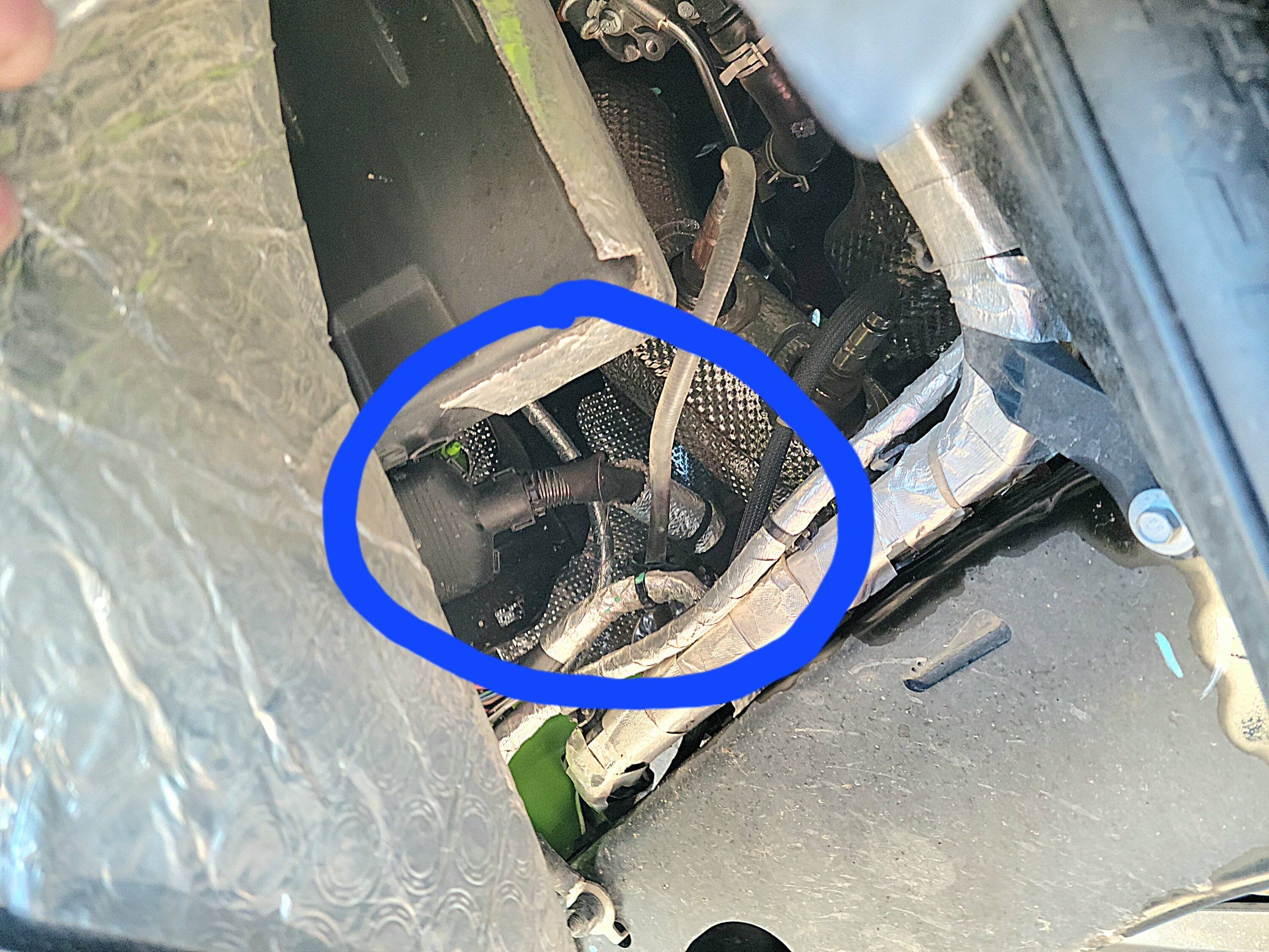

Jeep Wrangler JL Wire harness rubbed through 20221127_093921
It's this wire harness behind the passenger fender liner. Im going to zip tie it up from here. The other picture is looking up by the passenger side front control arms. The wire rubs on the flange of that smaller exhaust pipe on mine.

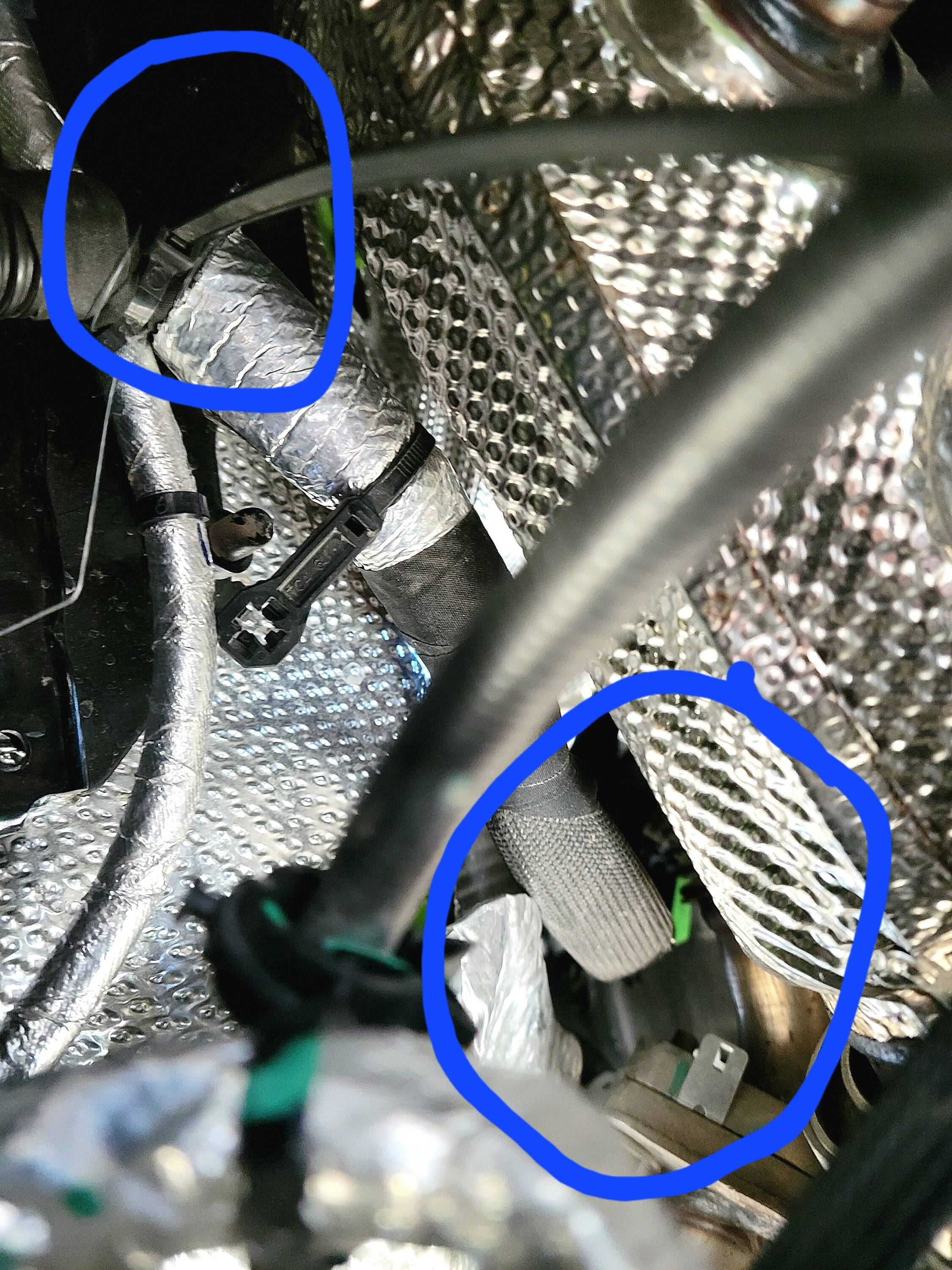

Jeep Wrangler JL Wire harness rubbed through 20221127_094910
I I don't know if this picture helps but the top circle is where I zip tied the wire just past the connection to a ground wire. The lower circle is where the wire harness used to rest on the flange. This picture is taken from inside the rear of the passenger fender liner.
