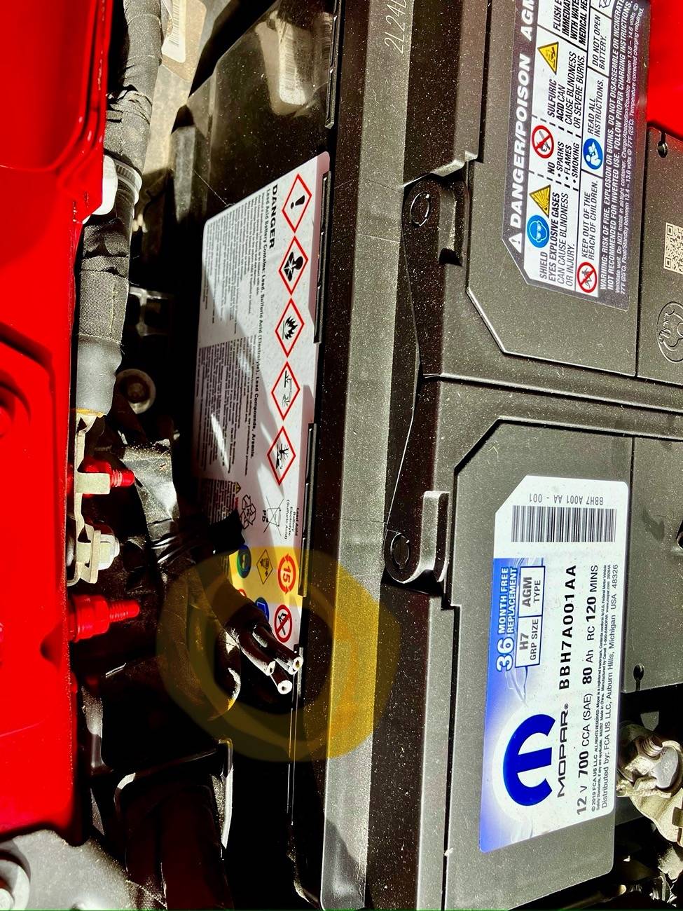

Can anyone tell me what this should go to?These wires are secured next to the battery, very visible, on the fender side.

Does your JL have the Aux switch package? It looks like the under-hood output wires for the Aux switches.

There are 4, but I don’t have auxiliary switches.
I do remember reading about some Jeeps having the aux wiring without aux switches, but I think those were 392s
Could they be from aftermarket switches?
Also (if you're not the first owner) maybe the (oem or aftermarket) switches were pulled, but the wiring remained? Or someone starting installing a set and gave up partway. Do you have a wire bundle on the interior, too?
I’ll have to look for those under the dash when it warms up a bit. Thanks
