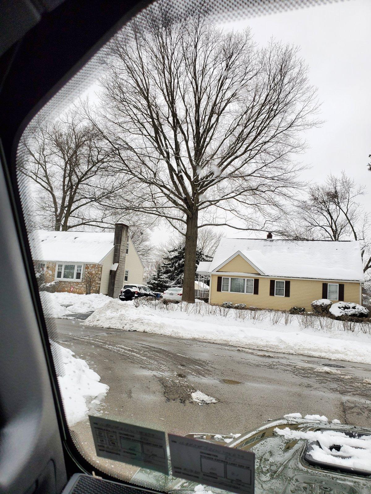

I wanted to verify for those of us struggling to defrost our windshields that this fix really does work. I ordered the 5/8 tubbing plug caps and plugged every other hole in the center portion. Now, the outer portion blows air equally like the center portion! Pics for reference and super easy! Thank you to everyone that has posted this fix, as a new jeeper, really appreciate it!
