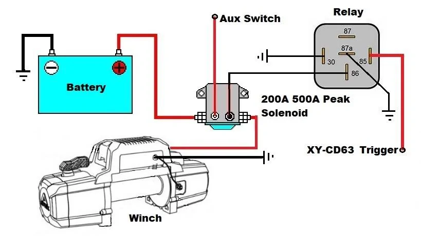

Here is what I plan on doing... chassis ground with secondary battery ground to chassis. Having more grounds the better.
Everyone is so worried about battery not being directly connected. Well the battery is not isolated unless you make it so. You have the charging system interconnected and nobody seems to care but me.
The XY-CD63 is a voltage monitoring device for charging batteries. It will not trigger without a simple mod. It is the simplest and effective device to protect your charging system and investment.
I plan on a full write up on its function and implementation. Note the solenoid is to be active by Aux switch until triggered at a programmed low voltage.
Sorry YBABRAT, I'm not totally clear on what you're saying. Are you planning on running a winch with engine charging off, and so want a cut-off before the battery is discharged beyond engine starting capacity? Are you planning on winching with engine charging and concerned about system/equipment damage from voltage drop? Can you clarify please.

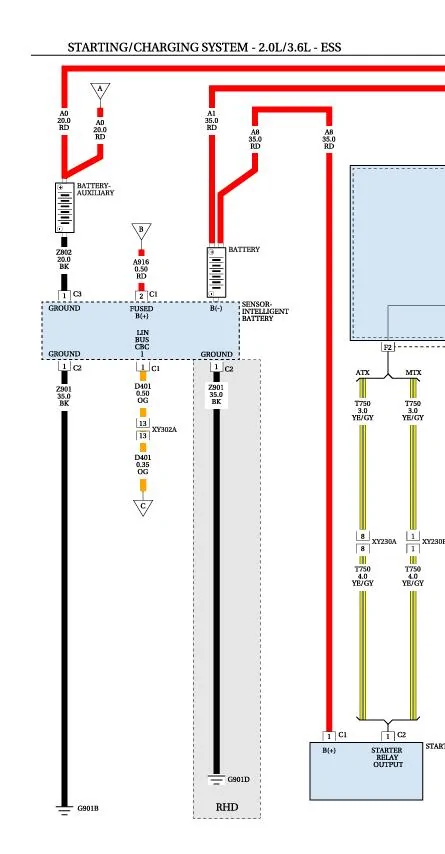

It is direct - battery to starter.

That diagram is deceiving, the battery power goes to that starter relay (protected in the Jeep and controlled by computer) or you wouldn’t have a break in power to start / stop the starter motor.
It's not deceiving man.
That red wire is a cable straight from the battery to the starter post.
The starter relay output you see there is coming from the fuse box which is where the relay lives.
Nearly every vehicle made has its starter motor cabled straight to the battery.
Here's the full diagram:
https://www.jlwranglerforums.com/JL-Wiring-Diagrams/STARTING_CHARGING-SYSTEM---2.0L_3.6L---ESS.pdf
