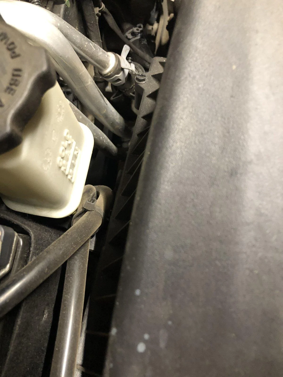

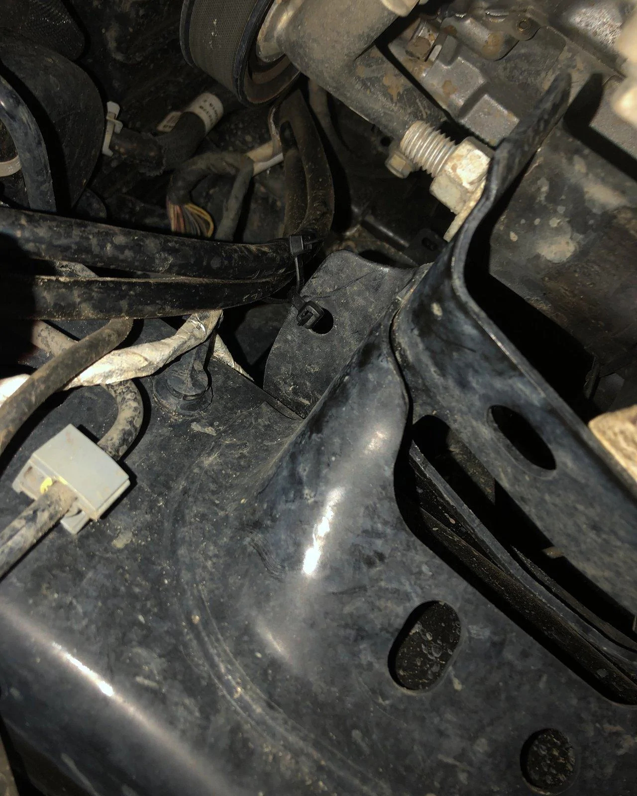

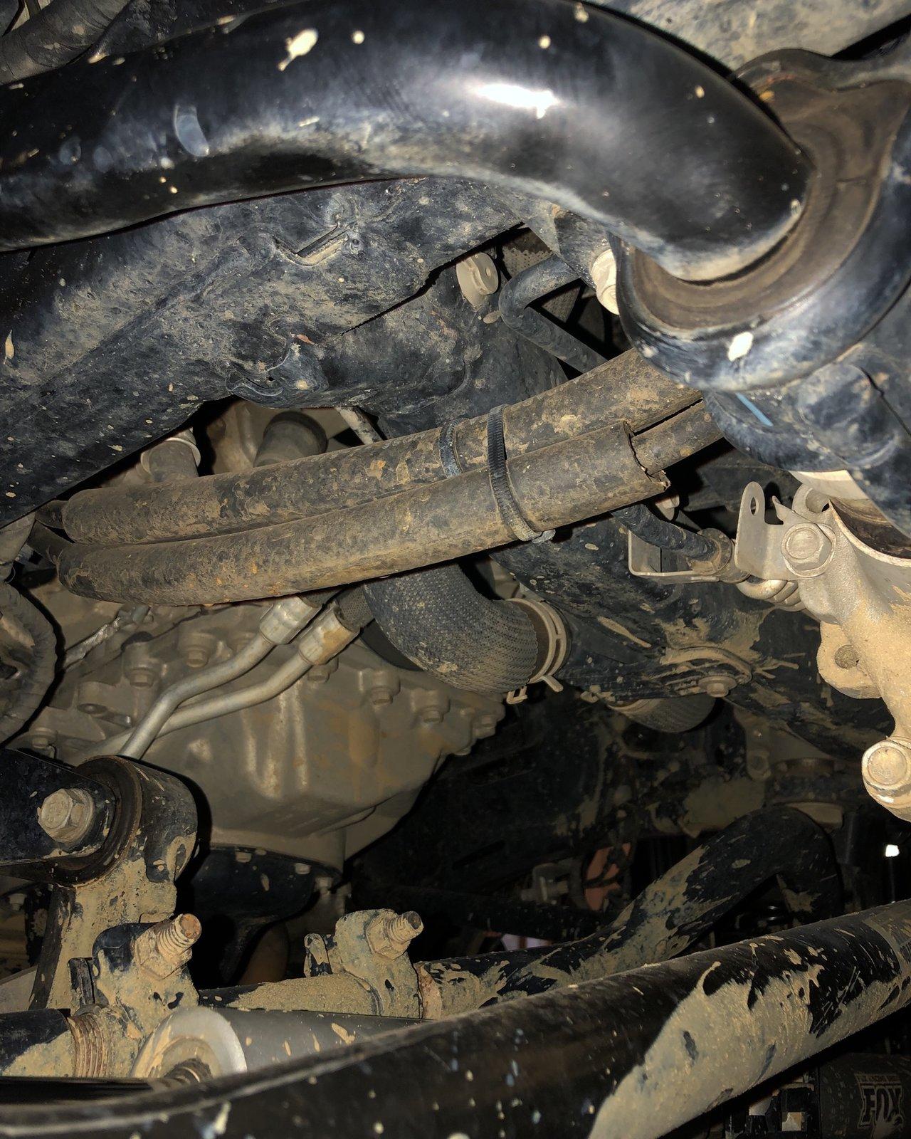

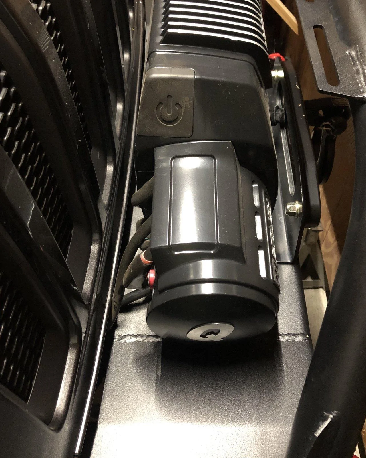

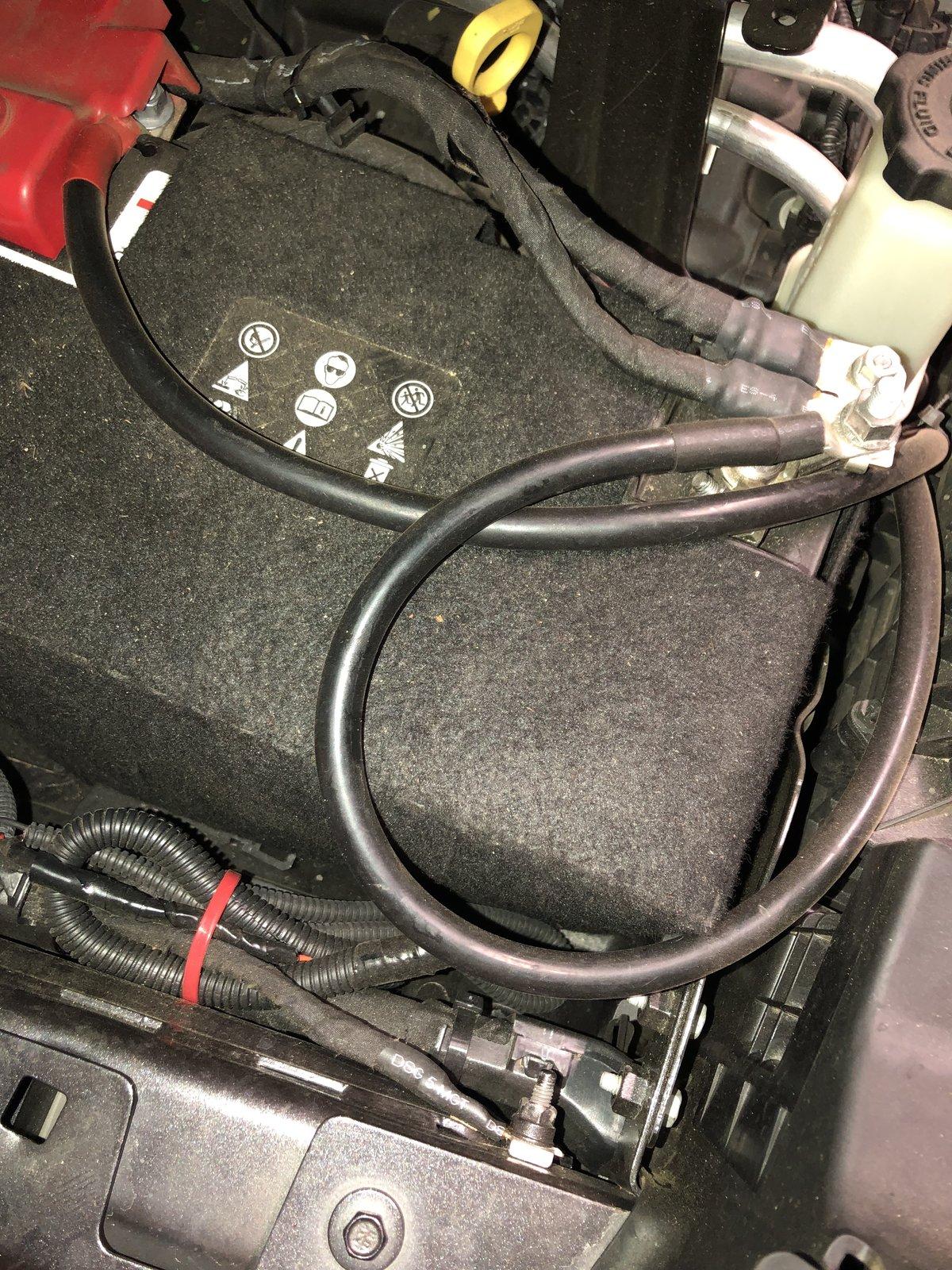

This is how I did it, and so far so good :fingerscrossed:. I just made sure that the cables don’t rub against any metal. I took some hydraulic hose and split it down the side to wrap around cables where they are most vulnerable.
When I tied them off to the frame, I zip tied the cables together then zip tied the zip tie to the frame. Pictures are kinda in sequence top to bottom, if you have any questions, happy to help ...:)

Well done with the cable tie to cable tie, that will greatly reduce chance of chaffing the wire. Aircraft standard.
