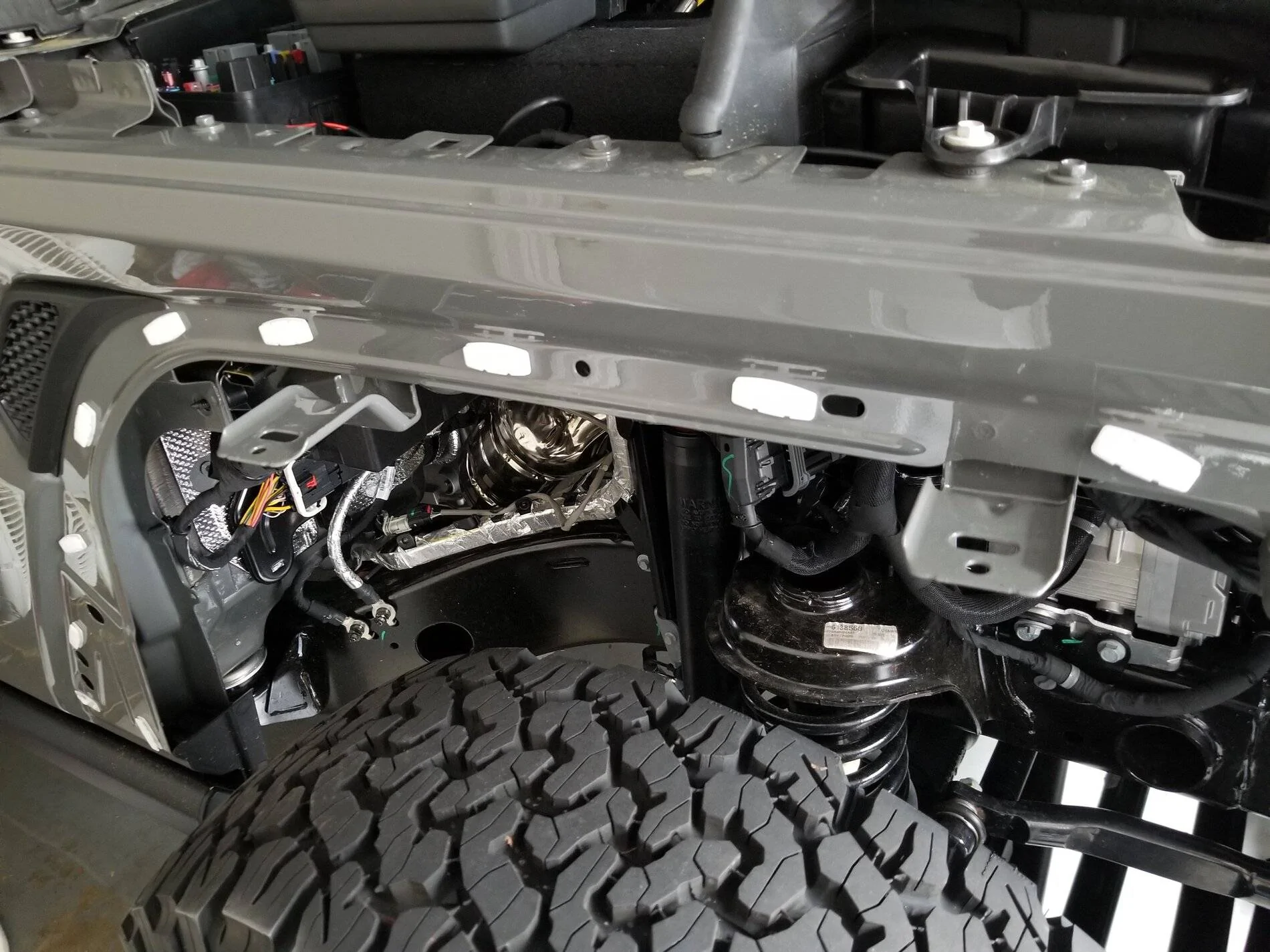

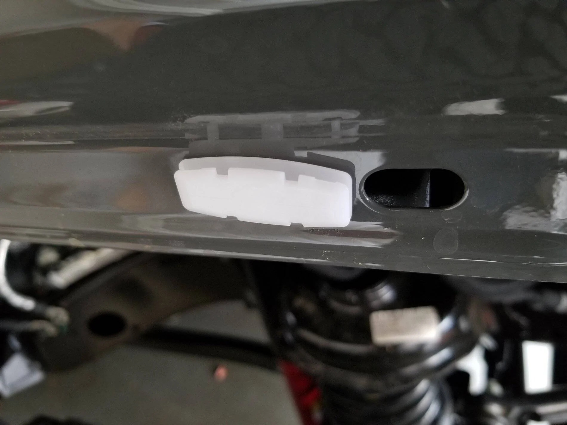

Removed JLUR fender flares to install aftermarket fender lights. Now attempting to reinstall the fender flares. Having a hard time. The white clips remained on the Jeep body when I pulled the fender off. The clips appear to be 2 parts. Am I supposed to separate these white clips somehow to get them off of the body of the Jeep and then reinstall them while holding the fender in place?
Or am I somehow supposed to fit the fender onto each clip while the clip is attached to the Jeep? This is my first time attempting something like this and I'm stuck!

Reach behind the back side of the clips and remove them from the body and install them back into the fender

Just squeeze the pin it has a couple flanges that you can squeeze together and then they'll pop right out.
Thanks! I'm guessing I need some needle nosed pliers to accomplish this? There definitely isn't enough space for human fingers to fit behind it, not to mention not having space to depress the clamp holding the clip to the body of the Jeep.
Thanks!! Now I'm trying to find some needle nosed pliers to accomplish this.

Exactly what I did long needle nose to squeeze those tabs made it easy-peasy
Yeah what ever you can reach them with.

Thanks fellas!! Needle nosed worked like a charm!

I like to use a small closed end wrench. You can find one that is just a little bit bigger than the clip that will compress the wings. Then it pops right out. Lessens the chance of breaking the clips or scratching the paint. :)
