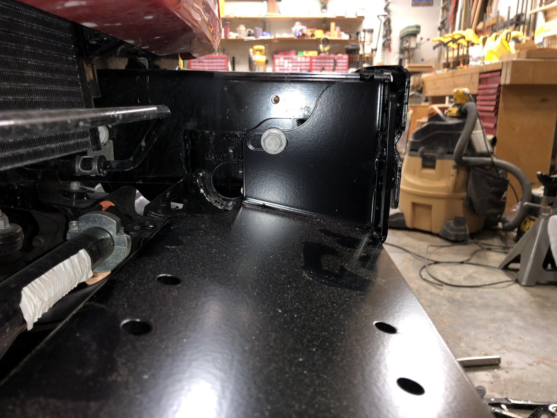

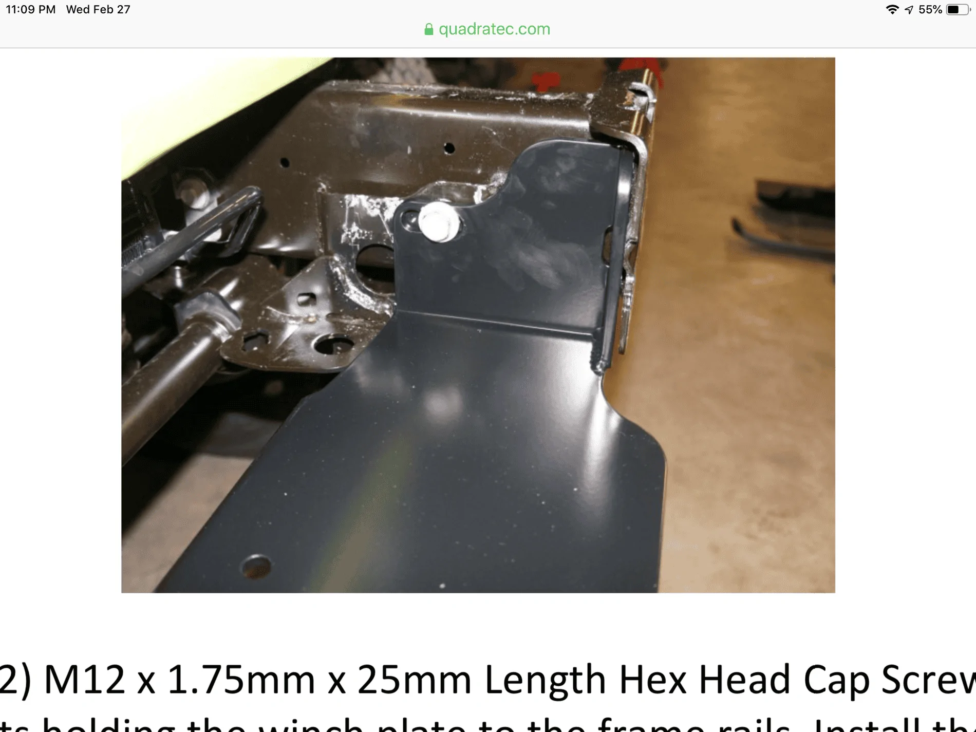

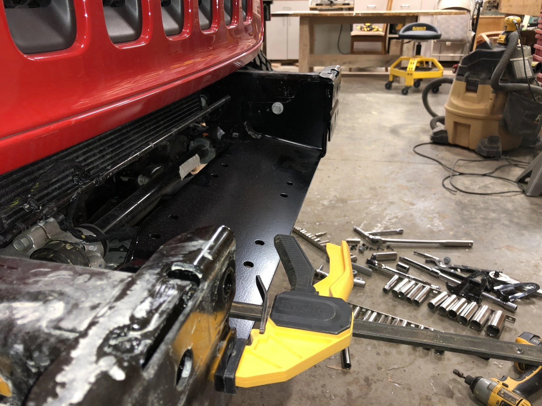

the Rustys winch plate does share two bolt holes with the bumper, however the winch plate flange and holes are just behind the plate the bumper bolts to, so the bumper studs just go right through both. it makes the bumper mount a little stronger. The the bumper studs are plenty long enough so the extra thickness of the winch plate is no issue.
These pictures are from when I installed it.
And of course, the lower bars is the Blue Ox tow plate, which is also compatable since it bolts to the outside of the frame and Rustys bolts to the inside.
Jeep Wrangler JL Rusty’s winch plate question IMG_3394
. the rustys flange is a little hard to see, but if you look closely, it extends down just slightly from the bumper plate, and is behind it.
