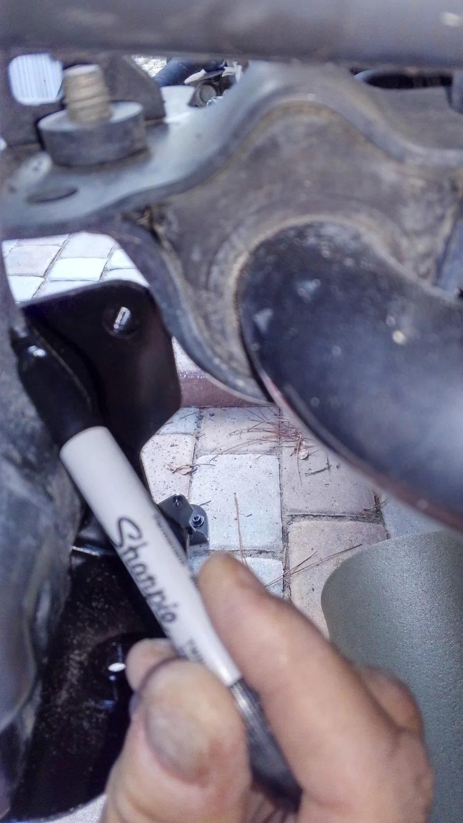

OK so finished the install and this is what I did with those plates.
OK this picture uploaded sideways just tilt your head to the left. Picture shows the plate with the two welded hex nuts and how the plate exceeds the side of the frame
in this photo I took a black sharpie and traced out what part of the plate I will remove.
Jeep Wrangler JL Warn Winch Plate Install Help Sharpi

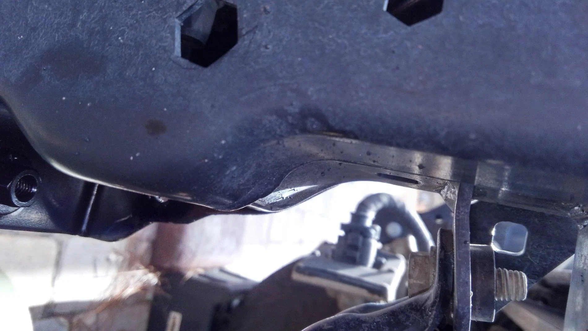

With the hex nuts grinded off and a small upper part of the plate removed, the plates fit much better and no worries of hanging up on anything.
Jeep Wrangler JL Warn Winch Plate Install Help Better fit
