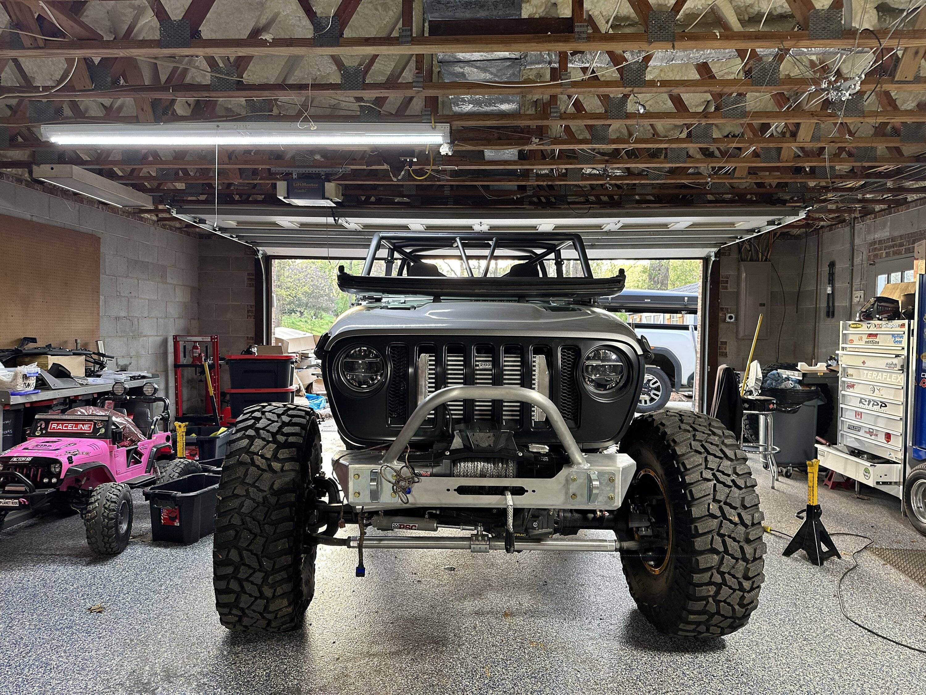

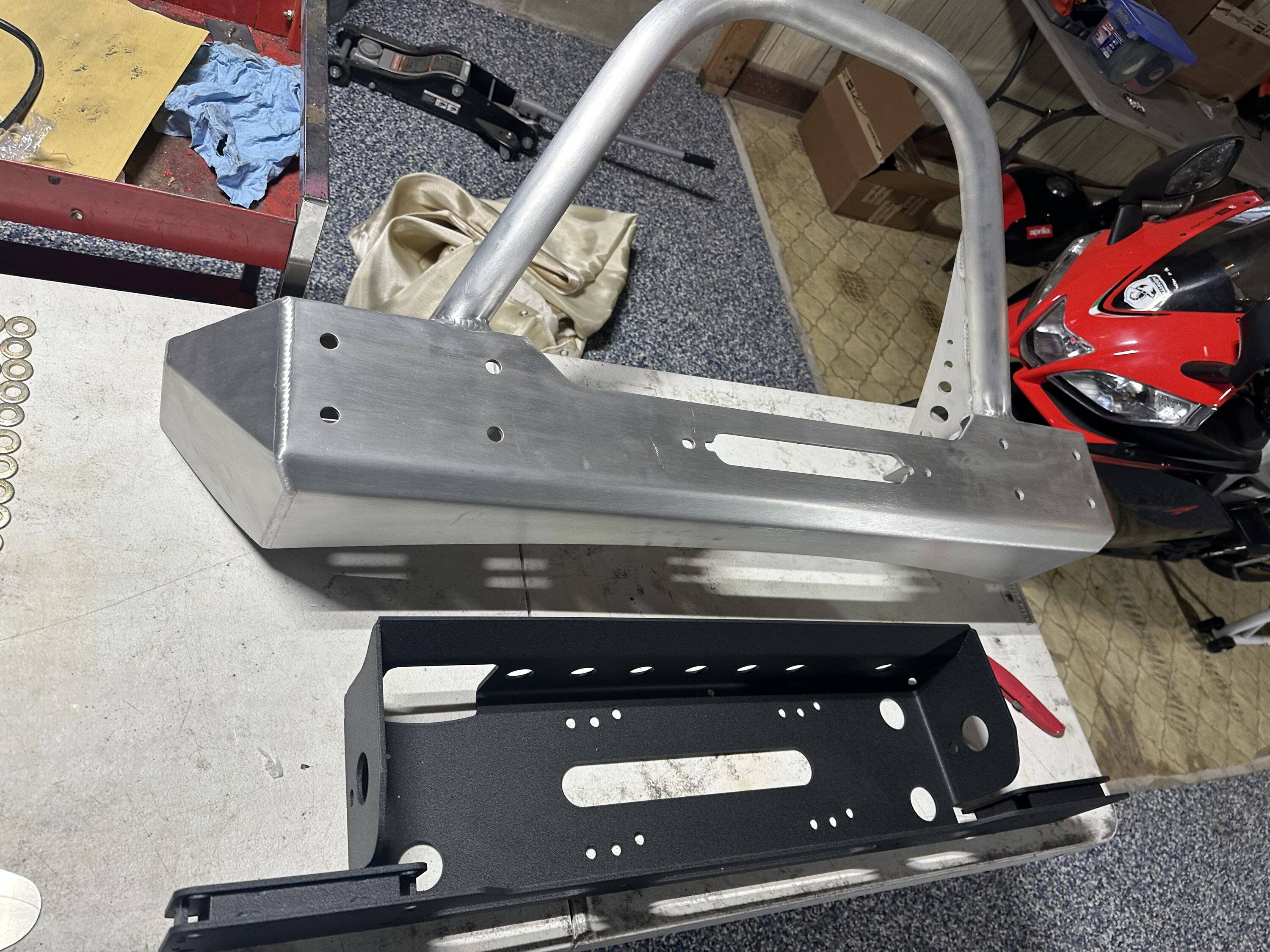

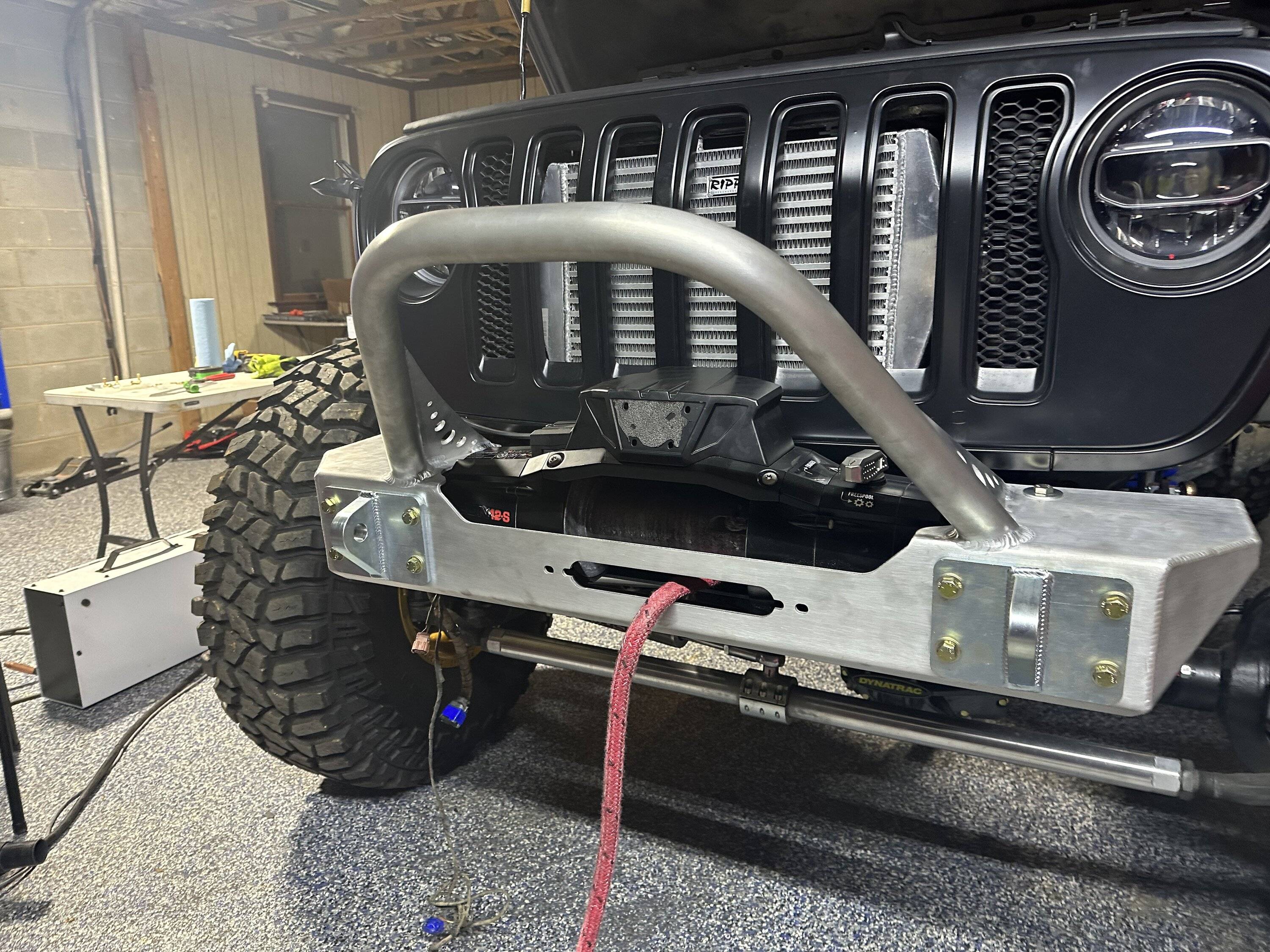

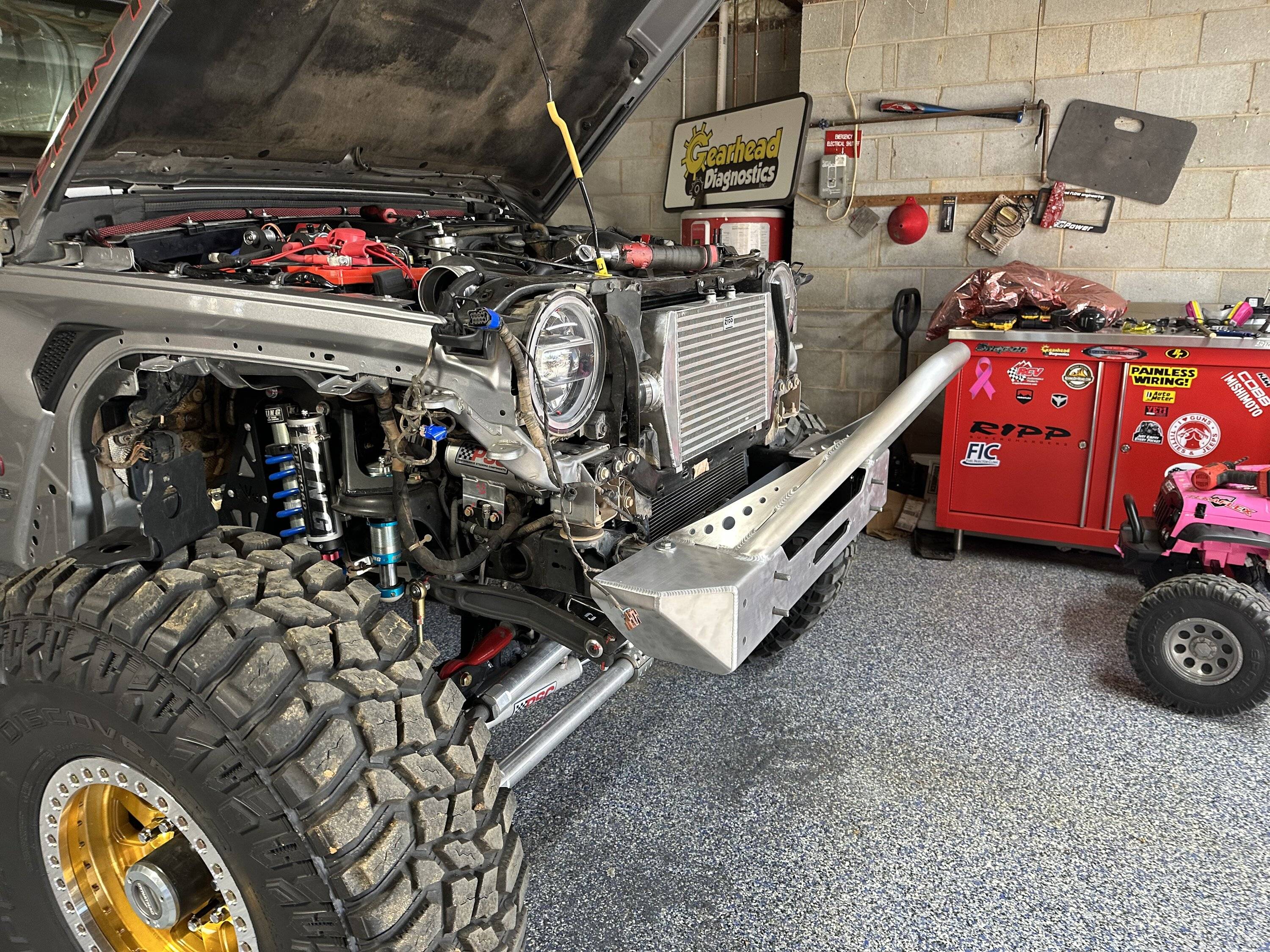

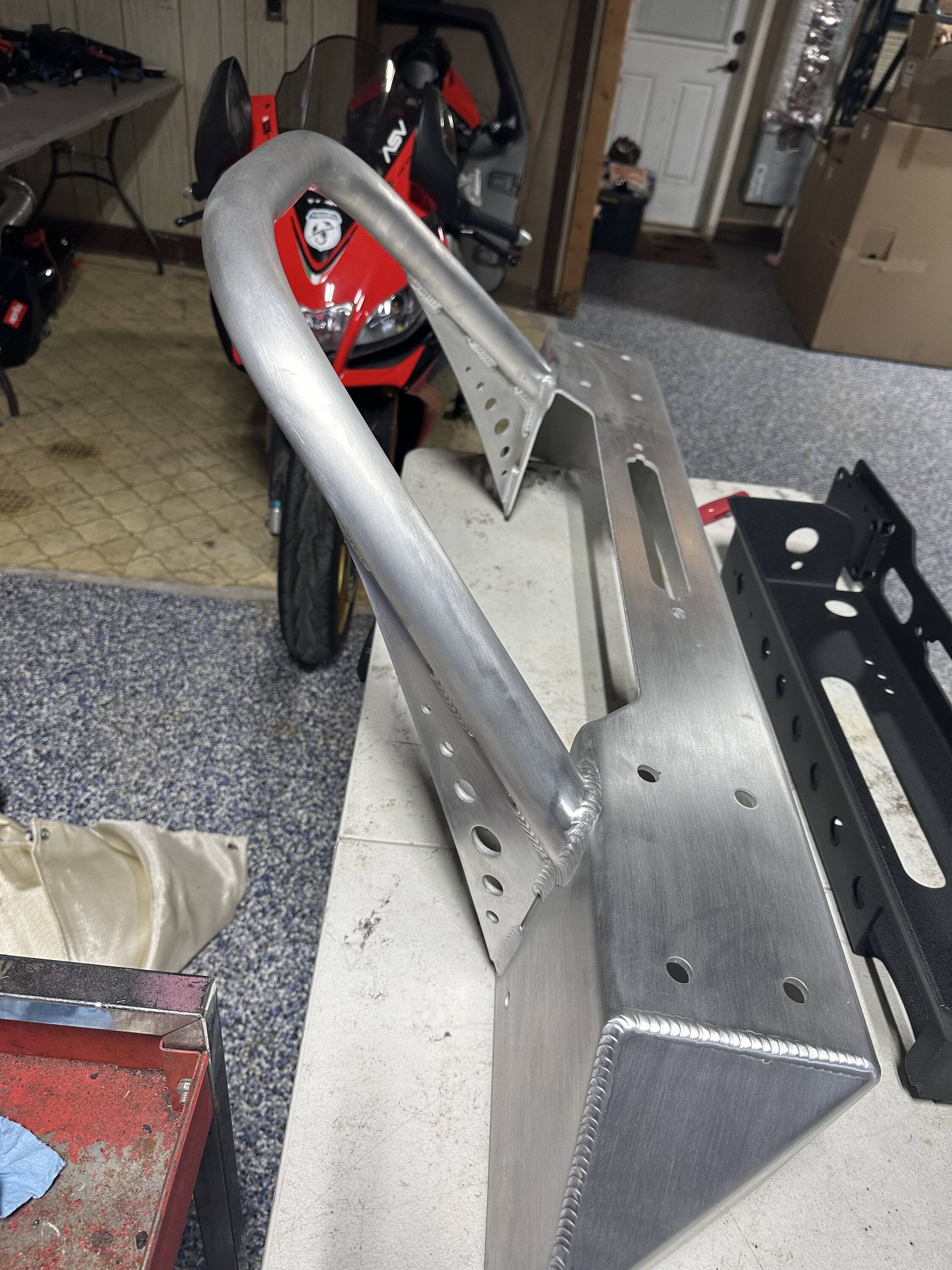

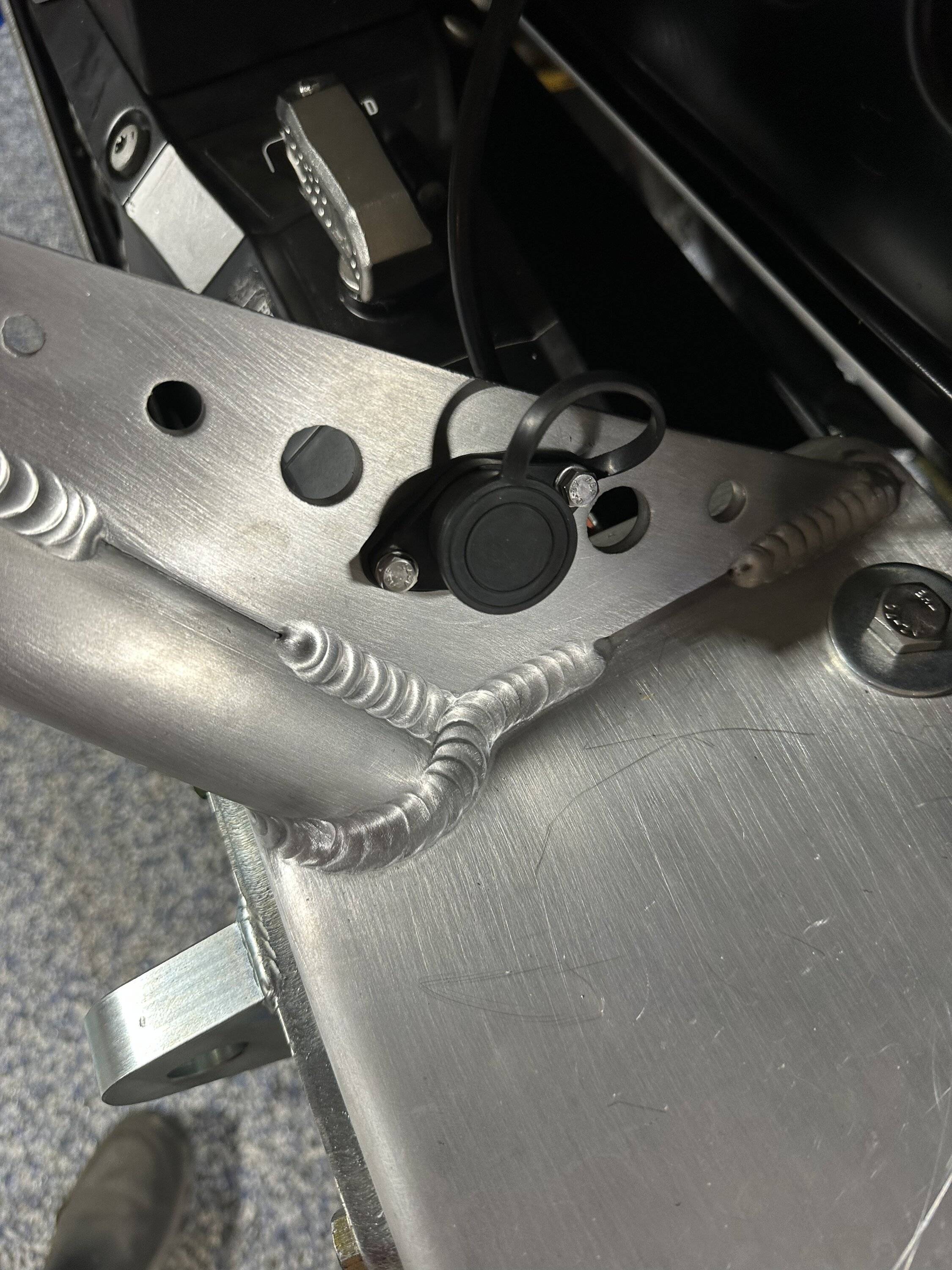

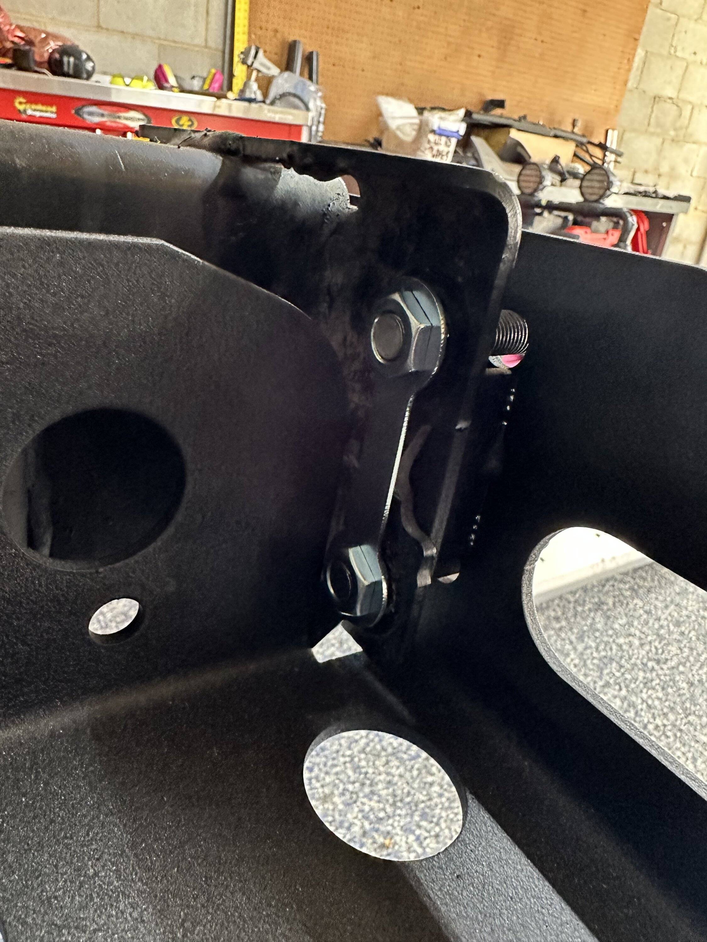

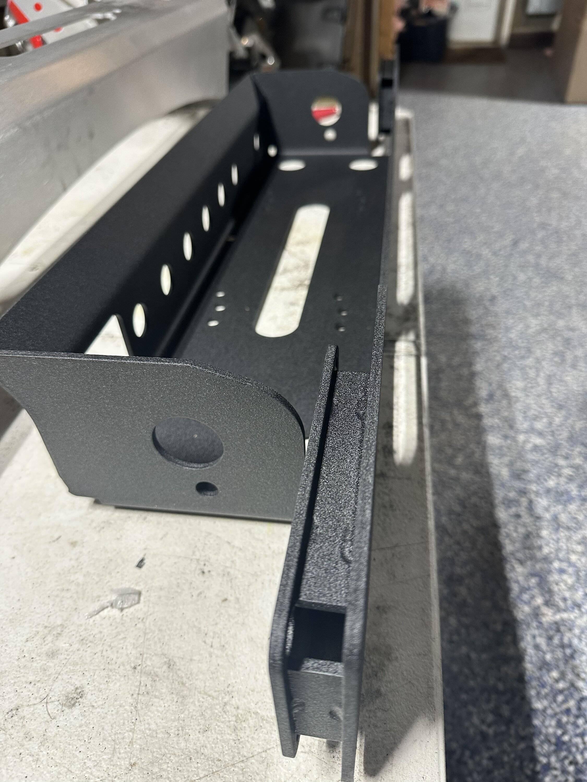

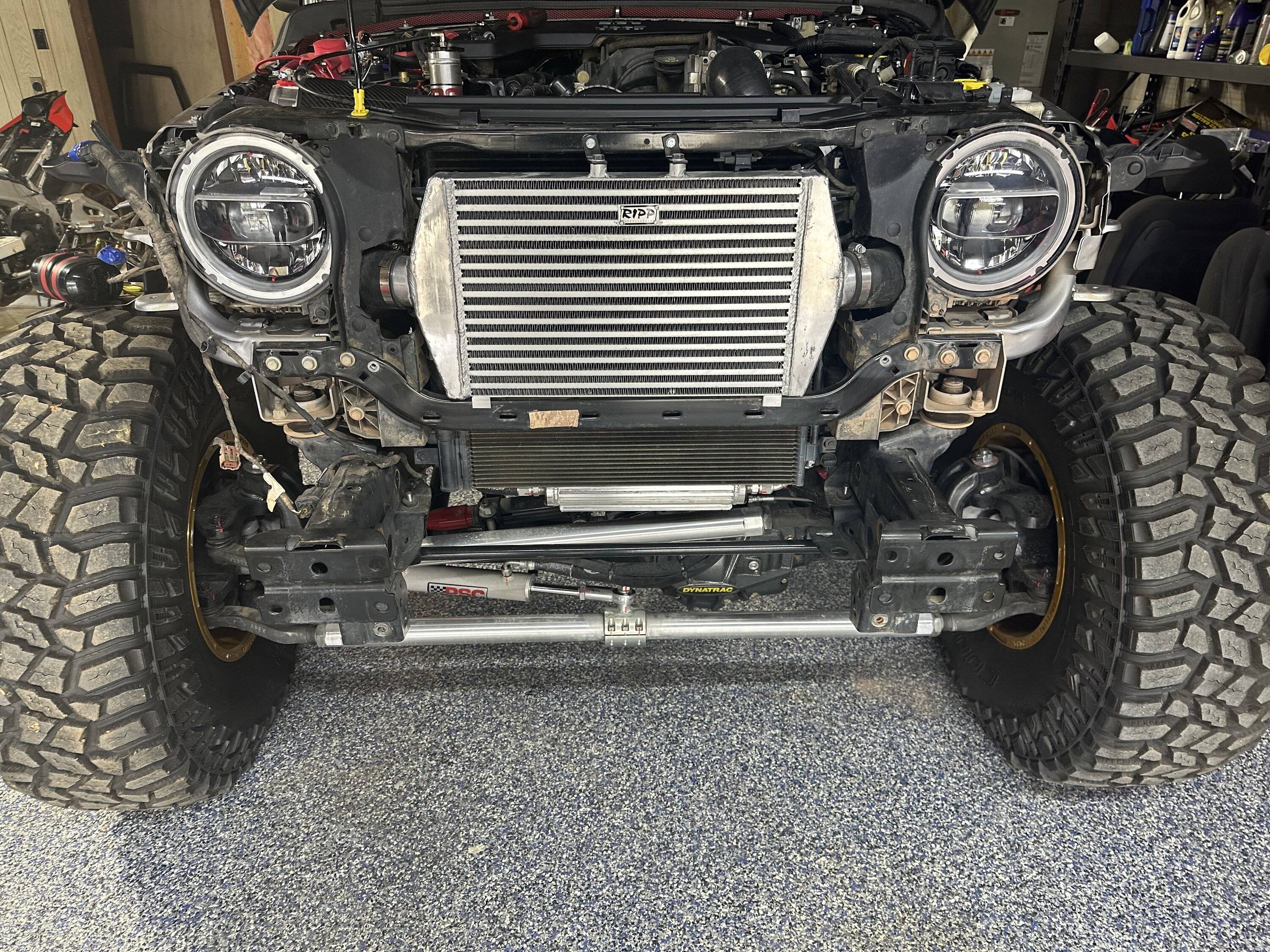

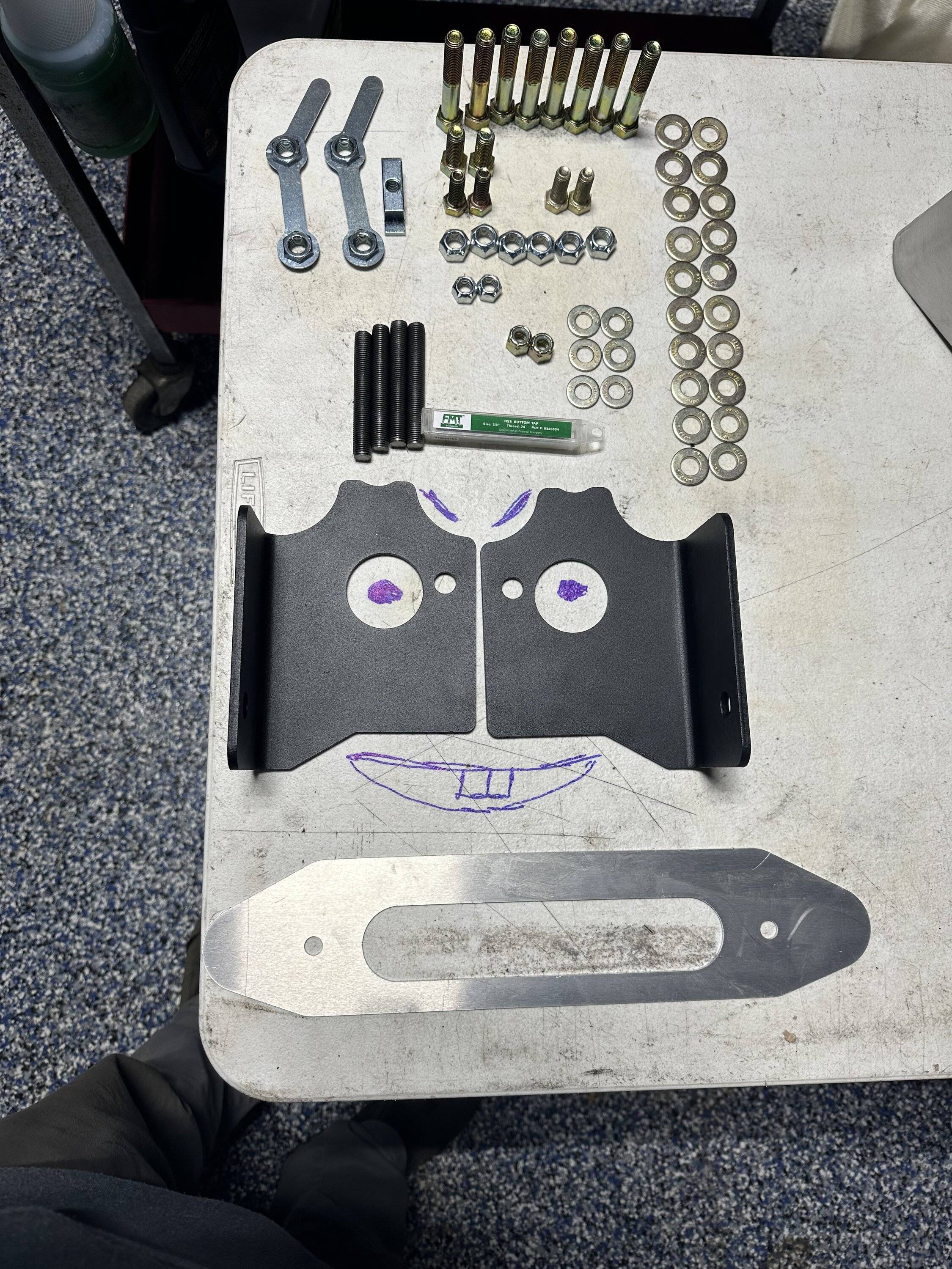

The bumper I ordered is P/N - FBB-10255.
I’m using a Zeon 12-S winch from a PowerWagon. I’ll cover the conversion to a regular use winch later in this thread.
Here’s a few pics to get started.

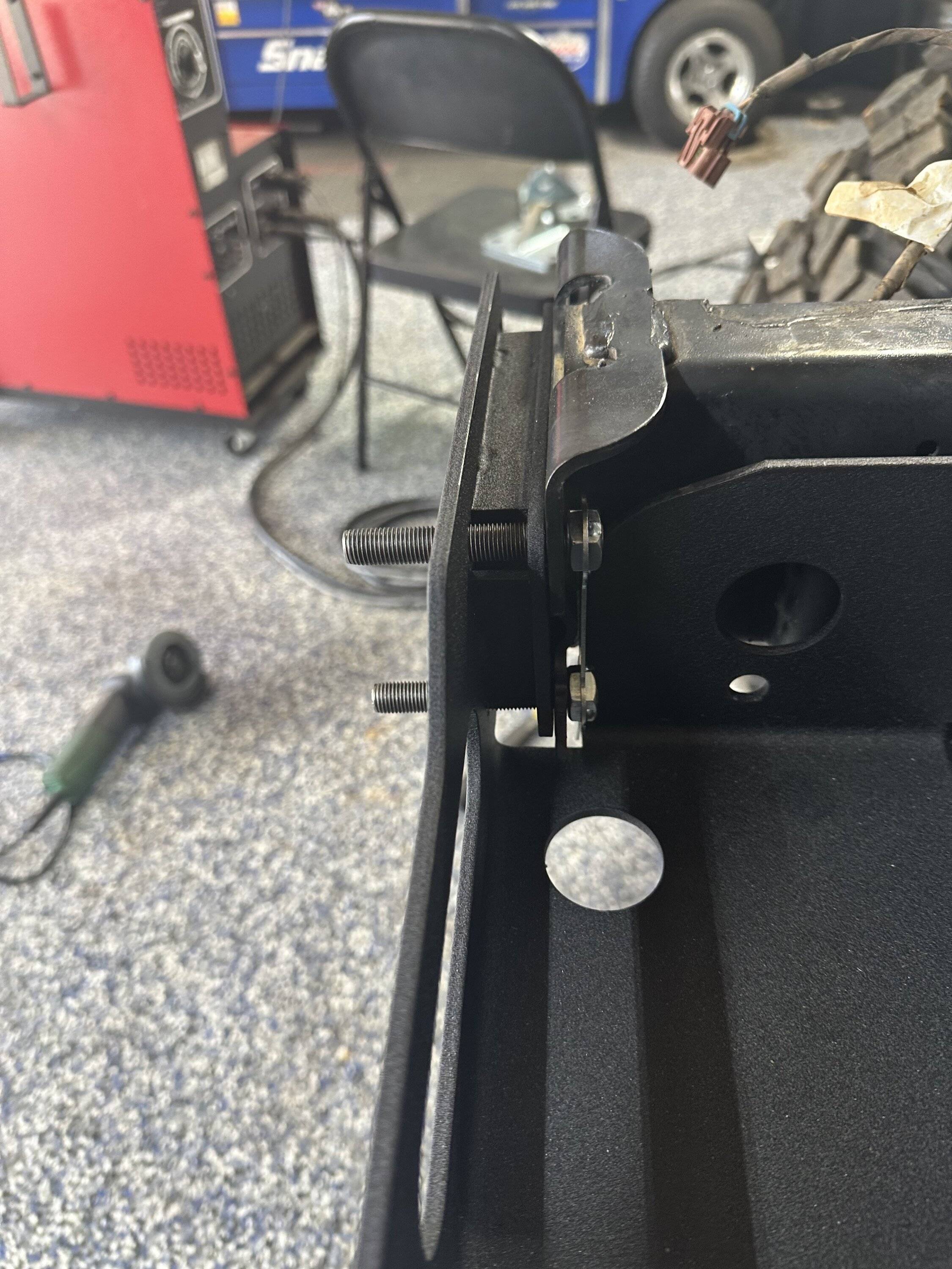

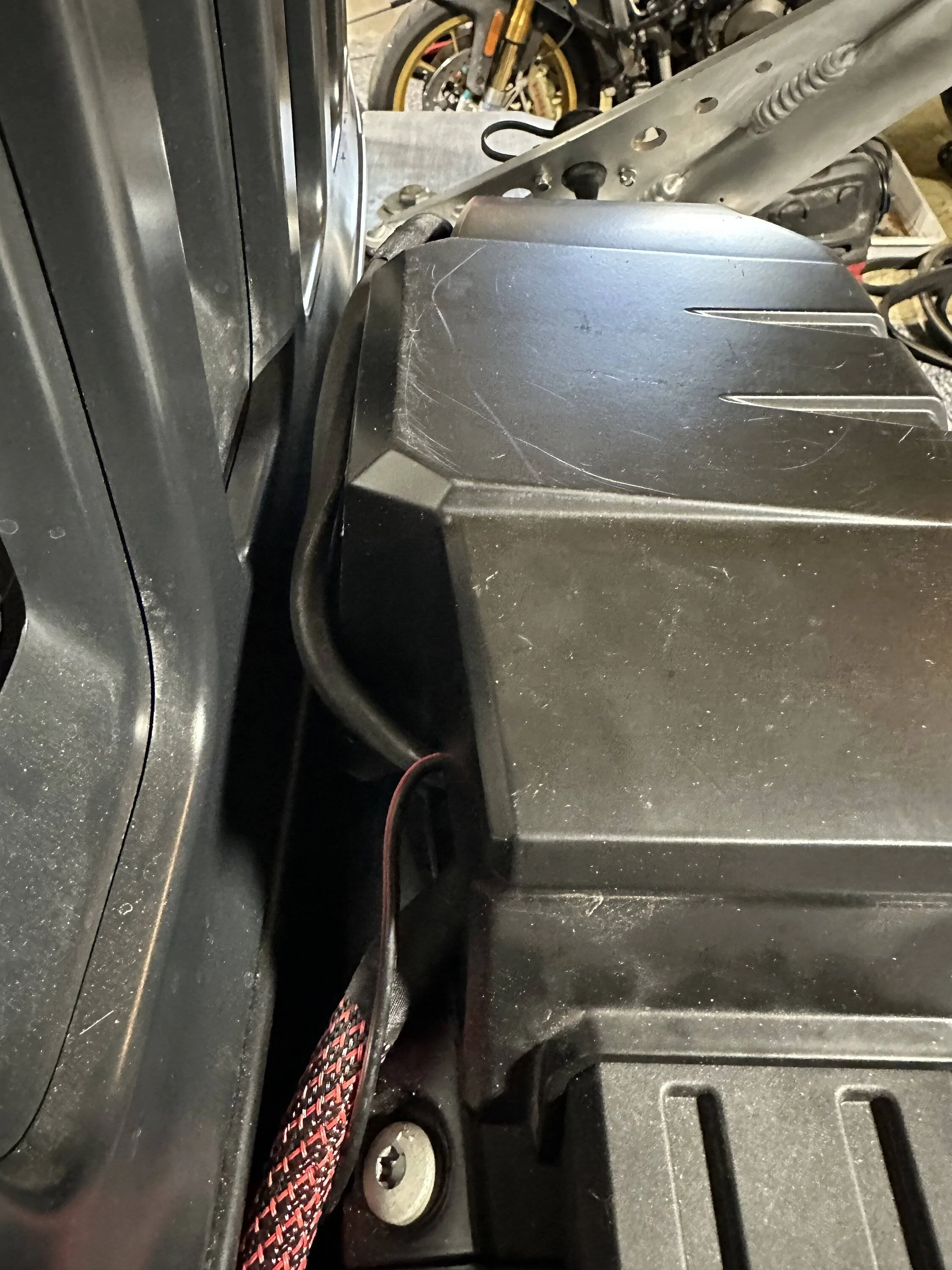

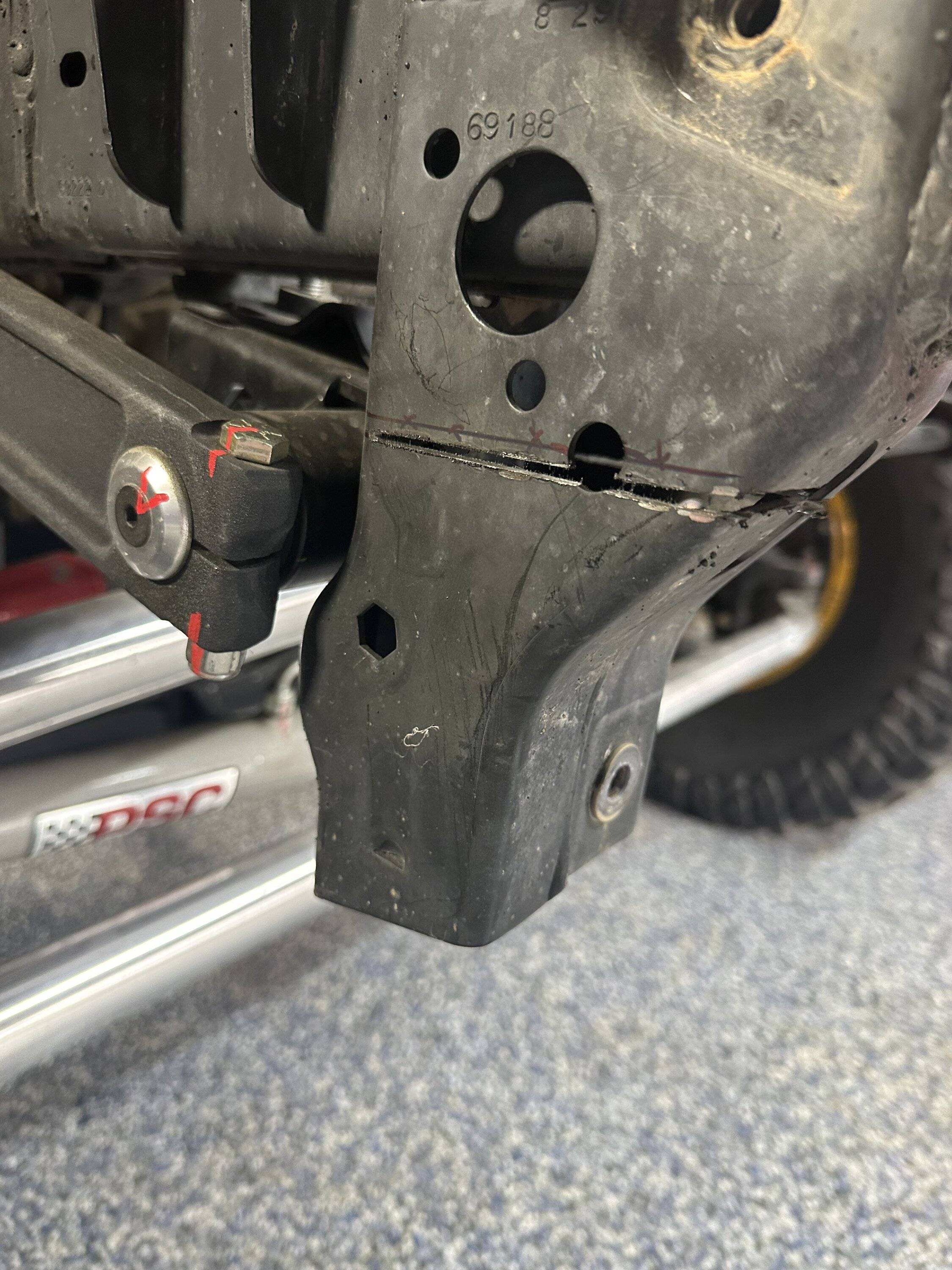

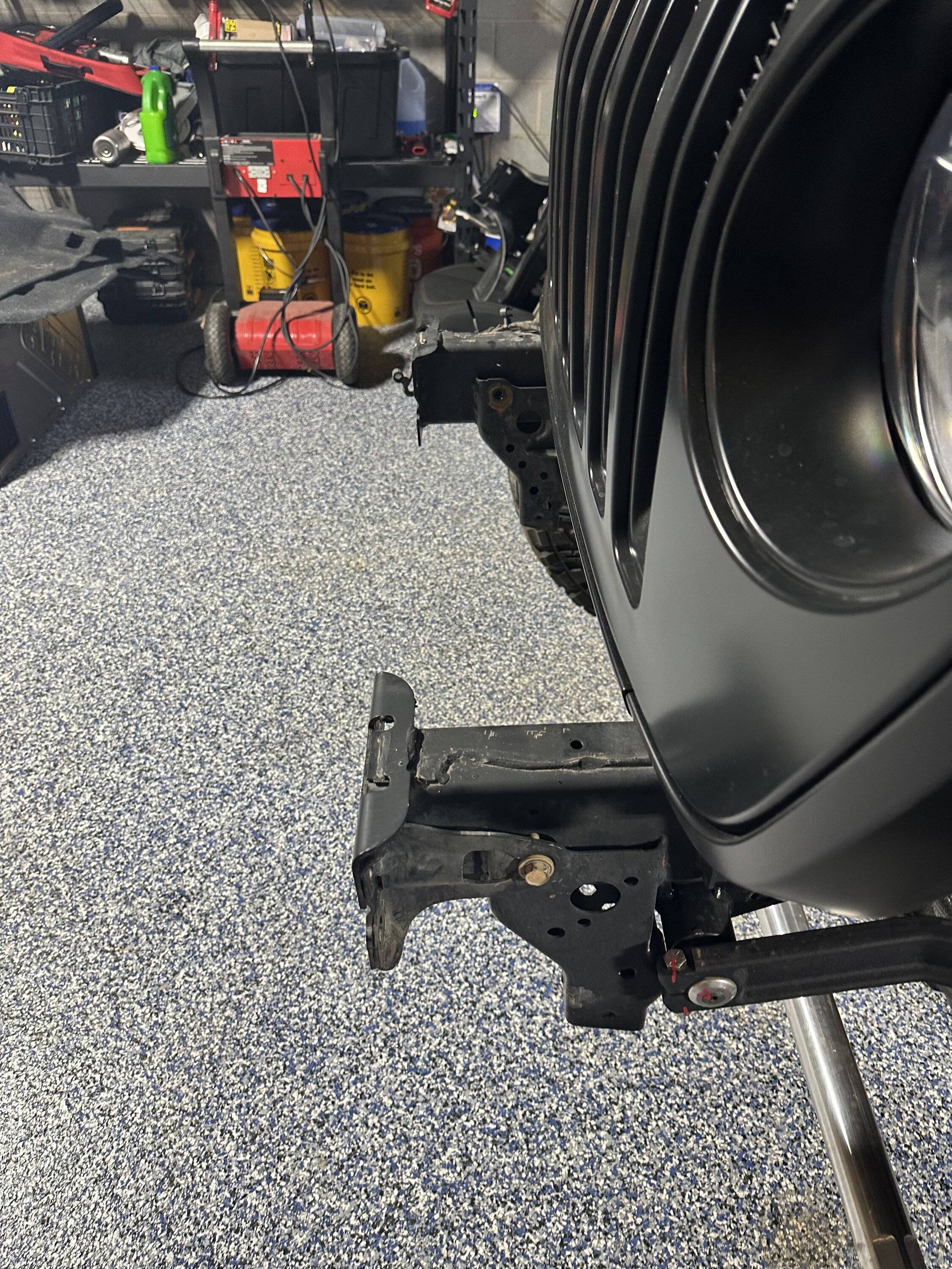

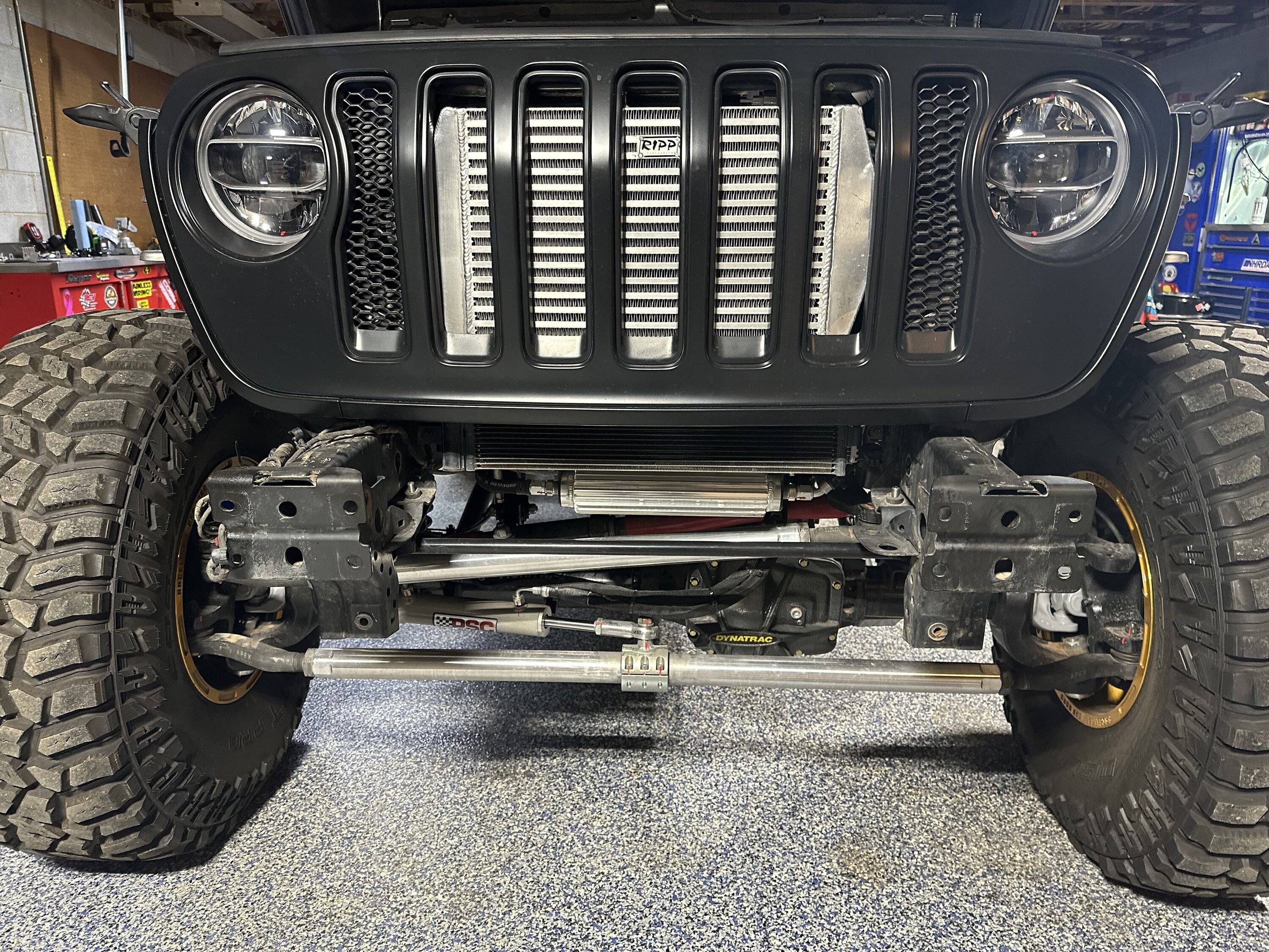

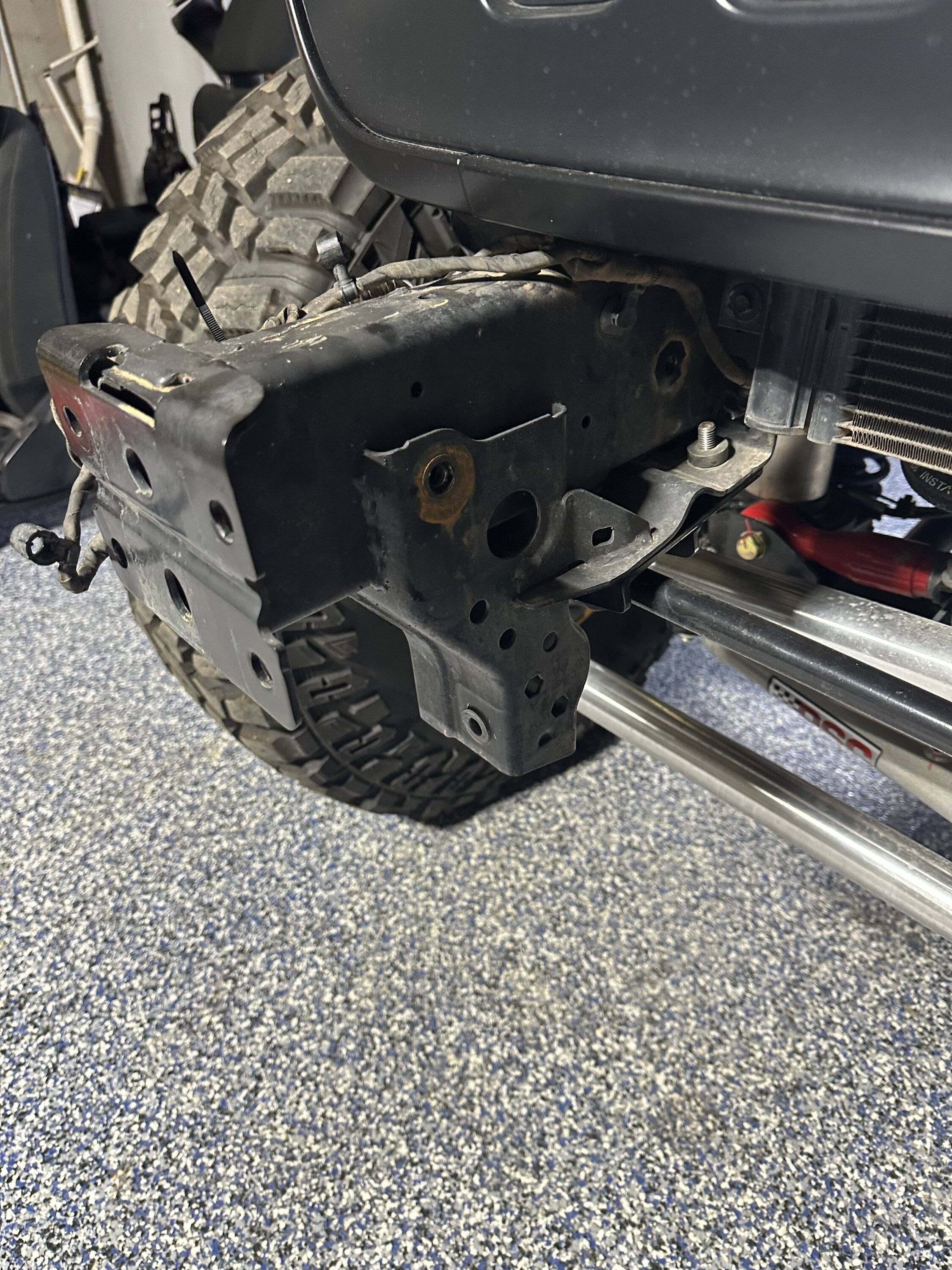

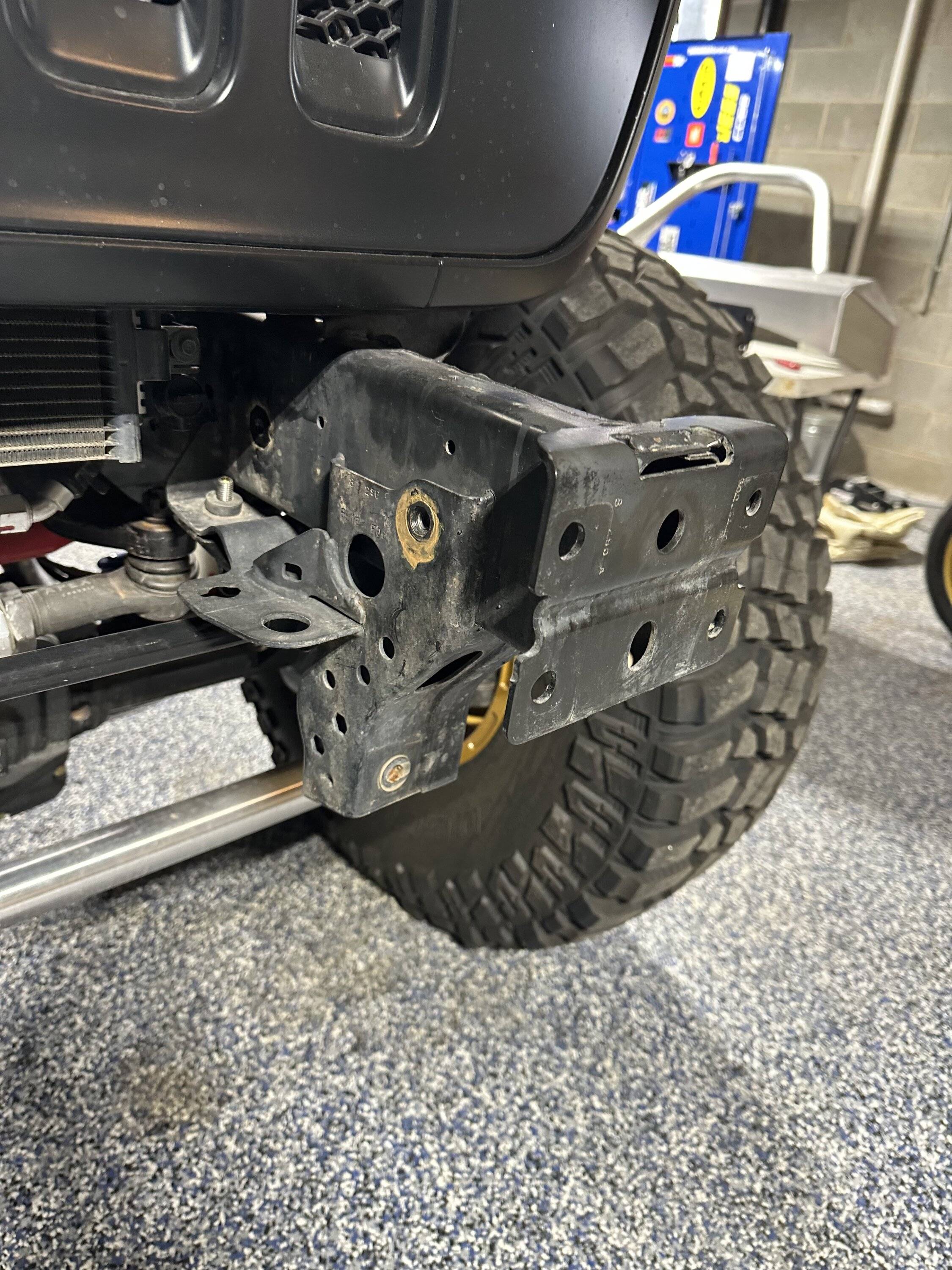

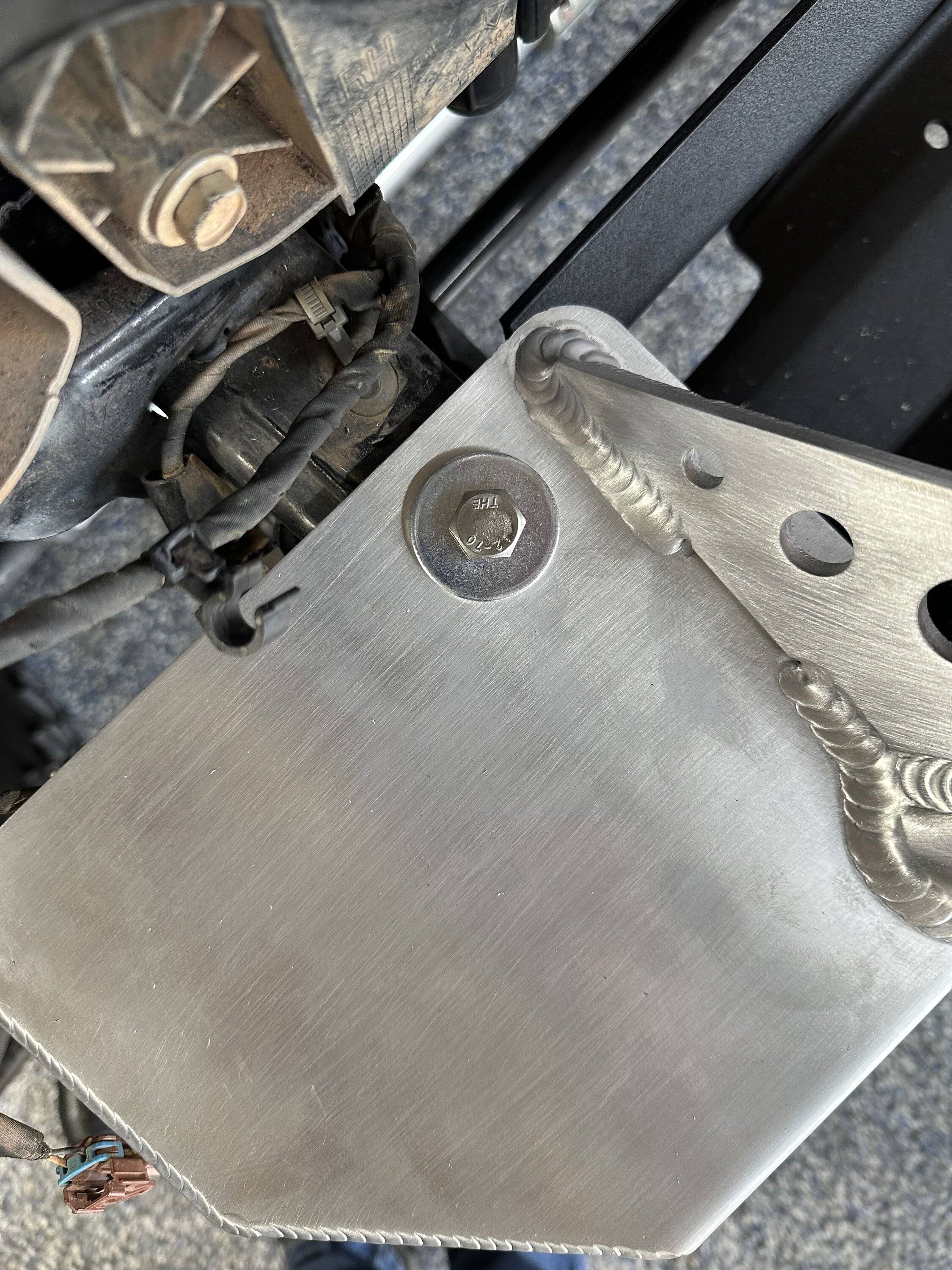

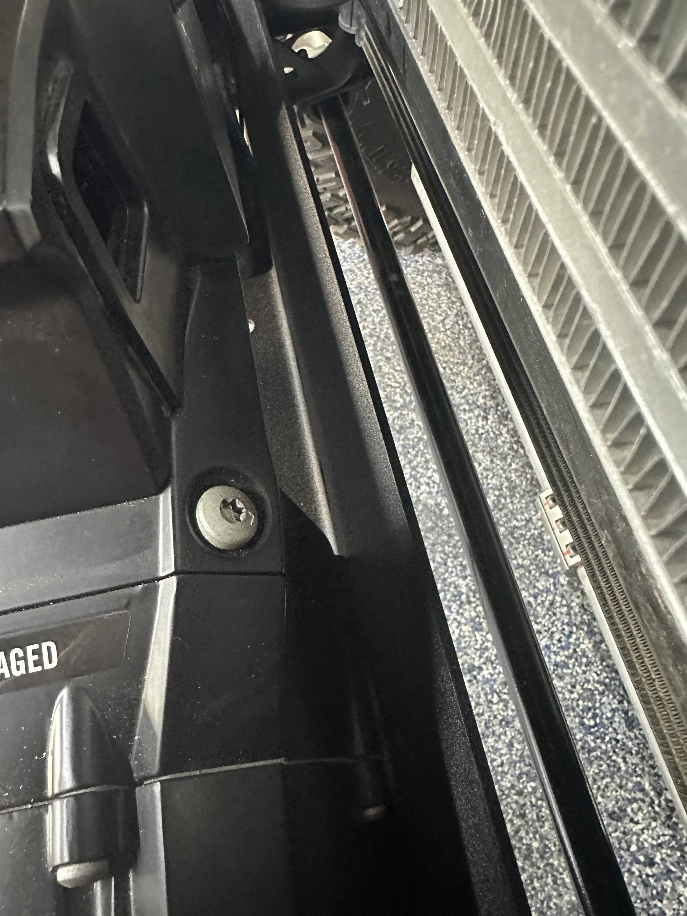

Got the grill removed and the horns cut off.
I wish I could weigh how much of this Jeep has been chopped off and ground away. Lol. There are several pounds of powdered Jeep all over the floor.

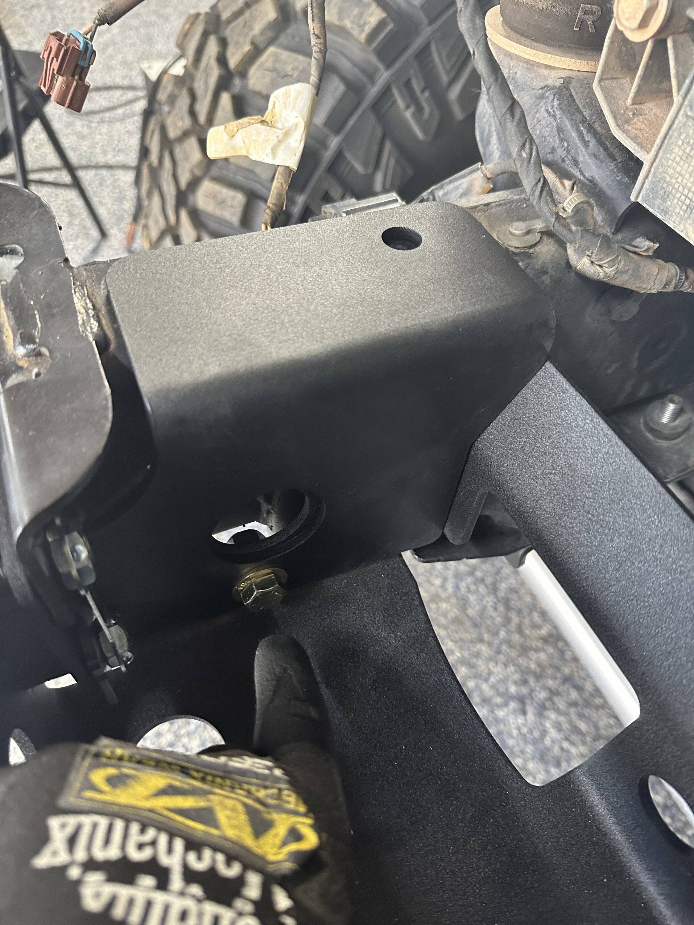

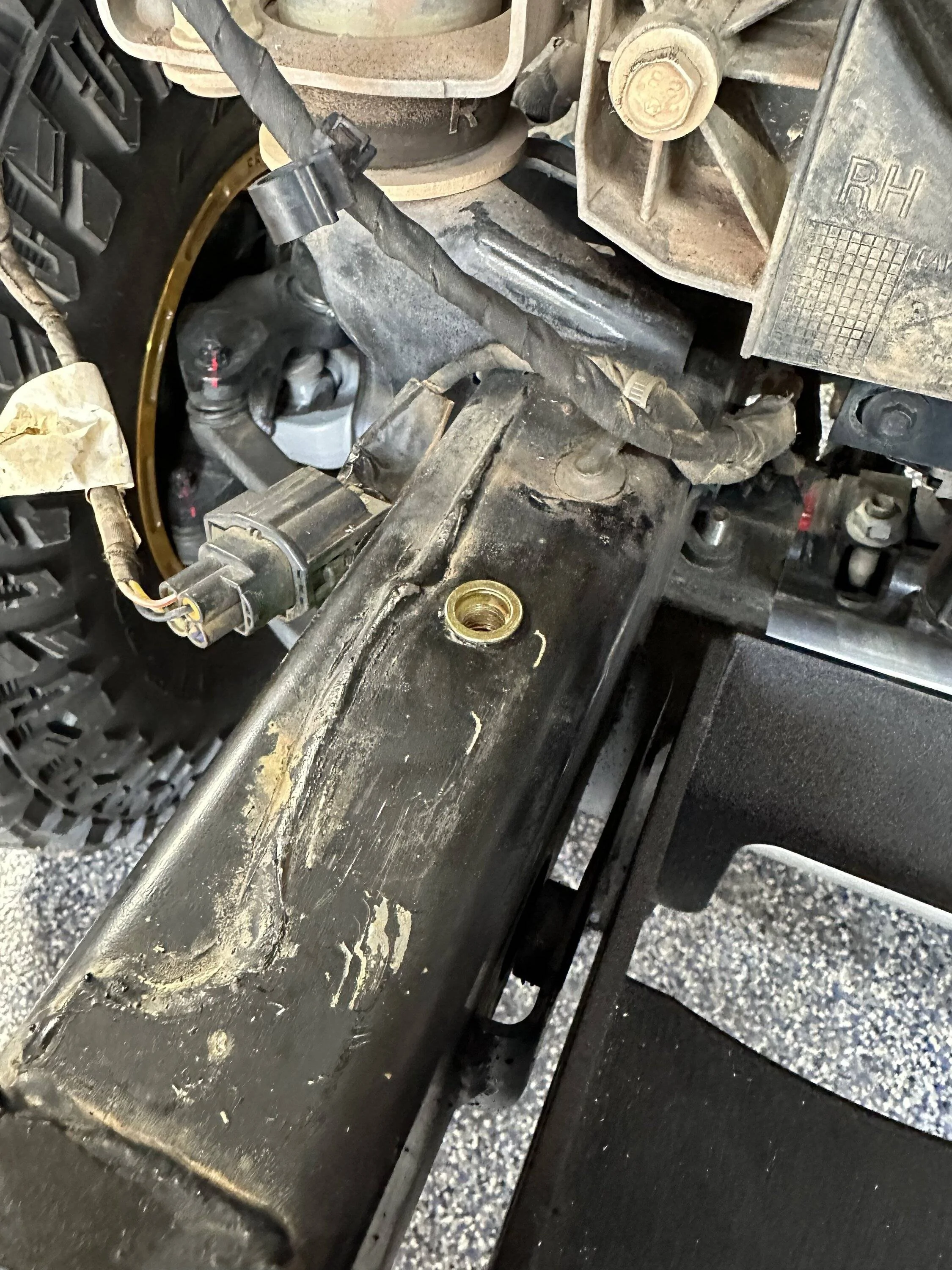

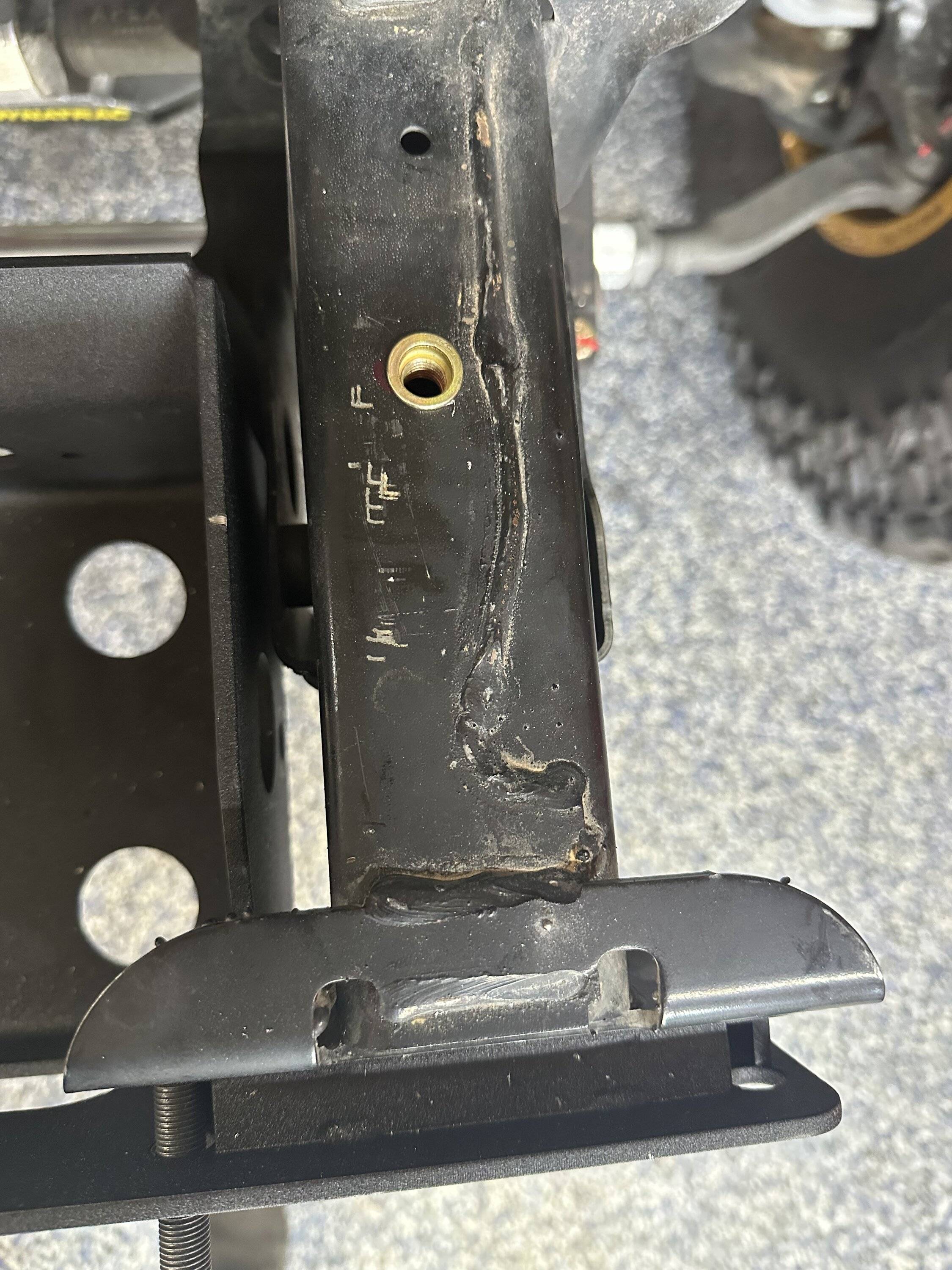

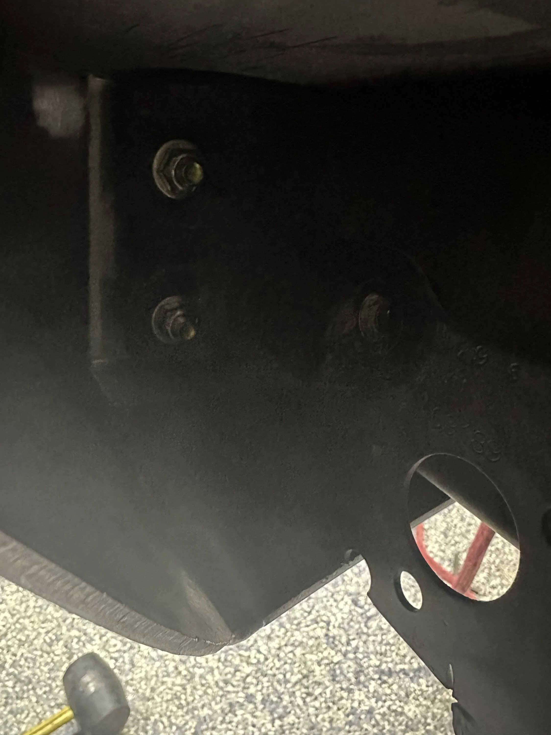

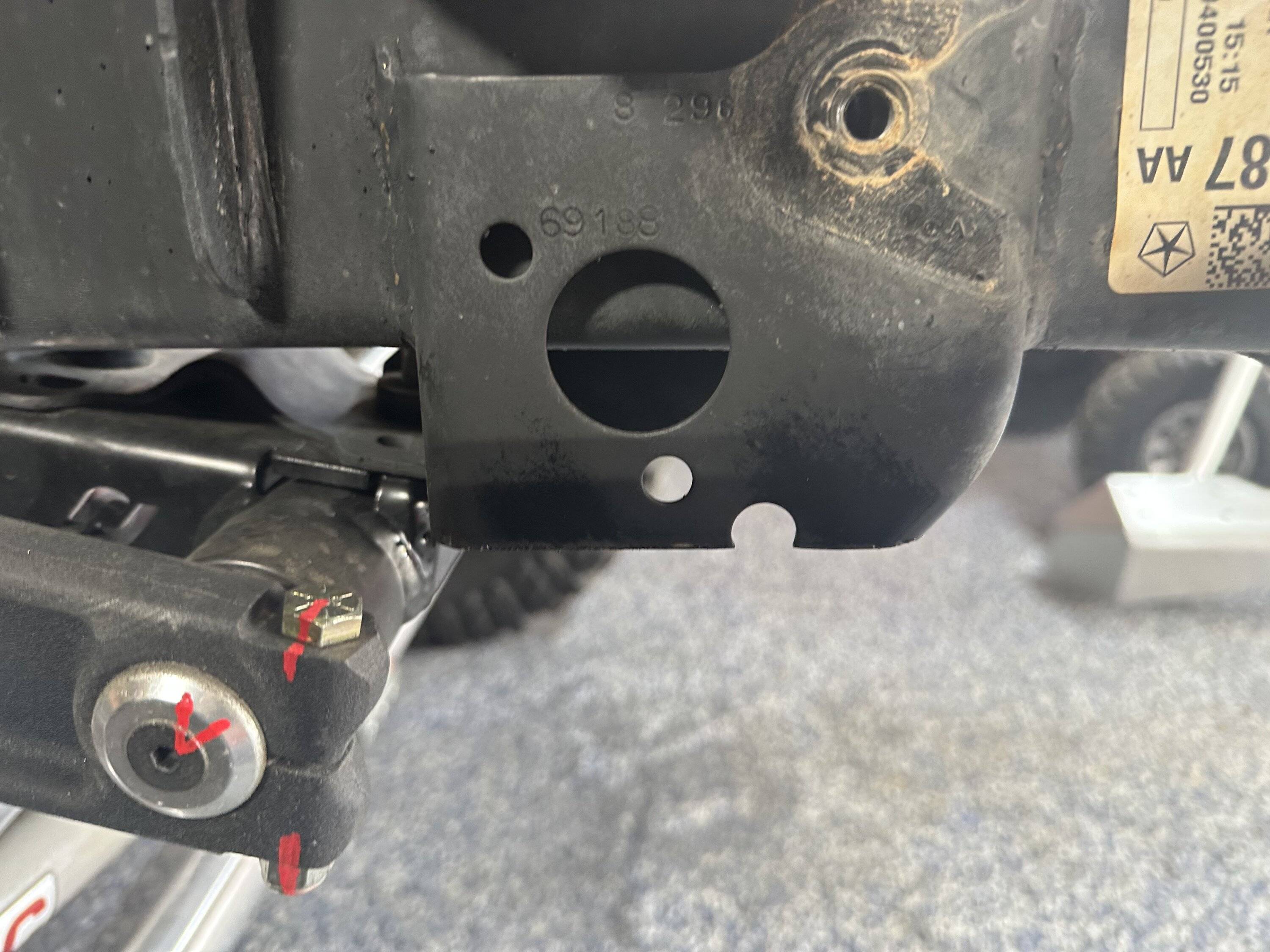

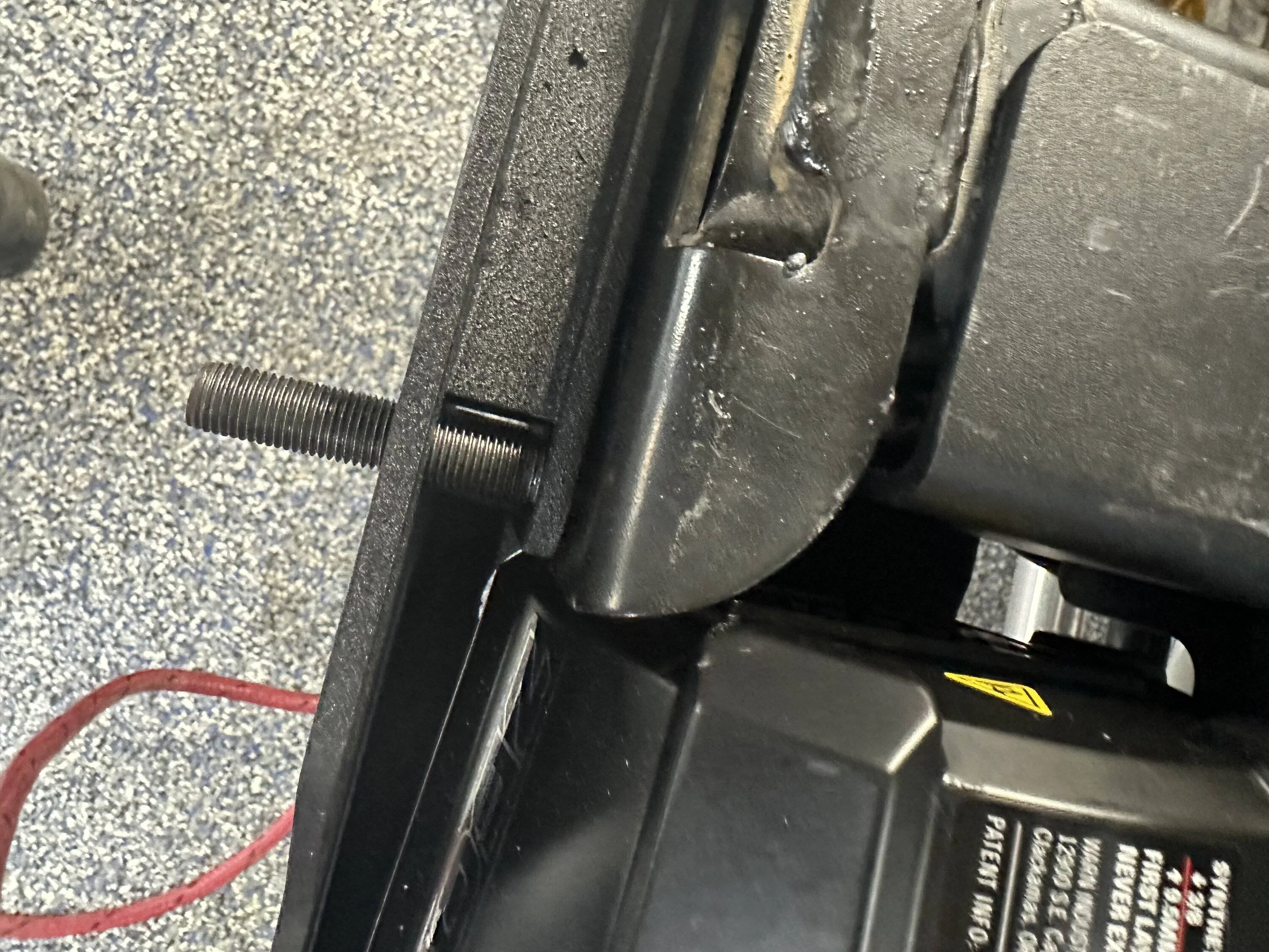

I ended up putting in some M10 rivnuts and making the top bolts bigger and stronger. I did this so I have a place to mount anything in the future.

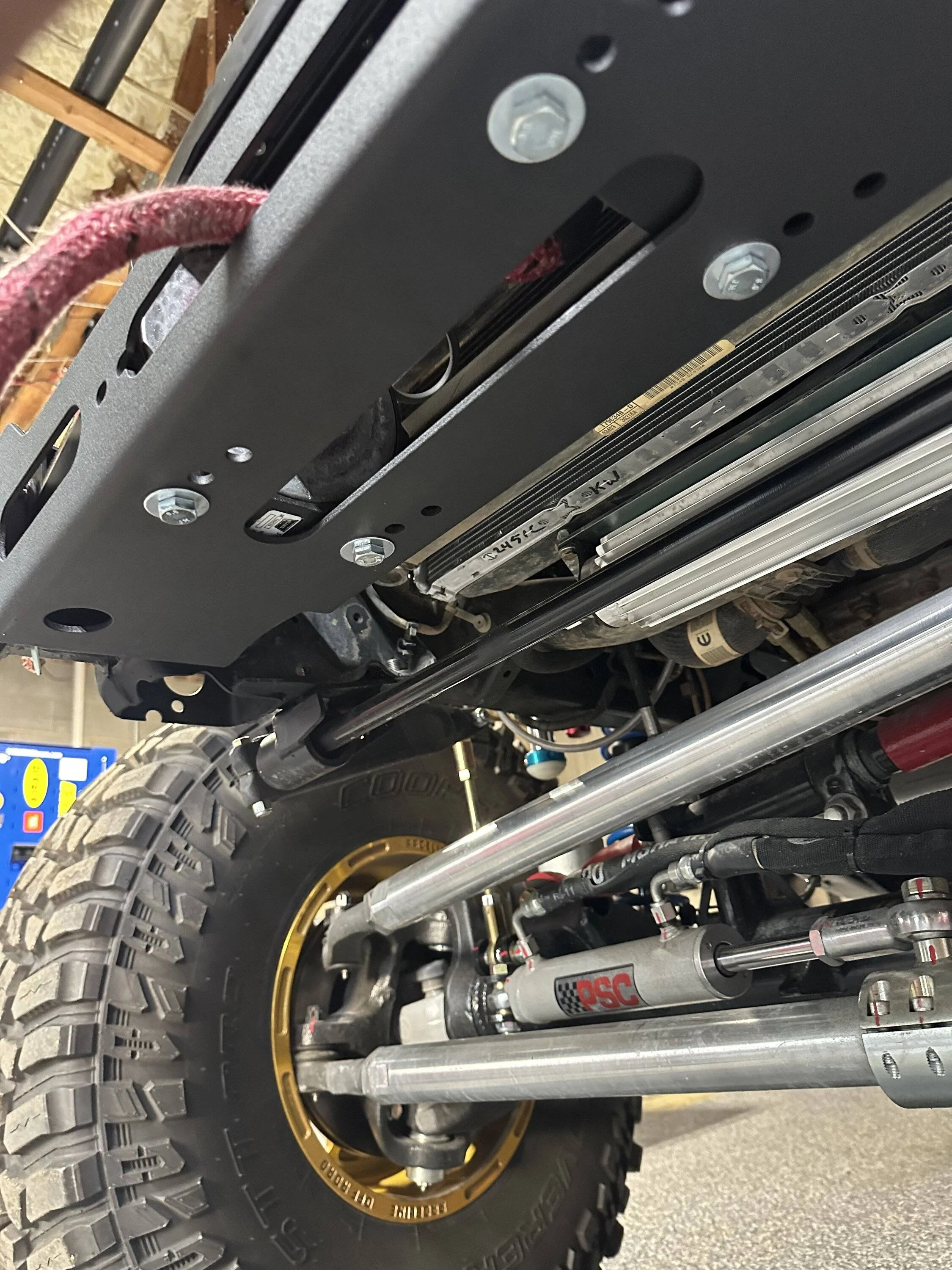

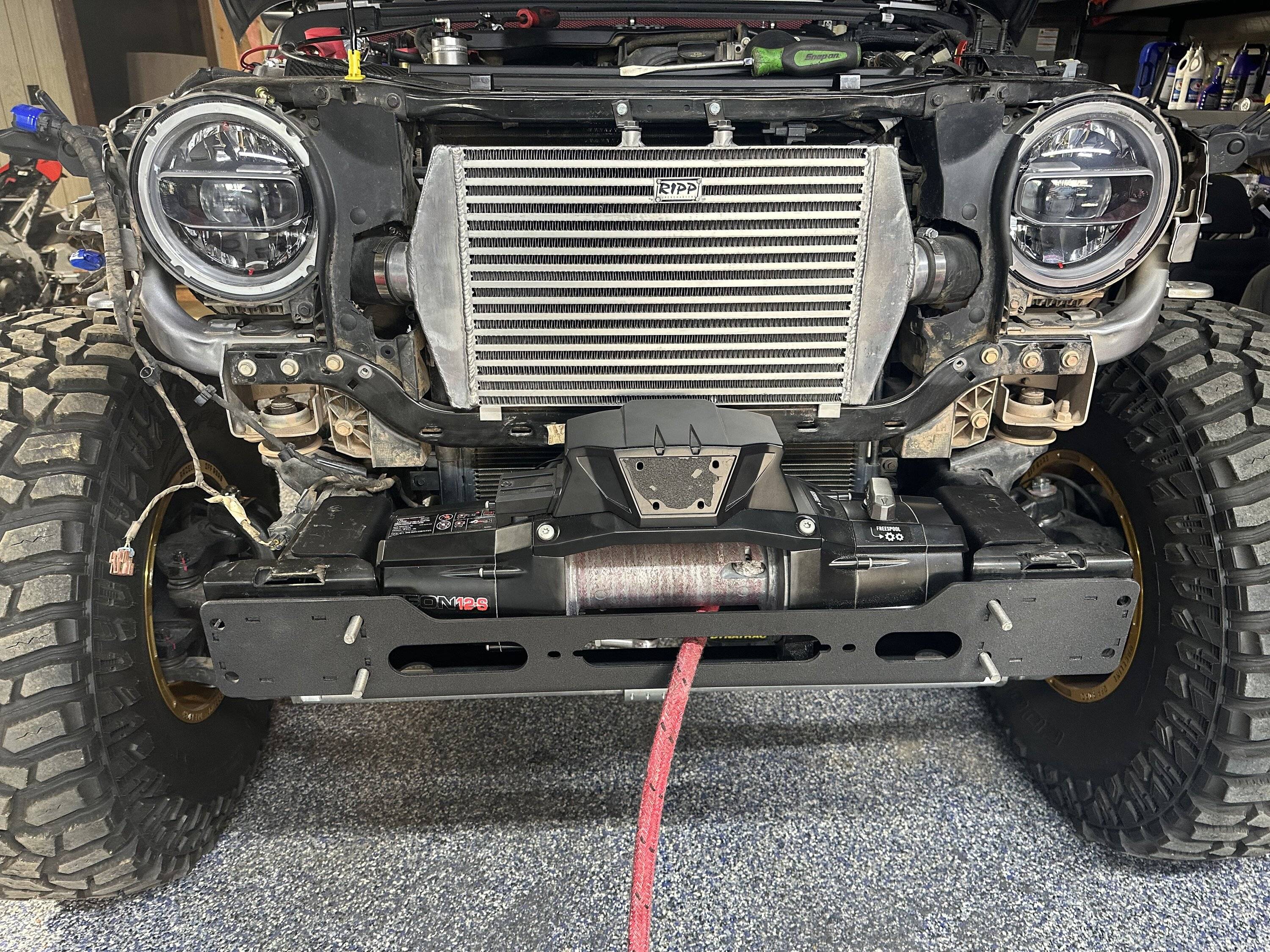

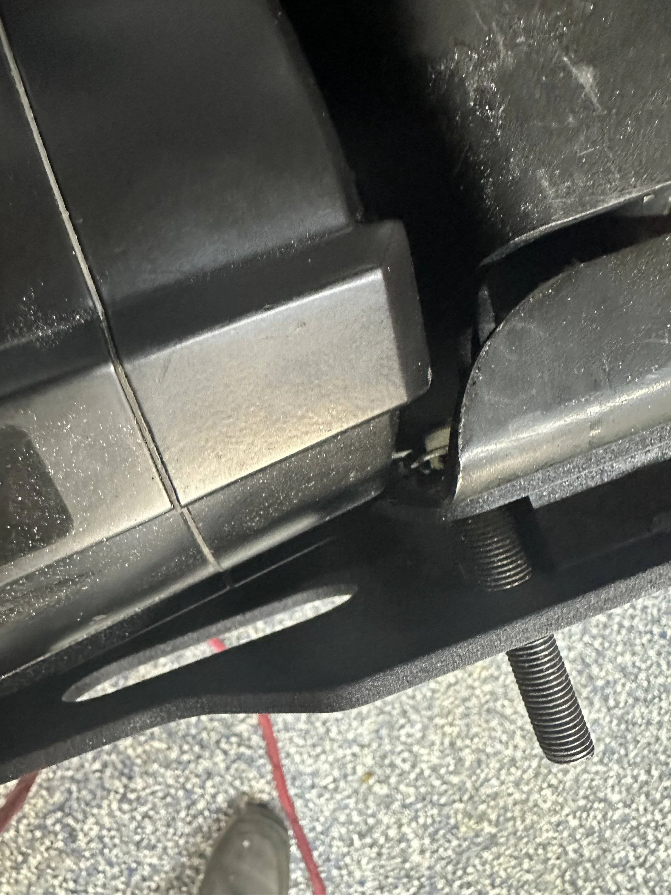

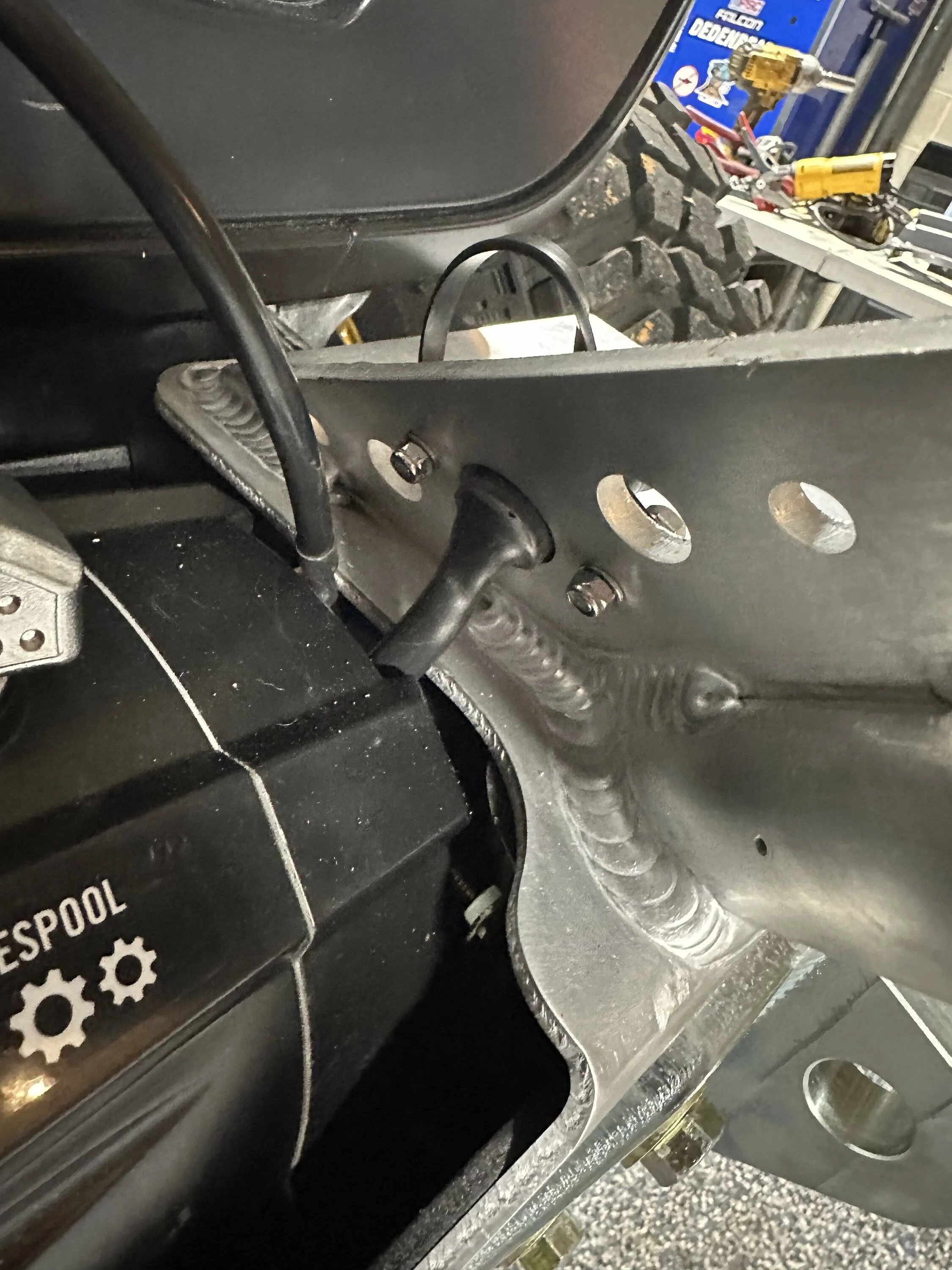

No grinding of the winch needed. It’s hitting in nearly every corner, but I just pushed it down to the plate and it went down and lined up great.

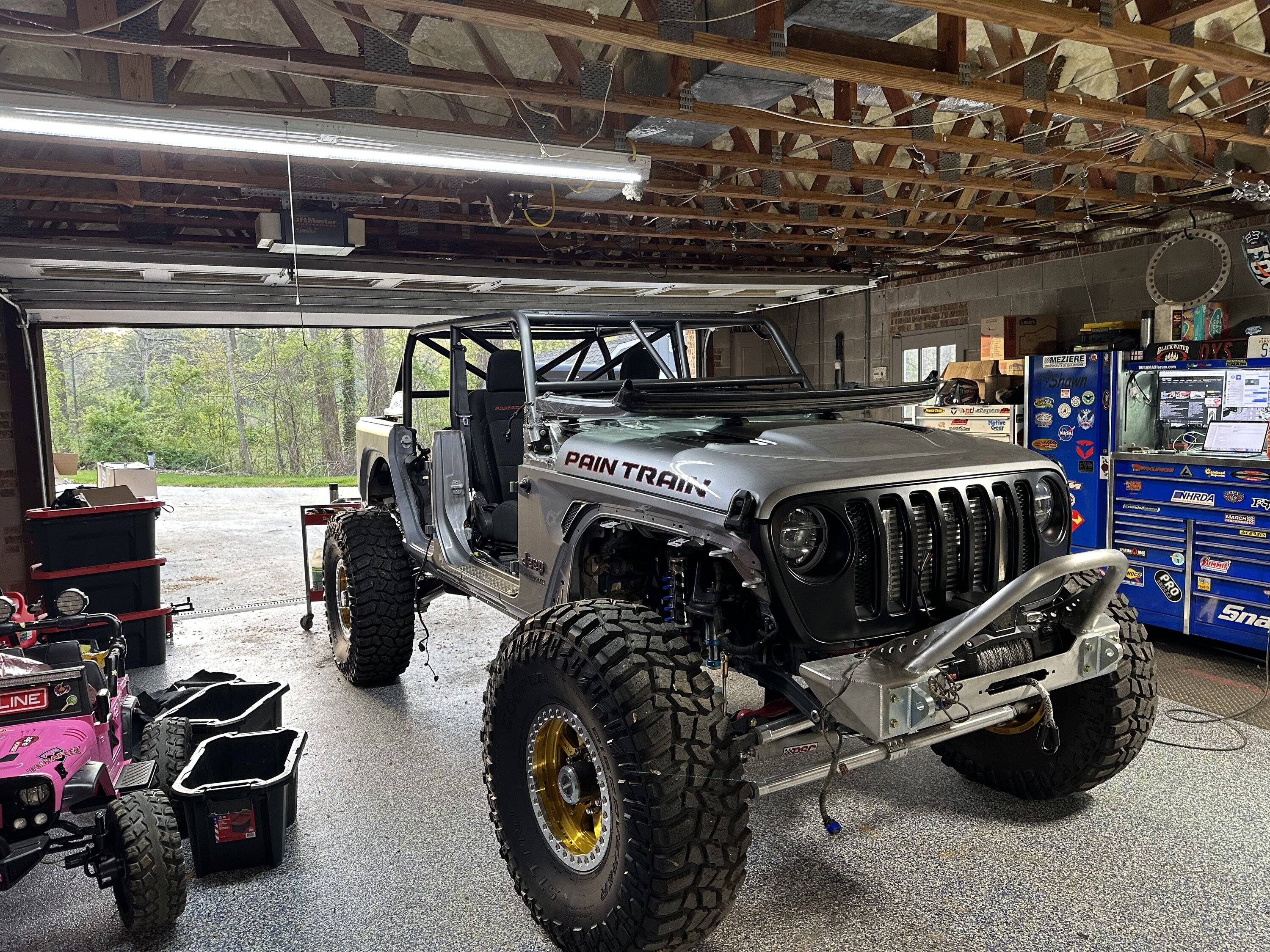

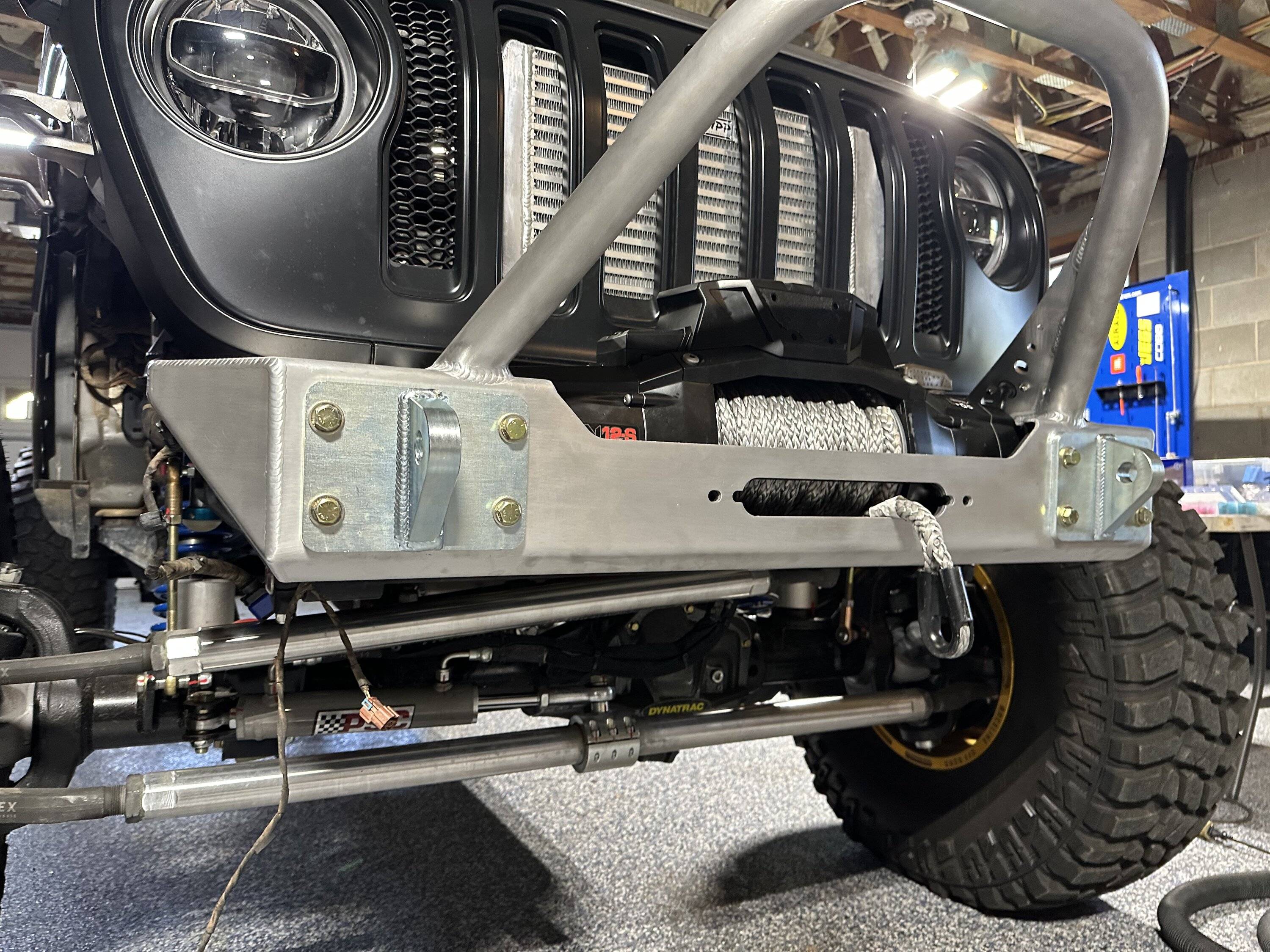

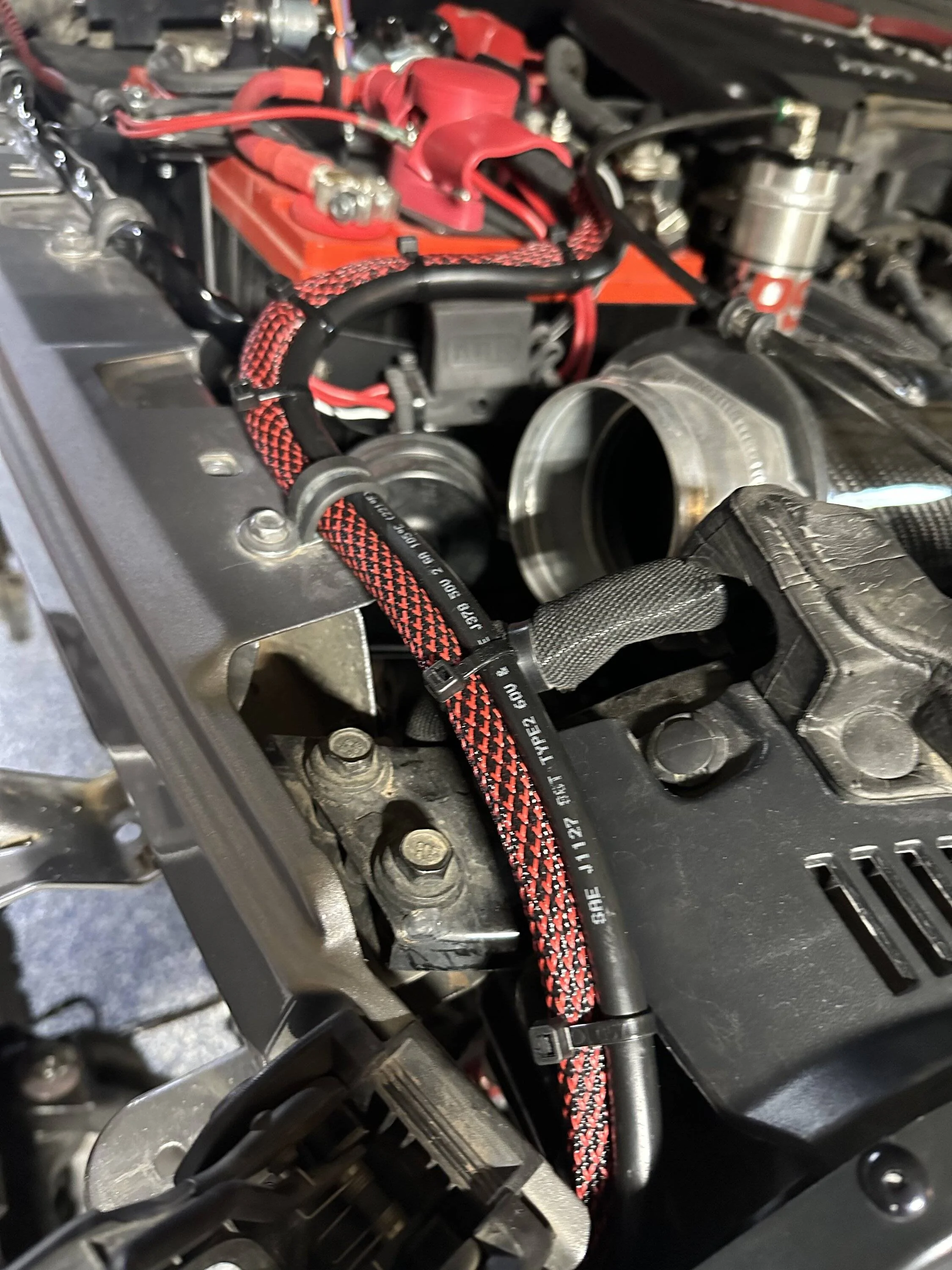

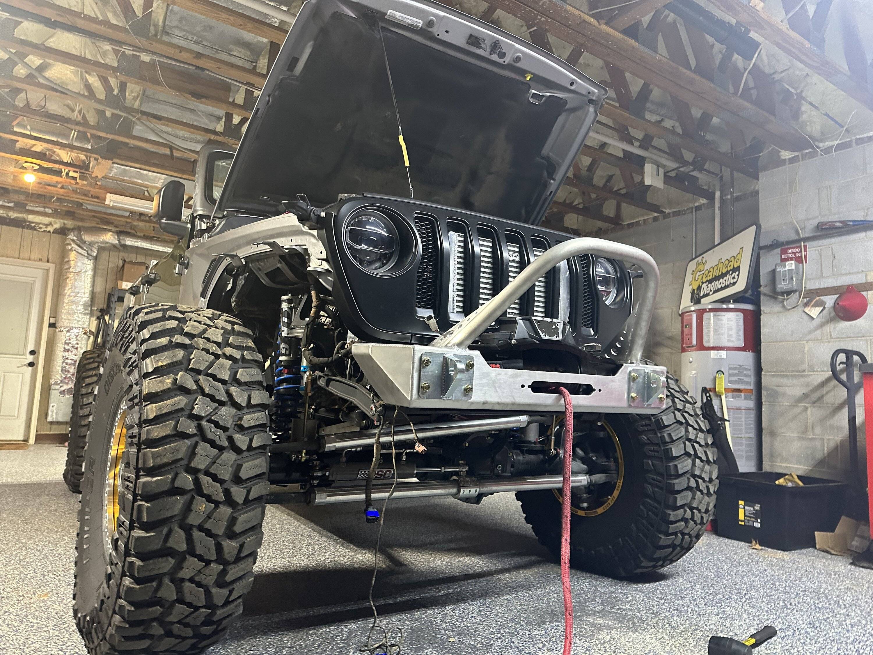

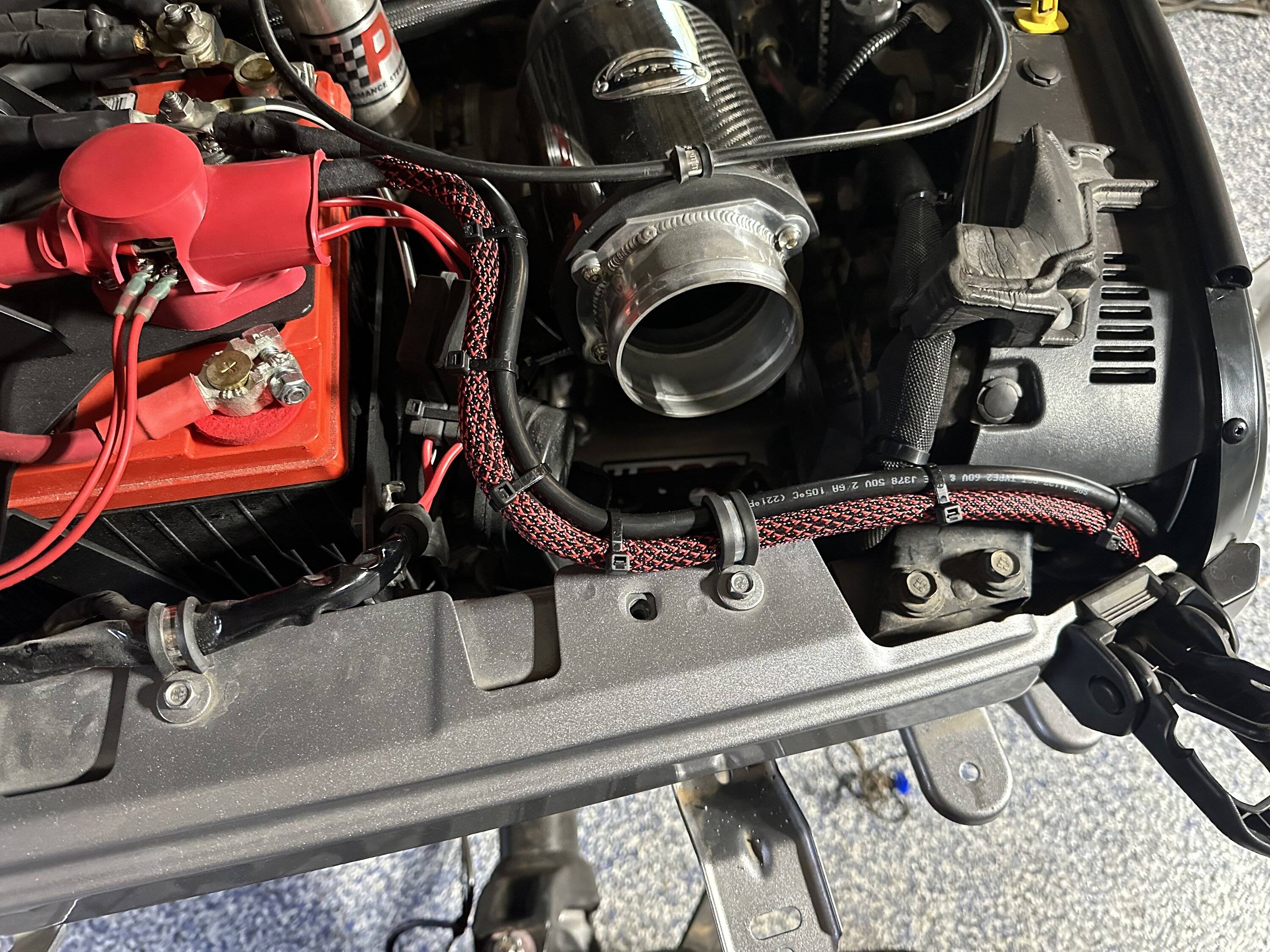

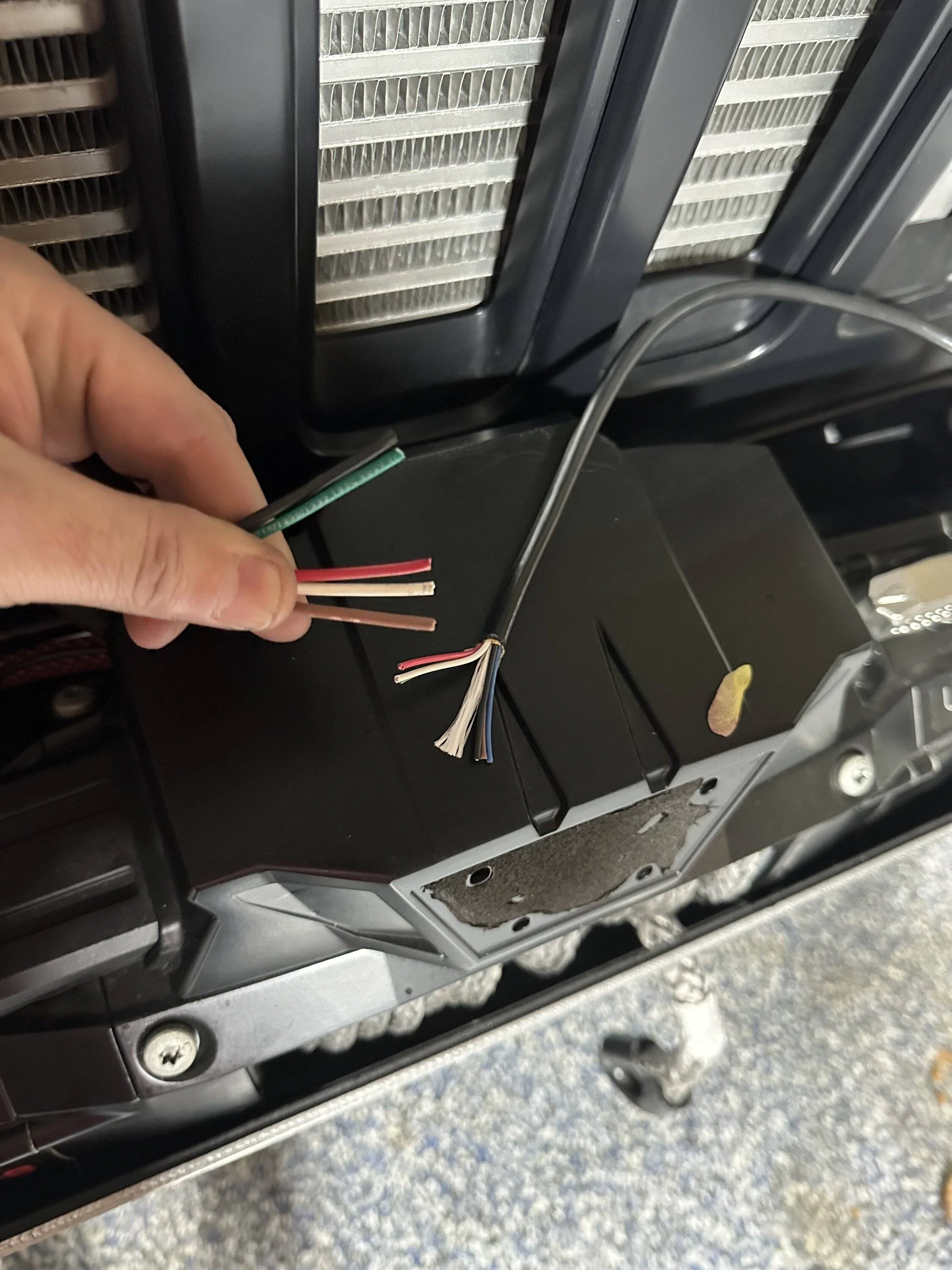

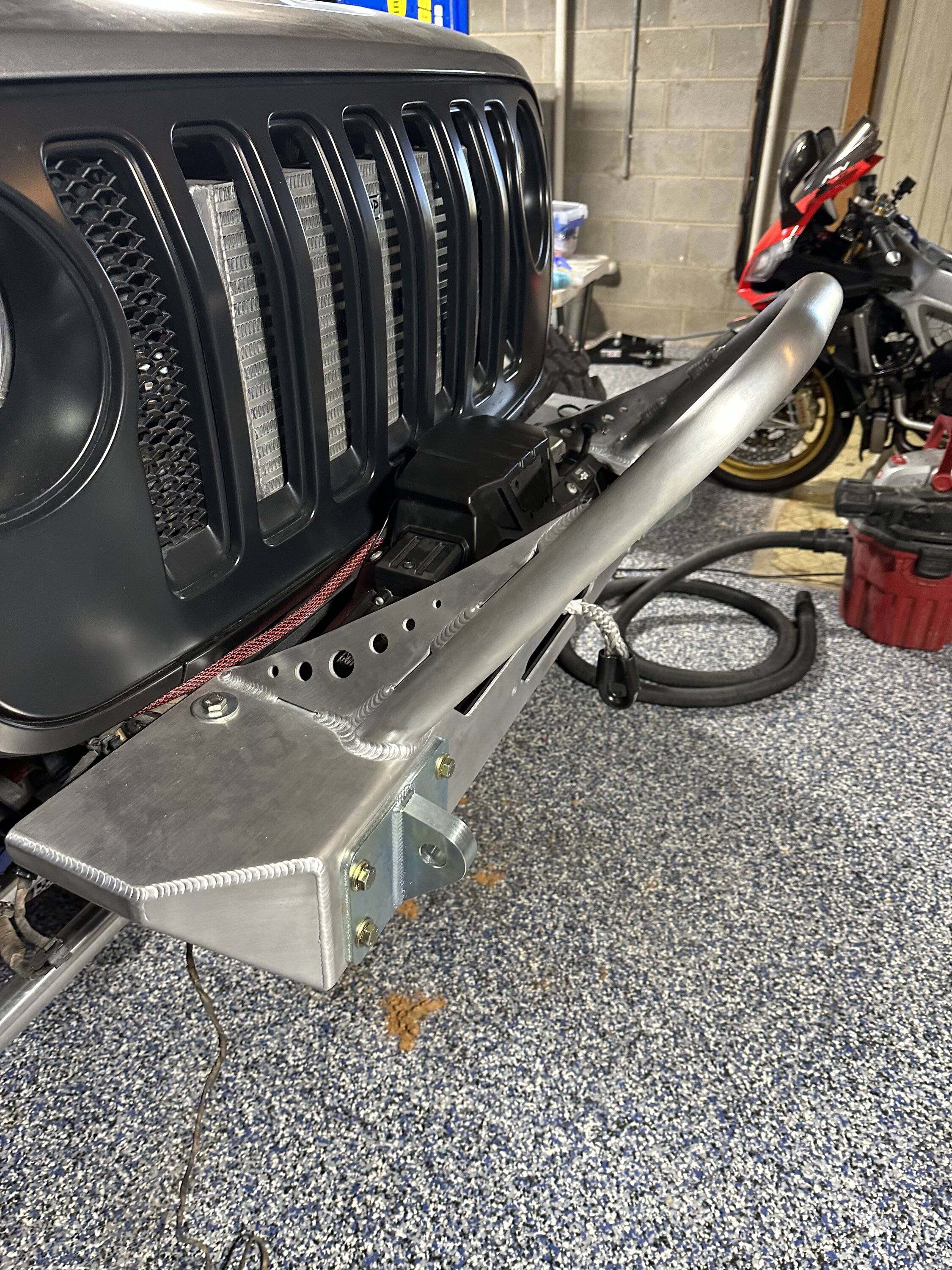

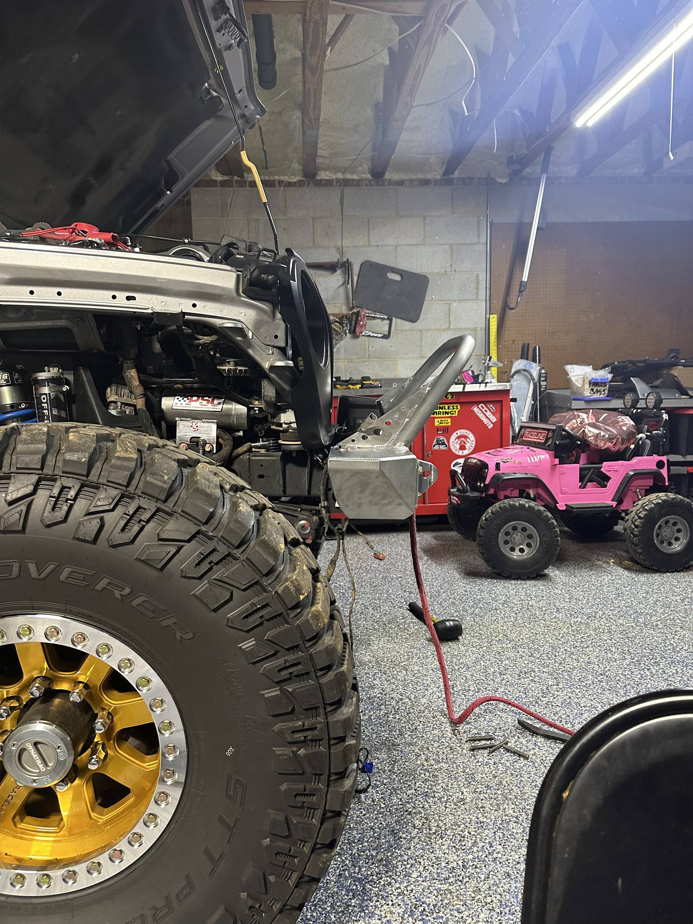

Got it all mounted up. I’ve got a little work to do to finish the winch itself. There’s no remote plug-in on the side of the control pack on this one. I’m going to run an extension cable to the cab then mount a remote switch and aux plug-in for the wired remote. One day at a time.

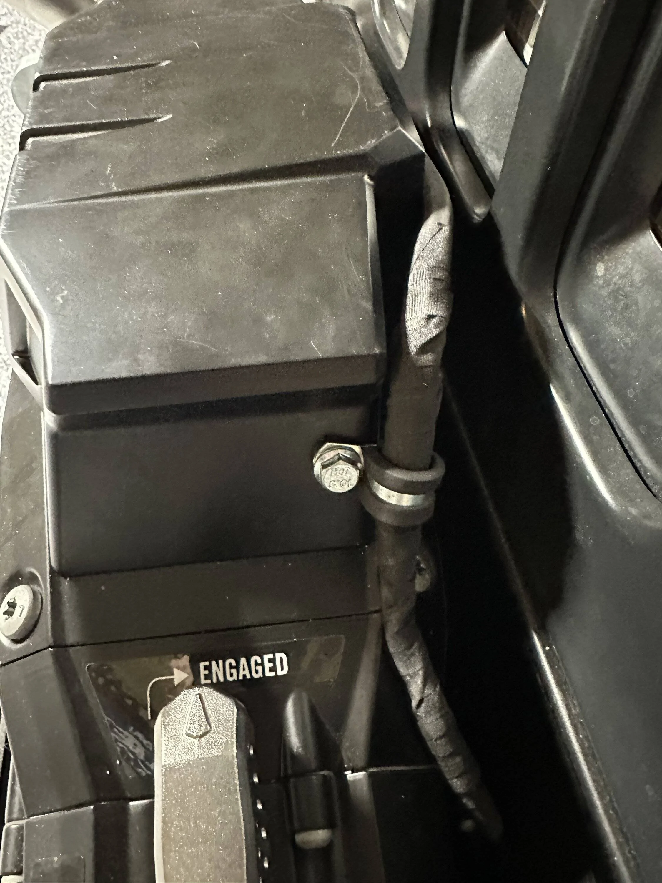

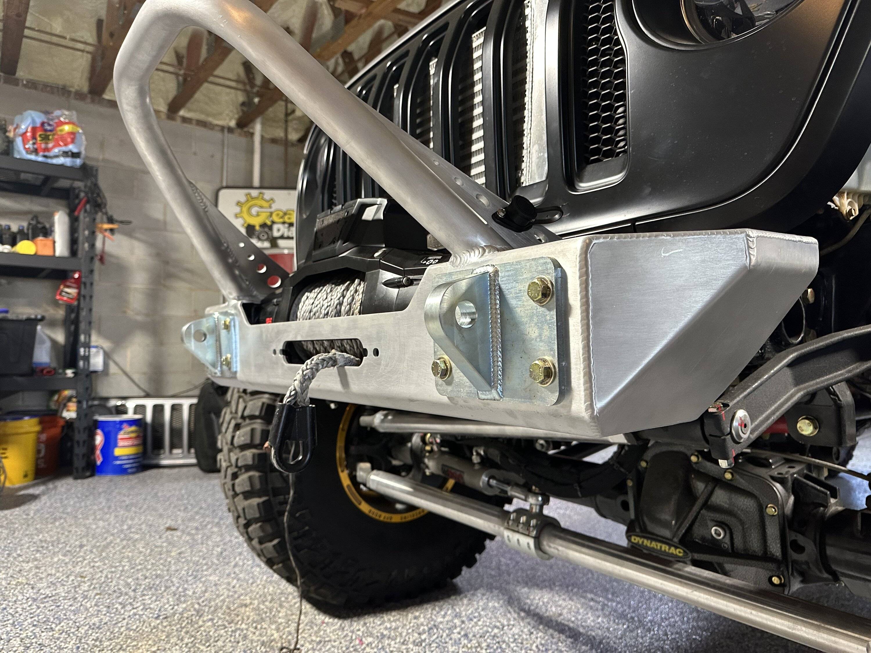

Last thing now is to get a fairlead. The winch I used, being from a Power Wagon, needed a wiring change and a remote harness. The Power Wagon 12-S has several differences from the regular 12-S, but can easily be converted. I spliced the 5 wire from the winch into a 6 wire remote plug in. The blue wire in the harness can be cut and it’s not used. Ended up mounting the remote harness to the bumper. Pretty clean looking. Need a Warn sticker for the control pack, too, I suppose.
