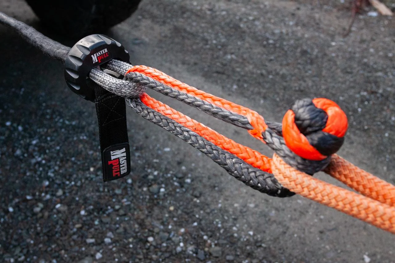

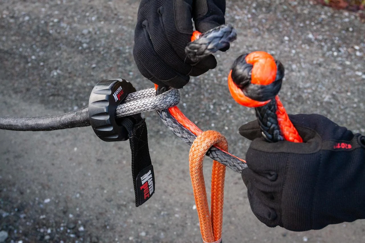

I know that this is bringing this back from the dead but Master Pull has a new option for terminating a winch line and it looks very interesting. They have added a puck to a basic spliced loop with a reinforcement to the end of the loop. http://www.masterpull.com/9mm-3-8-classic-ultralite-winch-line-17-600-lbs/
Thanks @sardog12. I like this maybe even better than the splicer. If you look at the pictures they have done exactly what I was referring to using the soft eye through a soft shackle. I guess that really answers the question of whether it is ok or not to just use the soft eye without any kind of hard end put on it.
What are your thoughts on it? You know a lot more about this stuff than I do.
I like it and am waiting for MP to start selling the "stopper" by itself so that I can get one and splice it into my winch line. Obviously they seem to think that it will work fine.

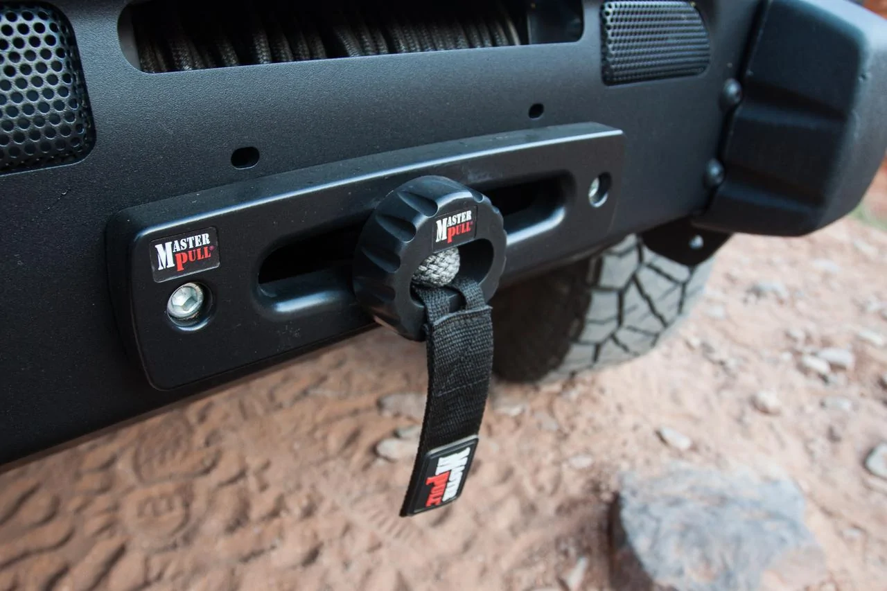

I hardly know anything about the conversation topic but on this Master Pull version, isn’t it a potentially bad thing to have the end of that eye exposed to road debris, sand, dirt right there where I assume a tight bend/pin is?
If you look closely, the rope is actually covered by a protective sheath. Notice how the weave pattern doesn't quite match the pattern of the shackle. This is the same thing that I plan to do when I set mine up. Even if you didn't use one, you could just hose off the end of the rope, making note to "scrunch" it together to make sure that any debris gets a chance to be flushed out. But, of course, that is a good idea to do periodically to clean the entire rope from time to time anyway.

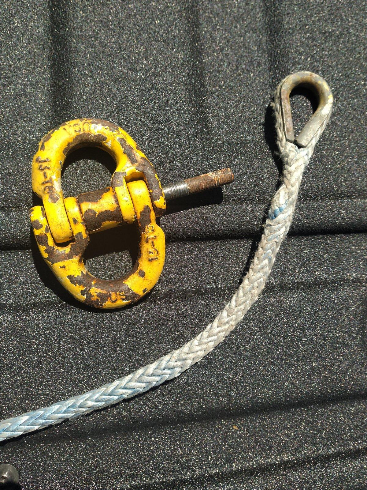

I'll dig this up again on winch lines connection's with a well used Ansteel winch line, in "service use" on a Ramsey 8 k winch for about 20 years. I never used it with a hook only the Hammer-Loc connector in photo.
The line and winch was kept covered when not in use most of the time. Many pulls close to winch max rating.
