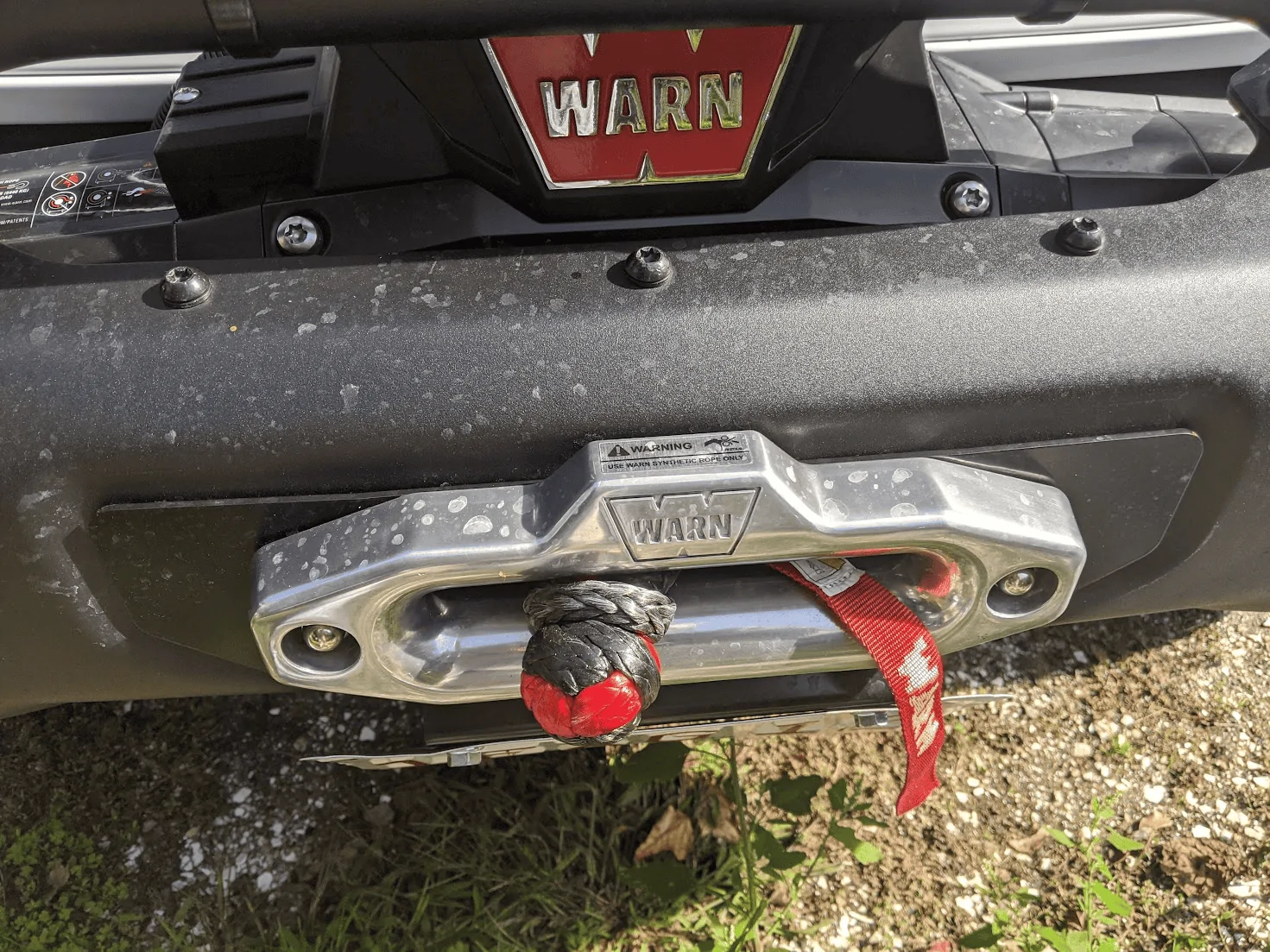

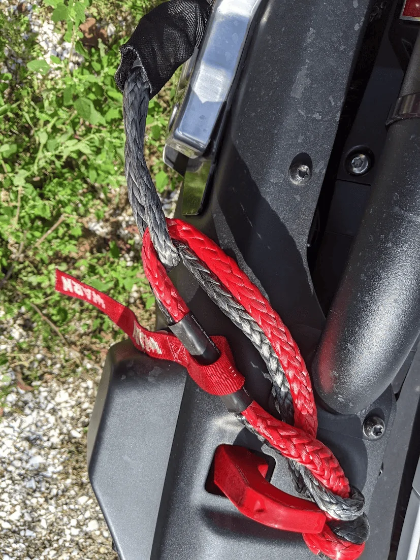

I'm running a 'no metal' setup with a soft shackle - you have to cut and re-splice the end if you want to get rid of the thimble.
You can search for "Dyneema Eye Splice Demonstration" and "Dyneema Lock Stitch Demonstration" for some videos on how to do it.
This is my plan, except I'm going to get the yankum fairlead so I can just hook the end of the line on the fairlead. Seems like a clean simple setup.
Still haven't decided on a synthetic winchline brand though.
