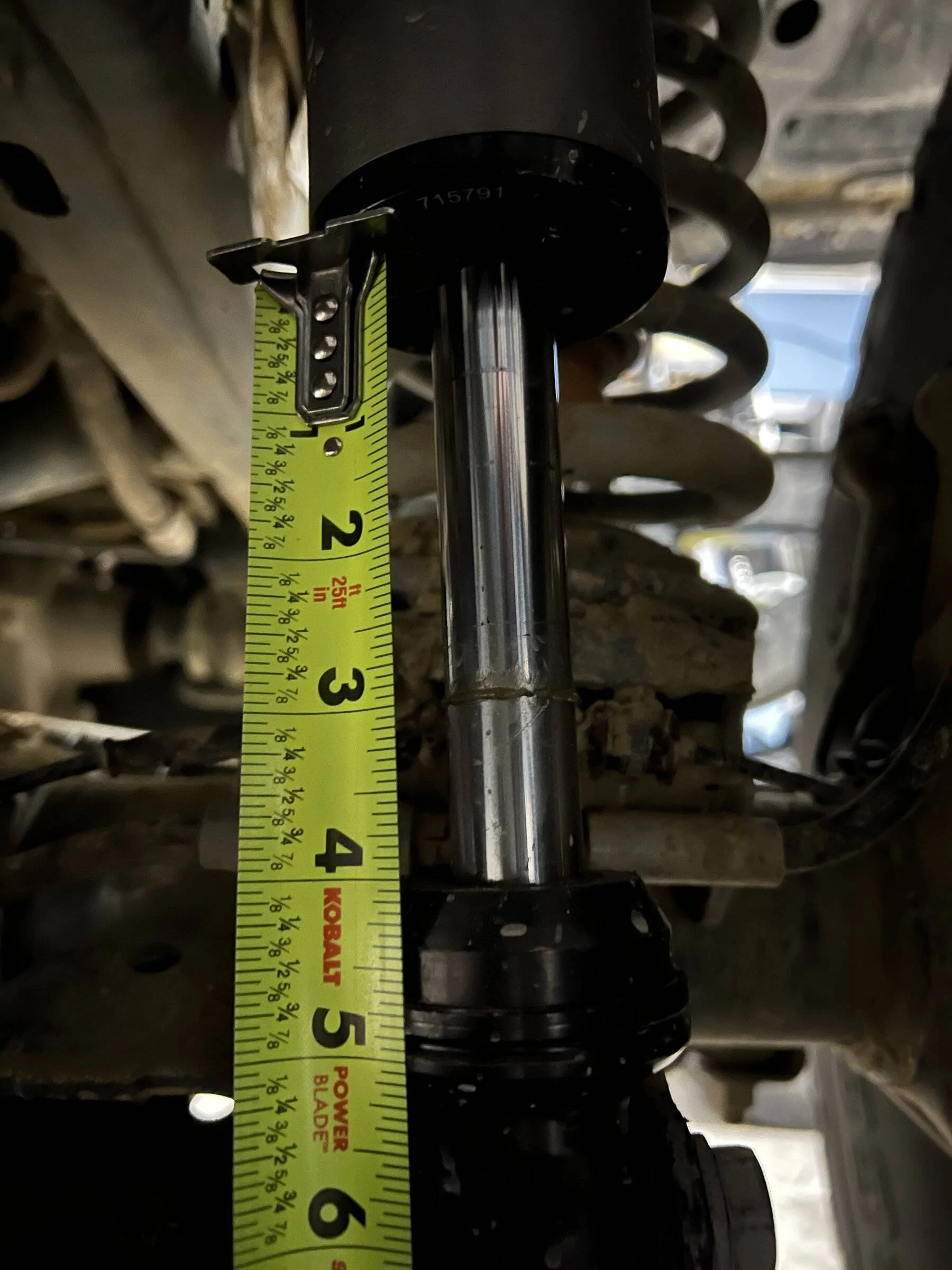

I chose to go with the Clayton Off Road 2.5” Overland+ lift for the 392. I have winch on the front which adds over 100lbs to the bumper and caused the stock springs to sag a bit compared to stock. With the Clayton 2.5” lift I’ve settled in at 1.75” of lift over stock after a week of driving and one heavy day off-road at a rough OHV park where the springs got a workout. The extra travel is very noticeable and welcome off road.
My brother has a 3.6 XR and does not experience the bottoming issues I experienced in the 392 XR. I have read of a few diesel owners also bottoming more often than they’d like so I think it’s a combination of the extended jounce towers that limit up travel to 3” and the weight of the v8/Diesel engine.
I’d suggest wheeling yours a few times before making any changes to see if you experience the same issues or not. If you do decide to upgrade I think lifting without increasing tire size gives a bigger dollar for dollar improvement to the 392 than high end shocks. However, the extra oil volume and dampening of the 2.5” shocks is also a noticeable improvement with all that engine weight bouncing around.
Pre lift:
Jeep Wrangler JL When ordering a 392, why so many XRs? 951029FD-7185-4AEB-85BF-6D7DDACB600F

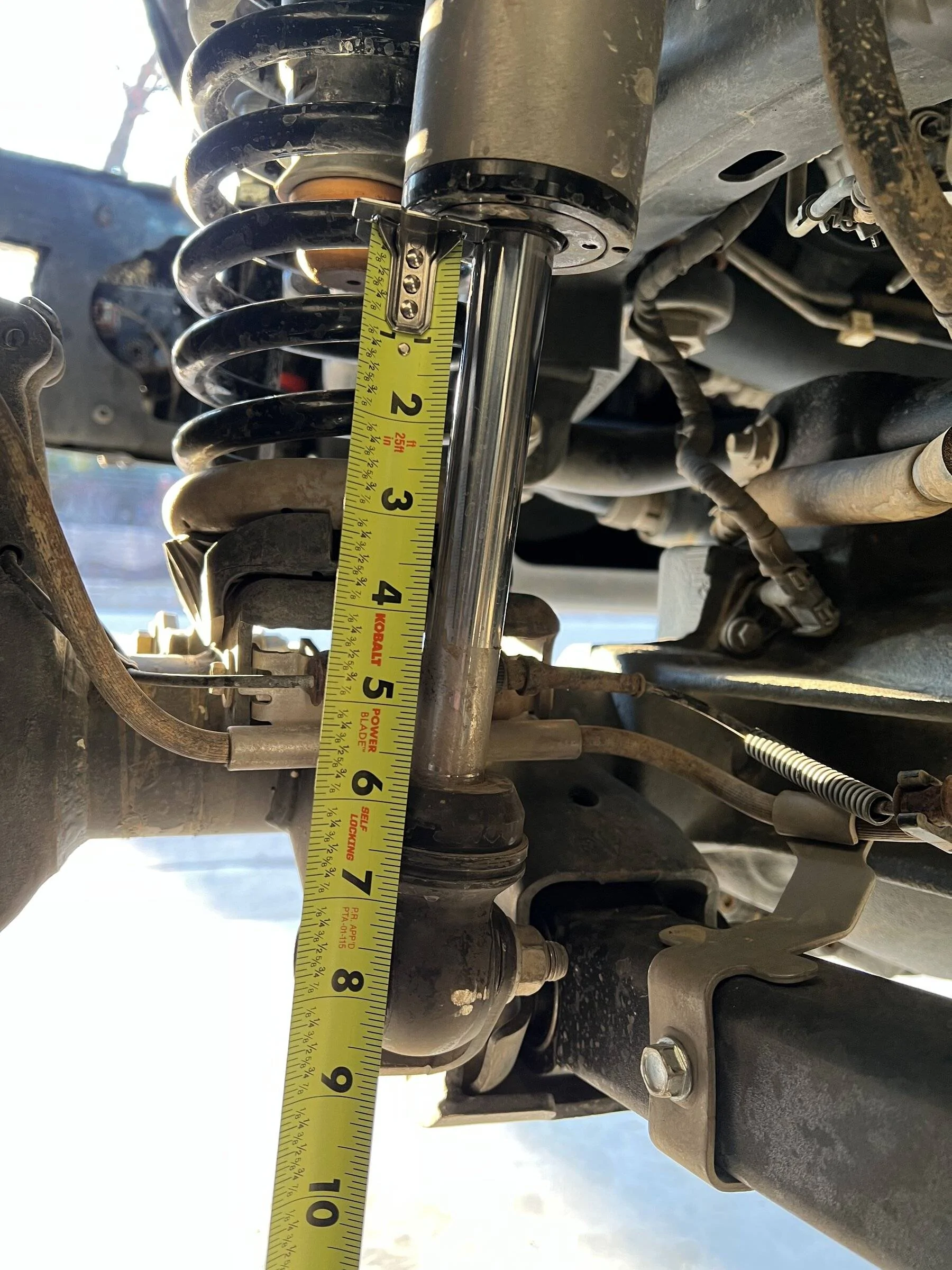

Post lift:
Jeep Wrangler JL When ordering a 392, why so many XRs? 7BE5DC72-21B3-4654-9036-231CCCFB3682

Thank you very much! That is good advice on just try out the factory suspension first. To see how it does. I also am putting a warm 12 winch on the front ( in the factory steel bumper for now).
Thanks again for the information.

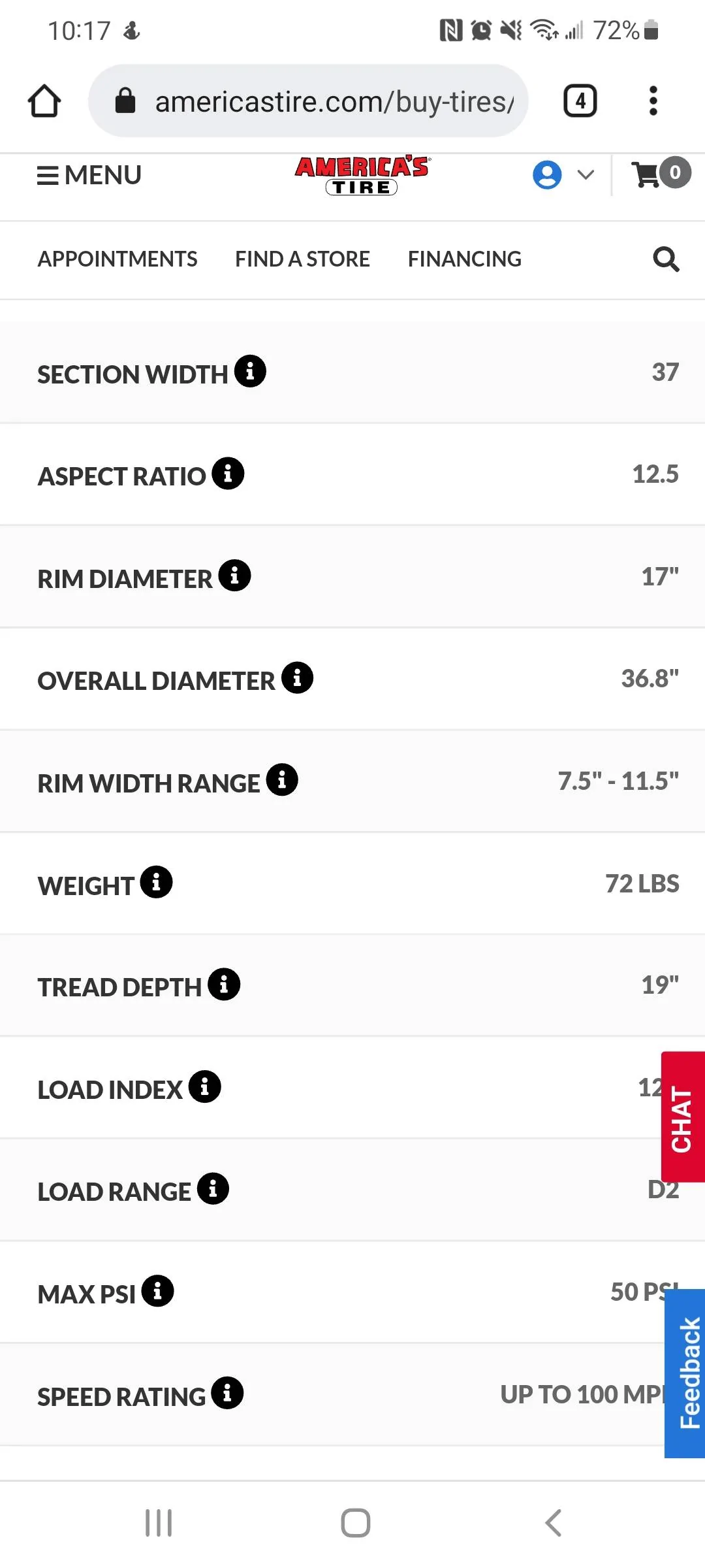

Over here too….
Please link me to a 37 that specs a 8” rim. They are all 8.5“ as the min.
Nothing is absolute, looks like milestar patagonia 37×12.50r17's are in fact specd for a 7.5" wheel according to America's tire? Not that we didn't know for a fact 37x12.50s fit stock wheels, but here's one that is within spec for the nervous types out there.
Jeep Wrangler JL When ordering a 392, why so many XRs? Screenshot_20220117-101758_Chrom
