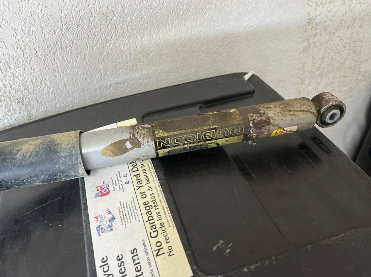

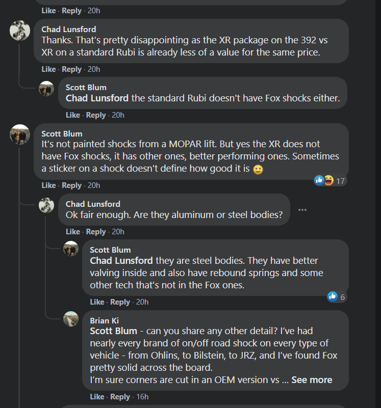

Scott Blum, a product manager at Jeep that's active in the 392 Facebook group and addresses things like that on occasion disagrees

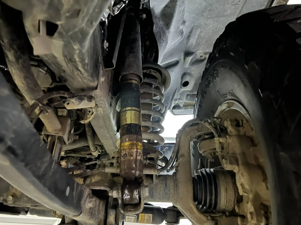

I have a 392XR and I love the 35" tires and the 4.56 gear ratio. I even like the fender flare extensions. I am not, however, sold that the Mopar shocks Jeep equipped instead of the Fox 2.0 are anything but a downgrade.
The Mopars handle great on the highway but they are quickly outmatched by the 392's heft and heat on the dirt and rocks. The combination of dampening heat and engine heat will make my front shocks almost too hot to touch on rough trails and I believe the stock shocks turn into a foamy mess and lose their ability to progressively dampen the axle.
My right front Mopar shock lasted less than a month before it started leaking.
Jeep Wrangler JL When ordering a 392, why so many XRs? 70C69084-5573-4170-8A20-02FB1284A147
Jeep Wrangler JL When ordering a 392, why so many XRs? 585B7317-C4E9-4363-ACA2-74167527F990
Upgraded to Fox 2.5DSCs and absolutely loved the way it handled on the road. Dialing up the low-speed compression basically eliminates body roll and makes cornering the 392 more precise. Off-road the 2.5's stopped the fading problem of the Mopars but even with the high speed compression maxed out the 392 would still bottom out multiple times per day on the trails. Lifting the Jeep has given the 392 5" of up-travel instead of 3" and it is a completely different animal on the trails. Slow rocky trails and smoother 4Hi trails are both a joy with the added travel. The suspension personality and capability finally match that of the engine.
