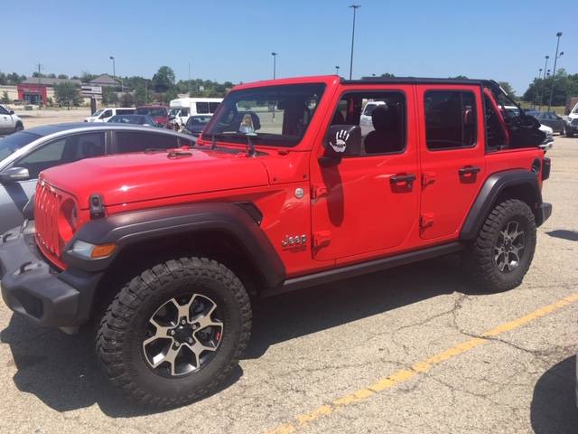

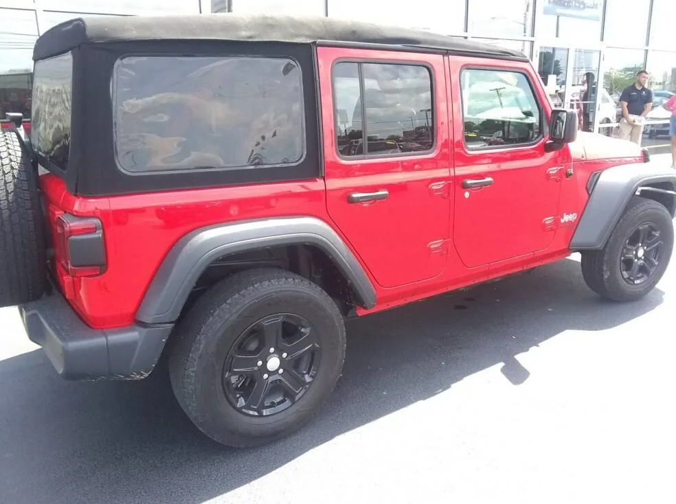

This is a '19 Sport with the top picture all stock and the bottom pic with Rubicon tires, wheels, and suspension that I just did last weekend. If you are satisfied with the looks of a Rubicon it is a pretty good deal. In my opinion it really beefs up the look of the Sport models. There is $1,250 invested in this setup, including 5 wheels and tires. The tires/wheels and suspension were from different sellers but both within 20 miles of my house and there were multiple choices of both setups for sales on Facebook Marketplace.
If you do some searching there are multiple springs used on different models that gain different amounts of lift, but in general "most" Rubicon springs will sit taller than any Sports. But doesn't hurt to check the part numbers between stock and what you may be buying to verify. The good news is that the parts tags seem to be pretty durable as the '19 with over 40k miles in the salt belt still have readable part numbers on the springs.
Just as a side note the Rubicon models have different fender flares that sit up about 2" higher, so even with the exact same suspension and tires a Rubicon will look like it's sitting higher.
