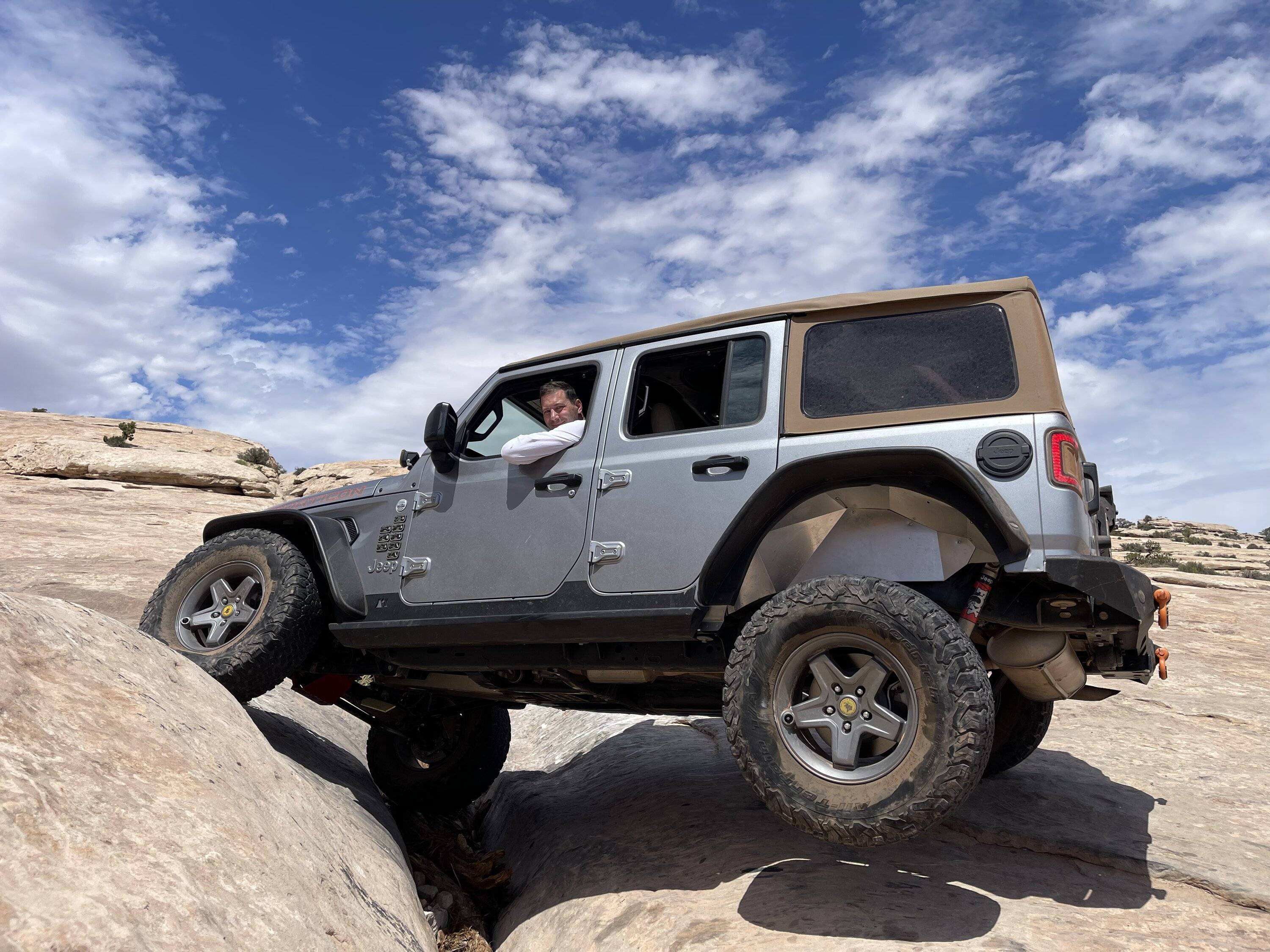

Interesting. I guess each jeep is different. I had some rubbing on fender liners on Moab trails with rubicon wheels and rubicon suspension with 1" spacers up front. With 315 KO2's I had minor rubbing on fenders with 2" spacer lift, 2" bump stops, wider Rubi axles, +10 offset wheels and diesel rubicon springs. And Rubicon supposedly fits 35" with no lift.
Front wheel lightly touches the top part of the fender in this picture.
I'm thinking because the offset of those wheels? if you were on stockers it would prob not rub fenders as much? And I was talking 33's, not 35's.

In 4 days of wheeling Moab, I didn't experience any rubbing. And that was over several Badge of Honor trails.

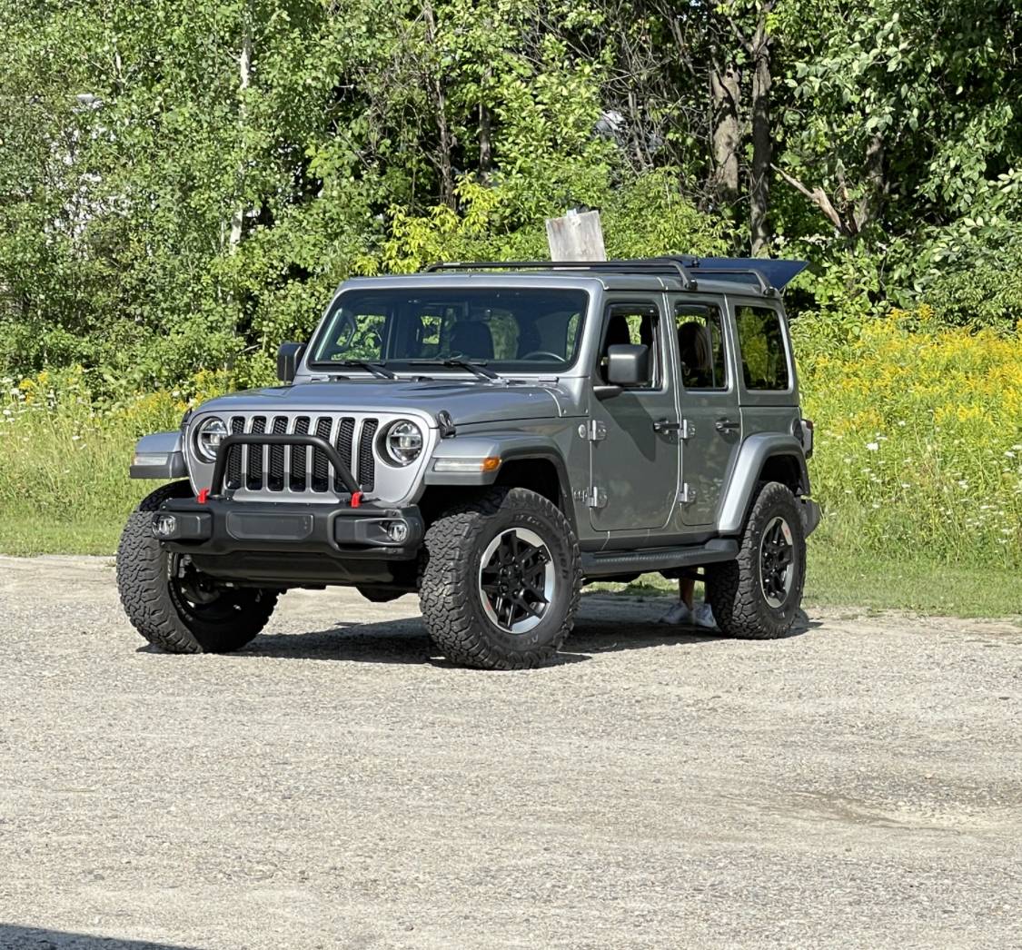

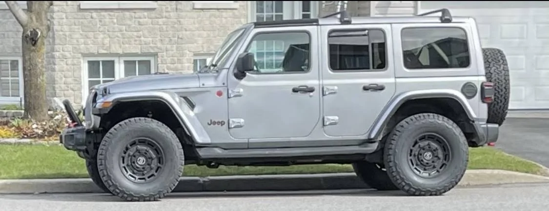

I went through all the tire sizes from stock to 35s, and can tell you without a doubt that the very best set-up for looks without too big an impact on performance/driving fun is Rubicon take-offs (285/70r17 wich are considered 33 inch tires) with a levelling kit. I recommend the Teraflex levelling kit that consists of 2 inch front and 1.5 inch rear coil spacers. Don't forget that your Sport is 0.75 inch lower than Saharas, and 1.5 inch lower than Rubicons. Keep that in mind when you read other comments, hence why I recommend the Teraflex kit.
As soon as I went to 34 inch tires, I totally fealth the added weight and couldn't ignore the impact on gearing as driving pleasure was replaced by frustration and my transmission kept hunting for gears on the highway. I couldn't justify driving and enduring a vehicle worth that much as if it was a beater with transmission problems. I installed a Hikeit X9 throttle controller, and although I was impressed with its impact on throttle, It didn't change the constant transmission gear hunting.
So after considering going back down to 285/70s, I decided to bite the bullet and have it regeared to 4.56 and install 35s. Now my friend, we are talking :) My Jeep looks killer AND turns those 35s as easily as it did the stock tinny tires. Kong Happy :)
1st Pic: 285/70r17 (33s) Rubi take-offs
2nd pic : 305/70r17 (34s) which was too much for stock gearing.
3rd pic: 315/70r17 (35s) with 4.56 gearing.

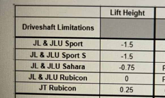

Couldn't tell you as I'm not too familiar with the Willy's. In the dealer Charts, The Rubicon suspension is considered the ''Standard'' and Sahara is -0.75'' and the sport -1.50''

Here you go:

Here you go:
too bad the willys isn't on there. And also, I wonder why the sahara is higher as I thought they had the same springs (or at least net the same height).

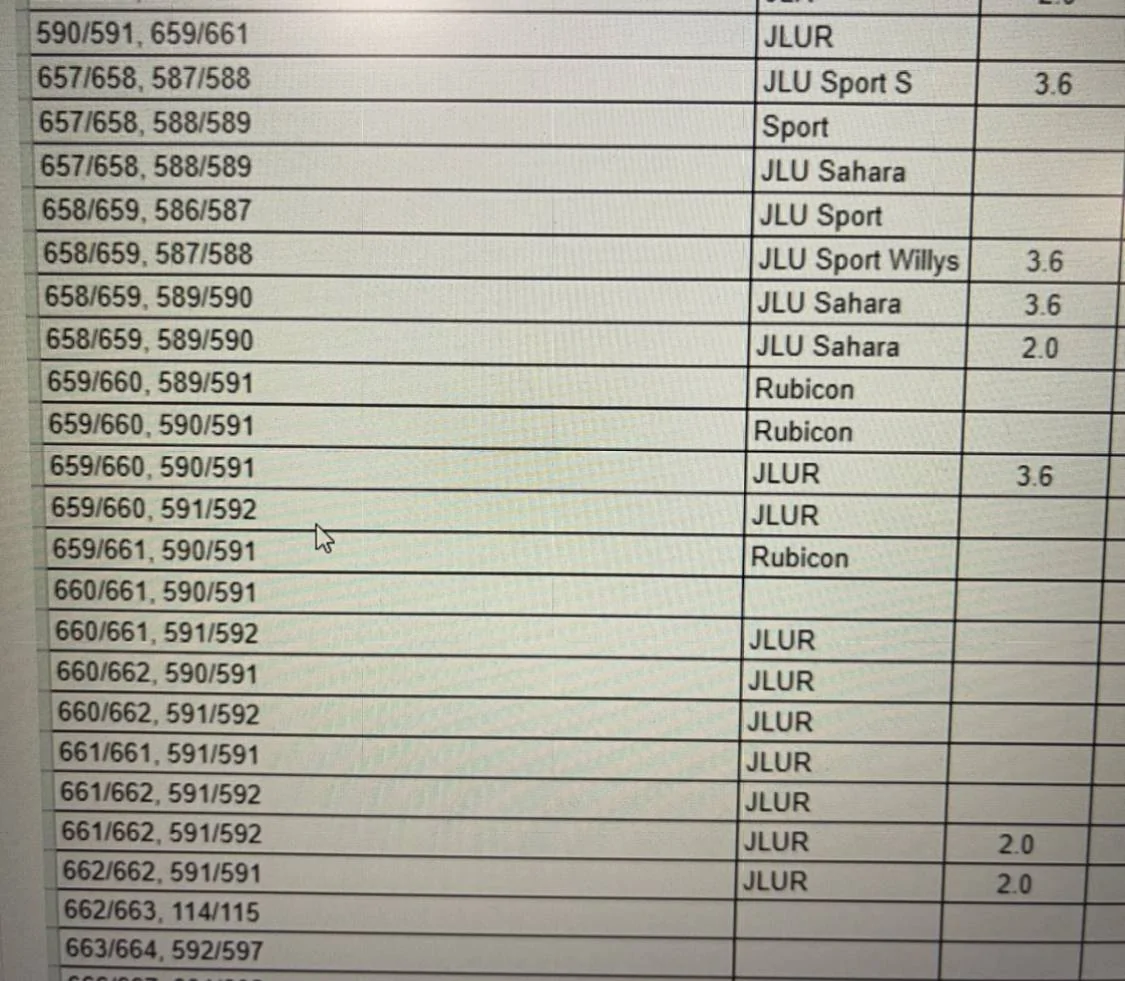

well, I know that my Sahara with the 3.6 has the same front springs as the Rubi with the 2.0 I realized it after buying a rubi take off suspension, omitting to ask the seller which engine he had. the rear was one number lower on each side. I have 89-90 and Rubi has 90-91
Also found this. Willys has same front as Sahara, but same rear as Sport?!
yeah I was just about to say, I doubt they'd make the willys sit shorter than the sahara. I know the willys has the rubi shocks, but the springs seem to be all over the place from what people post.
