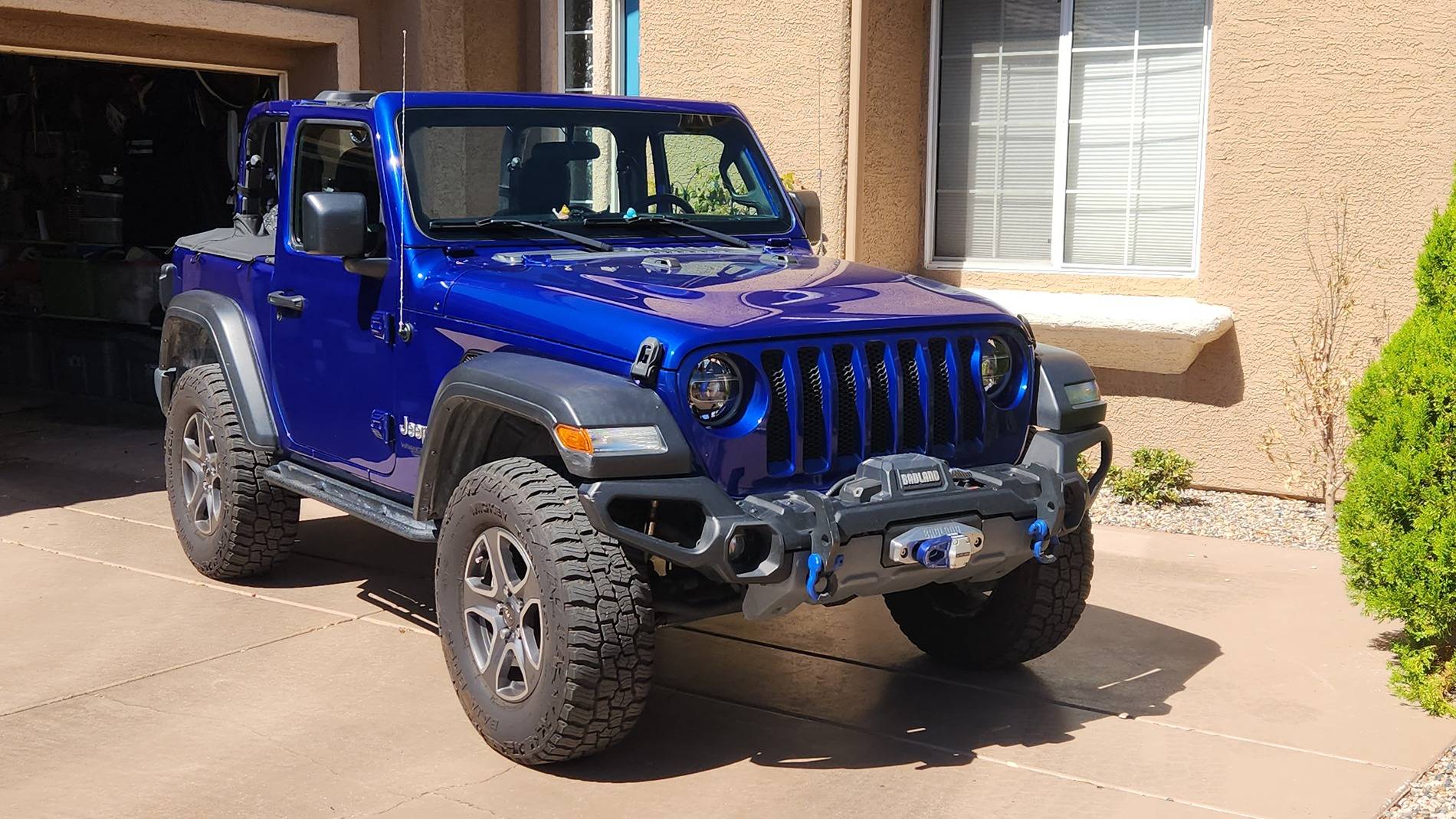

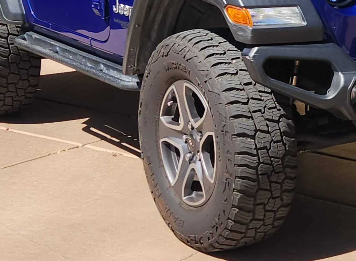

I moved up to 285/70's - (33") and the difference is minimal as far as ride hight, but the look is much more aggressive.
I do have a 2.5" lift, but you can run that size stock with no problems.
Jeep Wrangler JL Wheels and tires... school me 20241029_033935
Jeep Wrangler JL Wheels and tires... school me 20240816_104137

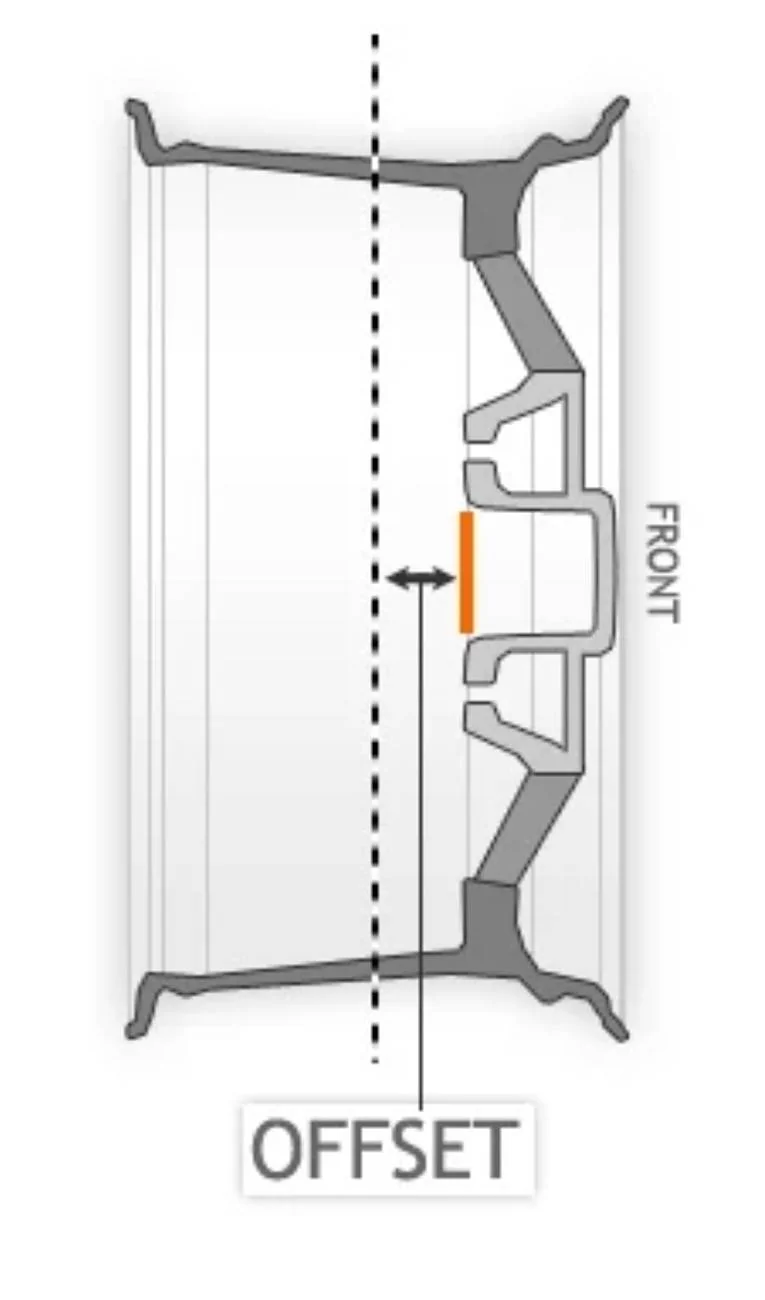

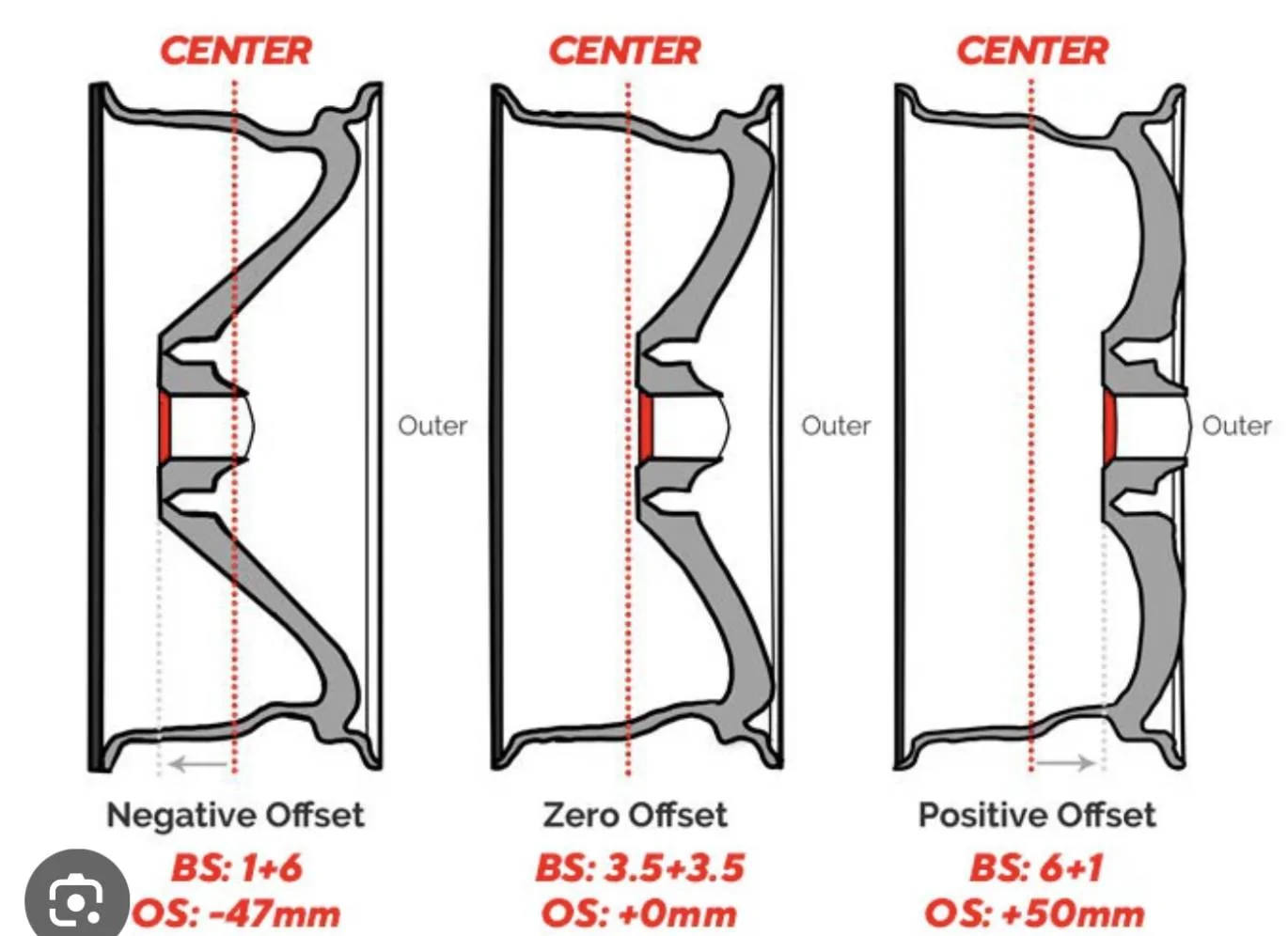

Pictures worth 1000 words.
Jeep Wrangler JL Wheels and tires... school me IMG_2038
Jeep Wrangler JL Wheels and tires... school me IMG_2037
