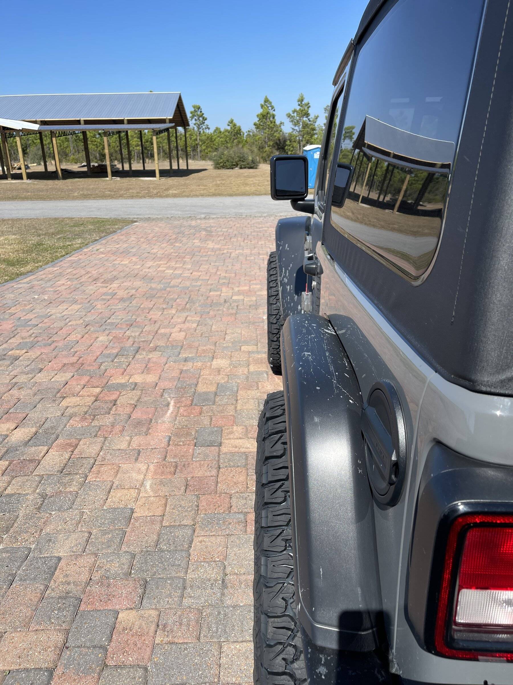

Here’s my poke with 0 offset. I personally wouldn’t run spacers, I have no particular reason, only I don‘t like the idea.
My fenders are now chopped, so they stick out a bit more.

Noticed you have a Sahara, my axles are wider. So they probably won’t stick out as much for you.

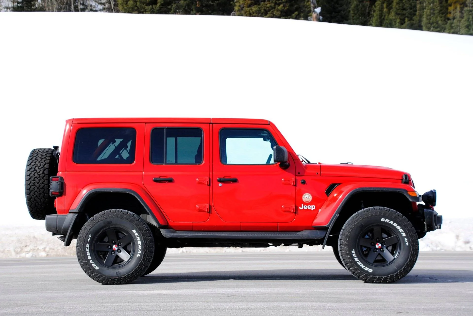

Quadratec wheels come with the right rim width and offset, and are usually cheaper than Rubicon takeoffs to boot.
