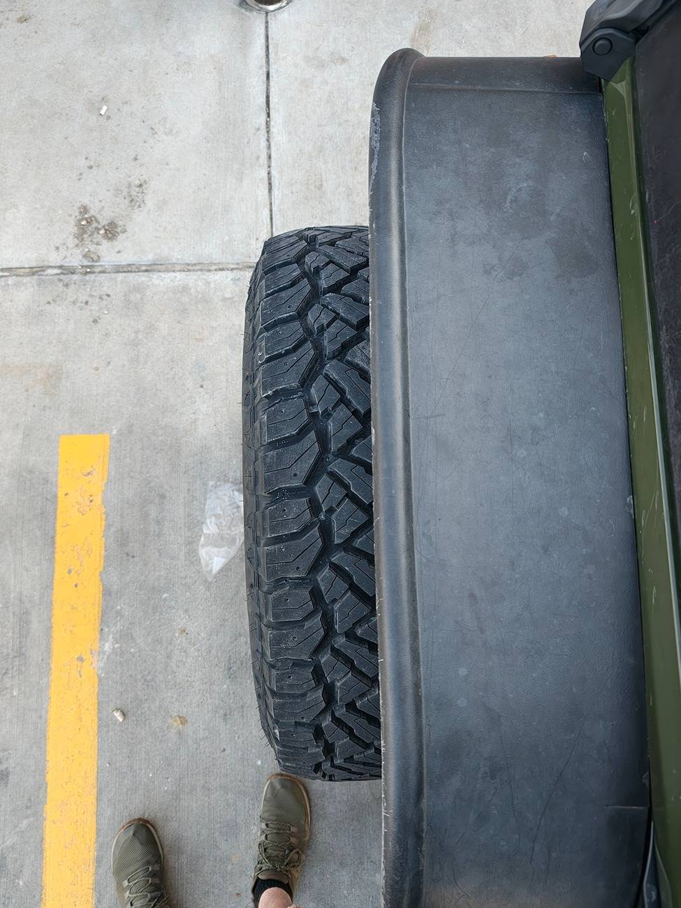

Here's my current poke past the bushwacker fender flares I'm running...Ohhh, That does make sense.

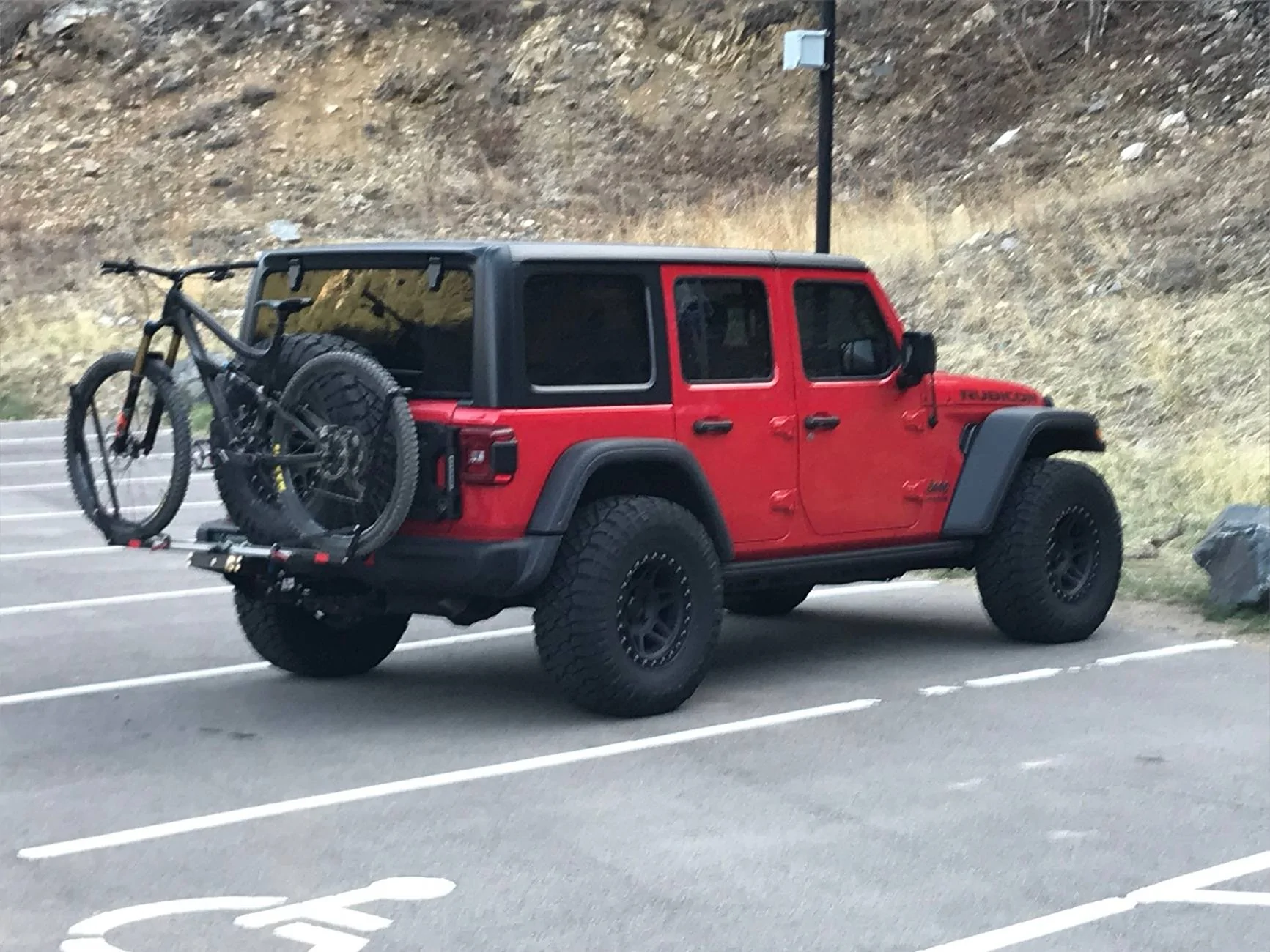

I also went with 0-offset wheels on mine, in my opinion it's exactly the "right" amount of poke. Looks nice and aggressive, but not to the point of ridiculousness. That's with 37x12.50 tires. If I had bigger tires I might want more poke.I always use this site for offset visualization - https://tiresize.com/wheel-offset-calculator/
Stock Rubi wheels have an offset of +44mm. Going from +44 to -38 will push each wheel out 3.23 inches. That's a lot of poke.
If it helps any, I just went from stock wheels to Method MR703s with 0mm offset. Pushed my wheels out 1.73 inches. Went from no poke to this. Going from this to -38mm offset pushes them out another 1.5 inches.
