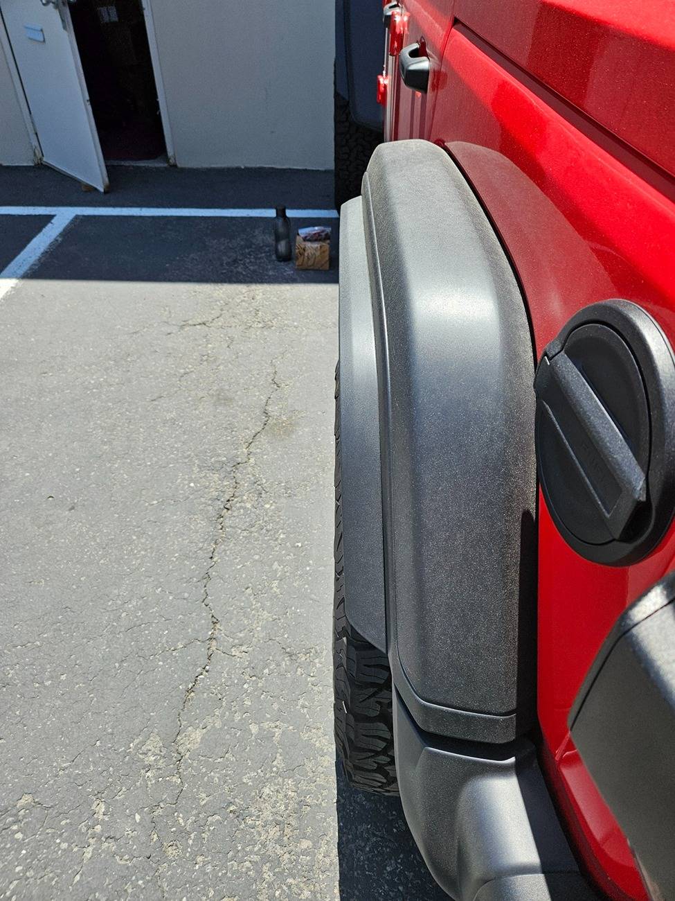

2024 JLUR-XR

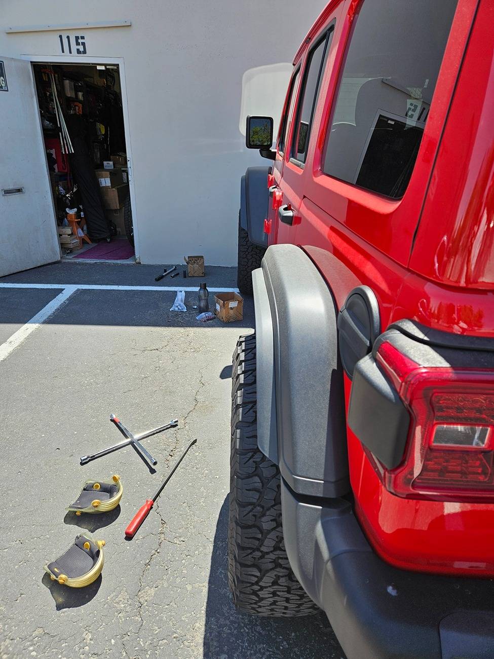

This is stock
Jeep Wrangler JL -12 or -38 offset 20240517_124918_resized

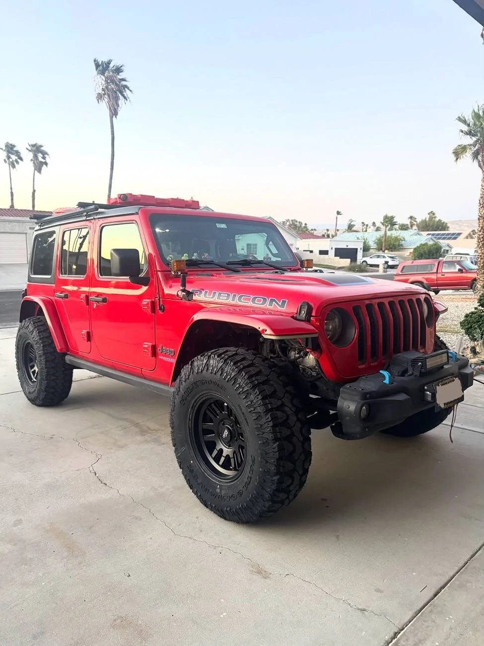

This is with a 1.75" spacer with stock tires
Sorry I can't remember what the B/S was stock I think it's 5".
This should be 1/4" more both sides than -38 which is 3.5"
Jeep Wrangler JL -12 or -38 offset 20240517_131752_resized

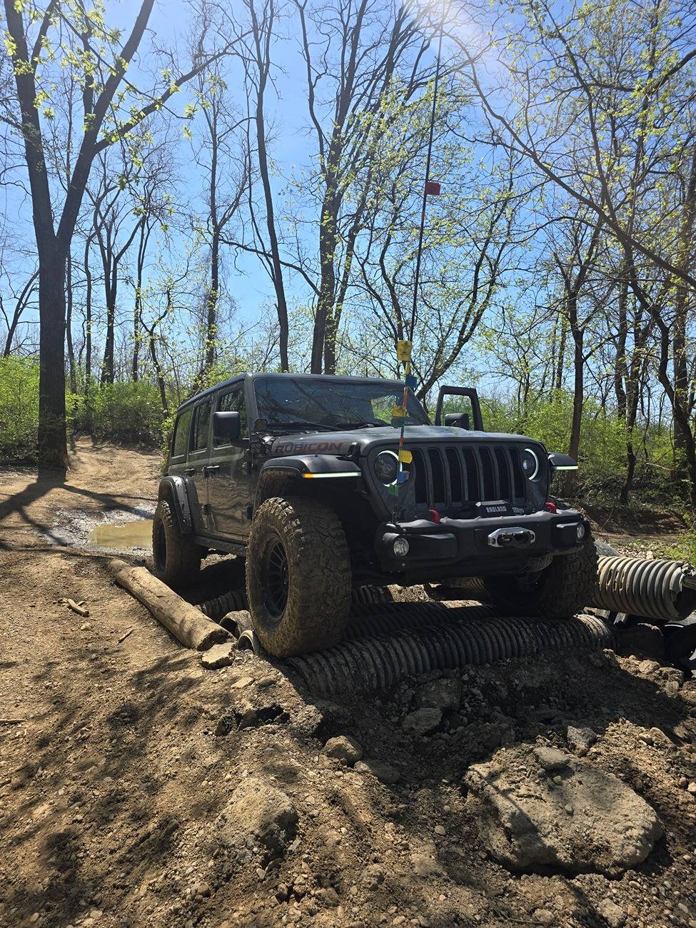

I didn't take a good pic of the rear with 1.75" spacers and 37"s with -12 4.5" HTH

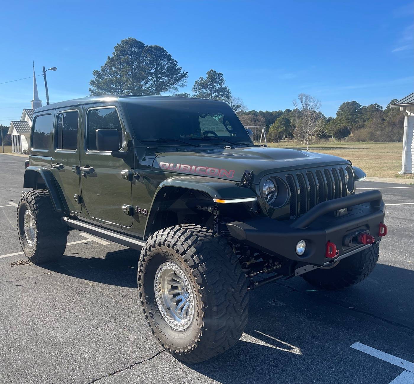

2021 JLUR, 1978 CJ-5
i’m changing my wheels and tires tomorrow and I’m trying to decide on -12 or -38 offset for 17 x 9 wheel. I just wanna get some opinions on which one I should get I plan on putting coil overs in three years but right now I’m putting on a Rancho 3 inch lift if I get a -38 I don’t have to switch out my wheels for the coil overs, but if I get a -12, I would have to.
-38 Fuel Rincon FC125 with Toyo M/T 37x13.50R17
Jeep Wrangler JL -12 or -38 offset IMG_5571
Jeep Wrangler JL -12 or -38 offset IMG_5569

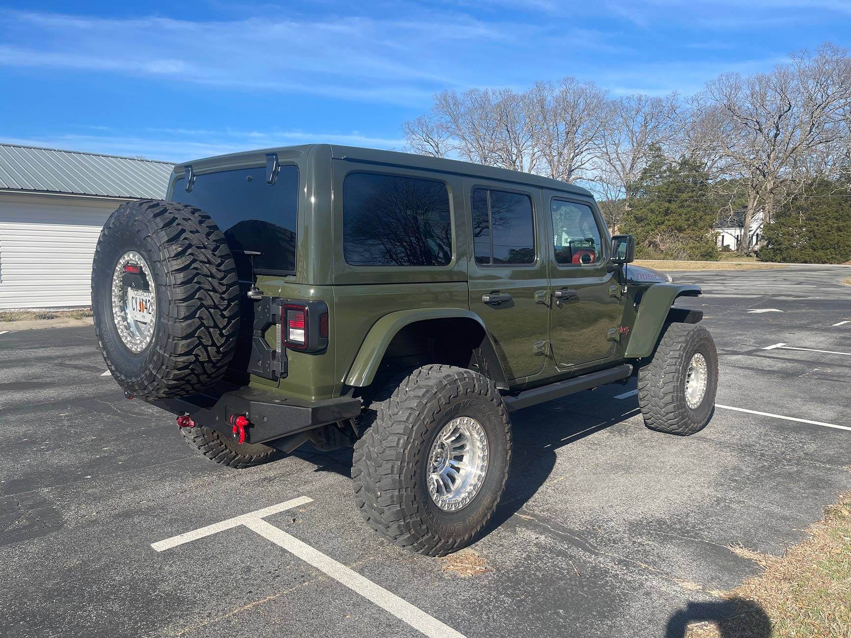

Swapped from +18mm Racelines to -44mm Methods when I chanced to beadlocks, mainly because of the limited offset availability on beadlocks. My MC lift cleared +18mm except I could touch the sway links up front. 37"x12.50 KO2s on +18mm vs 38x13.50 TGs on -44mm, fenders are Maxterrain/Hyperforms:

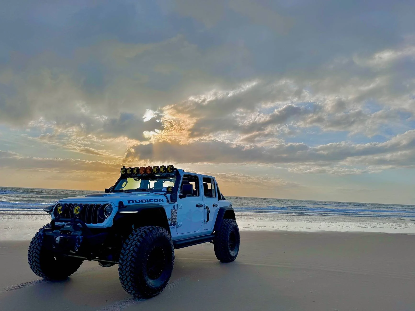

BBQ prophet
Jeep Wrangler JL -12 or -38 offset 15d0334c-35d9-461d-bde4-7a68a45fb4c2
38" on - 38
BBut beadlocks are a bit wider than what you are looking for. I will warn you that the increased offset wears ball joints faster.
