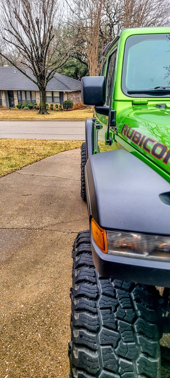

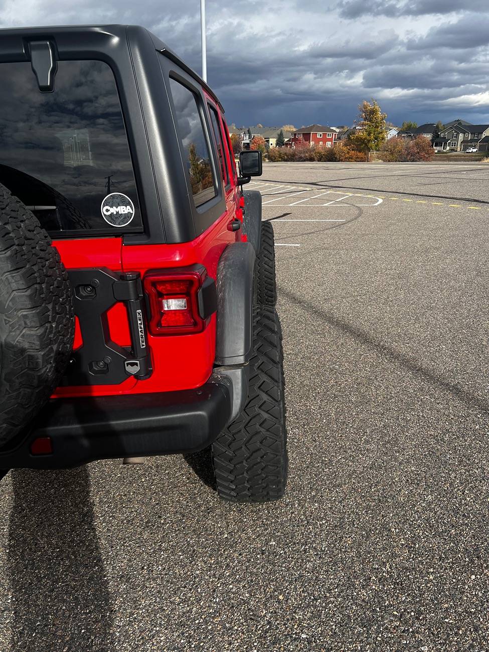

If it helps any, I just went from stock wheels to Method MR703s with 0mm offset. Pushed my wheels out 1.73 inches. Went from no poke to this. Going from this to -38mm offset pushes them out another 1.5 inches.
Jeep Wrangler JL How bad (or good) are -38 offset wheels? 20250212_094651
Jeep Wrangler JL How bad (or good) are -38 offset wheels? 20250212_094641

I run -38 Dirty Life and used to run -38 KMC and yes they did stick out a lot. My avatar pic is the KMC with factory fenders and 37x12.5 tires, any other pics I have are other Jeeps that had after market fenders which waaaay increase the stick out. With factory fenders it wasn't too bad but there is def some sling going on.

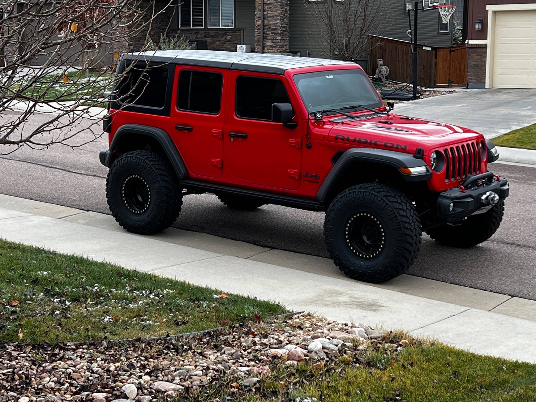

I'm currently running -6 backspacing on my Icon Rebound Pro wheels, but then I threw on an extra 2-in spacers from Rough Country.
It looks good though.. The slinging debris when off-roading kind of makes sense though.
Jeep Wrangler JL How bad (or good) are -38 offset wheels? 1000008413
