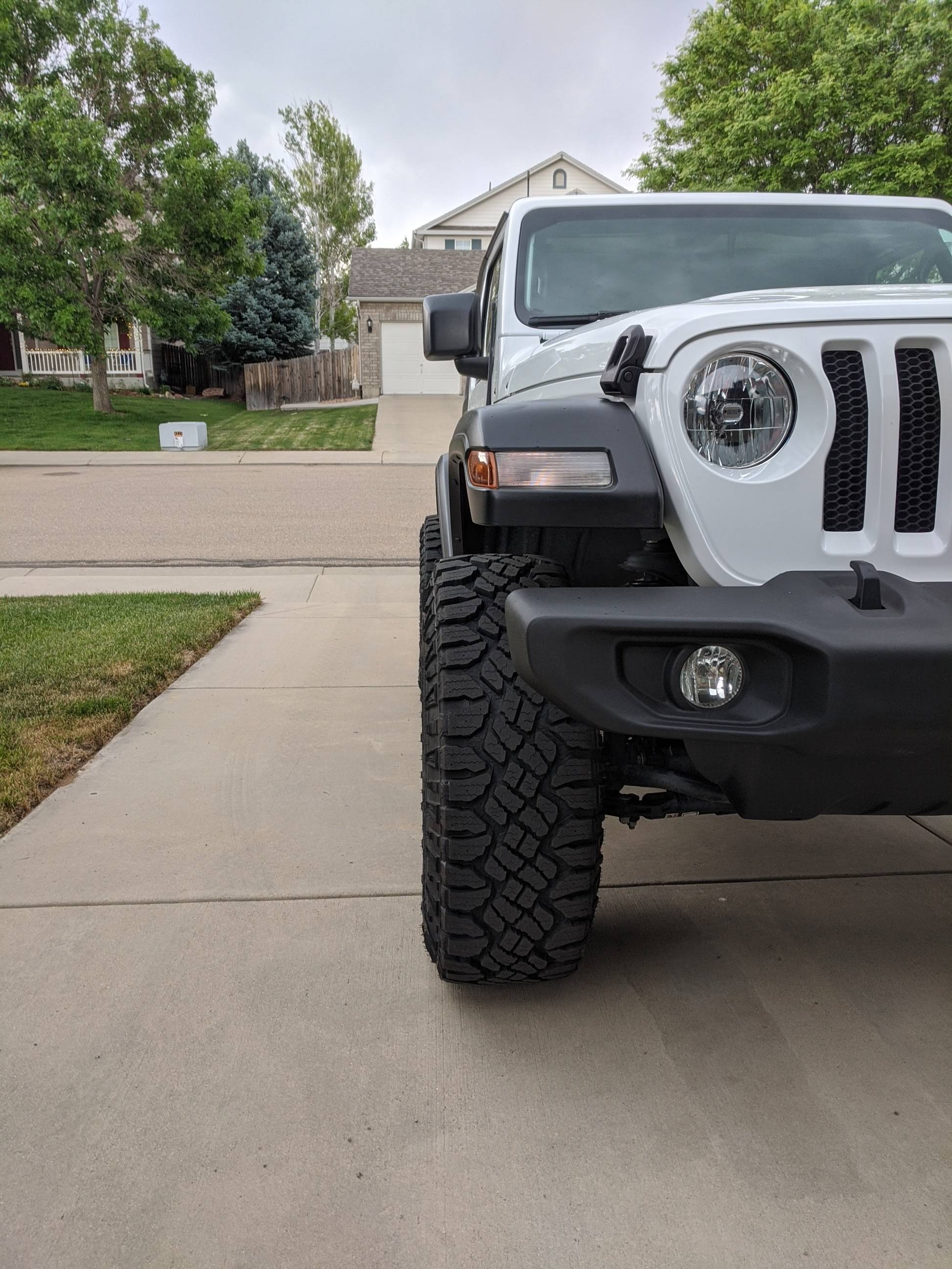

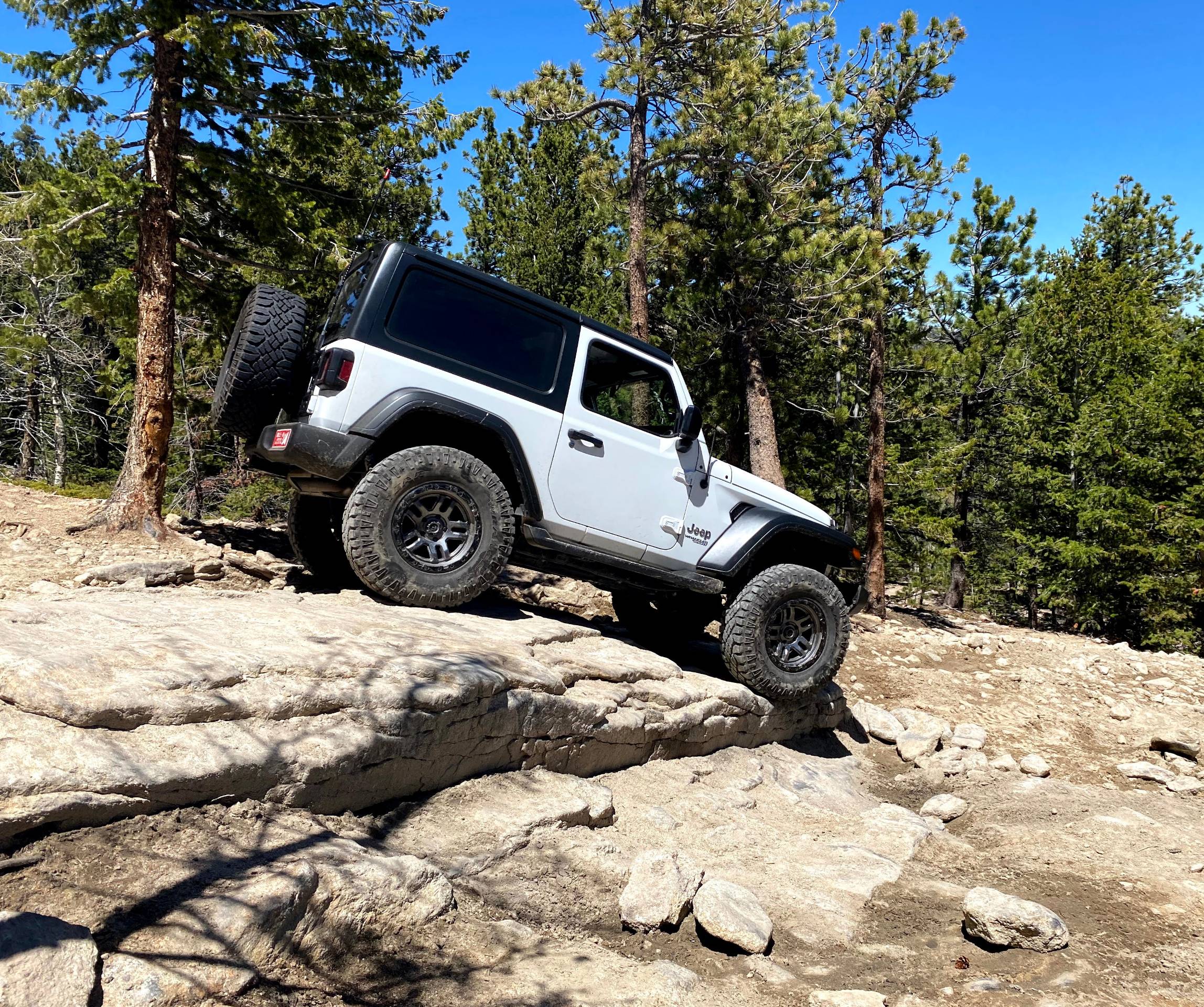

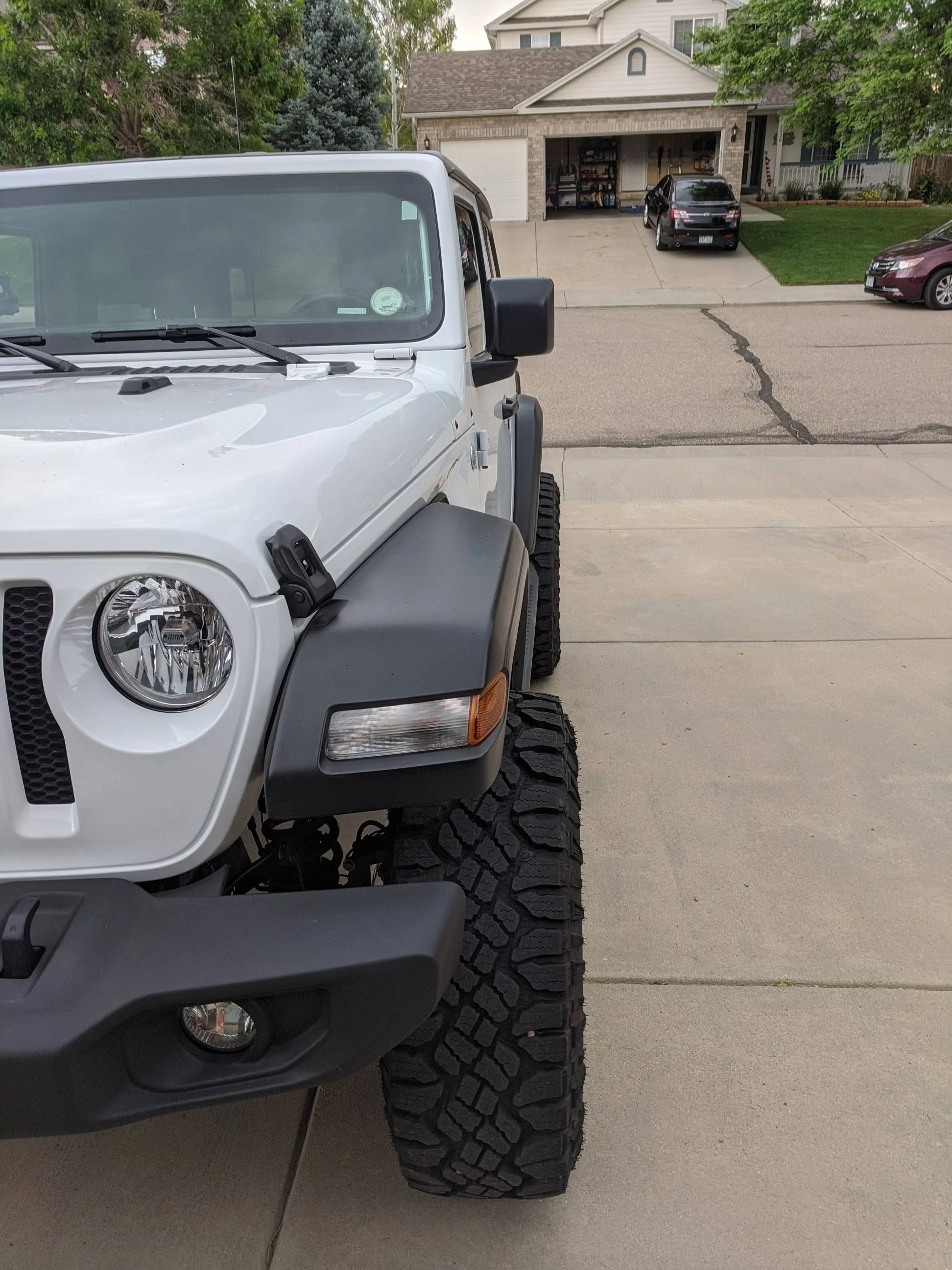

Lastly, just for a reference point, here is my setup with -12 mm offset wheels on 35's with the 2" Mopar lift. I live in Colorado (not yet a nanny state) and routinely find myself above treeline at 12000 feet (or higher) on some of the most panoramic vistas the Rocky Mountains can offer.

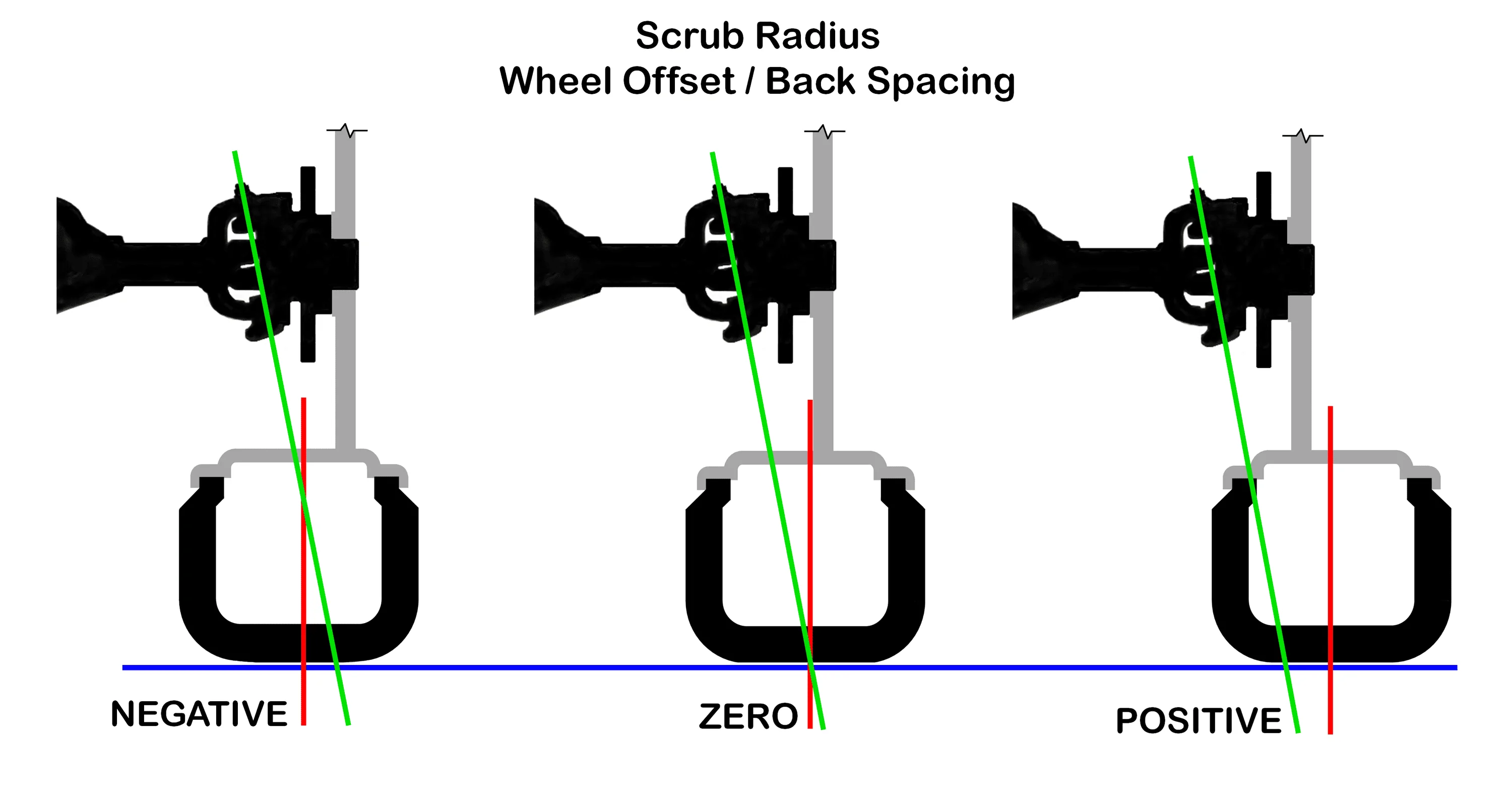

Scrub Radius is a function of King Pin Axis of Rotation intersecting Tire Centerline at the point of Tire Patche contact with the Road.
