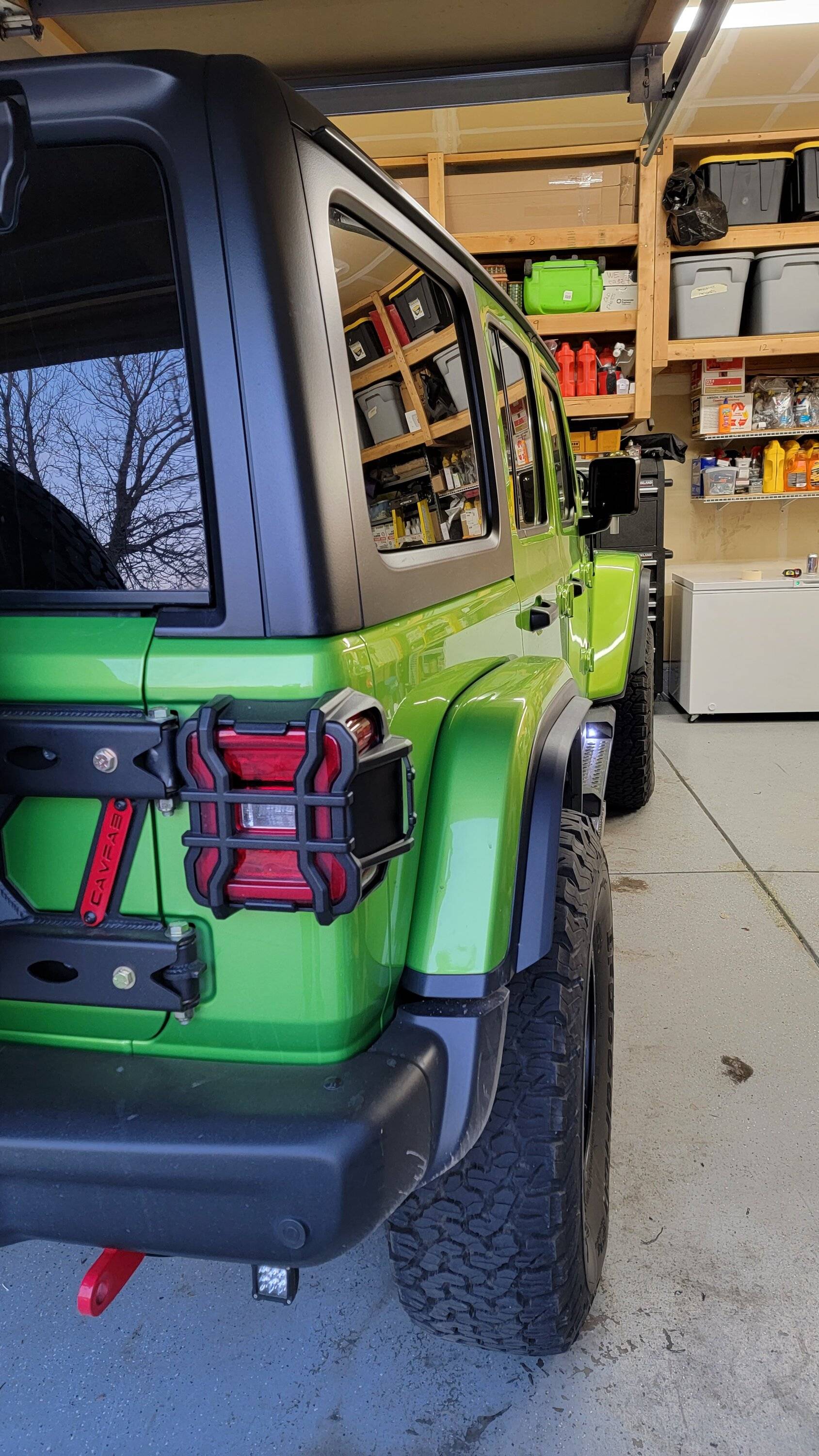

I went with 0 offset because I wanted some poke, but not more than I could cover with the XR fender extensions.
These are Icon Alphas, 17x8.5 in 0 offset and 4.75" backspace with BFG K02's in 37x12.5x17:
