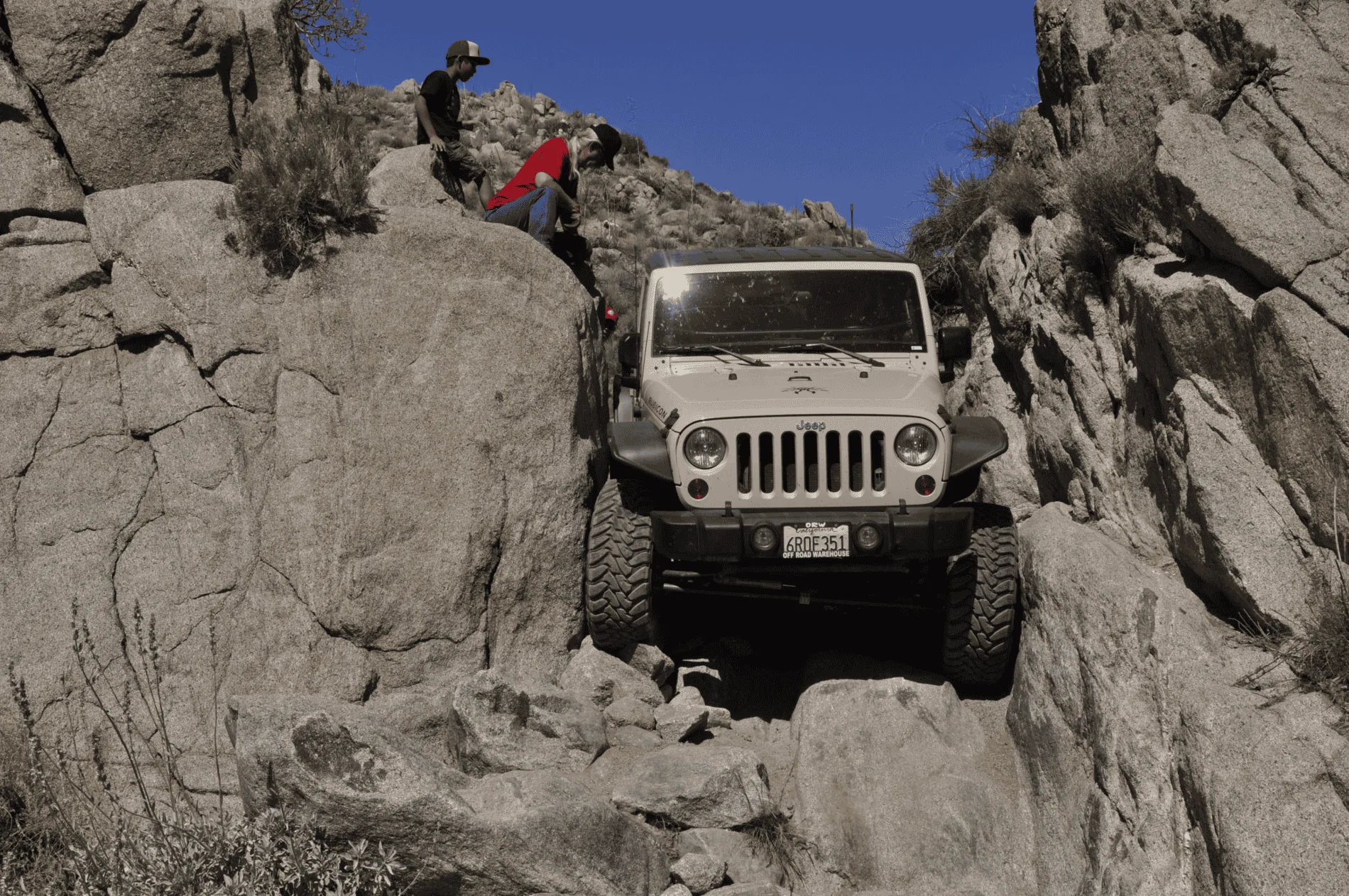

What he said^^ and since you have the wider Rubicon axles those zero offset wheels will work well. AEV has +25 offset wheels that work fine on stock Rubicons so going that zero will allow for quite a bit of lift if you go that route at a later date. -18s might make the difference between fine or wounded on trails like these~

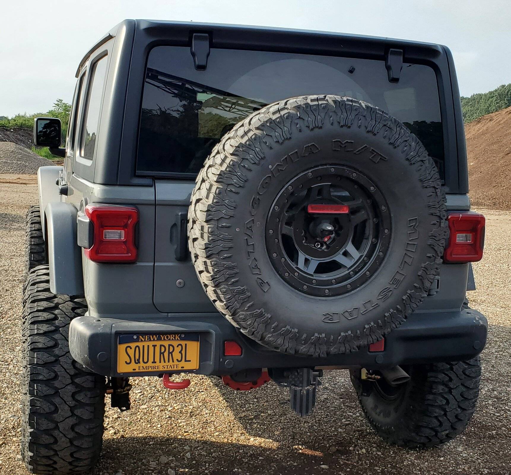

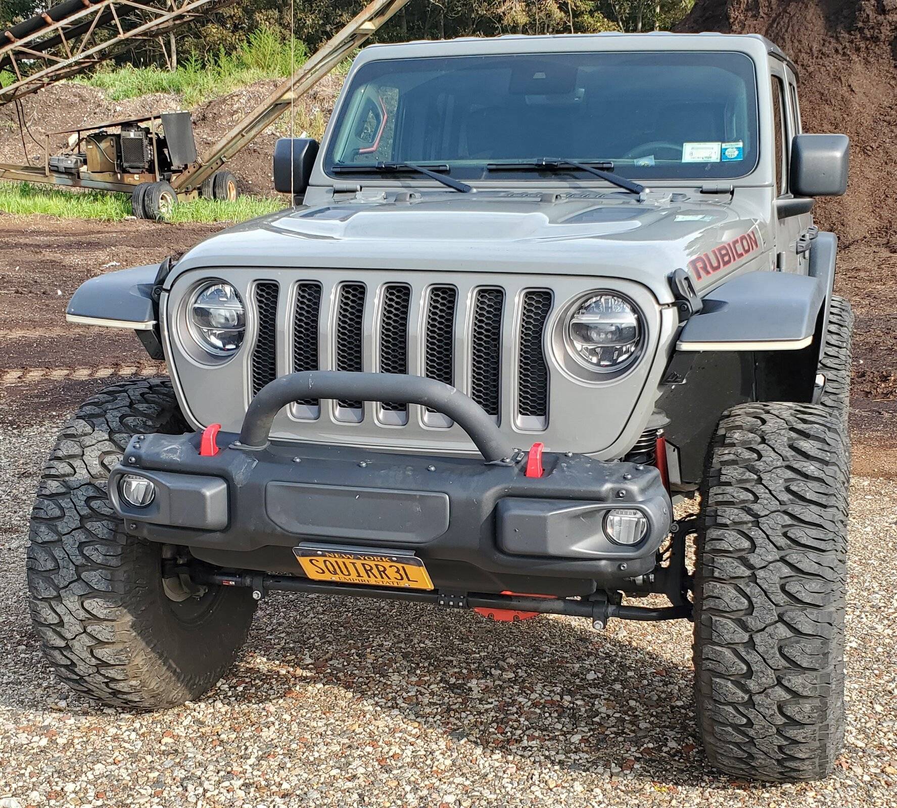

Here's a 17x9 wrapped in 38x13.5's with a -12mm offset and 4.53" of backspace. Every 6mm equals roughly 1/4".

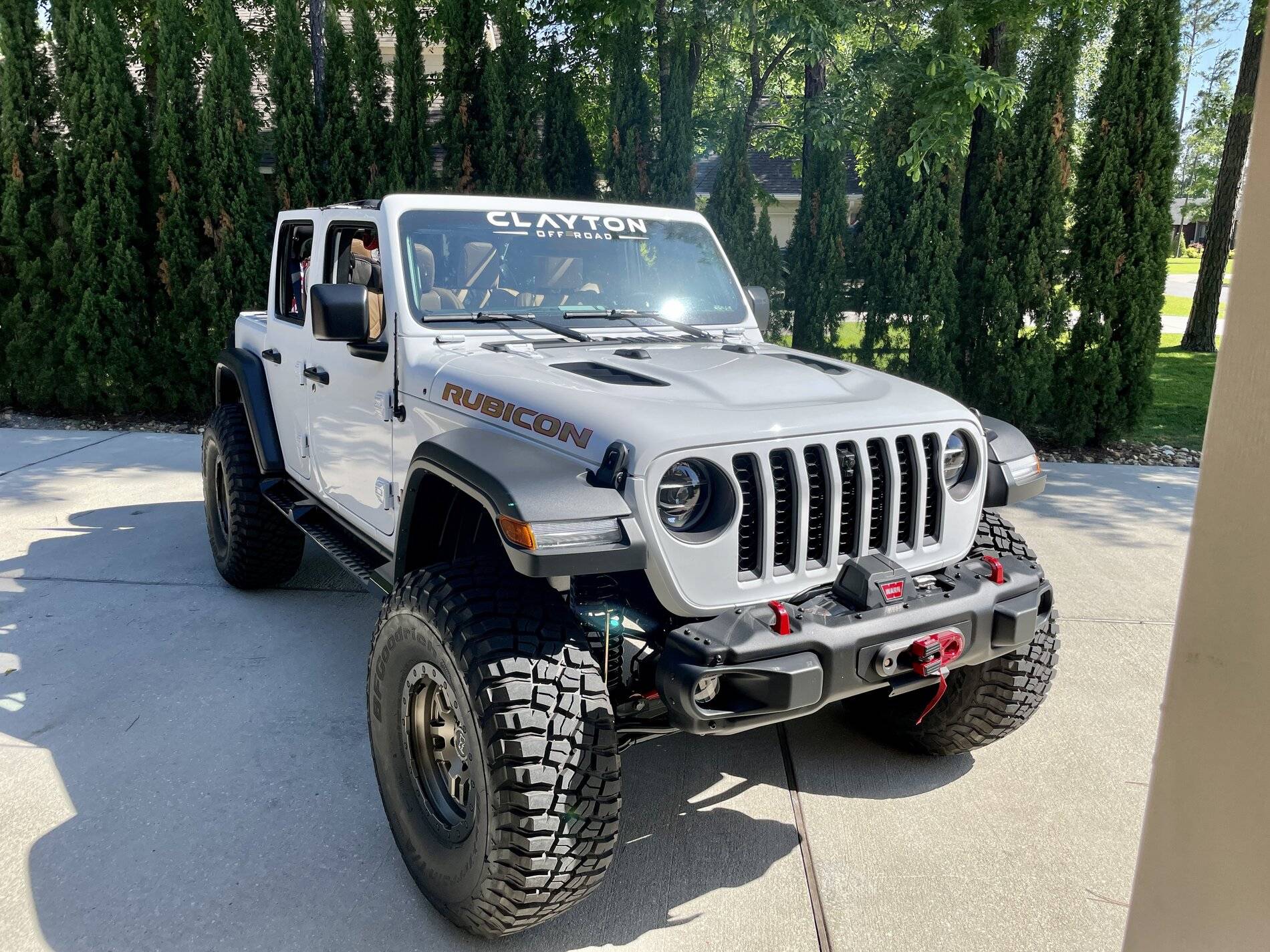

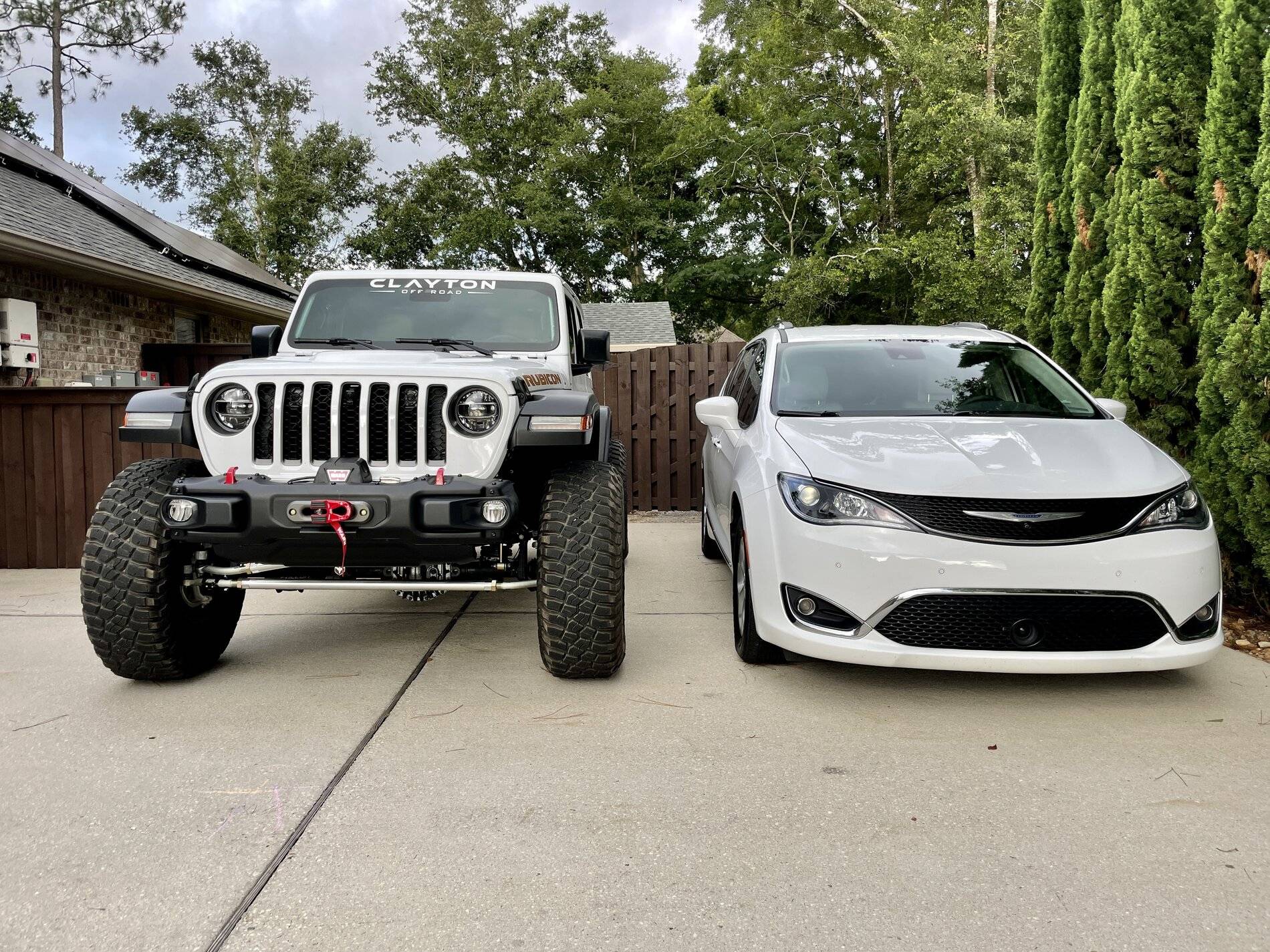

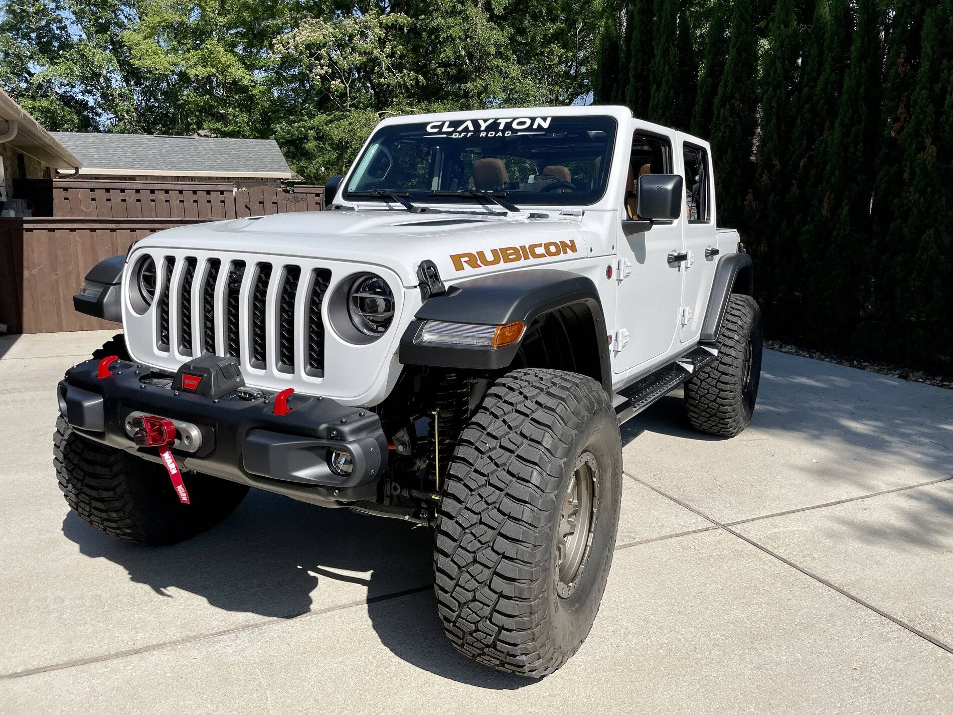

Here is Black Rhino Barstow 17x9.5 with -18mm offset and 4.5” of backspace on KM3 39x13.50 tires.

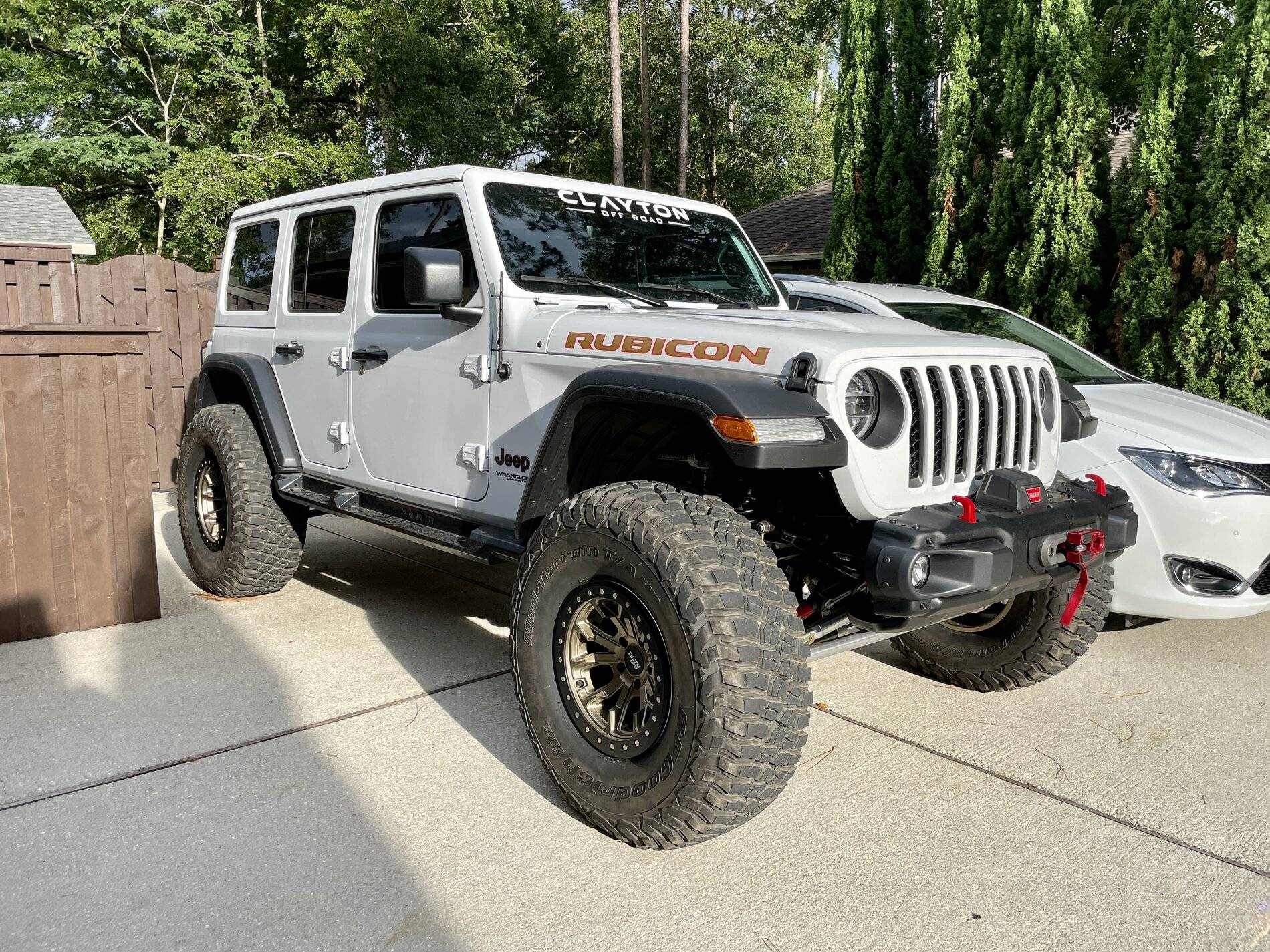

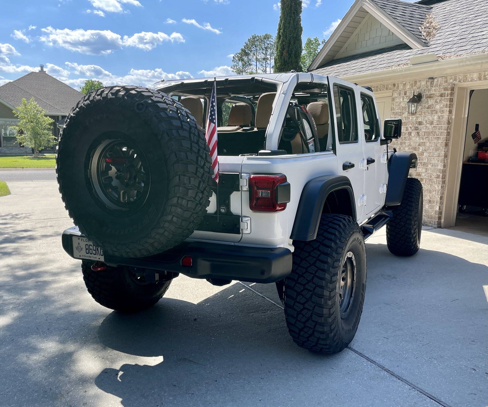

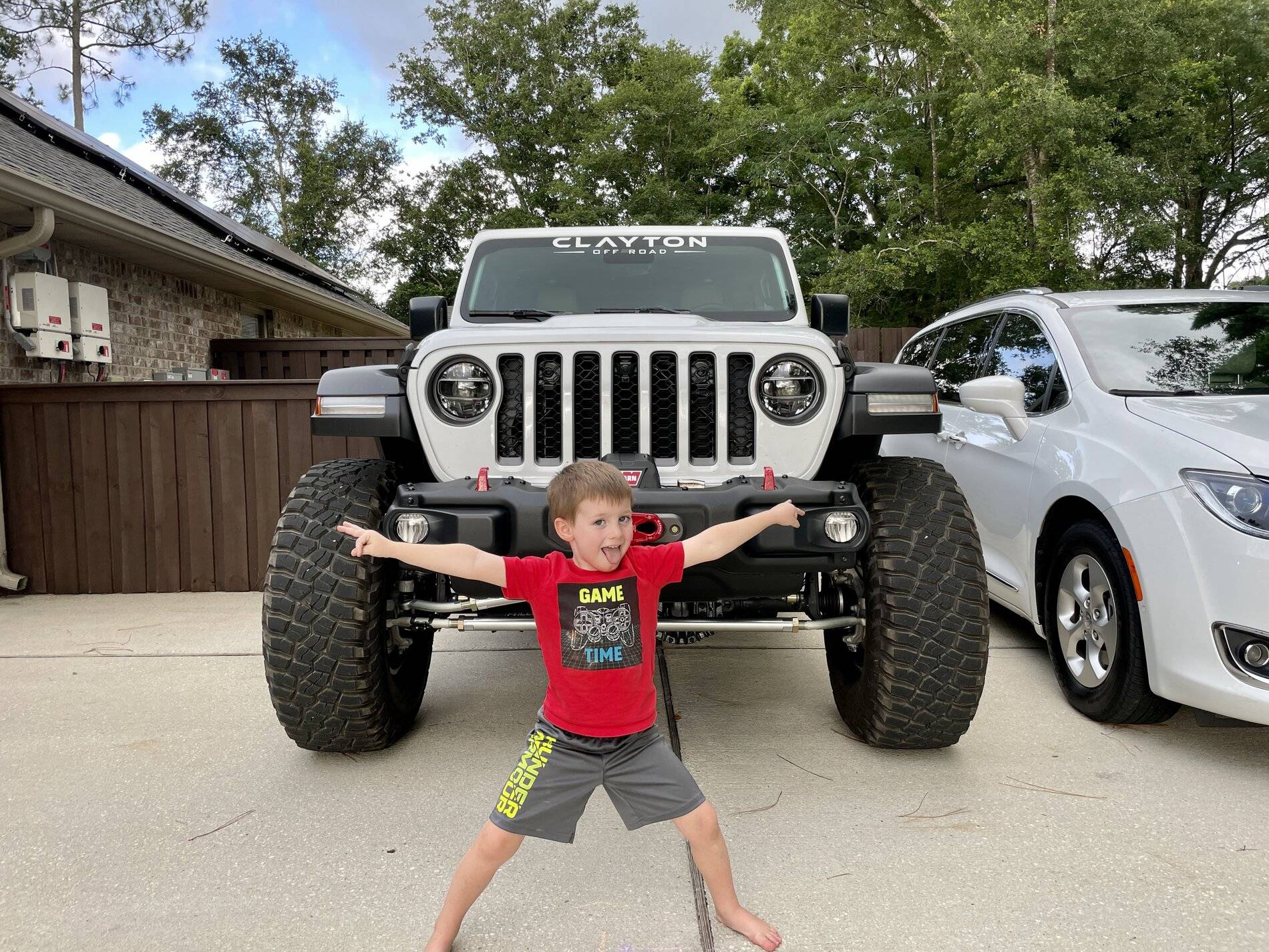

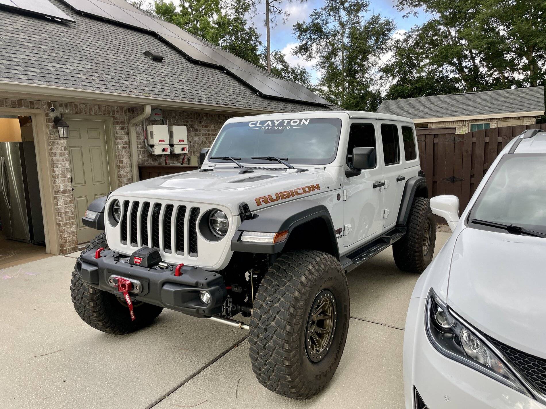

And here are the same tires with Dirty Life 17x9 -37mm offset and 3.5” of backspace.
There’s not a huge difference. Just go with the -18mm offset wheels.
