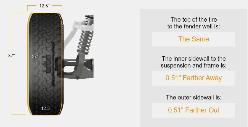

Correct, Option 1 vs. Option 2:
Jeep Wrangler JL +1 or -12 offset please help decide 1658841062180

The more positive of an offset will yield less "poke".

I would look for more positive offset than +1, but between your 2 choices, you definitely want to go with +1. You’ll still have a good 1.5 inch of poke.
