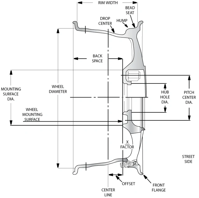

Note a 9” wheel is 10” wide, so 0 offset is 5” BS.
See diagram and table included above for clarity.

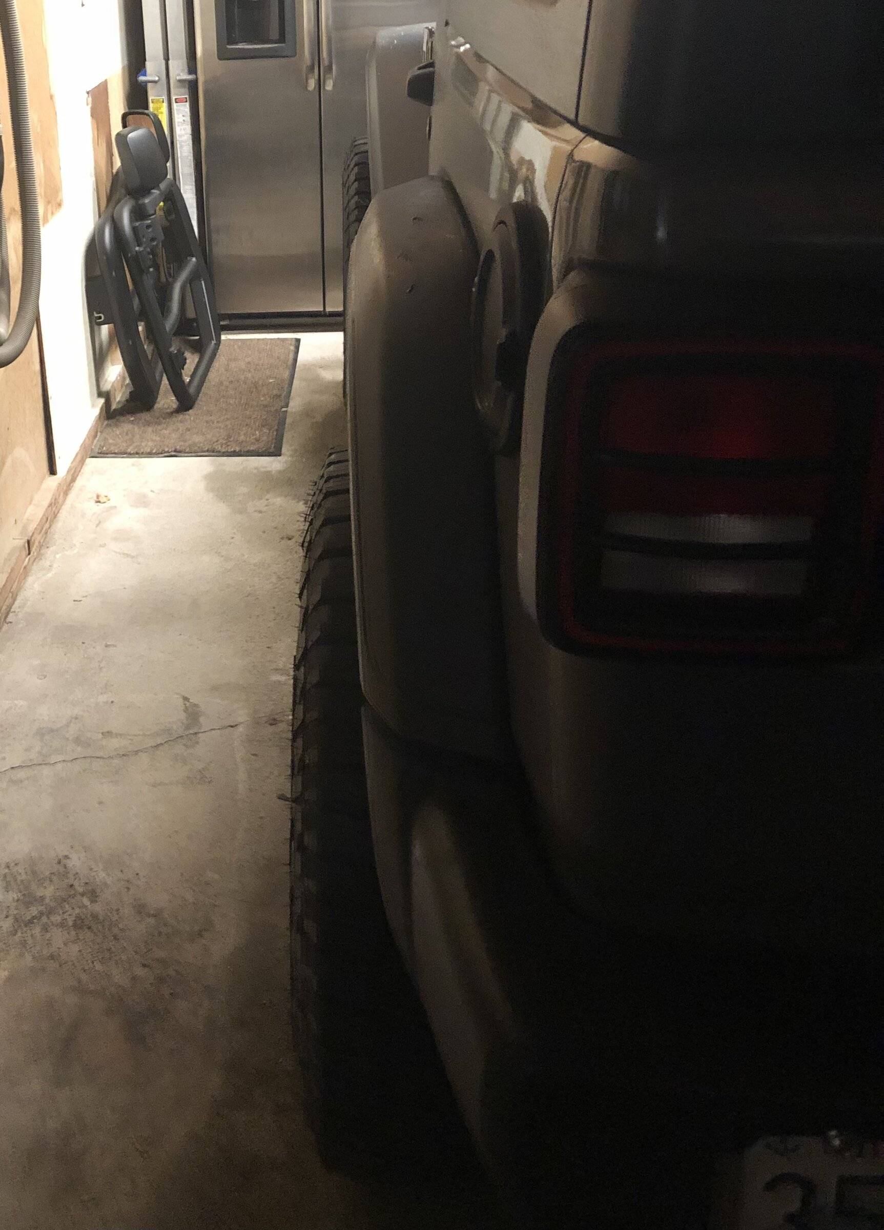

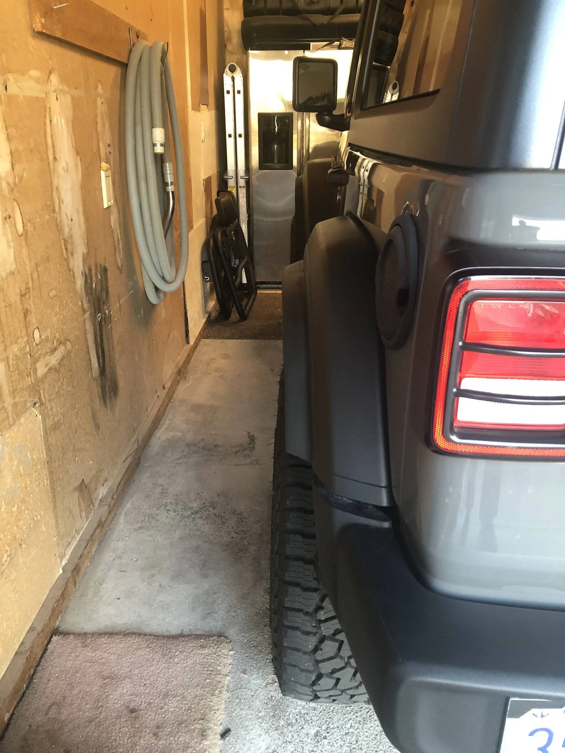

I have 4.75 backspace / -6 offset on my sport with rubi takeoff suspension. Tire poke of about 2 inches on 17x9 wheels which I like - very stable handling. But this is just covered by the fender flares I put on, so no inspection issues. ? So there are options if you are in a PITA inspection state.
Before vs after:

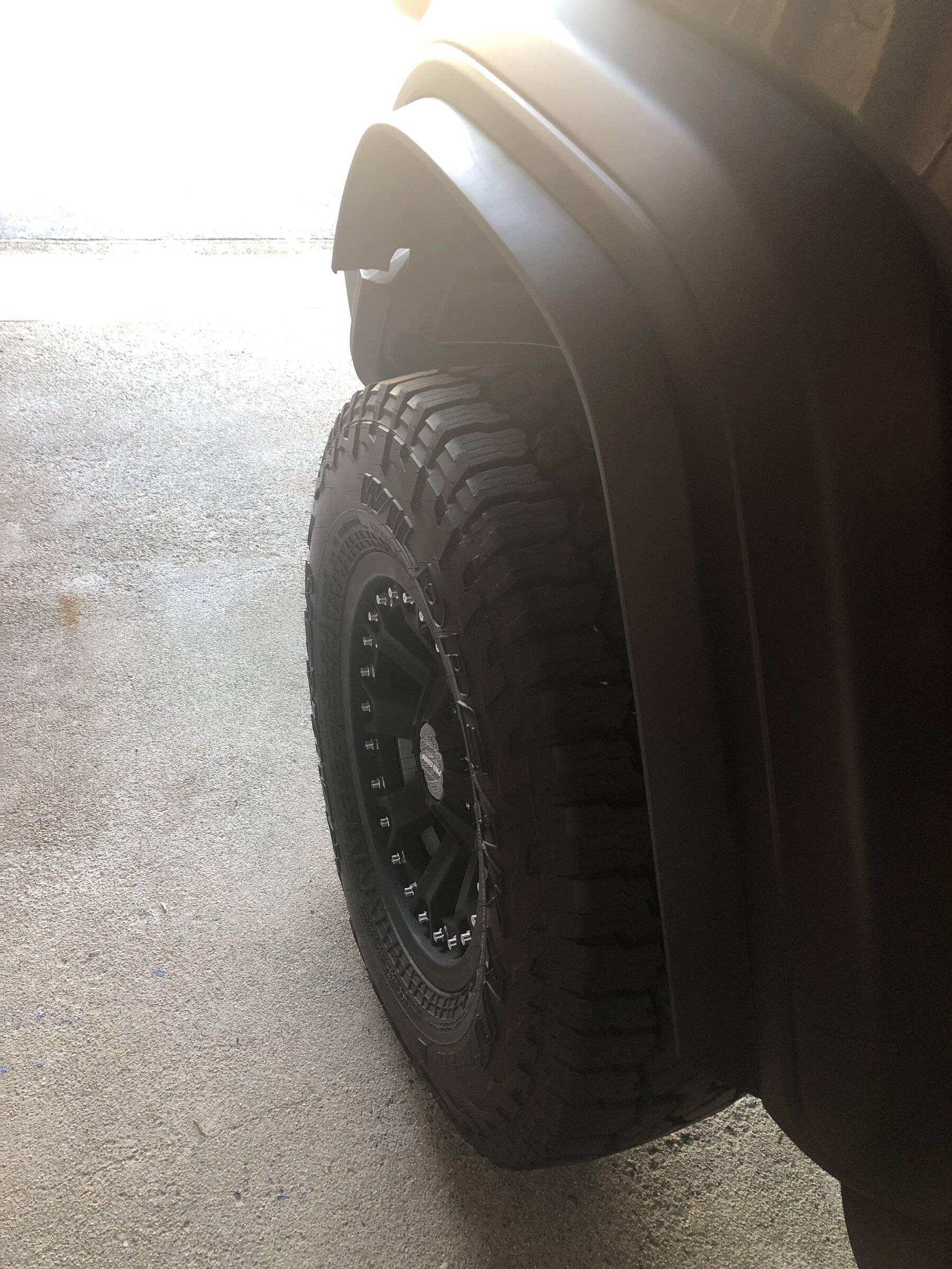

Before vs after:
……………….. so if I go with 3 1/2 inch backspace that means the tire will stick out 1 inch more ( past the fenders ) than a 4 1/2 inch backspace would………..Is that correct? Thanks.
