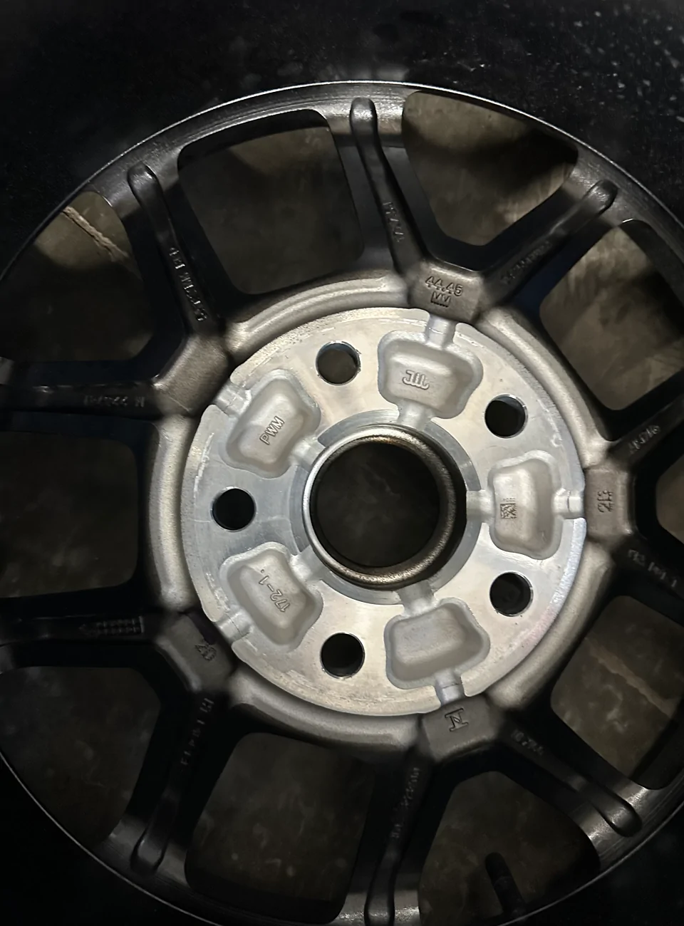

yes negative offset gives even more poke.....oem wheels are 44.45 offset and 7.5" wide so ends up being just over 6" of offset.
Jeep Wrangler JL Any backspace, offset experts here?? tempImagePHW8Tm
