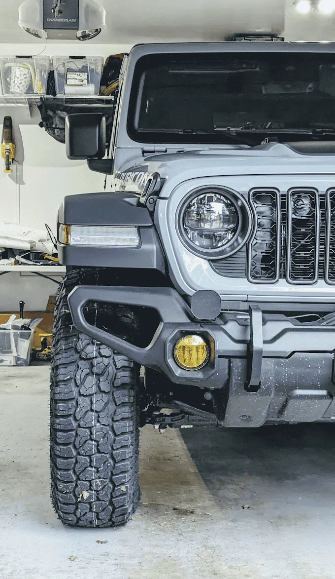

On a tall-skinny tire like the one you mention (34x11.5 equivalent) when push the wheel out that much it will show a lot more tire to inner frame gap.
this is 5.45 backspace (17x9 +12 offset) on tall-skinny 35x11.5r17s
Jeep Wrangler JL Photo request: -12 offset 1713998106882-wf
285 will be narrower (11.2" wide) and -12 wheel will push it out 1" (24mm) further out.

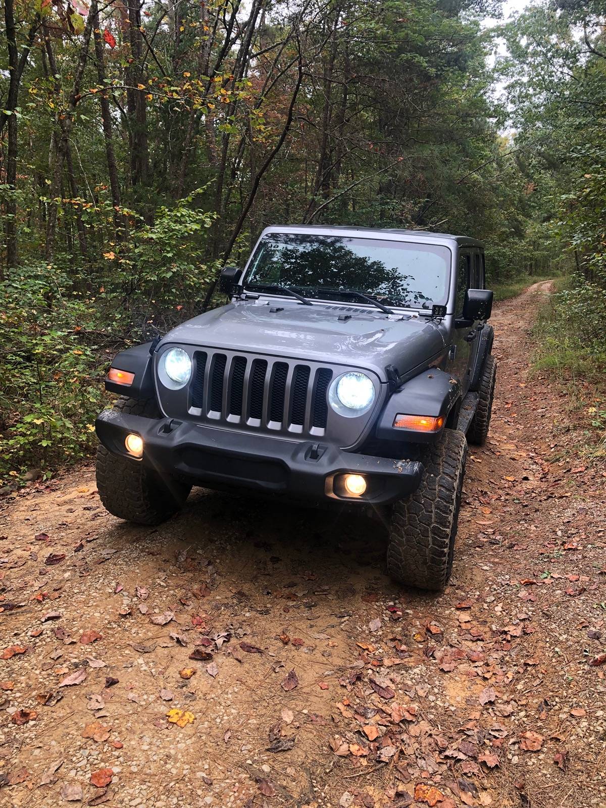

-12 offset with 35x12.5
Jeep Wrangler JL Photo request: -12 offset IMG_2125

35x12.5x17 -12 offset. Mickey Thompson Baja Boss AT.
Jeep Wrangler JL Photo request: -12 offset IMG_4835

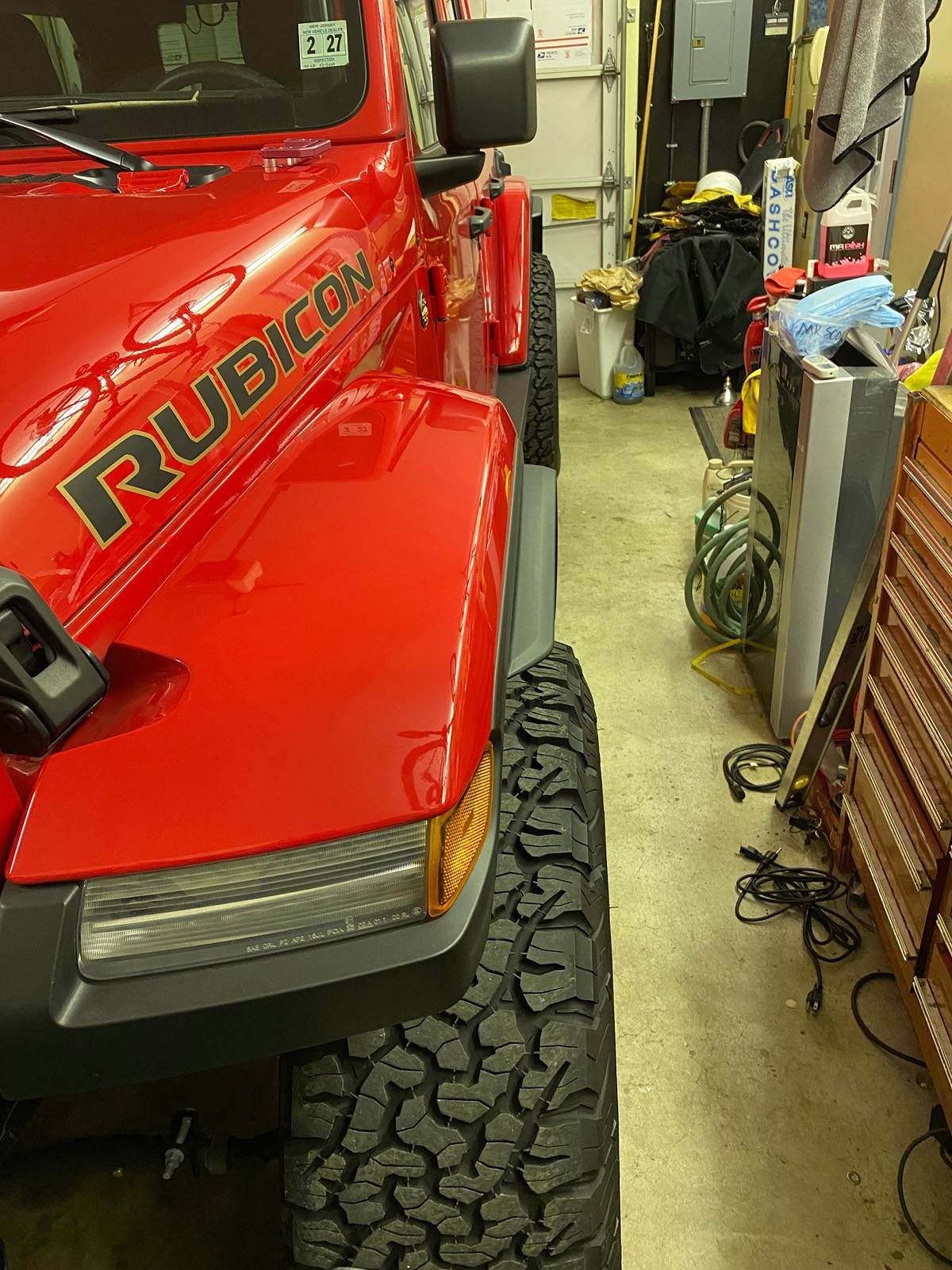

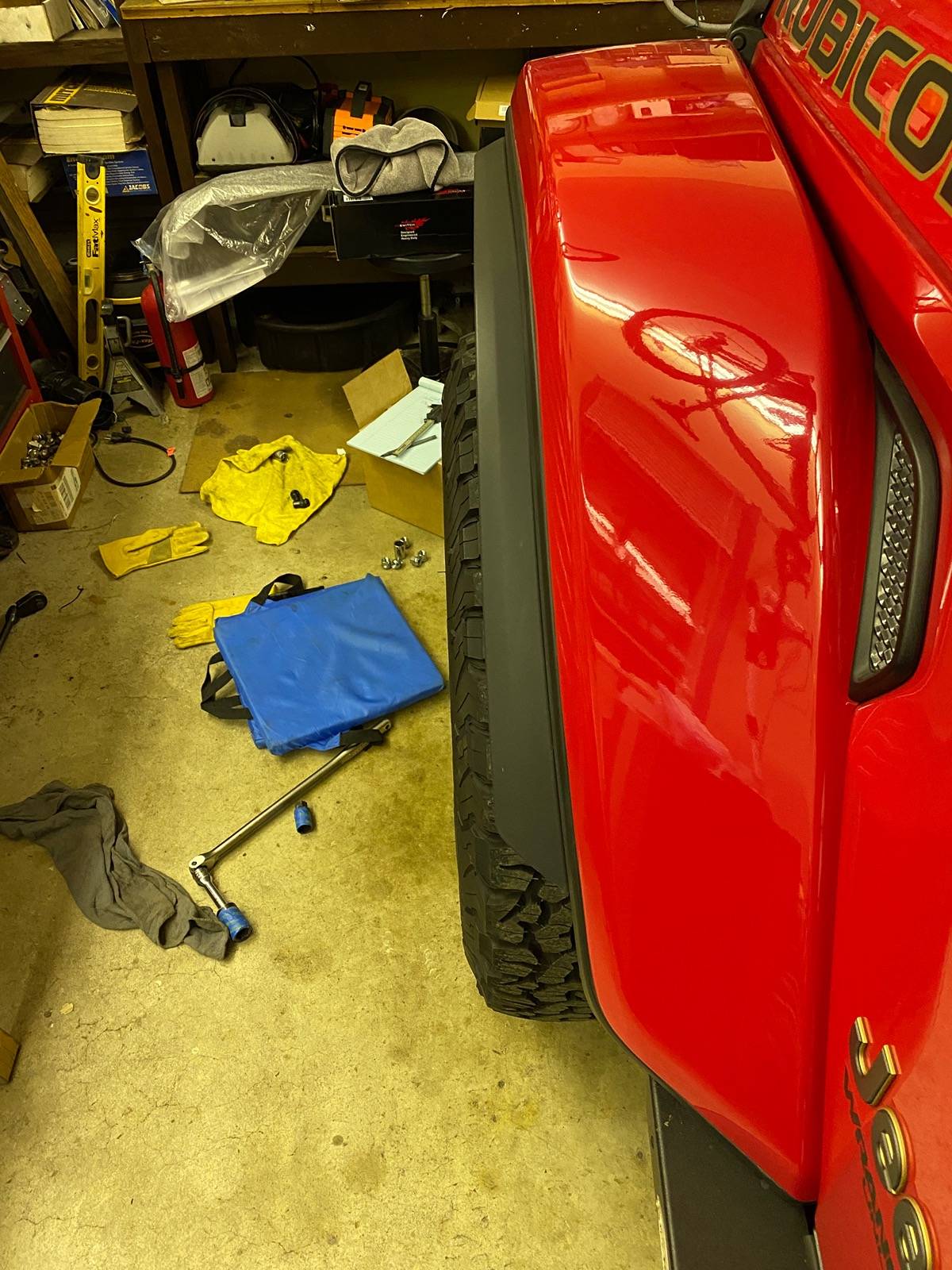

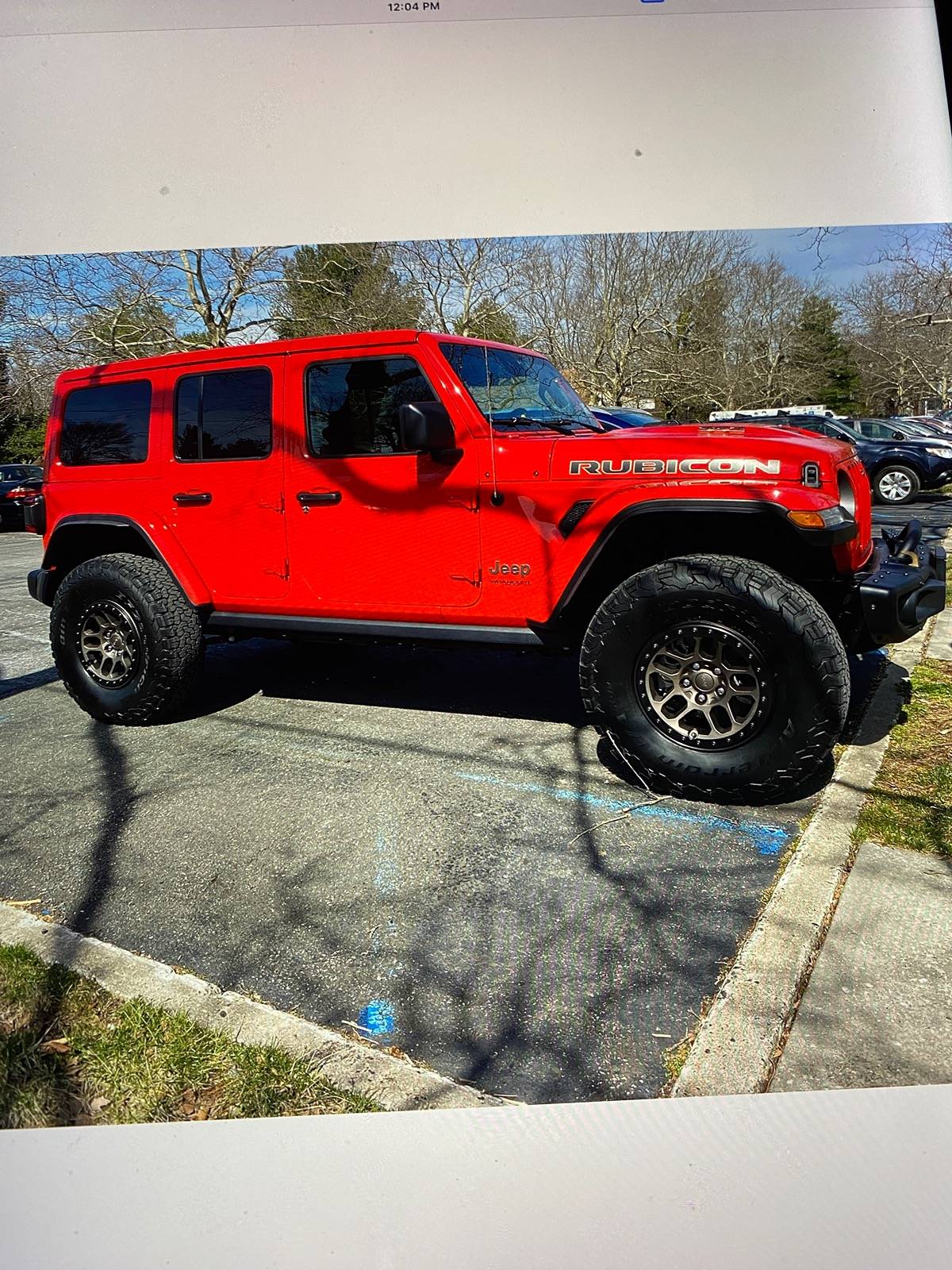

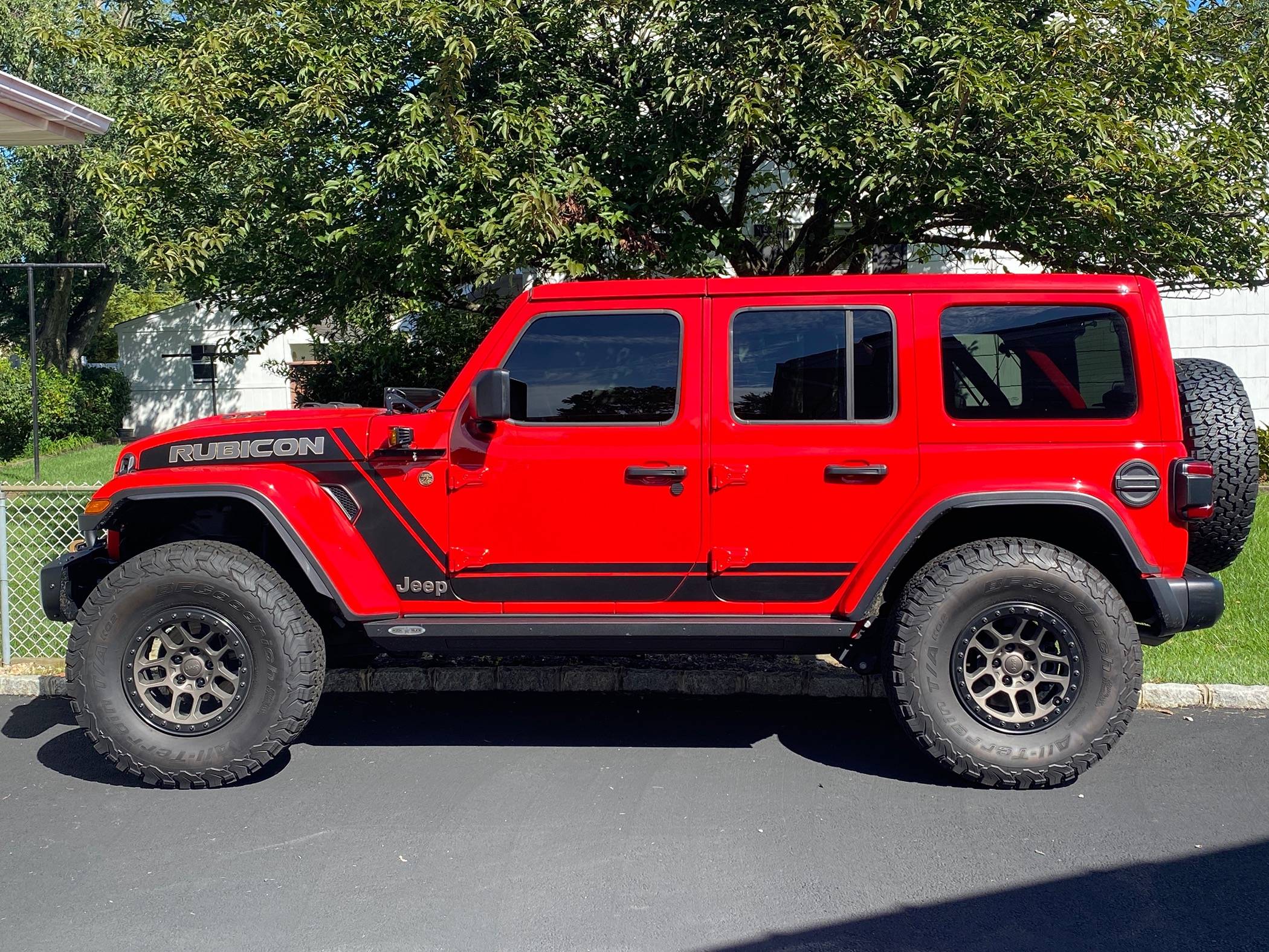

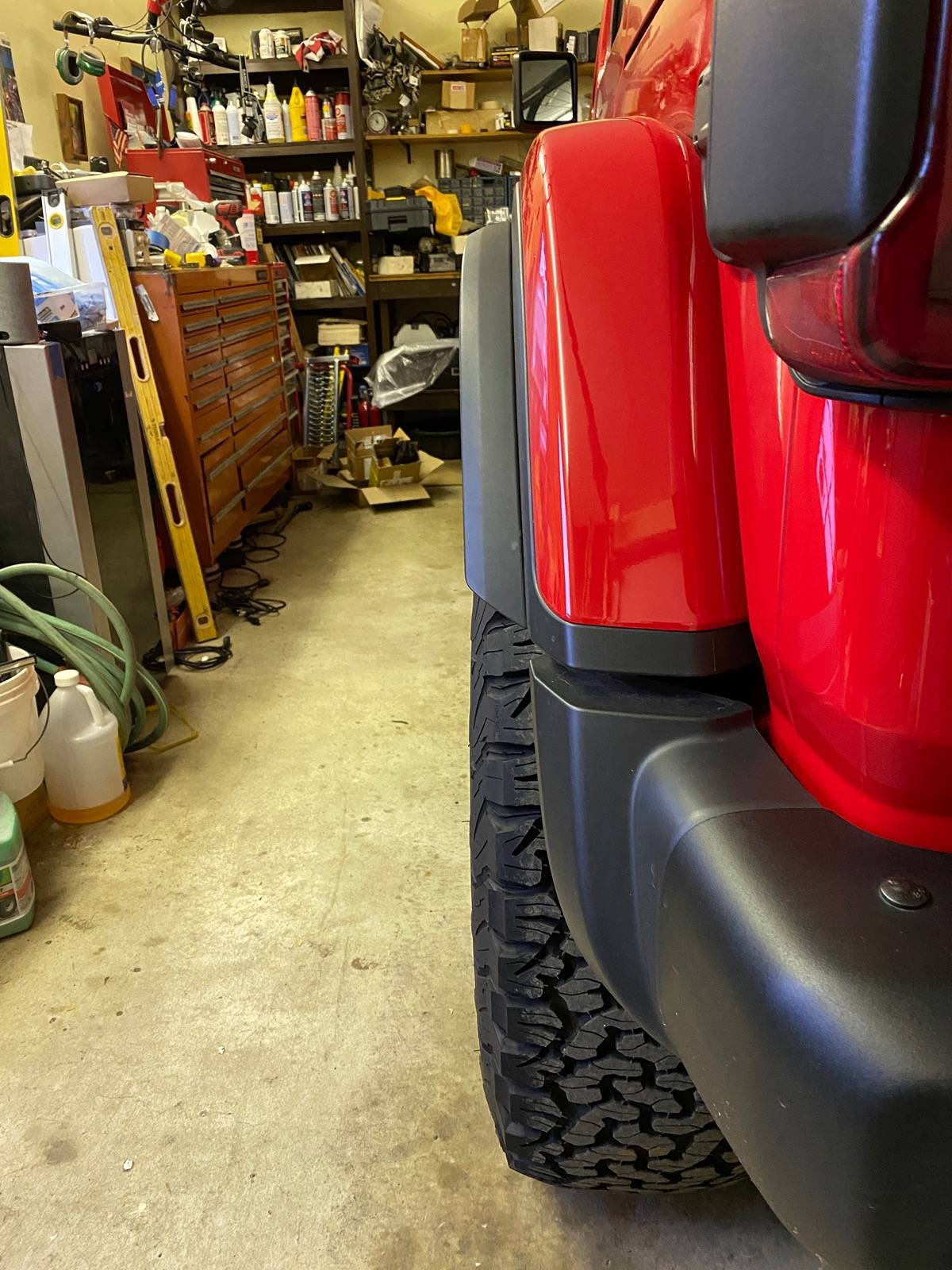

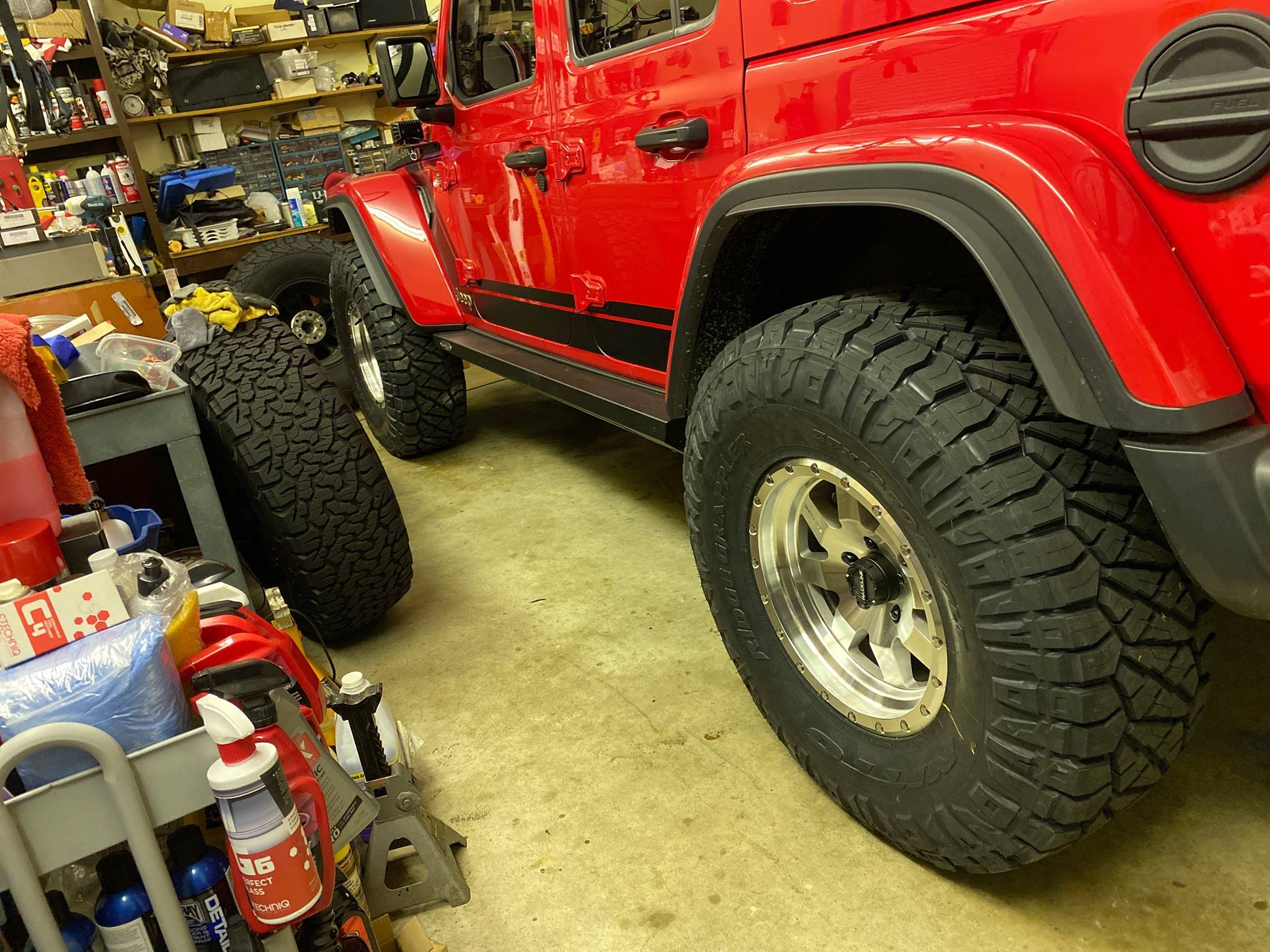

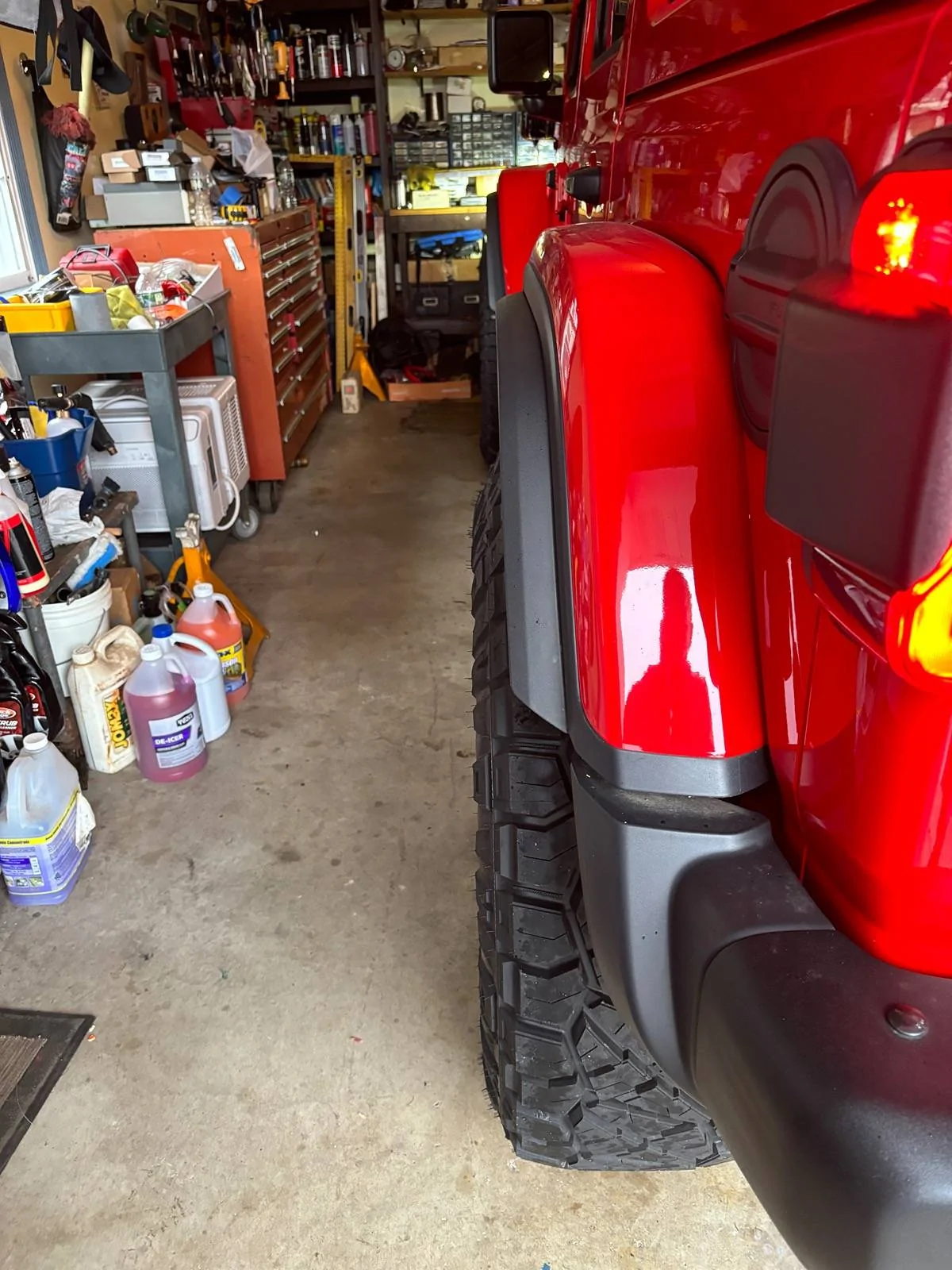

37 BFG`s on Rubicon XR wheels
There are pictures of the wheels on the Jeep with and without 1.250” Bora wheel spacers
Are these wheels at a -12 offset?
To tell you the truth I am not sure, there are forum members saying that the 392 XR has a +12mm offset while others say different. The Raceline Defender`s are a Zero offset
I jst took a look at the faxtory 392XR wheels and they are 17x8 with a +12mm offset
Part number 04755621AA

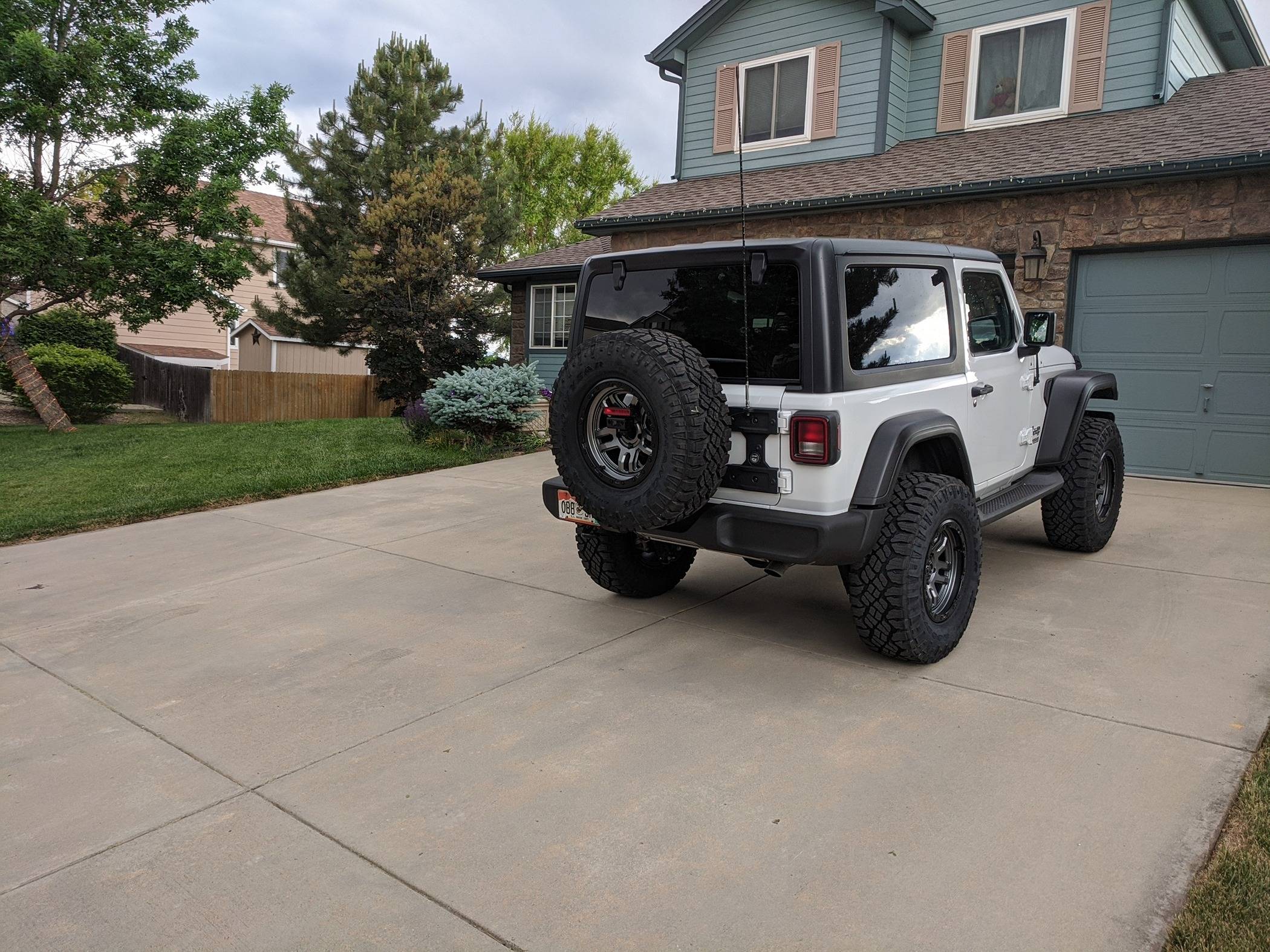

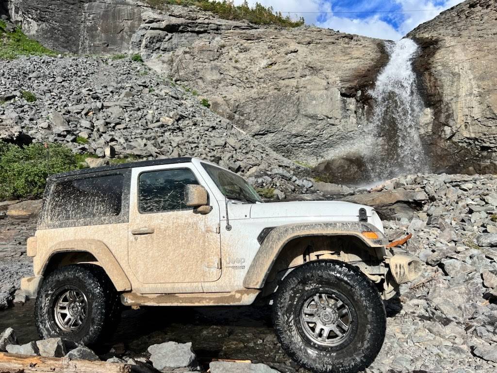

@TordFuglstad,
I have Goodyear Duratrac 35x12.5x17 on Fuel Ammo Anthracite 17x9" (-12 mm offset).
Pretty close to what you're asking for.
Jay

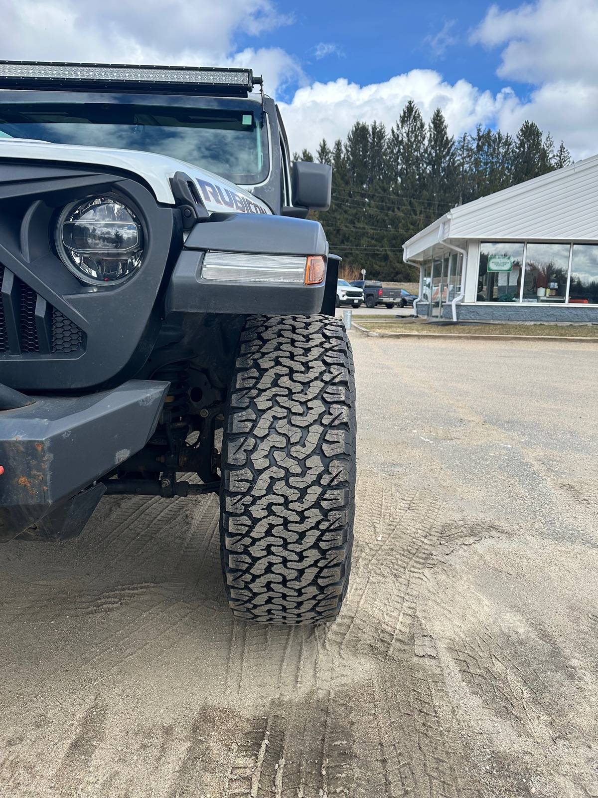

Fuel Block -12 on 35x12.5 general grabbers
they stick out about an inch
i added the XR fender flares and Rokblokz mud flaps as the offset splatters snow, slush and dirt all over within a few minutes of driving, and i find it ties everything together visually
