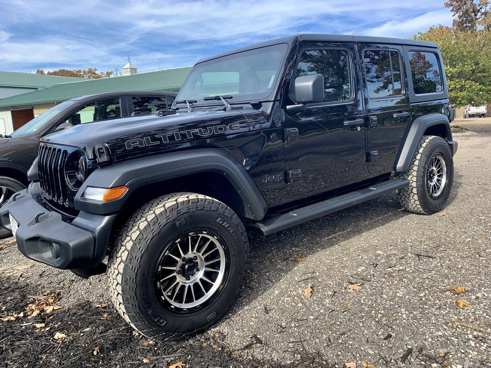

18x9 +18 offset with 275/70/18. Pokes just enough to look “tough” but not enough to sling crap all over the Jeep. Last photo is with 1” spacer lift.
Jeep Wrangler JL What does a + 30 offset look like 64B486E6-E42E-40FD-8056-43EF400DF1F9
Jeep Wrangler JL What does a + 30 offset look like FD19E897-F44C-4B2A-A2A1-0E6889E1F91C

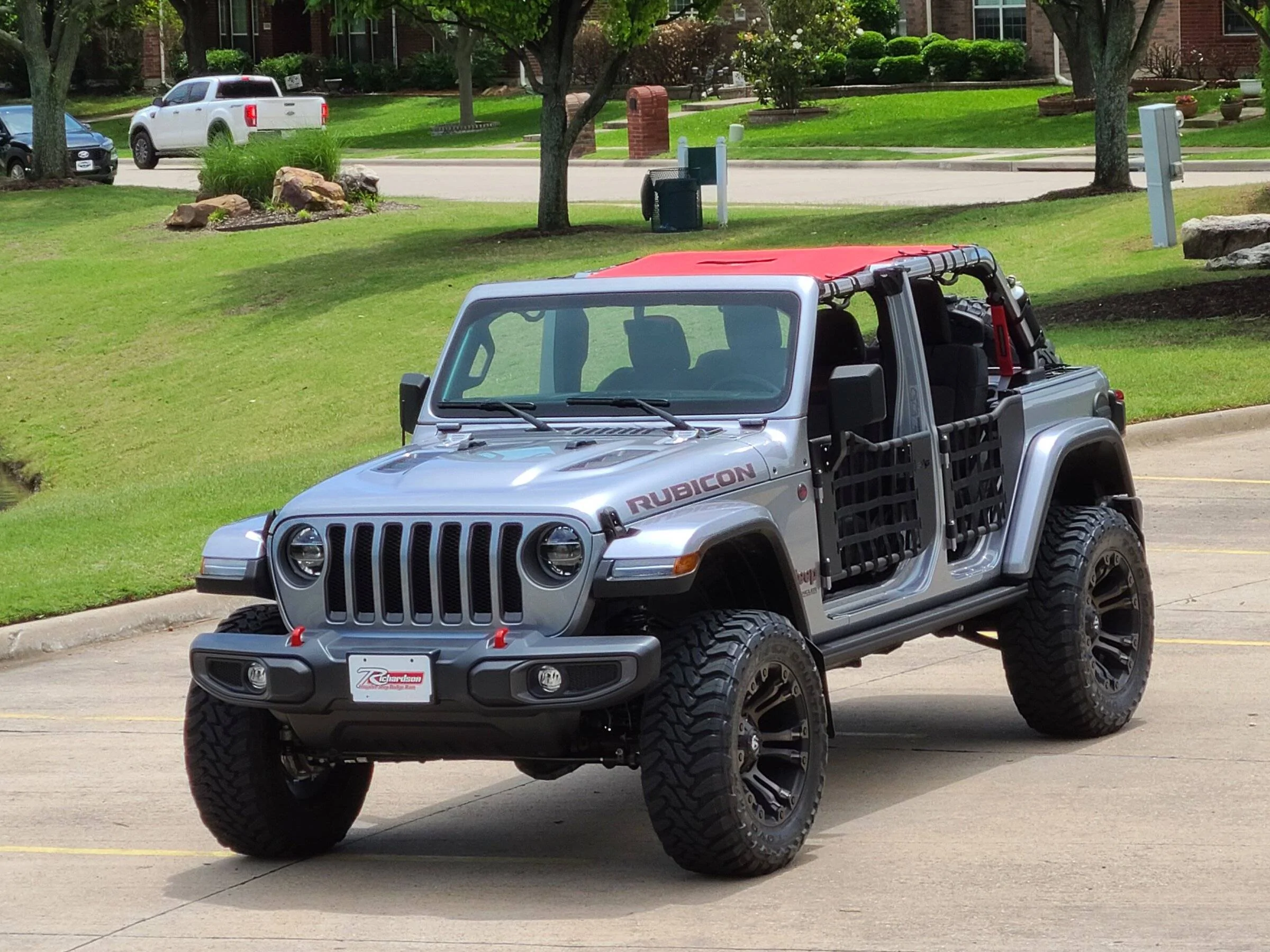

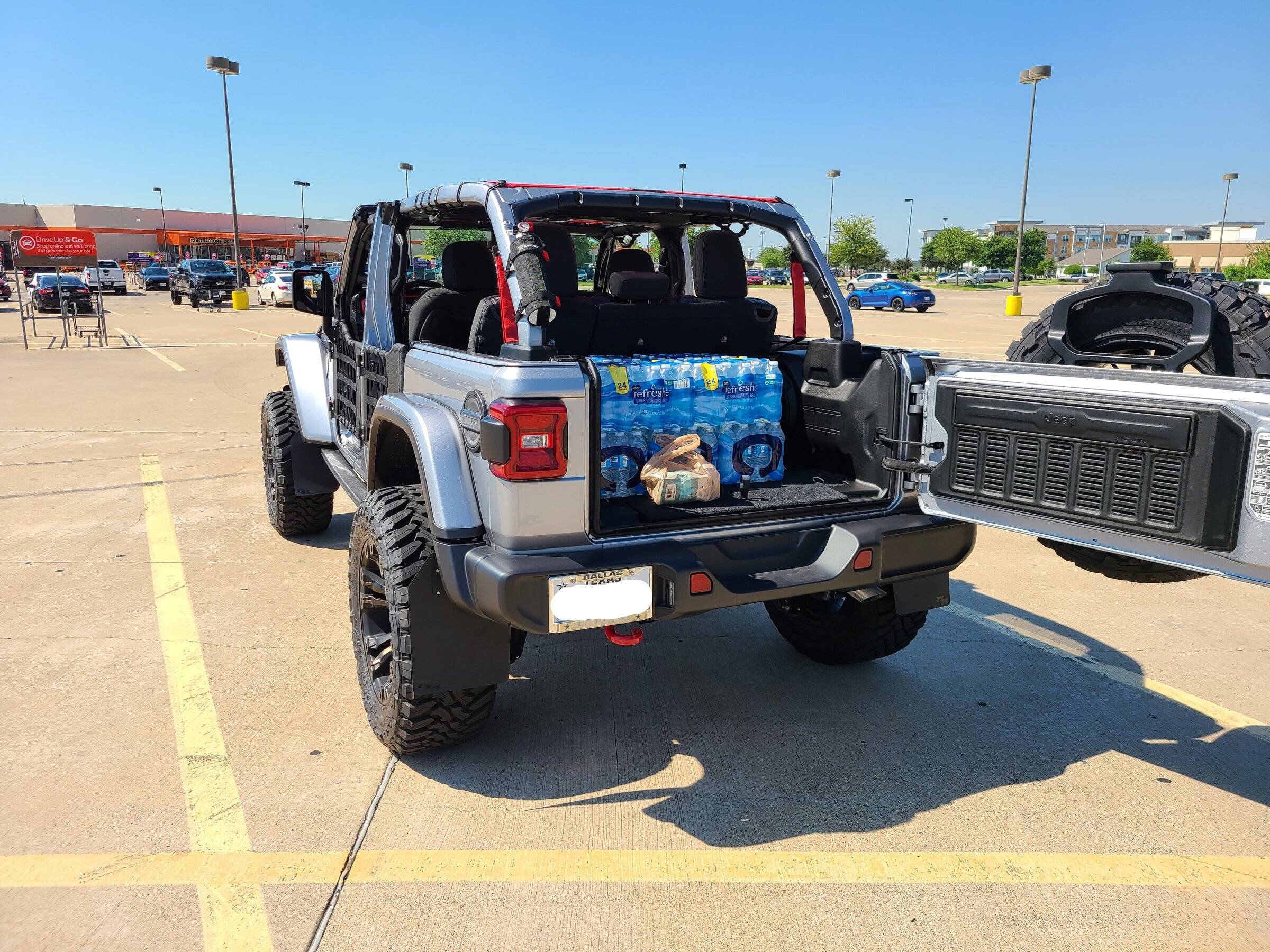

35" tires and Vapor Fuel Wheels and -18
Jeep Wrangler JL What does a + 30 offset look like Naked

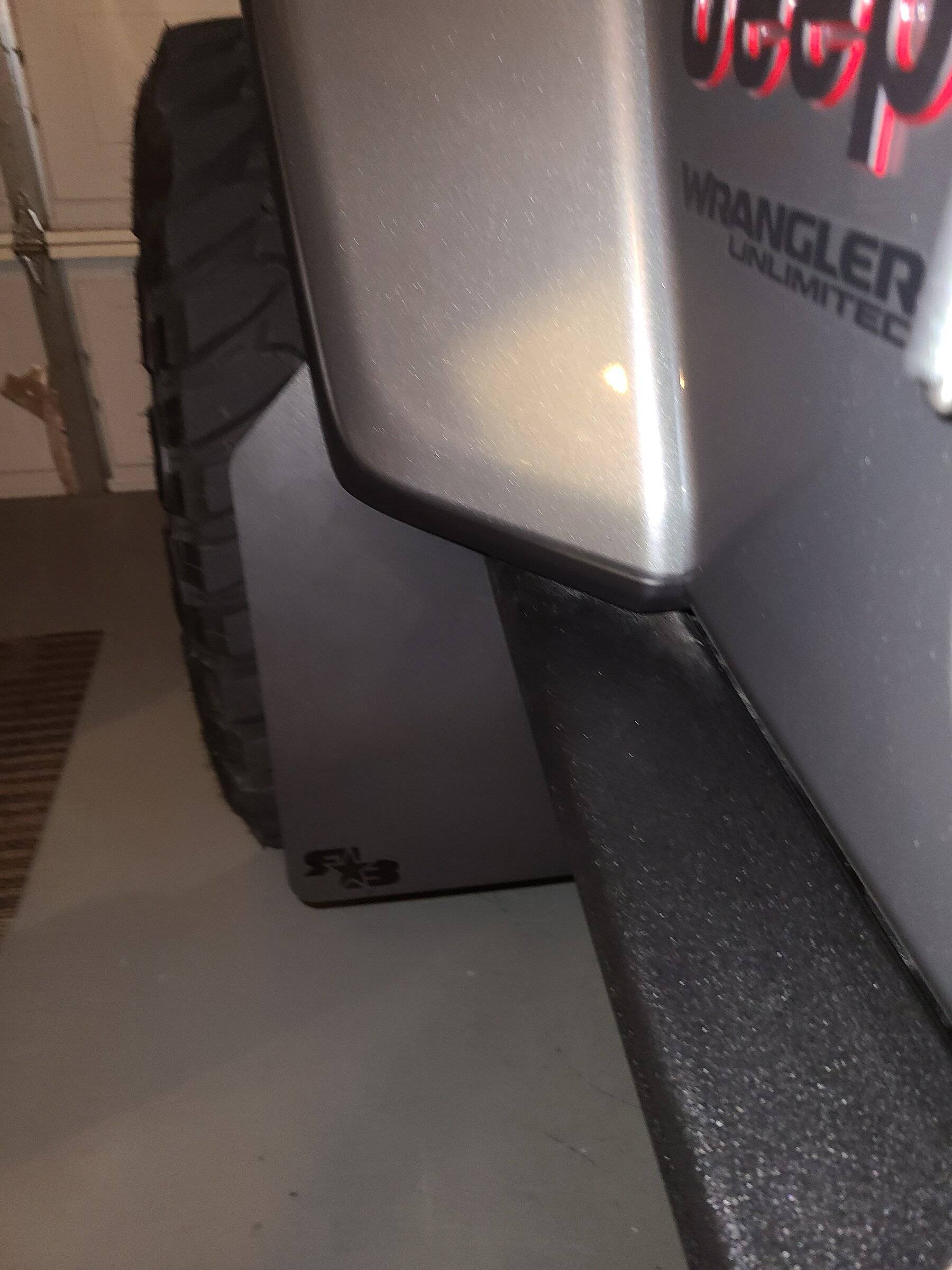

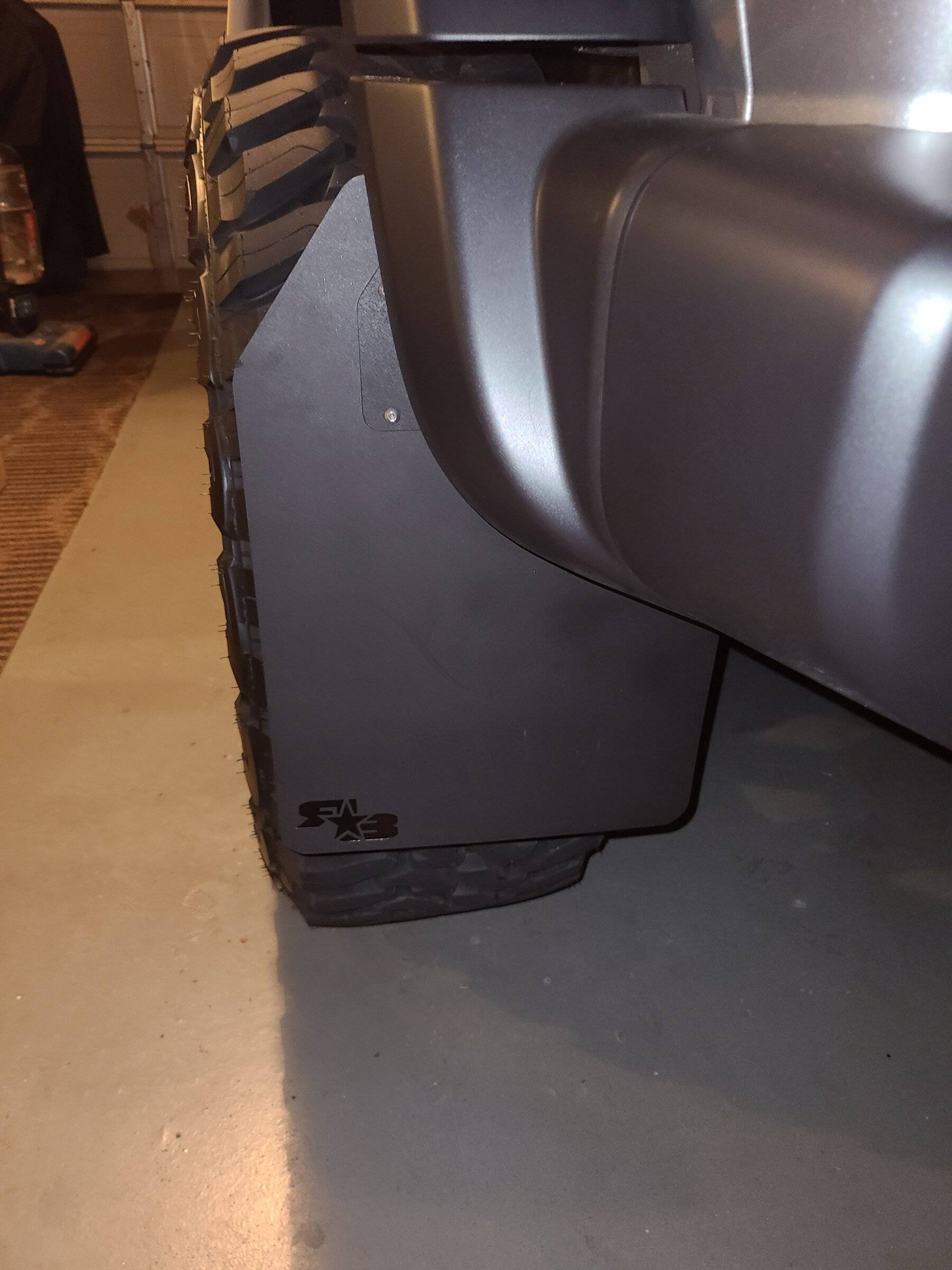

Thanks.
I guess the mud flaps will be necessary since they extend past the fenders.
